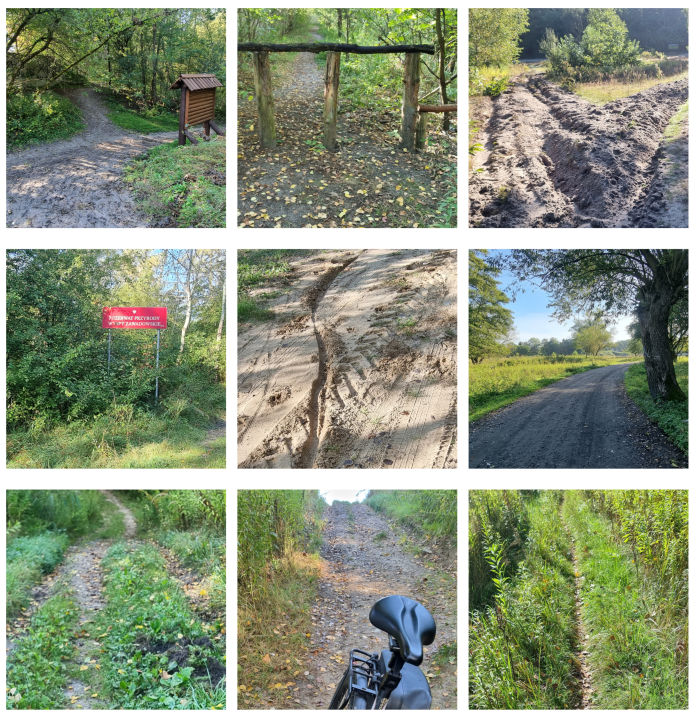

Besides, I will show soon pictures from today's ride on Vado SL involving a nasty singletrack. I had no issues with any "harsh ride" there!
If your fitness requires that you remain in the saddle at all times I could imagine that you would find the Vado SL uncomfortable....

That's the terrain I rode on my Vado SL 4.0 EQ on last Thursday.

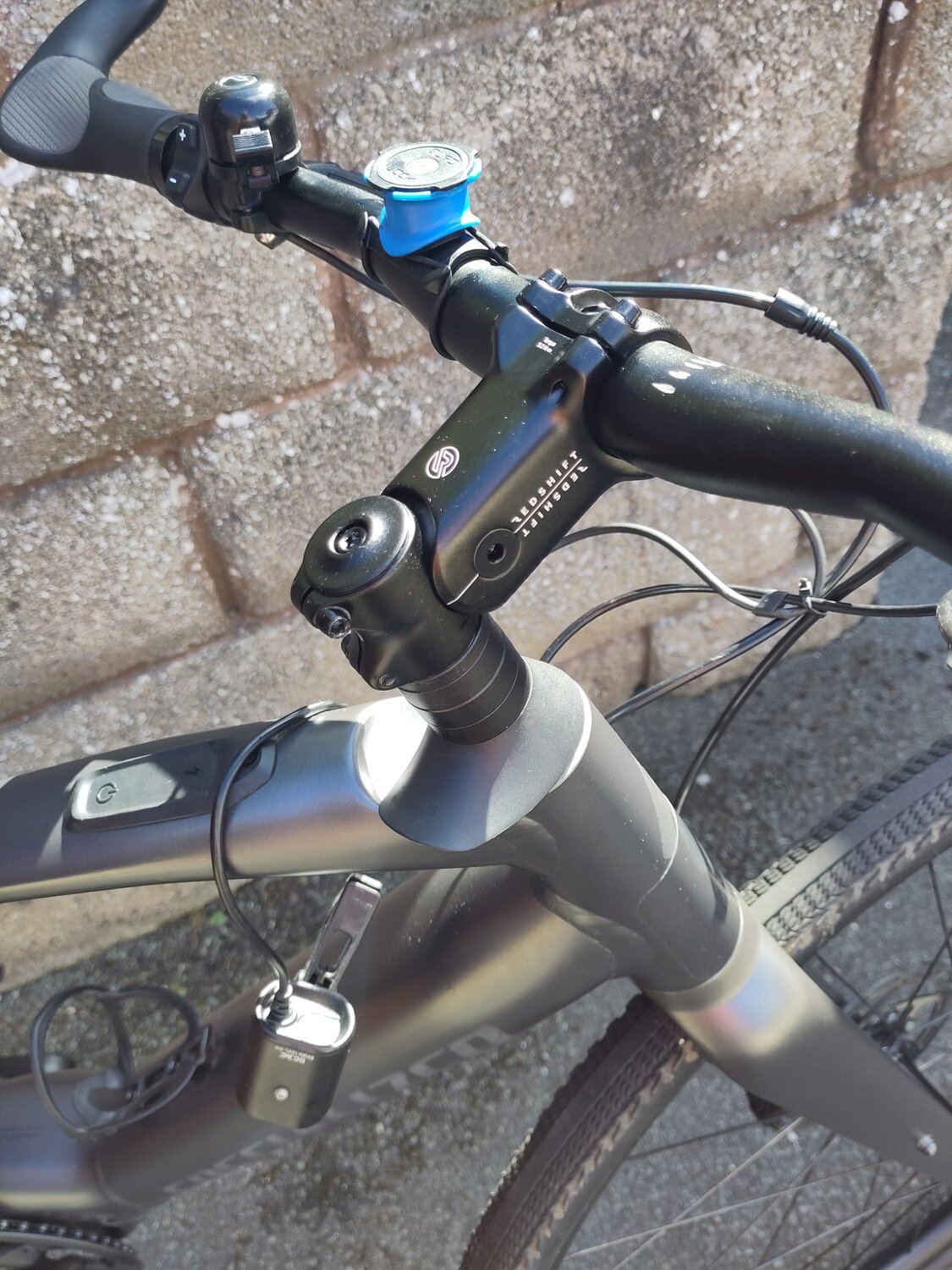

I fitted a redshift sports shockstop stem to mine and that did sort the harsh ride for me.
