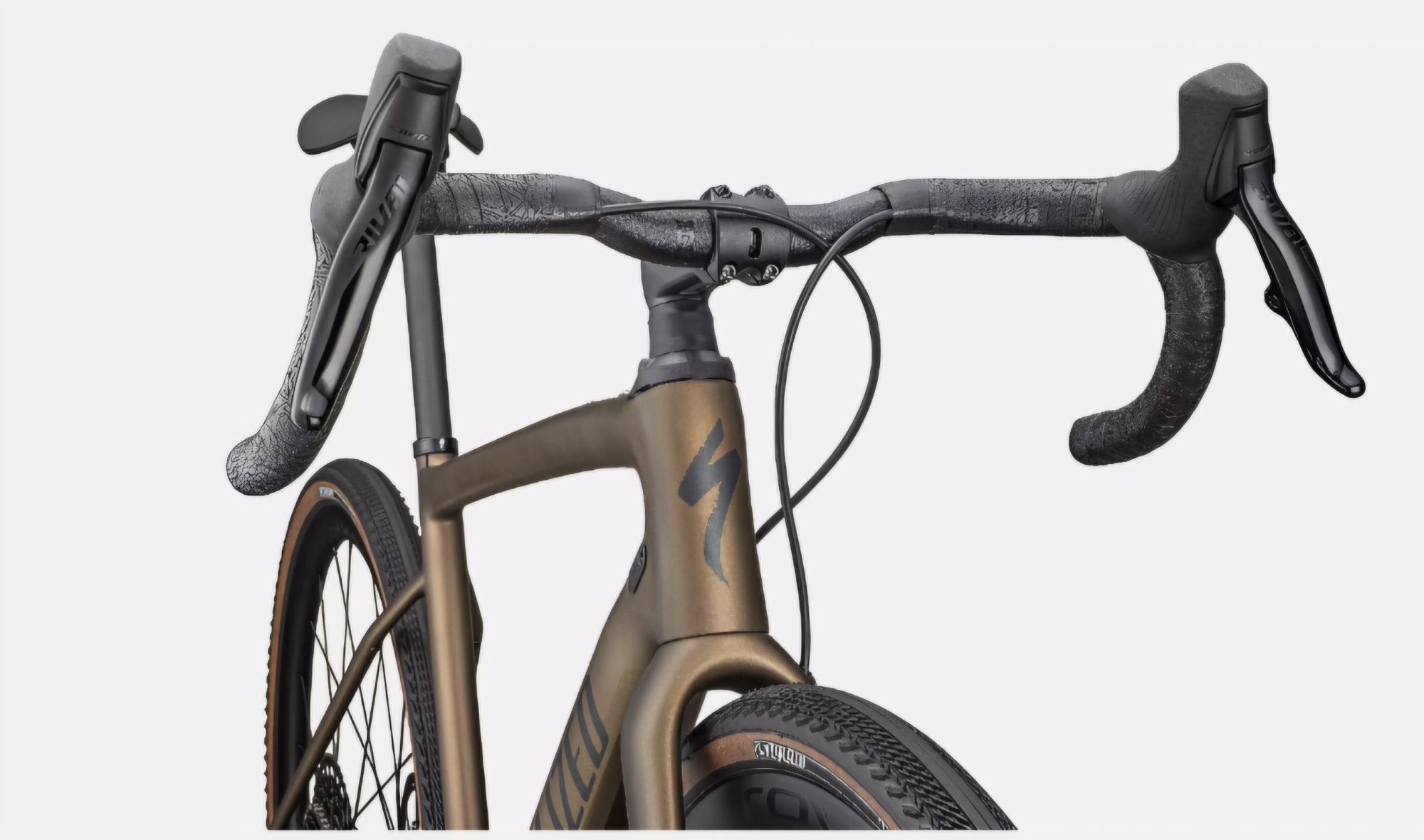

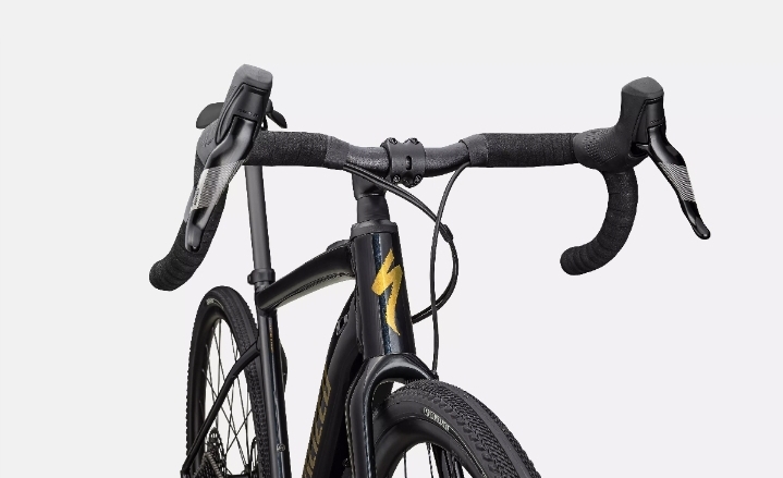

Jeremy, I recommend you explore the features and geometry of the following Specialized bikes:
  • Tarmac (racing road bike)
  • Roubaix (endurance racing road bike)
  • Crux (cyclocross bike)
  • Diverge (gravel bike)
and then draw the conclusions yourself.
Diverge
Creo 2
Gravel cycling (sport) involves gravel, off-road but also asphalt. You do not expect a gravel bike be as fast on asphalt as a racing road bike but a gravel bike will be lightning fast on unpaved roads (where a road bike might simply lose its delicate wheels).
The major difference between the sports of road and gravel racing is the peloton vs an individual/group. In the peloton, the rider is a part of a team that fits the peloton as if it were a part of a well oiled machine. The road racing bike is extremely lightweight and aero, and is equipped with narrow tyres. The cassette is made in 1-tooth steps so every peloton member can pedal at an ideal cadence and exactly the same speed. Some riders still use V-brakes as you are not expected to stop during the race but need low weight. The geometry is aggressive: you need the speed but no need for maneuvers.
In a gravel race you either ride as an individual (SOLO) or in a loose group. Being self supported is the keyword, hence multiple bosses for bags and water bottles (have you ever seen a road racing bike with water bottles attached to each side of the fork?) Flared drop bars and relaxed geometry help maneuvering in rough terrain. The drivetrain is of MTB type but using the drop bar brake/shifter levers. The dropper seat-post is to facilitate descents on singletracks. Wide tyres allow massive cushioning of road vibration, allowing the racer riding fast. It is always hydraulic disk brakes.
Take a road racing bike, throw 33 mm tyres in and you get "all road bike" but it is not a gravel bike.
