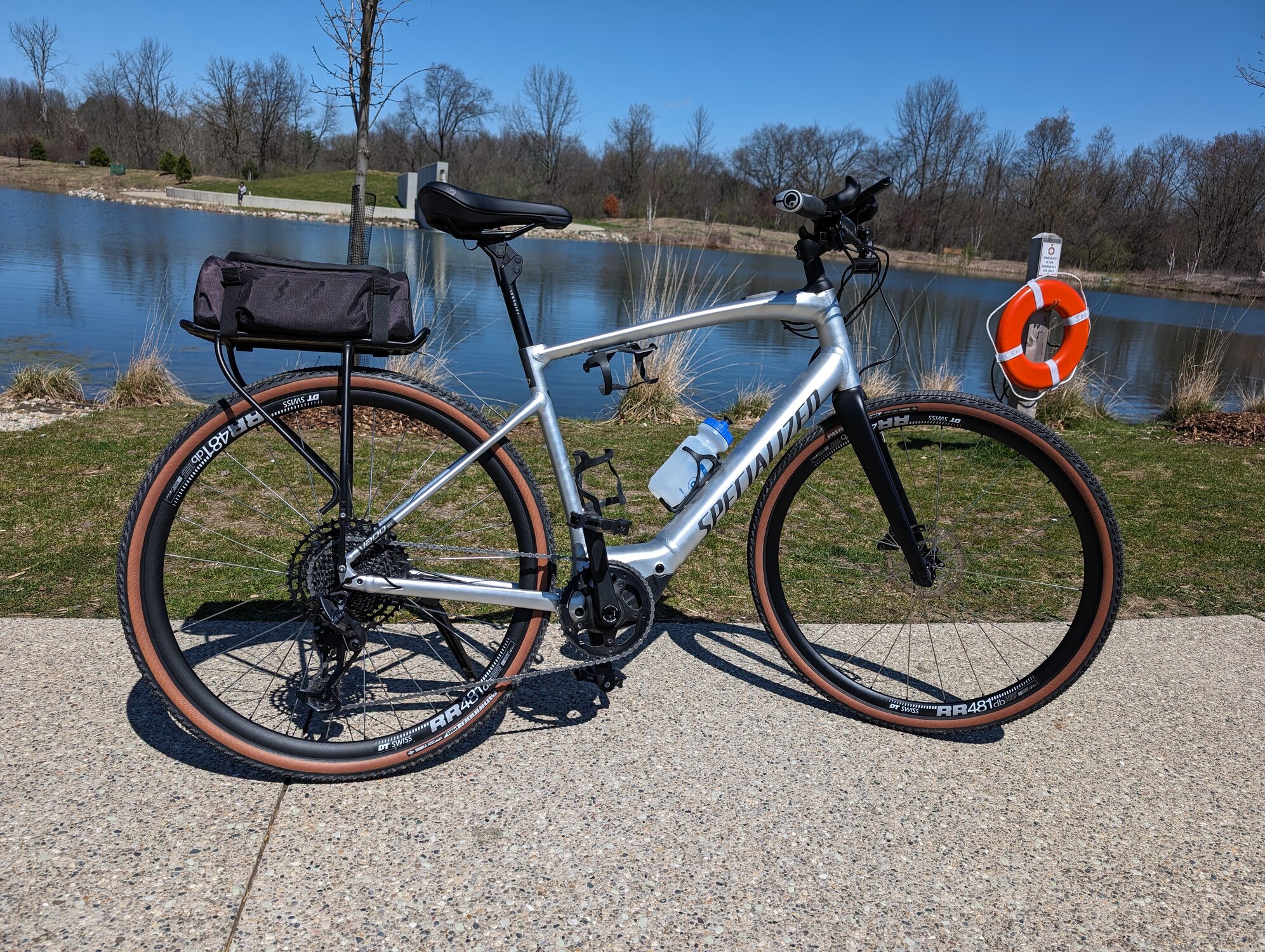

My 2022 Vado SL 5.0 in its 2024 incarnation. Changes include:
  • Custom built wheels with silent Vesper Onyx hubs by prowheelbuilder.com
  • Specialized Pathfinder Pro 700x42 tires
  • Ergon Evo saddle
  • Ergon grips
  • Shimano flat pedals (replacing SPDs)
I retained the Inner Bar Ends as well. Interestingly, I tried this same saddle on my old Vado 4.0 and rejected it. However, this is a different bike and I also bought the smaller size. My sit-bone width put me between sizes and I read somewhere that it might be better to go smaller in such a situation. I also bought it this time from REI, where I get a full year to return it with no questions asked.
This is also a bit of an experiment to go back to flat pedals, and I even bought some really nice Adidas FreeRider shoes to go with the new pedals. If these work out I might switch pedals on my hybrid bike but will retain the SPD clips on my road bike.
Unfortunately, since this photo was taken just a couple weeks ago, the weather has practically turned into winter again and I haven't been willing to go out for a longer ride to get a better feel for the changes.
  • Ergon Evo saddle
  • Ergon grips

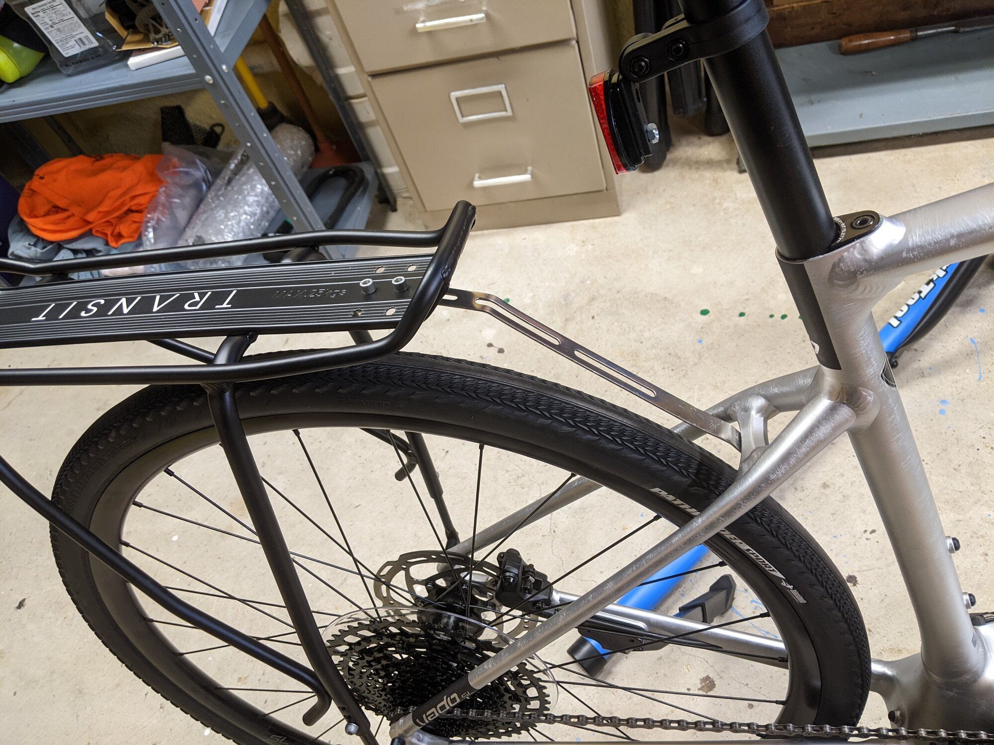

What rear rack are you using?
That's a really inexpensive "Transit" rack from a mail-order company in the U.S. called Performance Bike (performancebike.com). I used the trick of using a single mounting strap and attaching to the bolt under the rear seat stay bridge where a fender mounts on an equipped model.

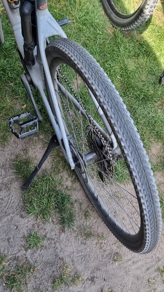

I had a chance to try my new Specialized Tracer Pro 2Bliss 42-622 tyres (tubeless setup at 2.8 bar/40 psi) in a sandy terrain! These tyres are excellent! It was the first time I could ride my Fearless through the sand with no fear!
Dusty a litte bit :)
