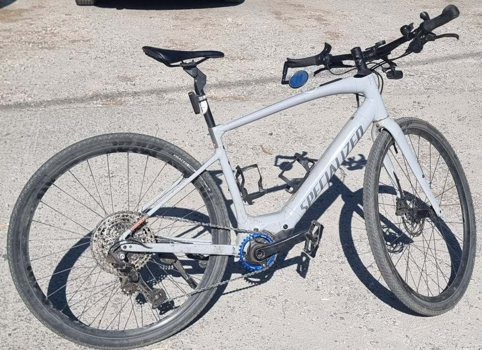

Now, after having replaced the previous chainring with a 32T, 104 BCD (Deckas) giving the 32-51T gearing, Fearless is ready for steep hills! Provided my combined leg and motor power would be enough to climb the hills at a stable speed...
Now only waiting for the Ortlieb Quick-Rack!

I have to ride Sudovia Gravel E-Sprint on my Vado SL with a 32-51T gearing as I am unable to replace the Vado 6.0 chainring (a stupid story...) The race is to take the place among extremely steep hills with (fortunately) short climbs. To make sure I will return assisted, I have to carry my 2 or 3 Range Extenders. Plus three water bottles, tools, snacks etc. I'll ride without the backpack, so I must take a pannier with me...

Not necessarily! As @mschwett was kind to explain it to me, the low gearing only ensures you can maintain a very slow climb at the proper cadence. Now, negotiating a given ascent at given speed, you must provide a certain amount of power with your legs and the motor. The SL motor only provides 240 W of power. With my bad legs, I could make a short 16% climb but that would not be possible at the 26% grade (walking the e-bike in Walk Mode would be necessary).
I would not have these issues with the Vado 6.0 that provides 520 W peak power if I had the 32-46T gearing but it is not practical at the moment :( The current 44-46T gearing is a no-go for the Sudovian hills!

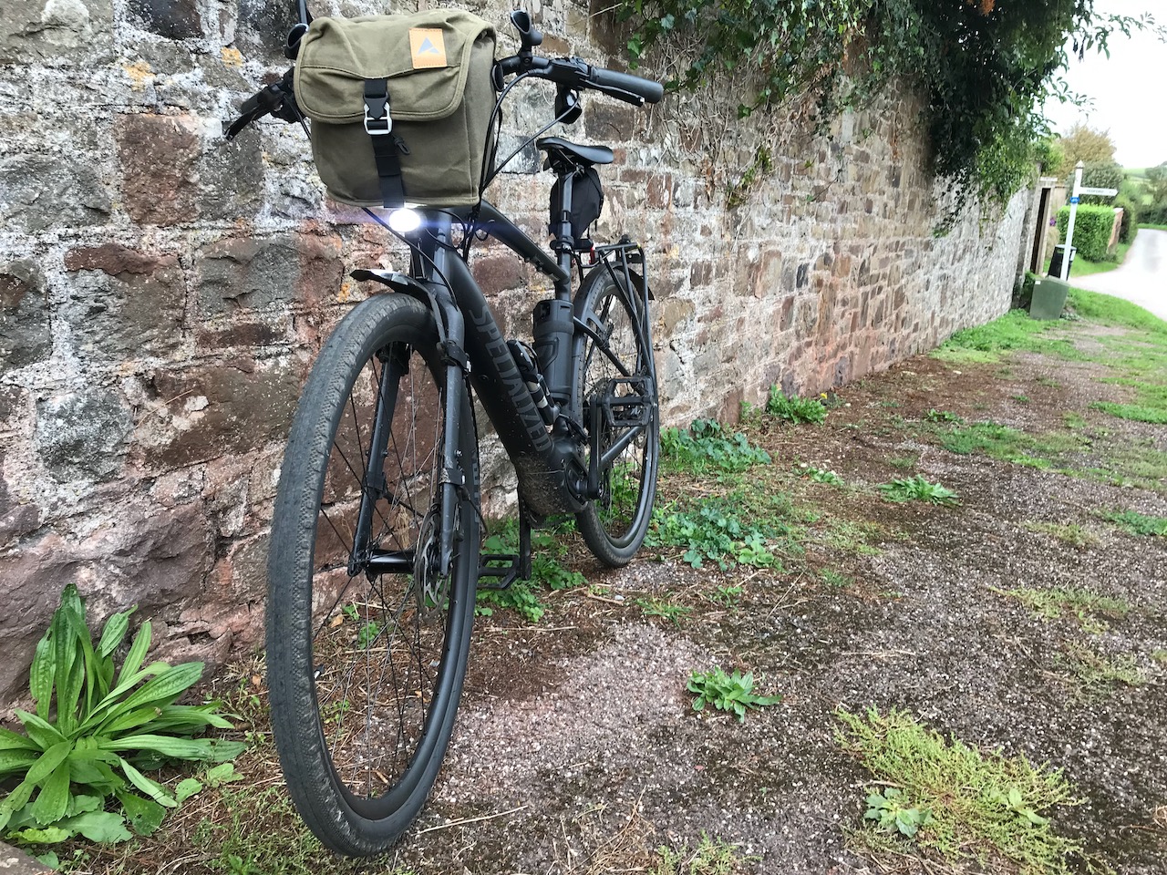

For normal rides, like not when I need to carry groceries etc for which I use panniers, I much prefer a handlebar bag then trunk bag. This KLICKFix one is great, very roomy I can carry coats spare gloves, sandwiches and so on. And the top pocket is ideal for phone and back up power bank.

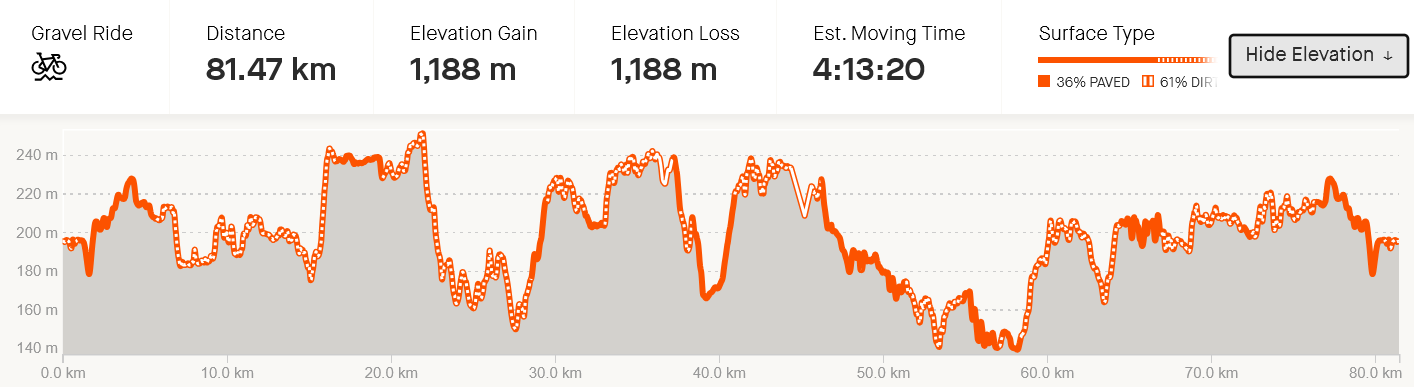

The Sudovian Mountains (as some call the area on the borderline of Poland and Lithuania in the Suwalki Gap) is the land of the most premium gravel roads in whole Poland. There are almost no flats only violent ascents and descents there. Here is the elevation profile for the Sprint Race:
It is (intentionally) a 50-miler.
Do I believe in the 26% ascent? Not. Do I believe in the 16% climb? Yes. I even do not intend to pedal on the descents because I need to conserve the battery, so let the gravity do its job. I am even more afraid of the descents as these are steep, short, and often end with a sharp turn! All of this makes the race so exciting!

I think you’ll be fine - although it’s up and down and up and down with what look to be a few very steep spots, no long sustained climbs and less overall than the standard for “hard” which is 100’ per mile around here, or 20 meters per km in your part of the world :)

i think that's conservative, given how short the climbs on this ride are, nothing wrong with going 7.5kph at 60rpm for a few minutes at a time. 500 watts is required. cut the bike weight in half and you need 450 watts, but your gearing is so much better that if you can balance, 6kph is reasonable, and now only 360 watts is required. supply 120 watts yourself, 240 from the bike, and go up those hills on the SL!
the steepest one appears to be at the 15km mark, about 50m of climb, only a couple hundred meters long - it shouldn't even take 4 minutes. the question is simply whether you can balance at 6kph on rough ground, and whether you can provide 120 watts of leg power for 4 minutes. the other climbs all appear much easier. 9kph on the vado vs 6kph on the SL over a handful of those climbs is only going to be 5 minutes or something for the overall ride, really not worth the other negative effects of the full vado for the rest of the ride. even if you have to walk up the steepest one.
