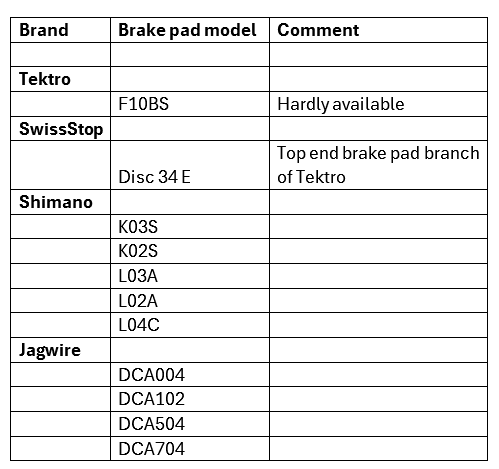

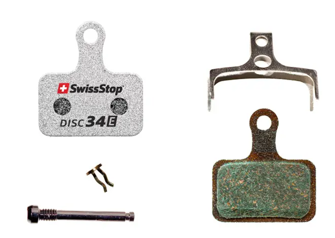

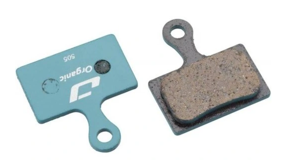

Brake pads for Tektro HD-R510 or HD-R290 Hydraulic Disk Brakes
I chose the SwissStop brake pads. Note: I copied the Shimano compatibility from SwissStop website; please verify visually before you buy!
