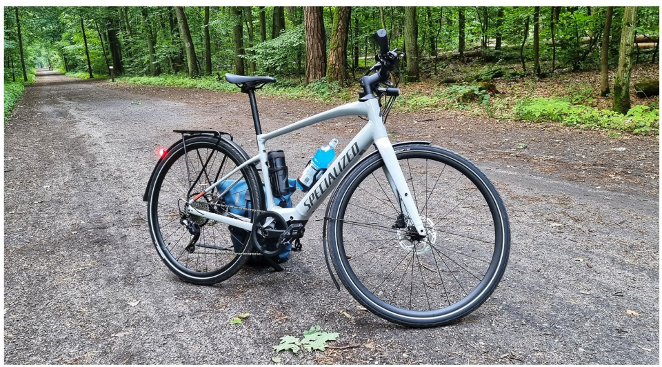

Going with the 36T chainring sounds like a plan. However, you could consider going even more extreme, that is, installing a 32T chainring, which is the smallest 104 BCD ring of them all, used on mountain bikes/e-bikes such as Levo SL. I went totally extreme with that by installing not only the 32T ring but also replacing the drivetrain with Shimano M5100 that has a 11-speed 11-51T cassette. That conversion gave me the lowest gearing of 18 gear-inches, which is purely in the MTB domain. (I use a 116 link chain in this configuration).
The consequence is I can climb anything but my max speed at favourable conditions is 32 km/h before I max out on the cadence. I do not care! The low gearing forces me to pedal at a higher cadence, which makes the motor work efficiently, and I am less tired on long rides as I do not need to pedal hard only fast.
When the chain gets worn, I'm going back to a 36T chainring but keep the 11-51T cassette and M5100 derailleur/shifter.
