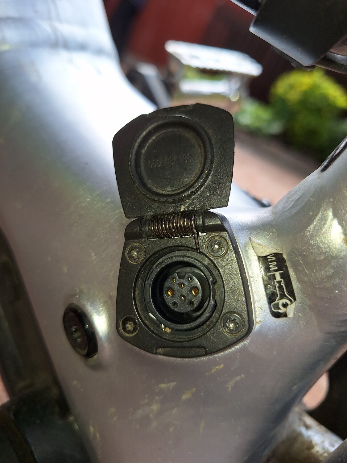

Has anyone replaced the charging port cover on Turbo Vado SL? The spring mechanism on mine has stopped working, the flap just flaps at the moment! The hinge bar became displaced and I think the end of the spring came out of its notch or from wherever it’s supposed to be fixed. I can either remove the current cover and try to repair this or order a new part which I have found online. I’m just a little concerned that when I remove the four bolts that hold the the port cover in place and remove the part that there may be small rubber gaskets or other parts that move such that it will be difficult to replace. Also the bolt heads are a rather unusual, what tool fits them?
I’ve had to do so twice. The part is inexpensive and built to stay that way. The screws are tiny two mm torx for which it is difficult to find a decent tool. Most strip the screws or themselves. The first time it happened, I had my LBS fix it. The second time I tried myself but met the crappy torx wrench issue and had to go to the shop anyway. I subsequently bought a better quality tool.
The port cover design is poor, easily strained by the charge or RE cables. When you order the replacement I suggest getting two as you will need it again and you won’t have to wait for a replacement if luck makes it challenging to obtain in the future.
Thanks, so if I undo the four screws and lift off the broken part, will the new cover just fit in place, with nothing to be careful not to displace?

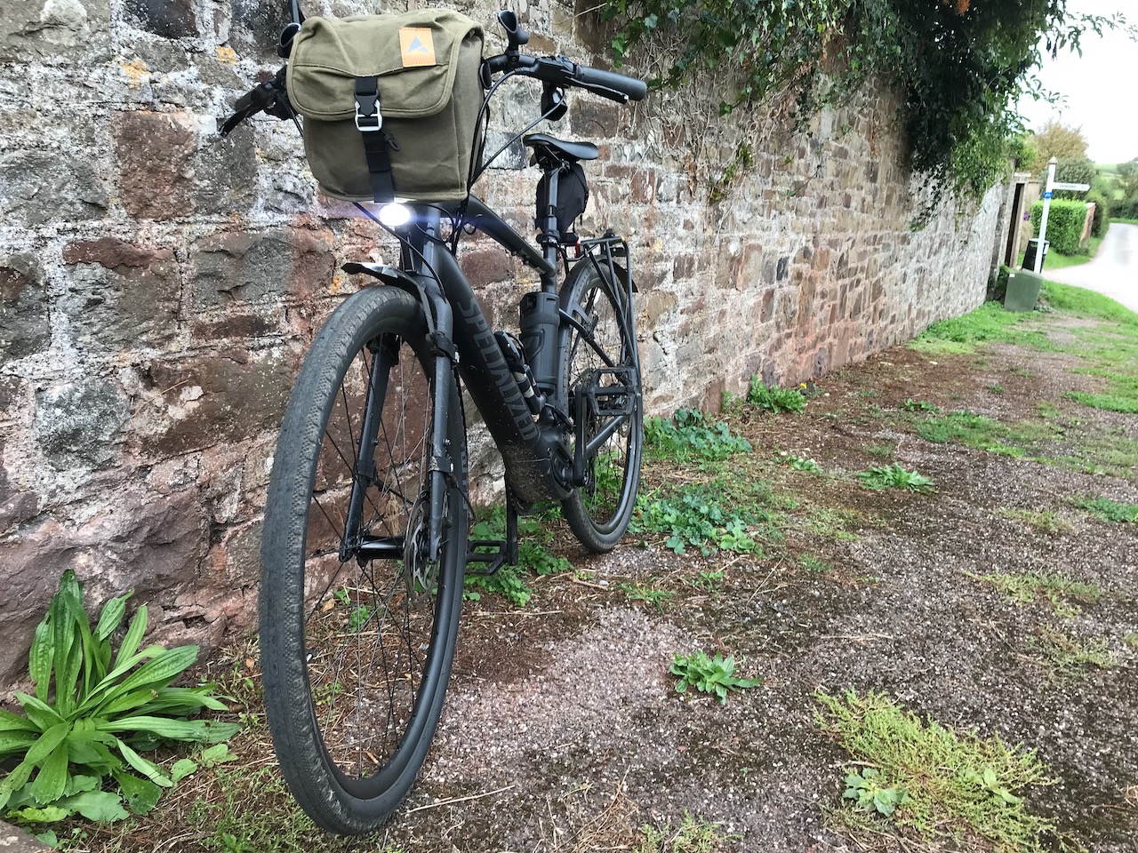

For normal rides, like not when I need to carry groceries etc for which I use panniers, I much prefer a handlebar bag then trunk bag. This KLICKFix one is great, very roomy I can carry coats spare gloves, sandwiches and so on. And the top pocket is ideal for phone and back up power bank.

A quick follow up on this bag which I remain pleased with. I've started carrying a small pair of binoculars for birdwatching or a little Sony camera, both of which make the bag sag down a bit and obscure the light, so contradicting my statement above. A bit of searching and boosting of Amazon's profits and I sourced some GoPro extension brackets in 6, 8 and 10 cm lengths. These allow the light to be dropped out of the way of the bag and hold the light securely enough. It's worth putting some threadlocker onto the screws/bolts to hold everything tight.

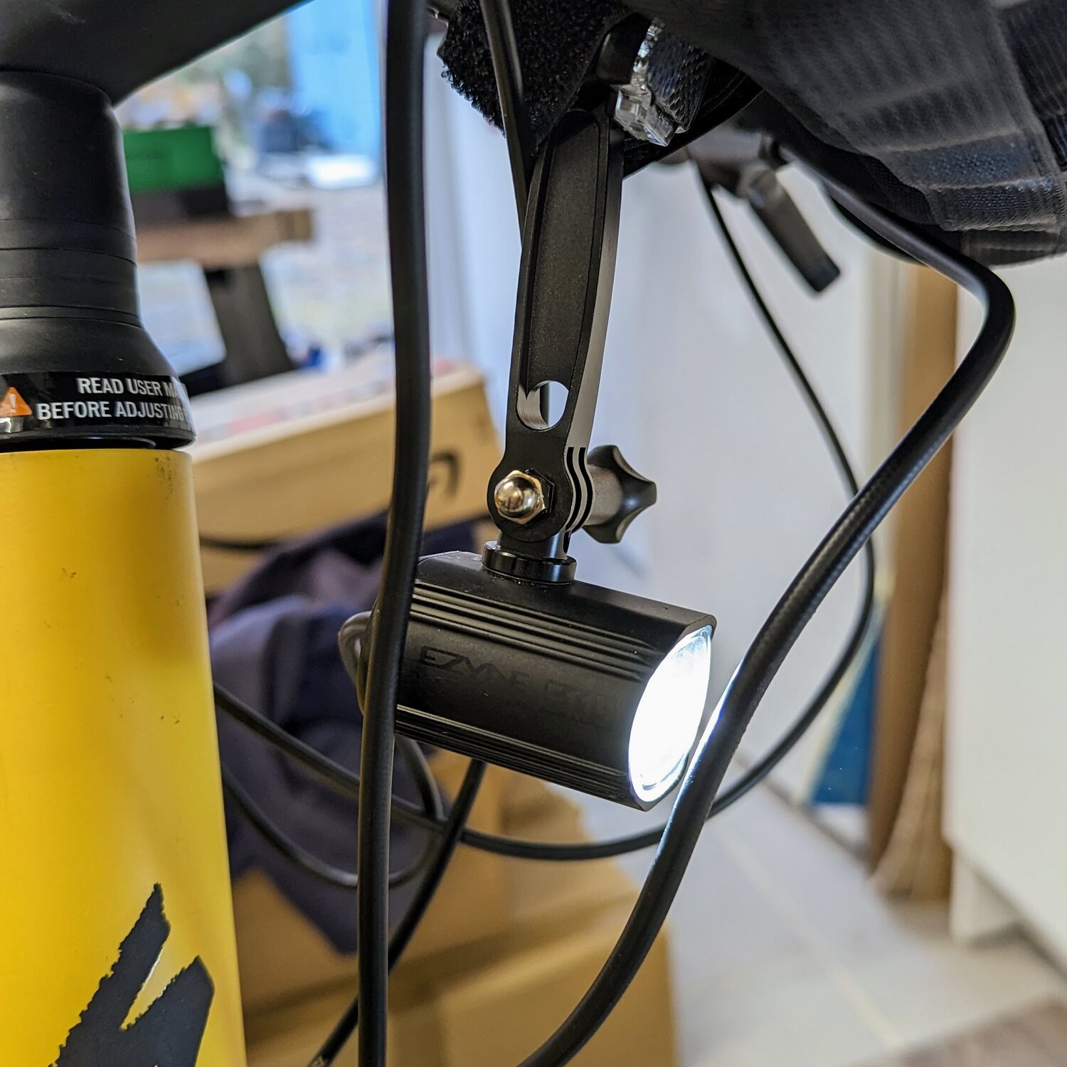

Well done! Seriously considering this mod and a similar handlebar+saddle bag combo for my own yellow SL 5.0 EQ, as we discussed elsewhere. The yellow accents on your handlebar bag work well.
Three questions, please:
Q1. Looks like the Go Pro extension arm just bolts in between the headlight and its original mount on the underside of the stem. Correct, or is there more involved?
Q2. How long is the extension shown?
Q3. Any cable routing issues with the bag shown?
Thanks!
