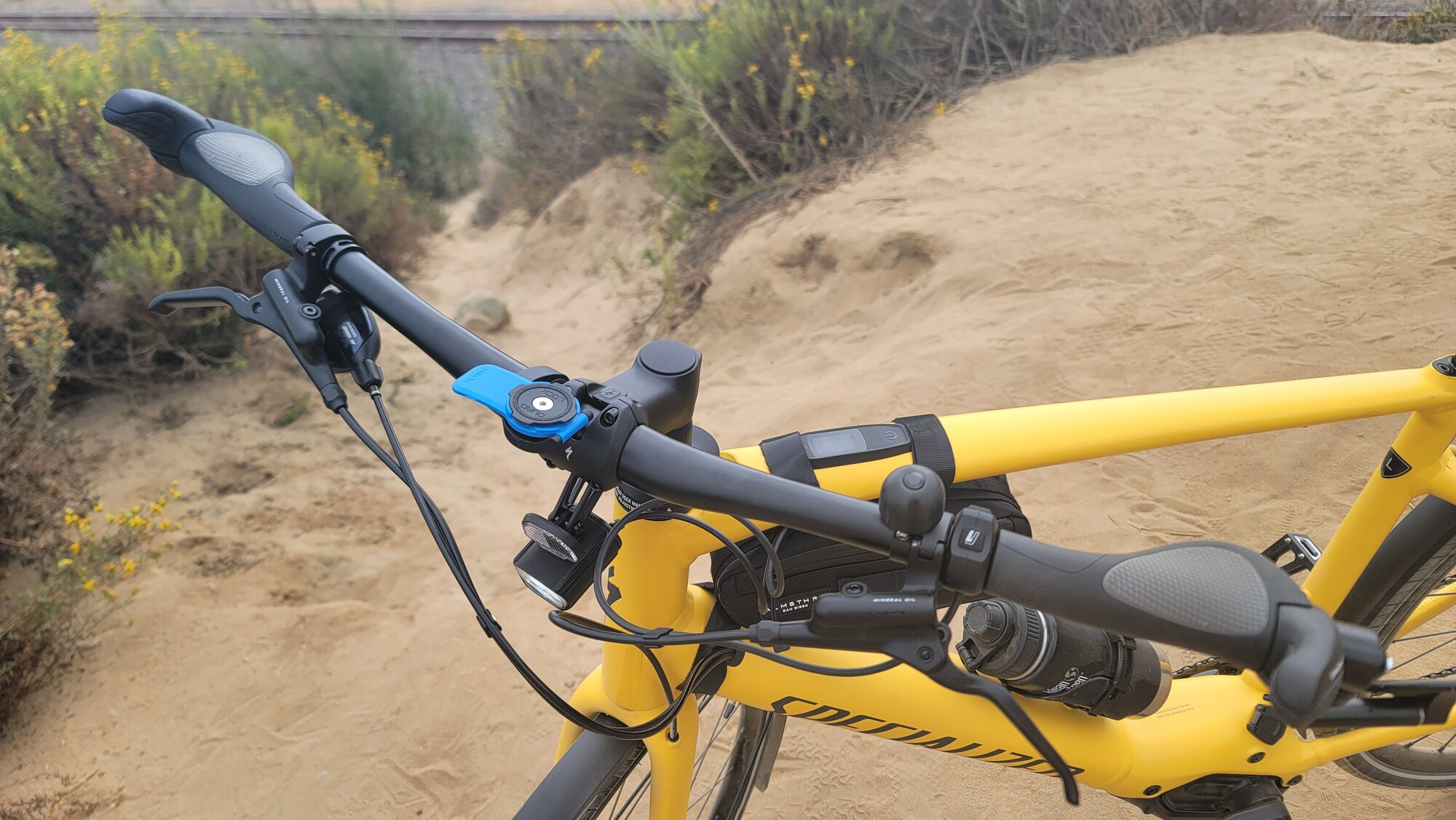

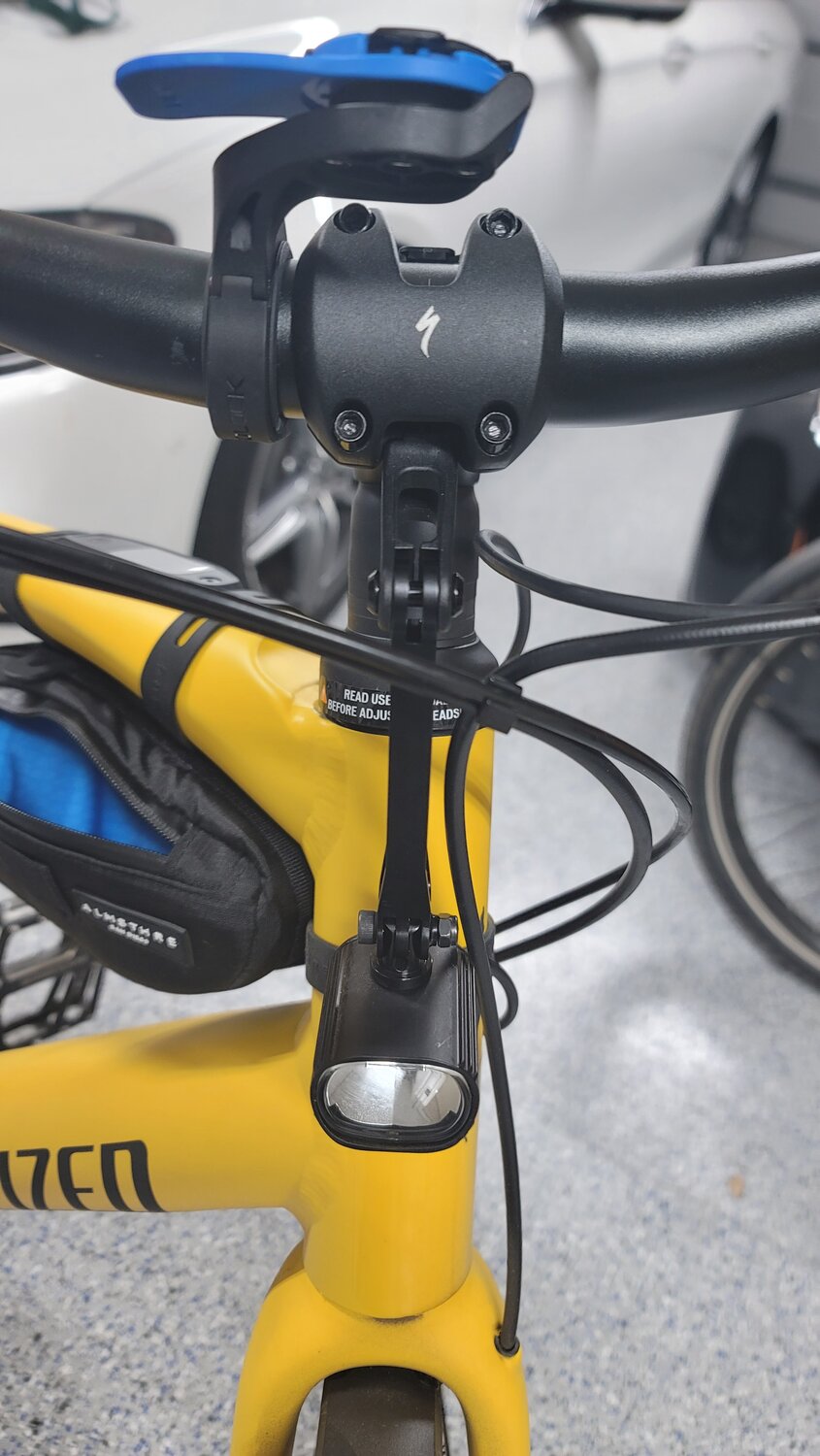

A quick follow up on this bag which I remain pleased with. I've started carrying a small pair of binoculars for birdwatching or a little Sony camera, both of which make the bag sag down a bit and obscure the light, so contradicting my statement above. A bit of searching and boosting of Amazon's profits and I sourced some GoPro extension brackets in 6, 8 and 10 cm lengths. These allow the light to be dropped out of the way of the bag and hold the light securely enough. It's worth putting some threadlocker onto the screws/bolts to hold everything tight.
Cheers
David

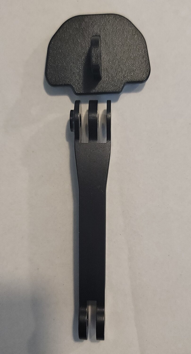

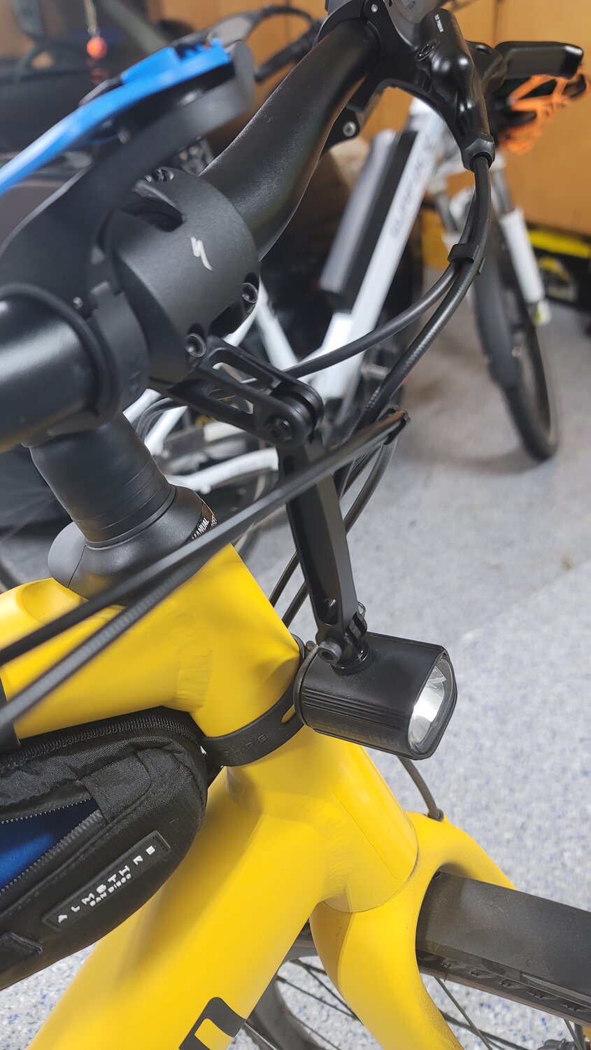

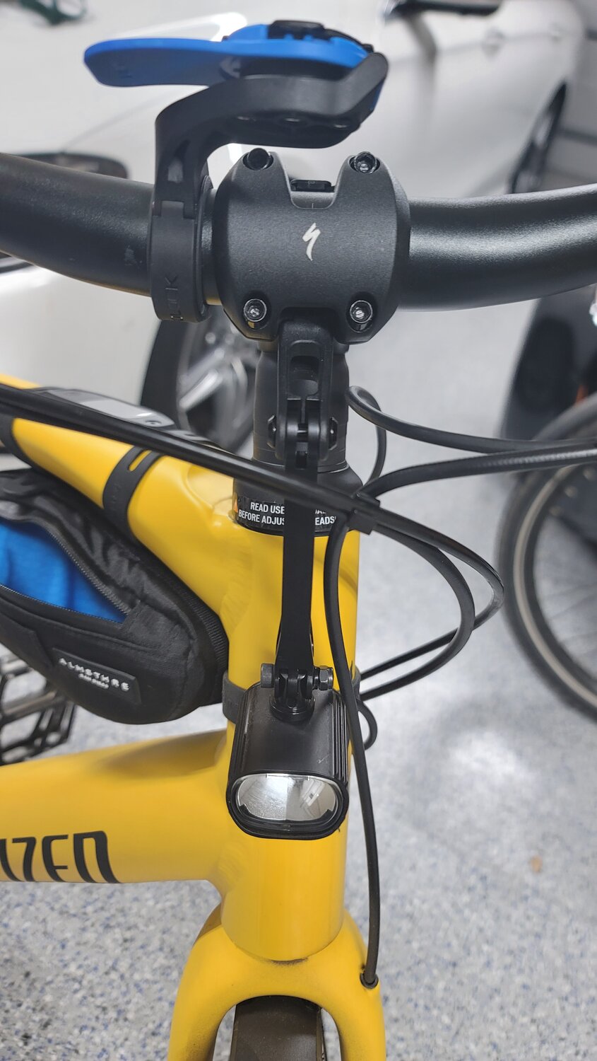

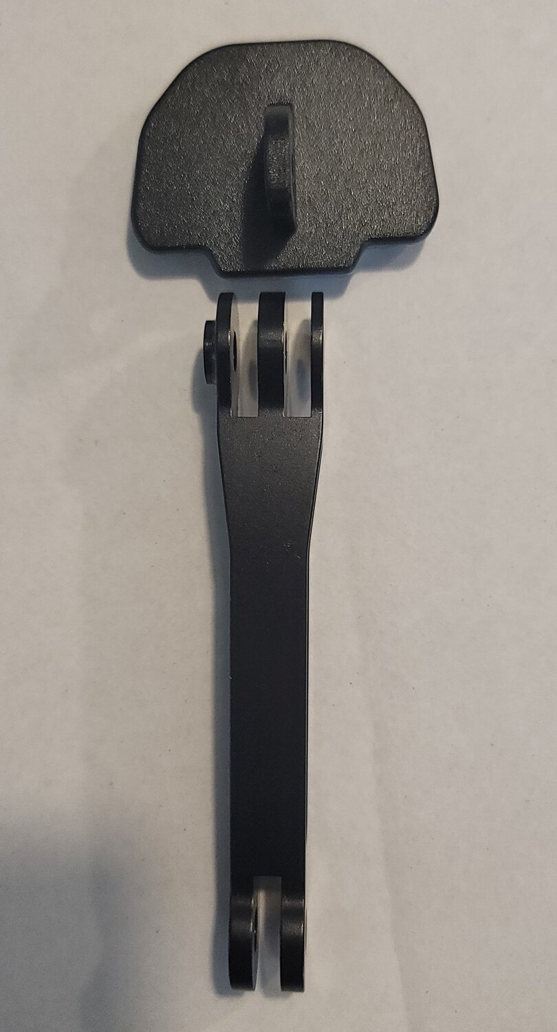

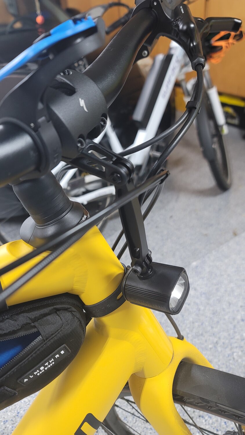

Following your lead, lowered my headlight with a 4-inch GoPro extension arm. Still sourcing a cable-friendly handlebar bag. Two concerns:
1. Are you still comfortable with letting your bag rest — and potentially bounce — on the cables?
Photo above shows cable routing around the headlight in stock location. The cables are neither long enough, nor flexible enough, to go around the front or ends of a handlebar bag as long as yours (10.5" per Amazon). Ditto for the 9.1" Topeak bag I've been eyeing.
Now leaning toward a narrower but taller bag in the 2.0-2.4 liter range with external bungees for a thin wind/rain shell.
2. Wish I didn't have to lose use of the stock front reflector. The extension's dissimilar ends leave just 2 reflector options: (1) Keep it in its original location, as you did, effectively hiding it behind the bag, or (2) just remove it as shown above.
Guess the bag will need either reflective stripes or a place to clip a reflector that won't get covered by the shell.

Why not remove the centre lug from the 3 lug end?

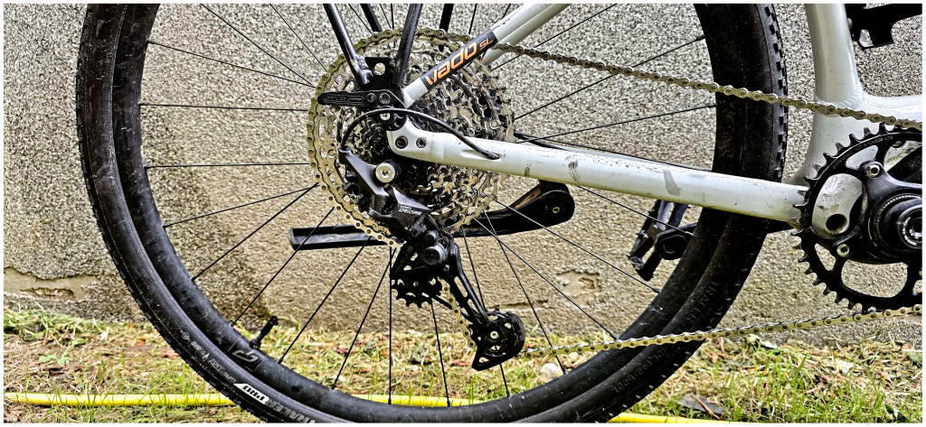

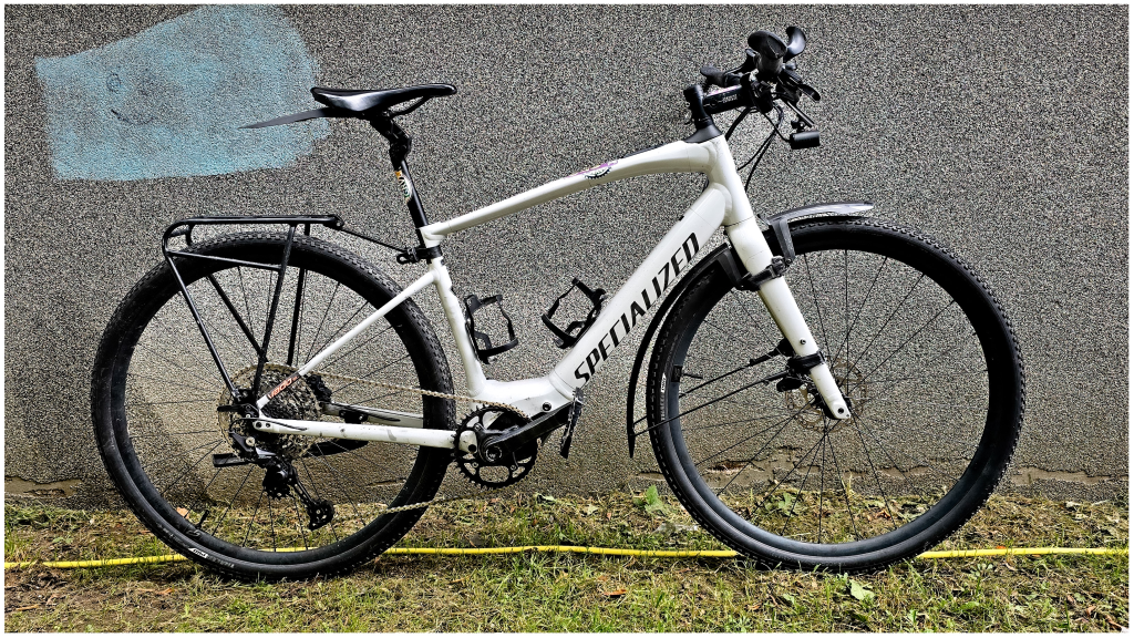

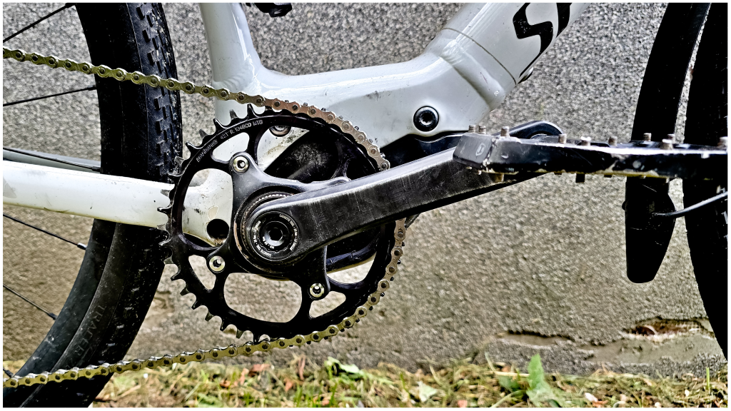

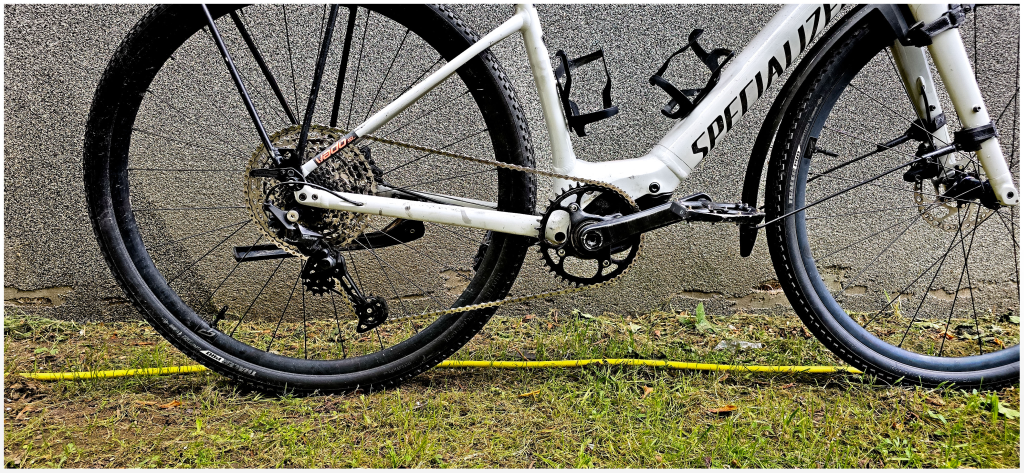

The Cold Season Configuration Of My Vado SL
A larger chainring (42T instead of the 32T) and a new chain were what I needed for regular Vado SL rides in the cold season in the flat part of my province Mazovia.
I have reused my Garbaruk 104 BCD 42T chainring and the 8x8 mm steel MTB chainring bolts tightened to 5 Nm.
The 11-51T 11-speed cassette and the derailleur belong to the Shimano M5100 groupset. It was my major upgrade of the drivetrain made this season on a Vado SL 4.0.
The lowest 42-51T gear is near to the maximum "chain wrap capacity". I would hesitate to go with the largest allowed 44T chainring here! NB: The chain is KMC e11, 122 links used in whole.

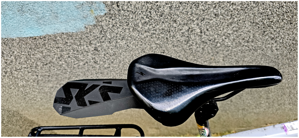

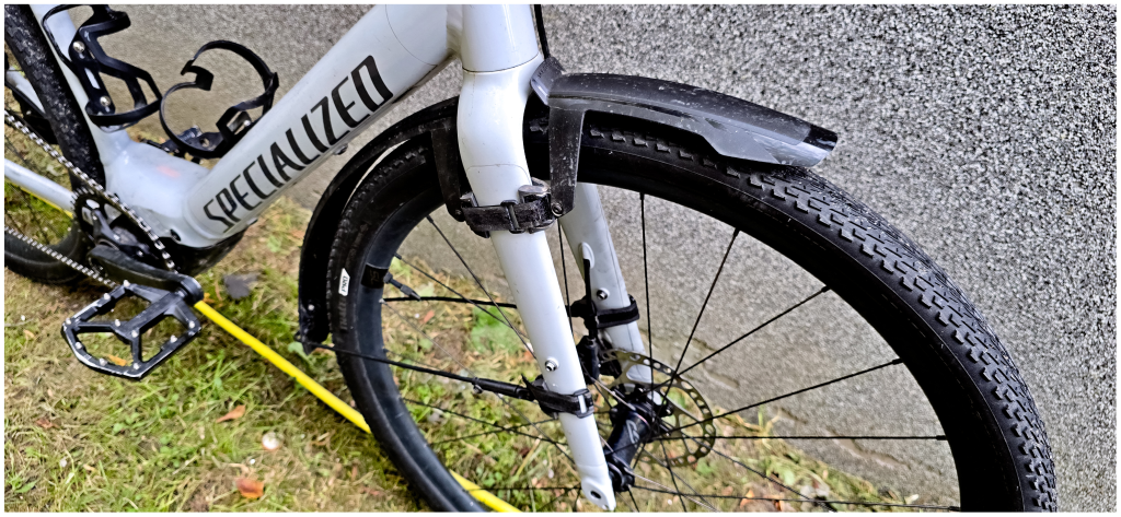

Installing 42-622 Specialized Tracer Pro tyres in the tubeless setup was good from the riding perspective but it has eliminated the possibility of using the rear SKS Speedrocker mudguard/fender (too tight clearance!) Went with an SKS S-Guard (splash guard) instead.
While the front SKS Speedrocker fit with no issues!

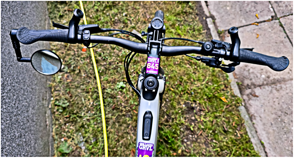

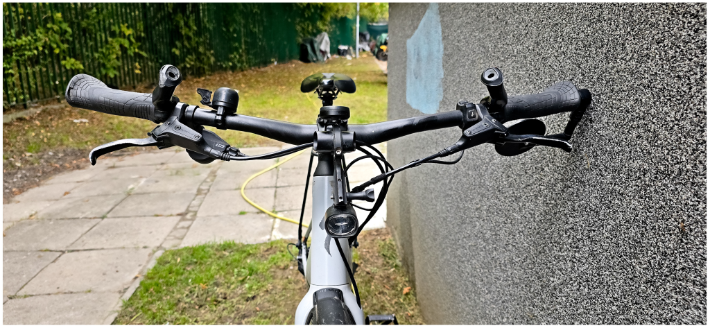

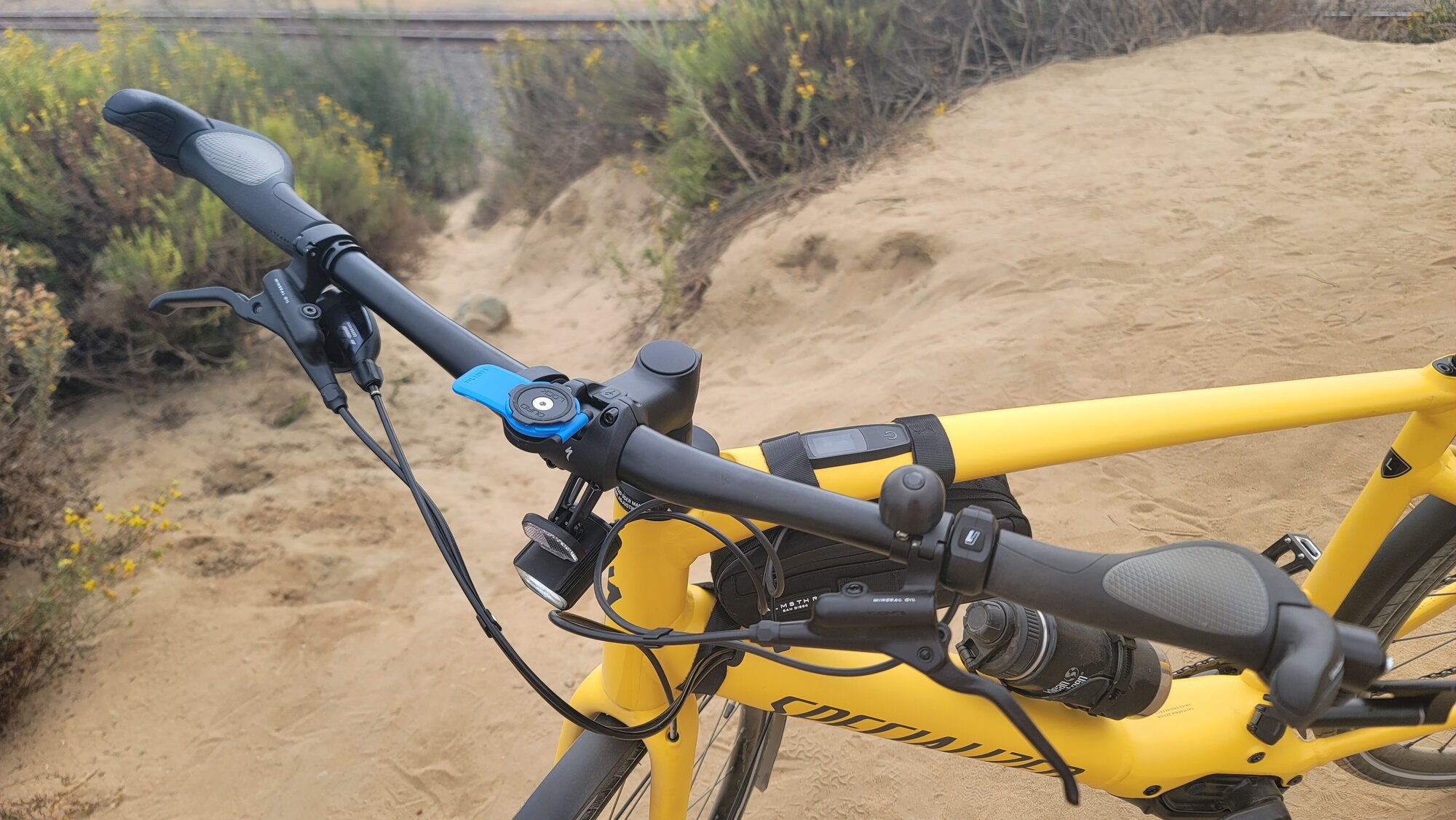

My Vado SL cockpit as seen from the front.
Top-view of the cockpit. The photo is out-of-focus because the camera focused on the steering tube cap or on the subject in the mirror! :D
