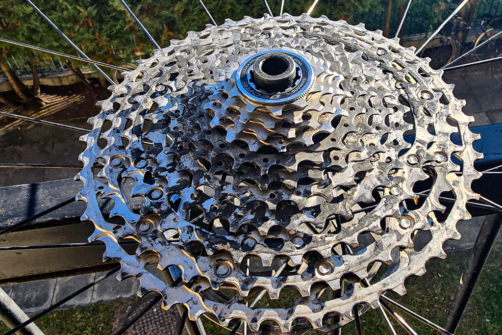

Replacing worn sprockets on my CS-M5100 (11s, 11-51T) cassette
This year, I equipped my Vado SL with a new Shimano M5100 drivetrain. However, I thought I needed a 32T chainring for steep climbs, too! As the chain mostly works on small cassette sprockets during normal rides, some small sprockets wore out, notably the 15T.
Fortunately, many Shimano MTB 1x cassettes are serviceable. As I own both the cassette wrench as well as the cassette whip, I just bought 15T and 17T sprockets. Fancy that: Some time in 2020 or 2021, an EBR Forum user @TS25 was as kind as to send me an envelope with several spare small 11s sprockets from Germany! It was a very kind gesture from him! (I miss Ralf a lot!) Now, I took the last 11 and 13T sprockets from his envelope and was good to go!

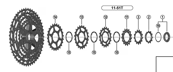

I had to think a little how to reuse the spacers on the cassette :)
This drawing from Shimano has certainly helped!

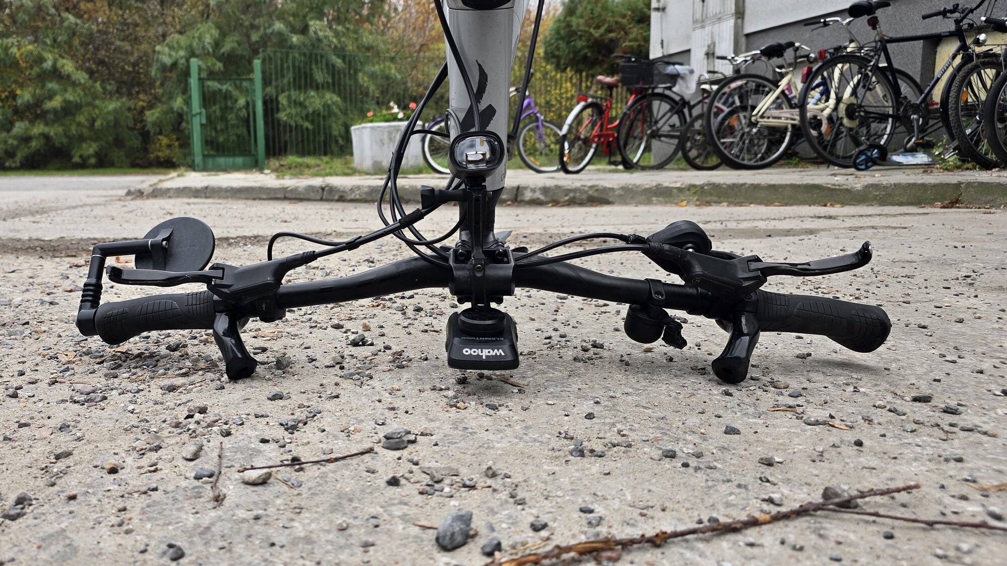

Trimming the bars will take out a lot of precious real estate, which many need to install accessories on.
Installing SQlab Innerbarends puts your arms 44 cm apart, which is the same as on the hoods of a drop-bar road bike.
Now, the full handlebars length might seem too wide for many riders but get into a mild off-road once and you'll notice how the wide bars help controlling the bike!

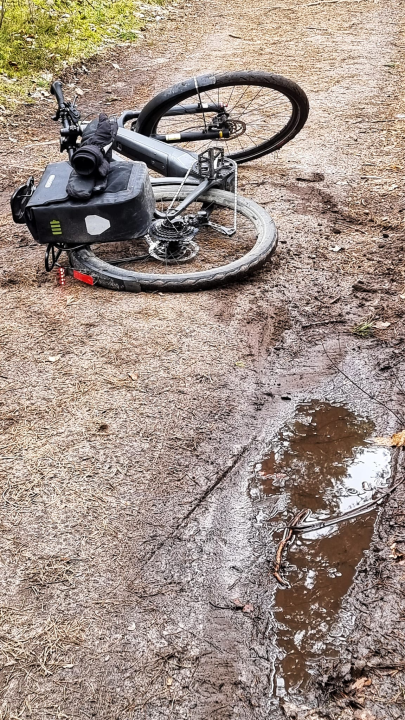

This was not an emergency braking but just wrong tyres for the terrain ridden. As I was riding over the little puddle on a fire road (high speed), the rear wheel skidded sideways. A longitudinal skid is allowed and expected. The lateral skid is the indication of wrong tyres used.
Moreover, the tyre design is focused on maintaining the lateral traction (cornering).
