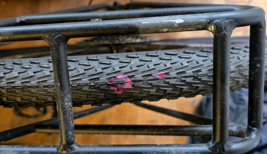

Or, when you look at your tubeless tyre:
  • At night, and you have an impression the tyre tread got torn off and you see the inner rubber layer through the tread;
  • In daylight, and you think you had punctures, and the sealant fixed the holes...
But you had actually ridden into some chewing gum :)

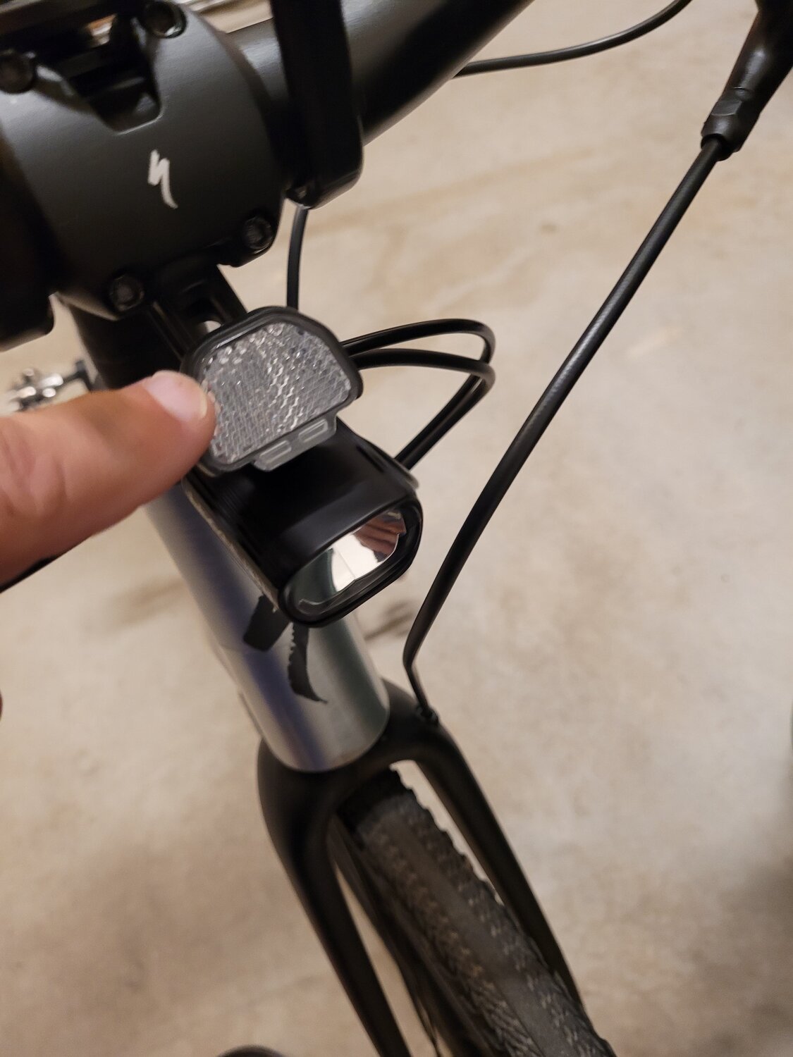

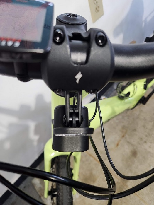

Here is the photo. I looked at some stock photos and I don't see this on the internet photos. It's loose in the bracket. No way to tighten it, as far as I can tell. Maybe it's a new thing that someone decided we needed for safety?
ItsView attachment 122527
My wife recently purchased a Turbo Vado SL 4.0 and it also has the front reflector mounted on top of the light. It didn't make sense to have a reflector on top of a light and went to remove it.
It appears if I remove the reflector the mount will not hold the light tight. Decided to leave it. With a hex key I did snug up the light and reflector. Both were loose.
I'm new to the site and working my way through this thread before doing a Introduction post.
Some US states still require reflectors on bicycles. The Specialized support site is a good reference in particular the Turbo Vado SL and All About Turbo sections.
California's one of them. And after shelling out $750 for the EQ package on the SL 5.0, I still have no rear reflector. Yes, got a small tail light out of it, but the lens doesn't reflect. Bizarre.

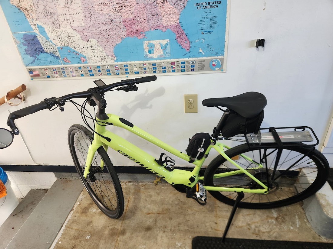

No fenders because of our bike rack.

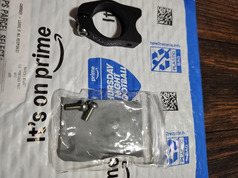

I put one of our old rear racks on. I could not find the correct size seat post clamp with rack attachment so the forward mount is just a zip tie for now.
This is what I had hoped to use.
Plan B is to use one of the metal straps and use the existing fender mount point
for the forward mounting point of the rack. I noticed the manual mentioned this option to mount a rack.

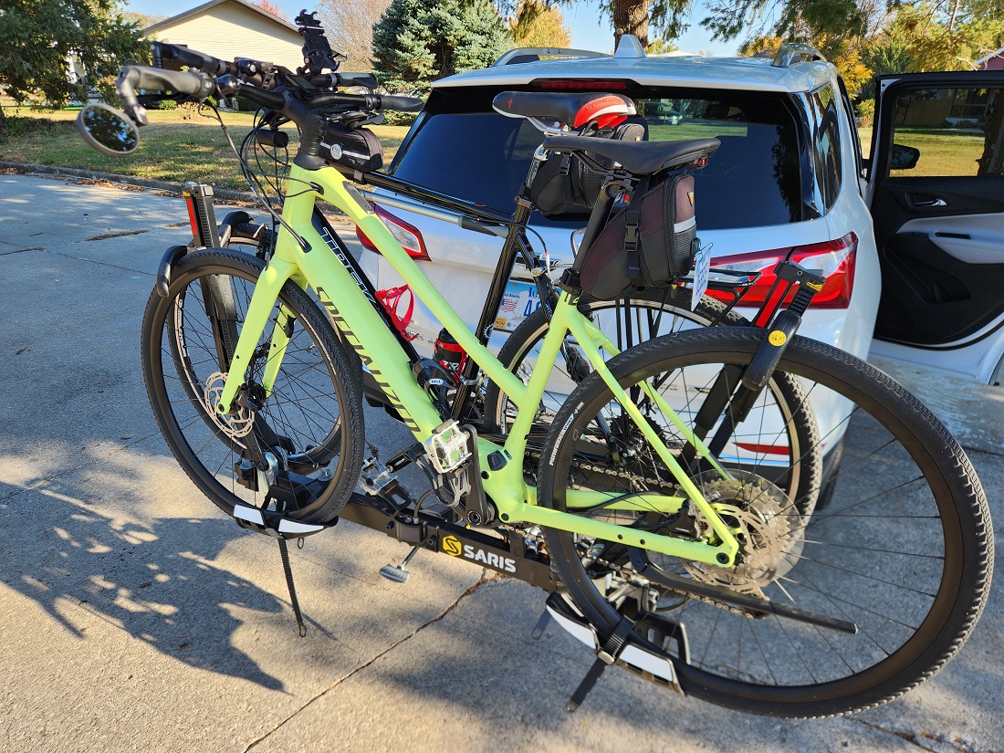

Here's Debbie last week on her first ride on the High Trestle Bridge Trail near Madrid Iowa.
She's not a strong rider so the first ride I thought we would do 26 miles on a Rails to Trails path.
The 13 miles headed back to the car we had a 20 to 25 mph headwind. She switched to Turbo for the last 13 miles and I was working hard to keep up on my hybrid which sits me up in the wind.
Debbie has a very lite weight carbon fiber Trek Road bike she does not ride because she does not like the riding position.
She likes her Trek hybrid but she is not a strong rider. Last year we started to think about a E Bike for her but she wanted something that was possible to ride at times without assist and I wanted something that was easy to carry up stairs because most of the time our bicycles are kept in the basement.
The Turbo Vado SL 4.0 is only 4 or 5 pounds heavier than her Trek hybrid and for me it does not feel any harder to ride compared to her Trek.
This may work for the seat post clamp with rack attachment. This is the Specialized seatpost clamp that works on the Creo 2 E5 with aluminum frame: S184700001 STC MY18 DIVERGE SEAT CLAMP WITH RACK MOUNT 30.6. Measure the outer diameter of the seat tube to double check. It does not work on the Vado SL models with the internal clamp.
I saw that last week when I was searching online. I guess this does not replace the seat post clamp but slides below the OEM clamp?
When I measured the seat post collar it was appox 31 mm. The OEM existing clamp is labeled as 30.8.

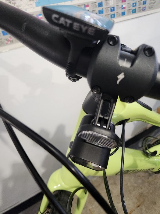

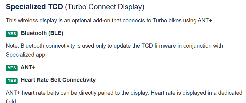

The Cat Eye is just a basic computer. She mainly wants to see speed and distance.
When buying the bike I did not realize the Specialized unit integrated with the bike.
This is one question I had planned to ask. Is the Specialized Wireless unit worth buying if she only wants to track basic info?
At the very least it would be nice to get rid of the sensor on the front fork and the spoke magnet.
The proper simple unit is the Specialized TCD (wireless):
You install the Turbo Connect Display in a Garmin handlebar (or stem) mount. It is a button battery operated device. You get the Speed, Distance Ridden, Odometer, Rider's Power, Cadence, Battery %, assistance mode and other parameters directly from the e-bike (no external sensors are necessary).
GPS bike computers such as Garmin Edge or Wahoo ELEMNT also connect to Specialized e-bikes, and ensure e-bike display, GPS navigation and ride recording but are a way more expensive.
(Specialized Wireless is an outdated device for non e-bikes).
Not sure- don't think so. As the Vado SL comes with the inbuilt wedge I only used it as a rack mount. If I remember at the time I ordered this one because it wasn't a seat mount rather than both. The problem was most mounts I could see were combination seat clamp and rack mount & I only needed the rack mount. This Salsa one at the time (2020) was the only one I could find.
Saw this video in post # 1,576 for a Specialized seat post clamp with rack attachment. It's 30.6 mm instead of the OEM 30.8 size for the Turbo Vado SL 4.0 step through.
