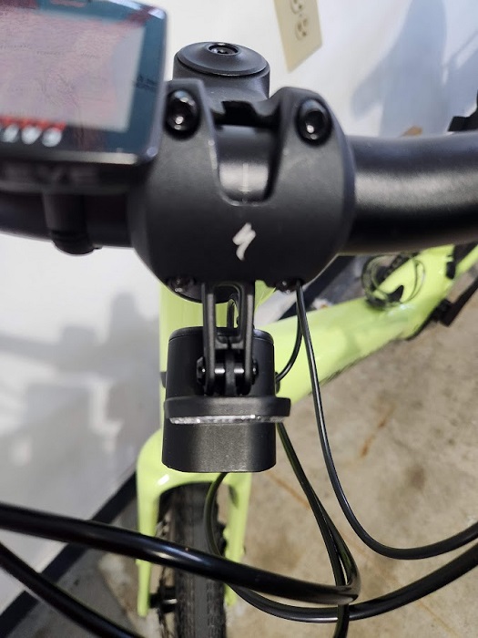

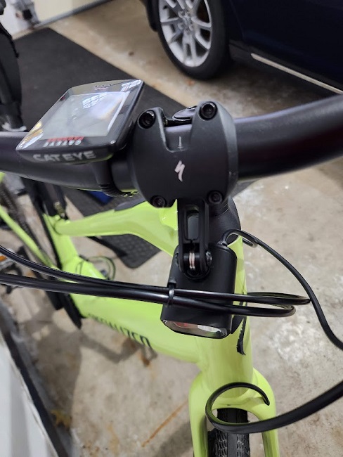

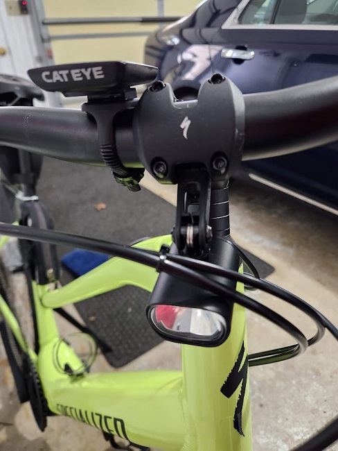

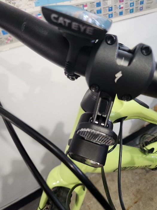

My wife recently purchased a Turbo Vado SL 4.0 and it also has the front reflector mounted on top of the light. It didn't make sense to have a reflector on top of a light and went to remove it.
It appears if I remove the reflector the mount will not hold the light tight. Decided to leave it. With a hex key I did snug up the light and reflector. Both were loose.

I removed the reflector. The nylon washers I planned to use as a spacer was slightly too thick so I used 2 stainless washers.
One of the fasteners that holds the light has external threads that thread into a barrel fastener on the other side that has internal threads.

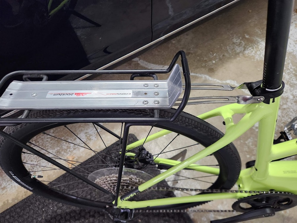

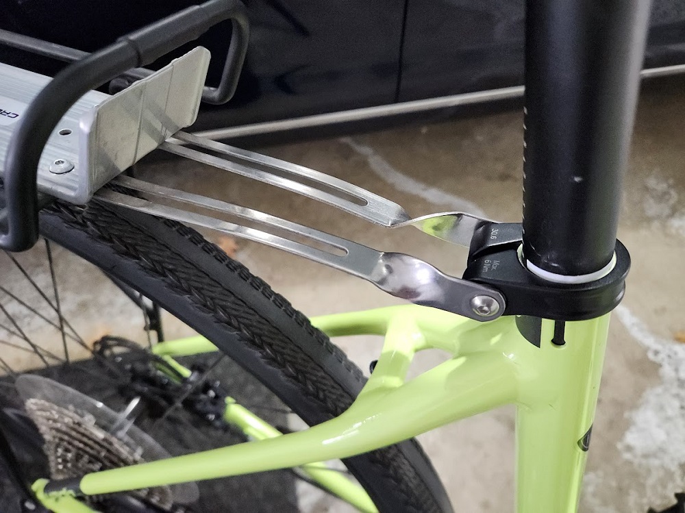

Saw this video in post # 1,576 for a Specialized seat post clamp with rack attachment. It's 30.6 mm instead of the OEM 30.8 size for the Turbo Vado SL 4.0 step through.
We were in Des Moines yesterday so we stopped in at a bicycle shop that handles Specialized.
I bought one of the Specialized seat post clamps that has the attachment spots for the forward rack mount.
The clamp on Deb's bike shows 30.8 mm and the Specialized clamp showed 30.6.
The shop manager took a seat off a Vado SL 4.0 and made sure the clamp would fit.
I was impressed he took time to check that for me since we're from out of town.

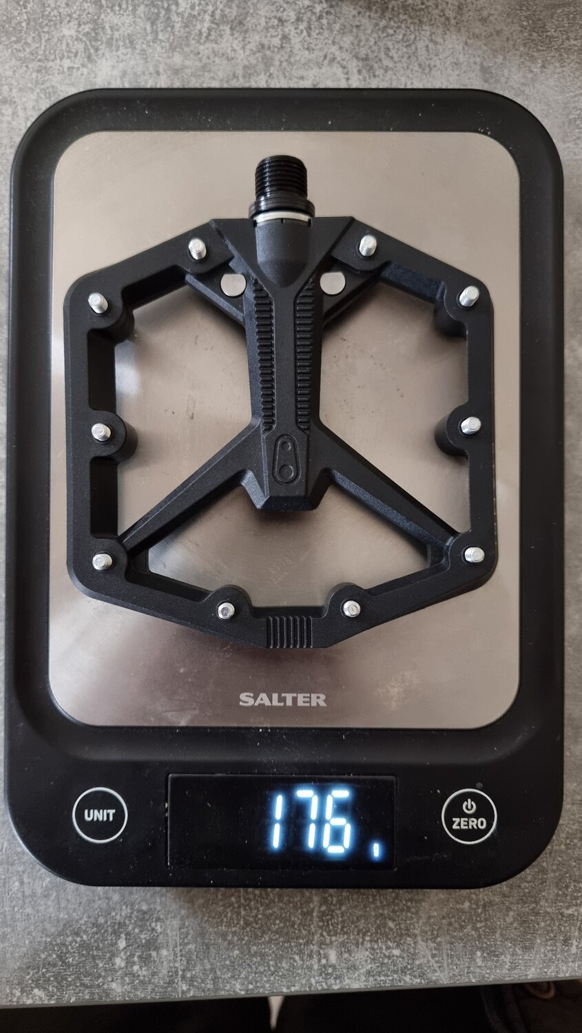

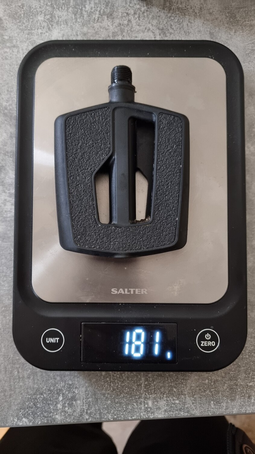

Crankbrothers Stamp 1 Gen 2 (Large) pedals compared to the original Vado SL pedals.
View attachment 185510View attachment 185511
I might try a pair of those for my Hybrid.

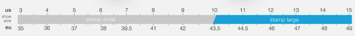

I wear size 11. Would I be better off with the small or large?
My sandals measure 4 inches across where the cleat would go.
My shoes measure 4.25 inches across where the cleat would go.
I suggest the size Large. A lot of feet positions are available. (My shoe size is U.S. 12, and I always had Stamp L).

Yep as mentioned above by Stefan the large pedals should suit you fine. I'm about the same size as you (UK 10.5 = US 11.5), and they felt good, with loads of grip, no complaints. :)
This is the size guide on their website.

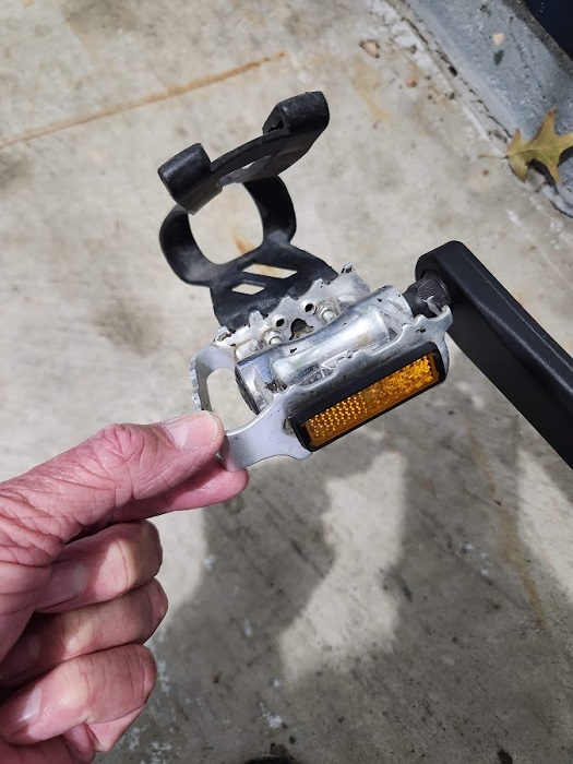

The Vado SL delivery pedals are just place holders. They are only slightly better than test ride pedals. They don't even bother to install them on Creo's because they are the first parts changed. I kept them in the junk parts bin when I had a Vado SL and reinstalled when I sold the bike. I am appalled at the Vado SL 2 reviews that mention the pedals but I assume they are just looking for something to complain about.
Most of our bikes over the years came without pedals. When I tried Debbie's Vado SL my feet would slid off the pedals so I replaced them with pedals from one of our old bikes.
These grip better.

Yeah, I'm impressed with them! I paid just £48 and I feel they are great value at that price. They have virtually all the goodness of the more expensive Stamp 7 pedals but at a third of the price. Plus they're about 25g lighter too! Composite vs Aluminium. :) My Hope pedals on my Frey cost £130 and there's no noticeable difference. Both are excellent, but these will be my go-to pedals in future.
I like the stock pedals. When they eventually kick back there's less pain than the MTB type. Seem to last.
Stock Specialized pedals are surprisingly similar to VP-831P 😊 These cost £31, so are not completely free. Good pedals indeed. However, anyone who has tried Stamps has never gone back to regular pedals like VPs.
