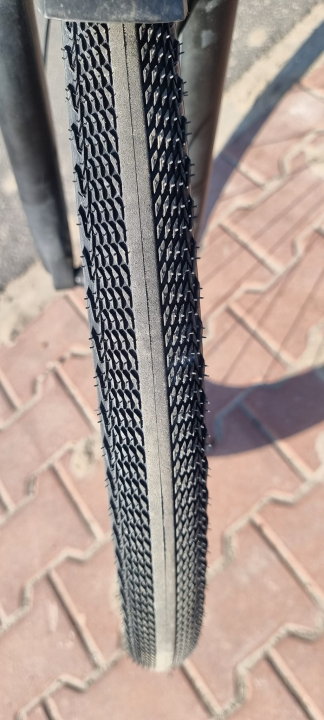

As a follow-up to my post about my changes for 2024, the bike -- good enough last year -- now rides like a (silent) dream! It's even smoother than before with the wider tires at a lower pressure, and between the FutureShock and the Redshift only the worst of bumps come through at all. I've not ridden as many gravel roads as I had originally thought I would but I'm planning on trying it out sometime soon to see how it does. There's a local "gravel grinders" group that rides them regularly but they're also a bit more "hardcore" than I feel comfortable with -- I'd need a eMTB to keep up!

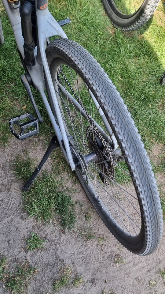

I had a chance to try my new Specialized Tracer Pro 2Bliss 42-622 tyres (tubeless setup at 2.8 bar/40 psi) in a sandy terrain! These tyres are excellent! It was the first time I could ride my Fearless through the sand with no fear!
Dusty a litte bit :)
While you have the fenders off you might try the Tracer Pro in 47mm width. You'll be even more "fearless" off tarmac! :D
I'm afraid such a wide tyre would not fit? Whatever, I'm glad with the performance of the 42 mm tyre off-road indeed.
Thank you for the suggestion though!
P.S. I use SKS temporary fenders so no way! 😊

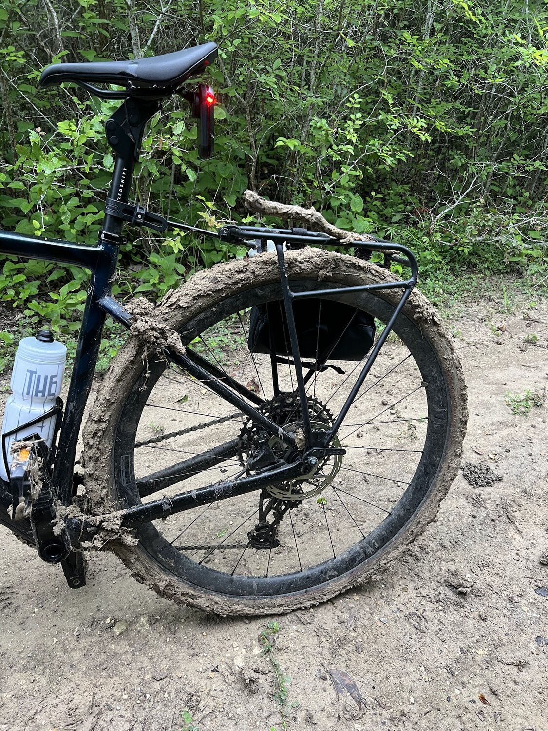

-Pathfinder Pro 42 tubeless in clay. The bike seized up completely once enough got jammed in there, but the tires didn't slip much before that.
-Ortlieb quick rack with mud scraping stick
