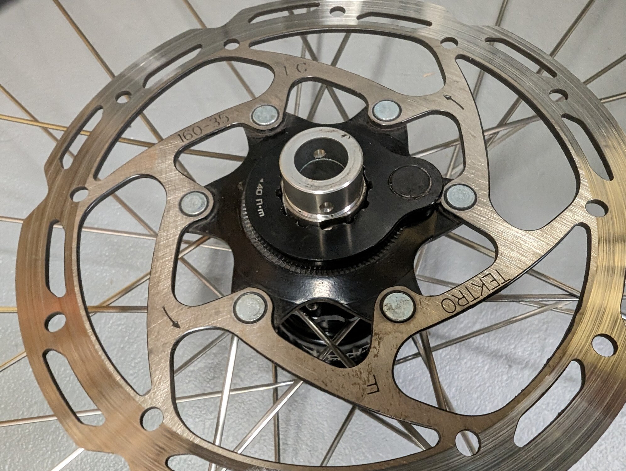

Remember to move the magnet to the rear wheel when you have installed the brake rotor!
Easy to do since the magnet is integrated with the lockring.
For "extra credit", can you tell me what's "wrong" here that is causing some considerable trouble for me in finishing this job? :confused:

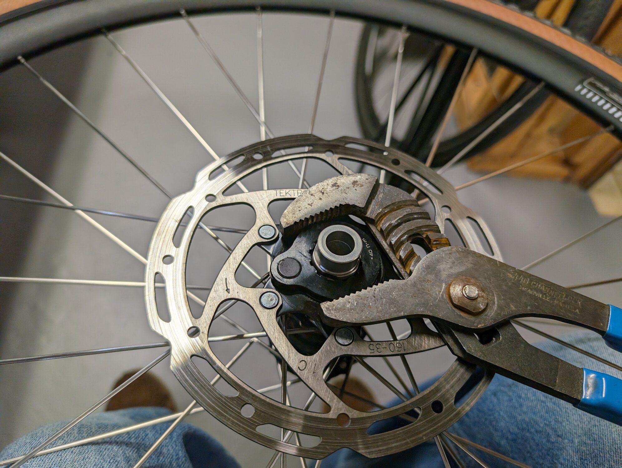

Solution to the lockring problem. I'm very confident that I could tighten it sufficiently this way and probably close to the specified torque.
Everything went well and the new wheels are on the bike with chain installed, etc. I had to re-center the front brake caliper slightly; the rear was OK. I of course also had to adjust the shift cable and found out how critical this is with the close spacing of a 12-speed cassette! About a 1/4 turn of the adjuster each way makes a big difference when shifting across all 12 gears. Getting on and off the largest cog smoothly took a few tries, but then I don't think I've ever actually shifted into that gear while riding...

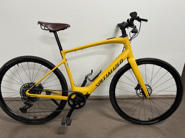

Next Steps To Convert My Vado SL 4 EQ Into A Sporty Gravel Bike
