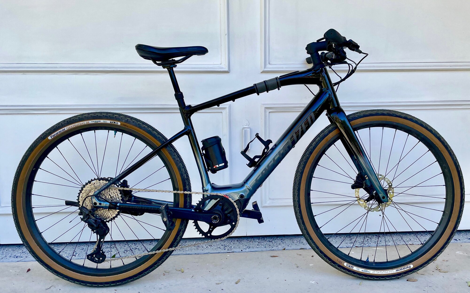

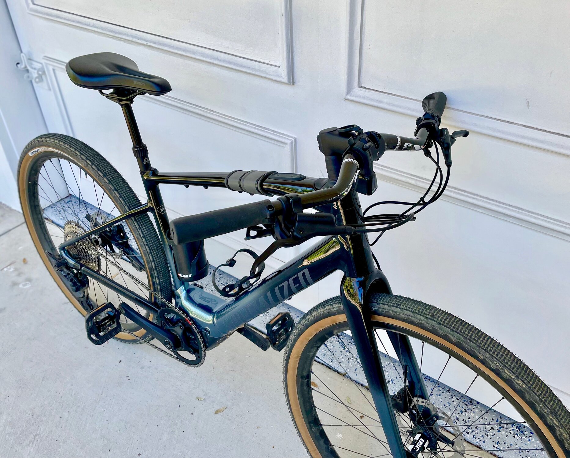

We decided to convert Mrs levity’s Vado SL EQ to a GQ, i.e. make it a gravel bike “fit for a Queen”.
We used bits we’d saved from her previously modified Vado 6 and Creo to customize a new Medium sized SL:
EQ parts: Remove the lights and fenders since we’re fair weather riders in southern California. Keep the kickstand, it rocks!
Handlebars: Replace the OEM bars with Answer carbon 20/20 bars (20mm rise and 20° sweep for hand and wrist comfort). Bars were shortened to 700mm wide, but are 20mm wider than the OEM bars providing more control leverage.
Handlebar height: Lower the bars to a more aggressive position by flipping the stem down and inverting the bars to give a further 20mm drop. This put the grips level with the seat. Removing the stem spacers and using the 15mm shorter “duckbill” topcap was not enough. A pad was installed on the top tube in case the lower handlebar controls hit during a crash.
Dropper post: PNW 90mm dropper internally routed with Wolftooth bar remote.
Wheels: Light Bicycle carbon rims, i30mm, DT Swiss 350 hubs.
Tires: Panaracer GravelKing SK 27.5 x 1.9. These measure 53mm (almost 2.1”) at 30psi on the i30 rims and have plenty of clearance in the fork, seatstays, and chainstays.
Seat: Ergon Core Prime for the ultimate in comfort.
Some beauty shots -
and enjoying it in the real world -
The larger tires provide great traction and extra cushion.
Warning: the wide, low bars and low bottom bracket invite hooliganism! ;)

Ok, here are some approximate measurements of the pedal spindle height on mrs levity’s SL, my SL, and a Creo (all with 172,5 crank arms):
Vado SL with 27.5 x 1.9” (actually 2.1”) tires: 105mm
Vado SL with 700 x 47mm tires: 123mm (estimate ~3mm higher than with 700x38 tires)
Creo EVO with 700 x 38mm tires:102mm
So if the stock Vado SL pedal height with 700x38 tires is about 120mm then switching to 27.5x2.0 tires you can expect to lower the pedals by roughly 15mm. Still, the pedals on a Vado SL with 27.5 wheels will be similar to or slightly higher than a standard production Creo with 700 wheels.
We initially thought Mrs levity might want to switch to 165mm cranks (Praxis sells them). However, she has found that this doesn’t seem necessary. Bear in mind that she has good bike handling and cornering skills (as well as a lot of experience avoiding pedal strikes riding mountain bikes!). Specialized cannot assume this will be the case for all target Vado SL riders and for this reason may be reluctant to recommend switching to a smaller wheel size.
