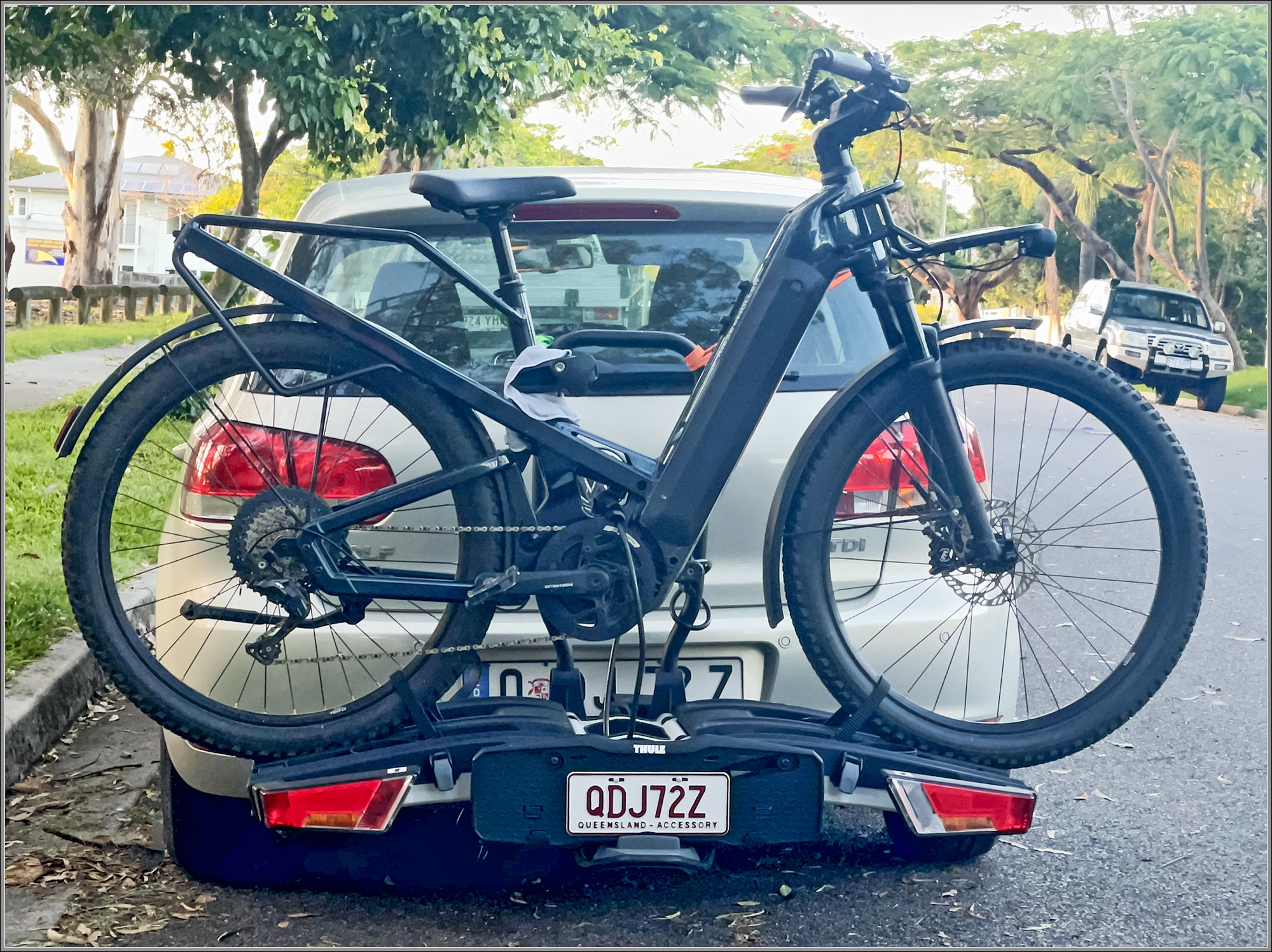

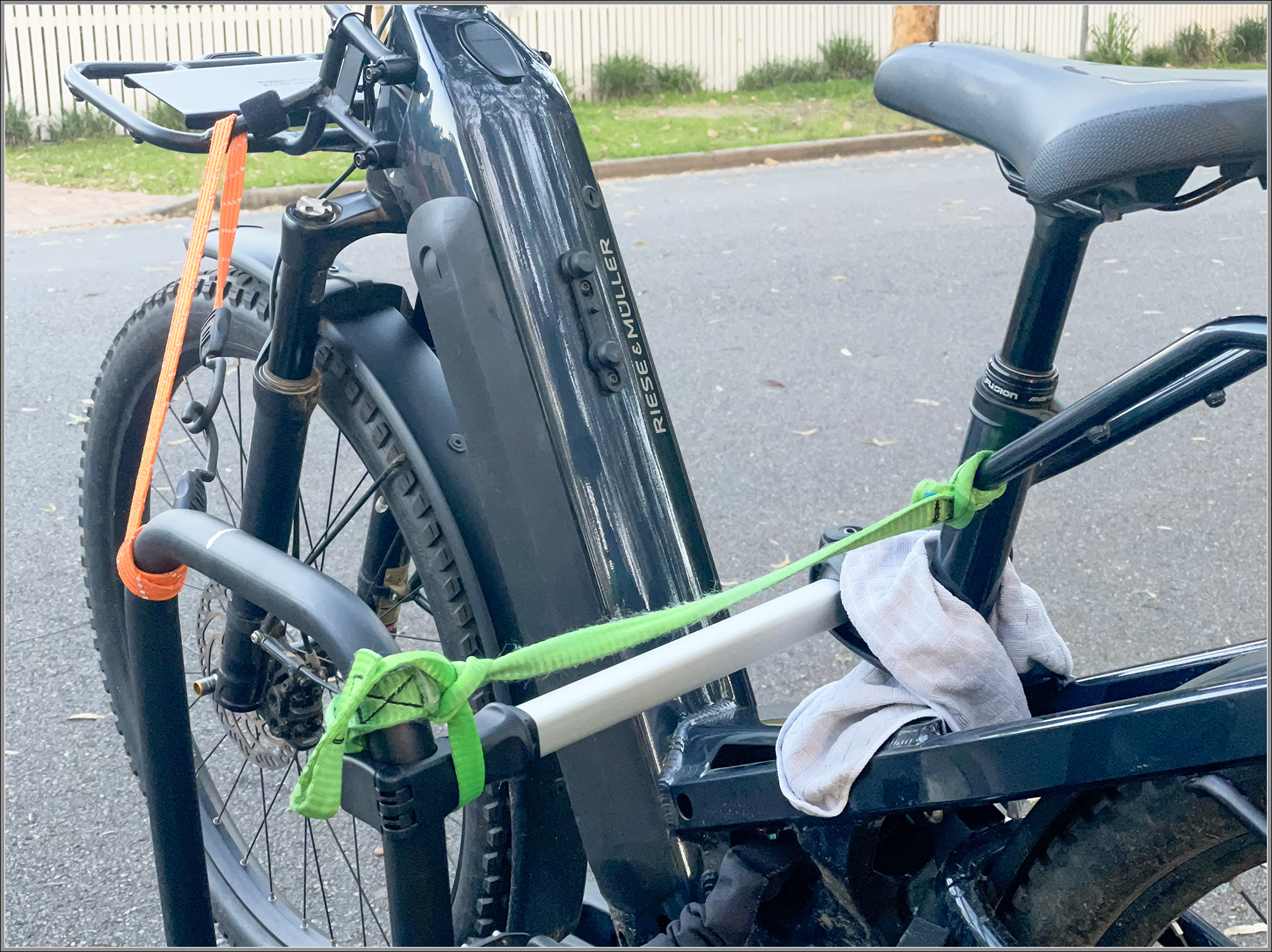

Homage + Thule Velospace Carrier…
Riese & Müller Homage & Thule Velospace 3-bike carrier
The Homage is not the easiest ebike to carry on a car rack. Here's my solution using a foldable towball-mounted Thule Velospace 3-bike carrier. Despite being a long ebike, the Homage doesn't exceed the car's width as much as my iPhone might suggest!
  • white rag : protection for down tube
  • green strap : for my peace of mind (for example, over traffic-calming humps)
  • 10mm x 1.2m plastic-coated cable with Abus lock (near rear shock valve)
Trivia:
  • double-sided velcro next to orange strap on front carrier (holds brake on ; for example, on trains)
  • Fidlock magnetic water bottle mount on down tube

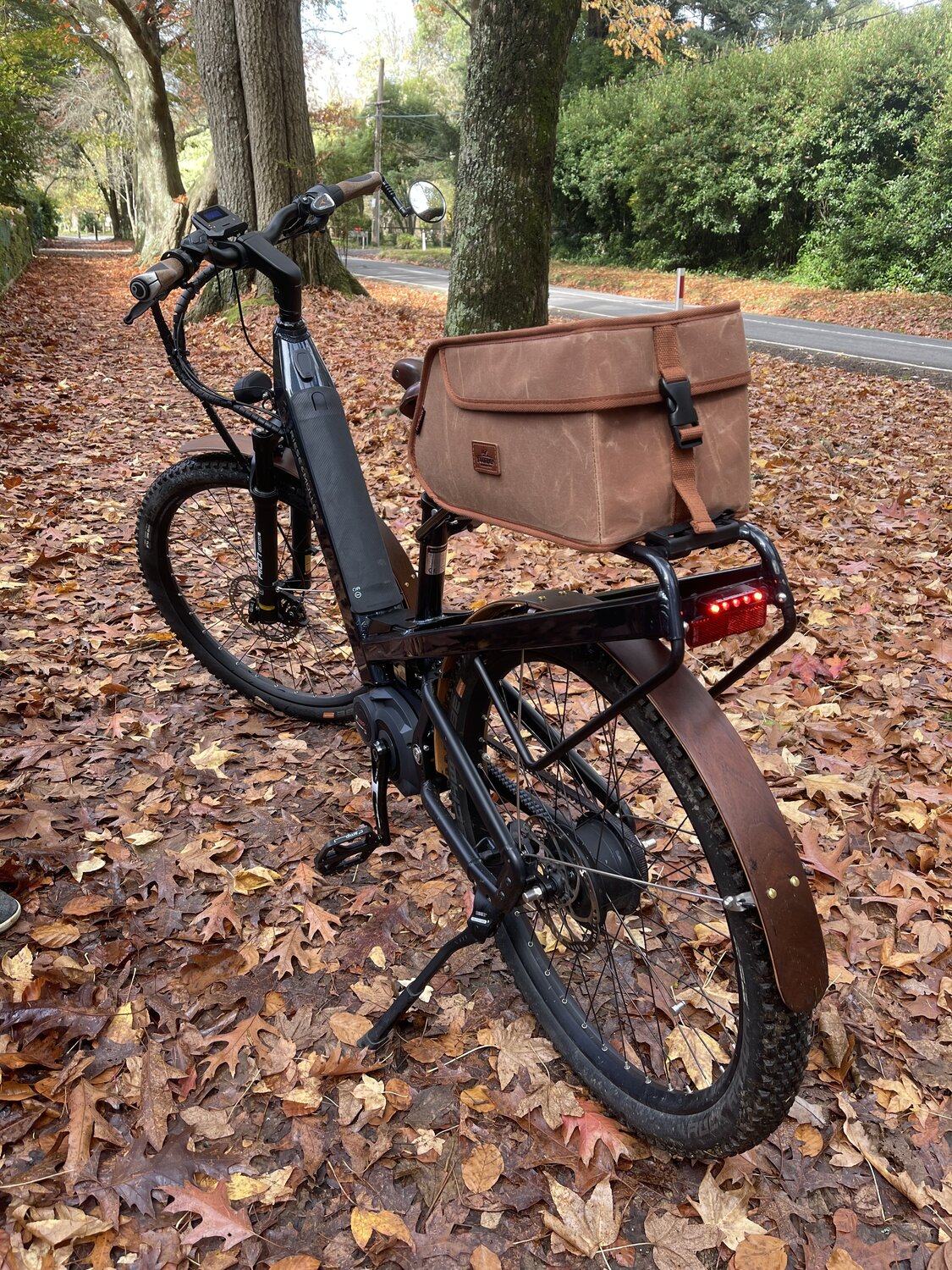

On the subject of bags, here is the one Susie has on her Homage - it’s a cracker! Waxed canvas, large enough for a bottle of champers, and foil lined to keep it cool 😎 The bag is made by Tourbon.
