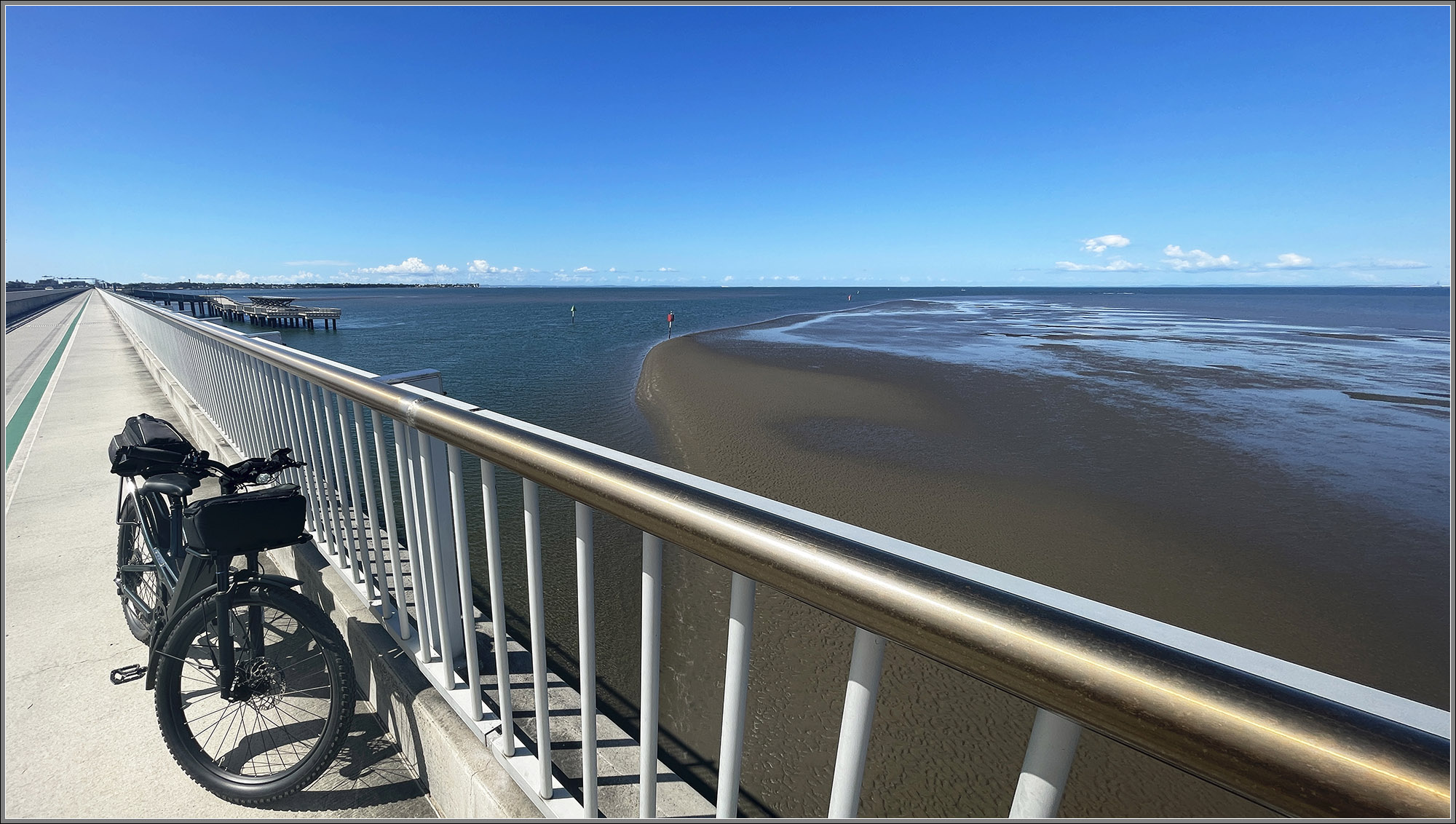

Cheer up, everyone!
Here's my 2021 Homage Touring with Comfort Kit nearing the end of today's 122 km ride. The photo was taken looking across Moreton Bay to the Pacific with Fiji, Hawaii and Vancouver Island 'just over the horizon'.
Ted Smout Memorial Bridge, Moreton Bay
Cheer up, everyone!
And not a worry in the world about the roll-off! :)
