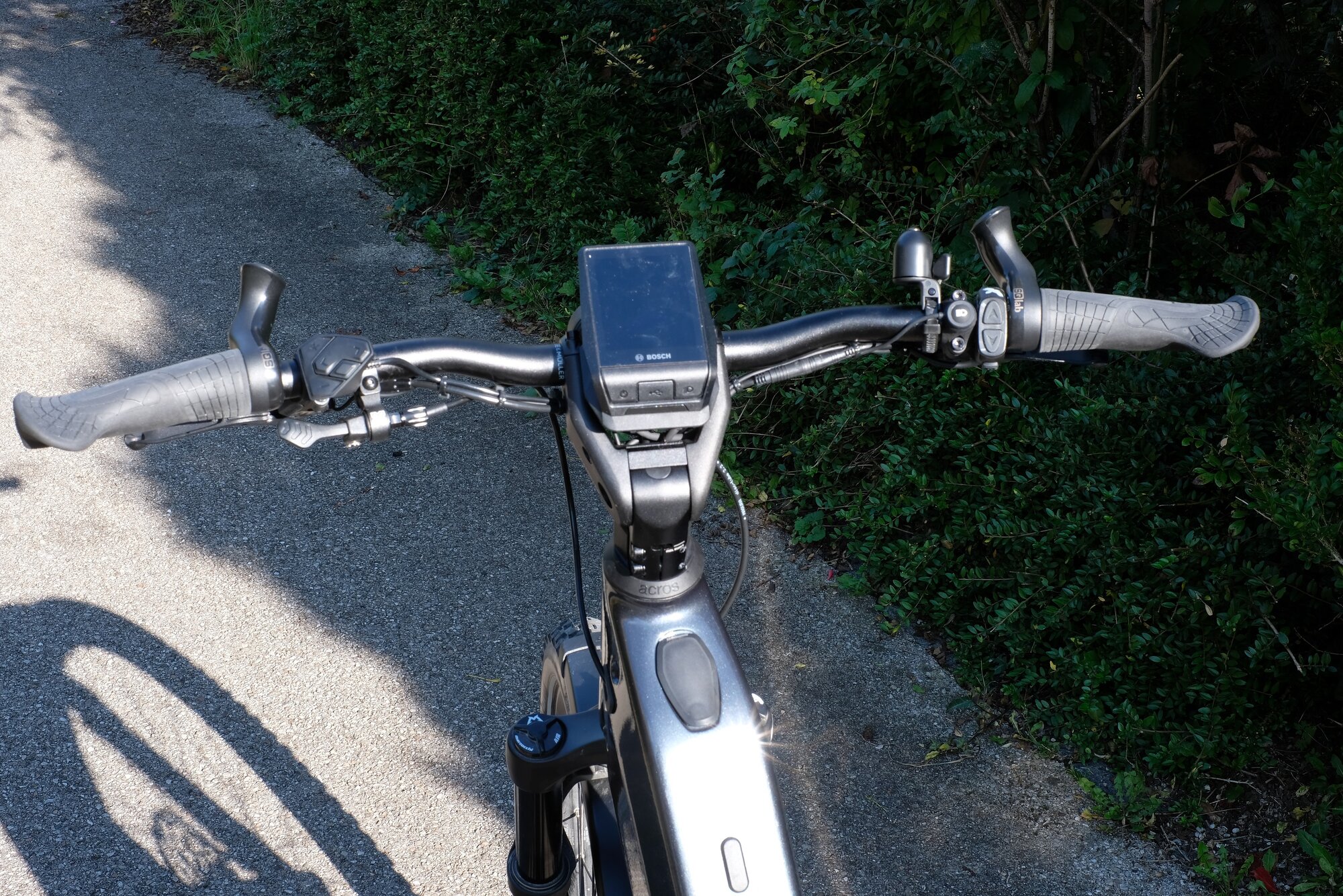

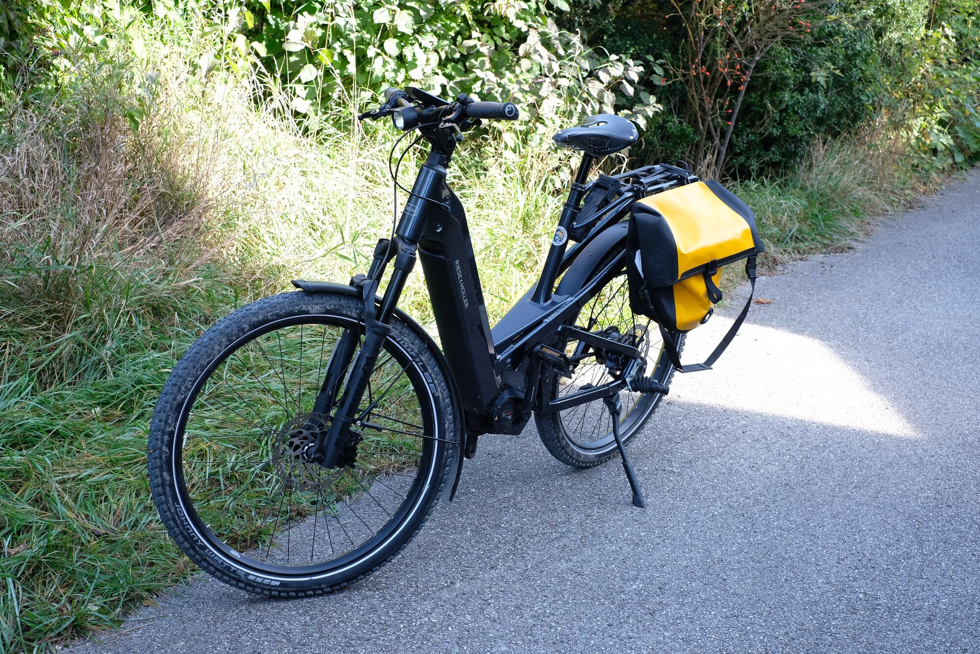

Last Monday I fetched my Homage from the local dealer. On thursday and friday got into my office (around 23 km distance) using that bike. Immediatly it became clear, that some modifications will be meaningful.
  • Saddle: Coming from a recumbent this is a very important issue for me. After 15 min driving the original saddle felt very uncomfortable. For me it was cleart that I never will be happy with this one. Hence I replaced it by a Brooks B17 Imperial. What a difference. On friday going into the office was nearly a pleasure. Going backwards in the evening the saddle felt a little bit hard. But I'm confident this is due to the phase of accomodation. We will see.
  • Stem: For a more relaxed bike feeling I put the stem into a more upright position. As a consequence it was really hard to read the display of the bike computer (nyon), since the angle was too steep. Unfortunately the user manual doesn't give any instruction how to adjust the angle of the computer holder. Fortunately I found some hints in the Web and also my local dealer could help me partially. To make it short: If you loosen the two screws below the front beam a little bit you can change the angle of the holder. You can see the result on the attached picture. Unfortunately the holder ist no more stabilised by the stem after this modification. I contacted R+M regarding this issue. This detail could have been solved better or maybe they already got a solution.
  • Control buttons on the left side: Just look at the first picture. I think this arrangement makes much more sense. Especially usabilty has been improved, which is a very important aspect for me as a software guy. Your can reach every button with your thumb without changing the position of your hand. And the break lever now has the same distance to your hand as on the right side of the handle bar.
  • Handlebar grip: Although I am accustomed to this type of grips I still got some problems with my hands probably because of problems with the blood circulation. Changing the angle of the grips helped but still the problems didn't vanish completely. Maybe the GP3 or the GP4 can improve the situation. But I didn't arrive at a decision regarding this issue yet.
To avoid a false impression. I'm really happy with that bike. It's a great piece of German engineering (as a German I must say this). Every critics is just "Jammern auf hohem Niveau" (whining at a high level) as we say in Germany. On the other hand there is nothing which still can be improved.

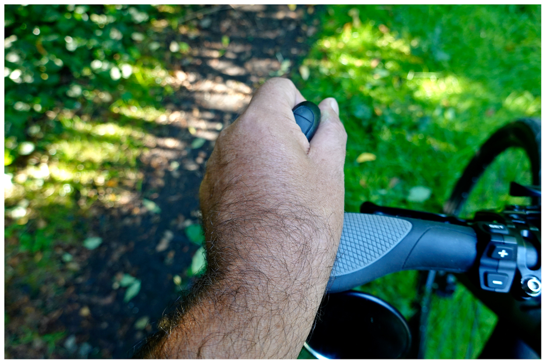

On Wendnesday evening I mounted the new grips and inner bar ends from SQLab on the handle bar. On Thursday I had my first ride with this new configuration. Not perfect but much better. Around 80% of the time I grabbed the handle bar at the inner bar ends. In my eyes also the grips are better in comparison to the original ones from Ergon. The whole grip has got an ergonomic shape, not just the outer part. But fine tuning will still be necessary. At the weekend a will reconfigure the control elements completely. That means greater distance between brakes and grips (very important for optimised break control due to several comments in the web...maybe I will exchange the original levers by the one finger lever HC1 later....nice christmas gift), new bell (trigger bell) will be attached on the left side, seat post control will be moved to the right side,...
When everything is finished I will post a new foto.

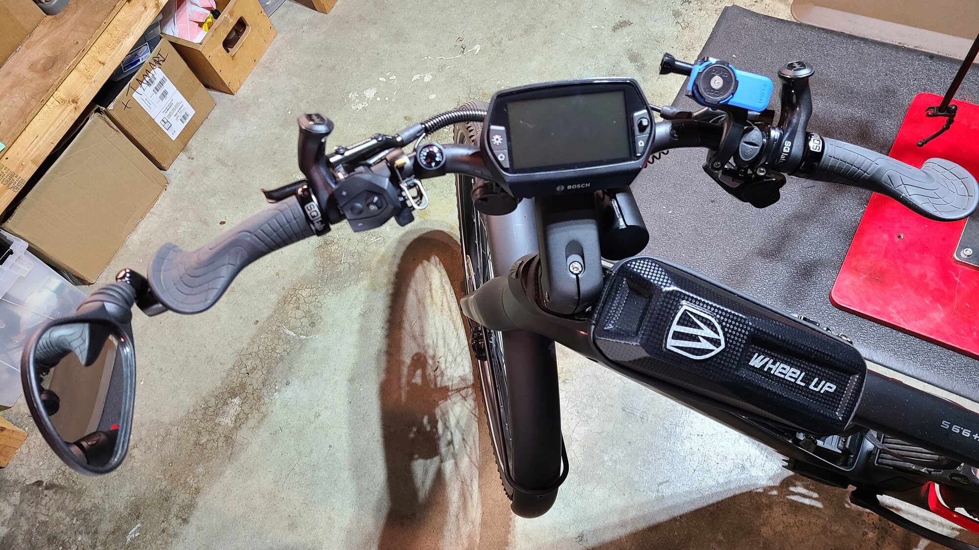

Although I no longer own a Homage, I do have SQ Labs grips with inner bar ends on my Trek Allant 9.9S.
They are definitely a step up from the Ergon GP's in terms of comfort, cushion and hand position. The broad part of the grip where the heel of the hand lives has more flex, with just the right amount of firmness, making them considerably more compliant/impact absorbing.
The inner bar ends provide a useful alternative hand and wrist position the helps resolve tingling and numbness on longer rides, while still being able to activate the brakes. Shifting the Sram AXS wireless shifter does require returning the right hand to the grip.
I did have to drill out the left grip in order to inset the Busch & Muller 701 mirror, which I consider to be the best made, most useful bike mirror by far.

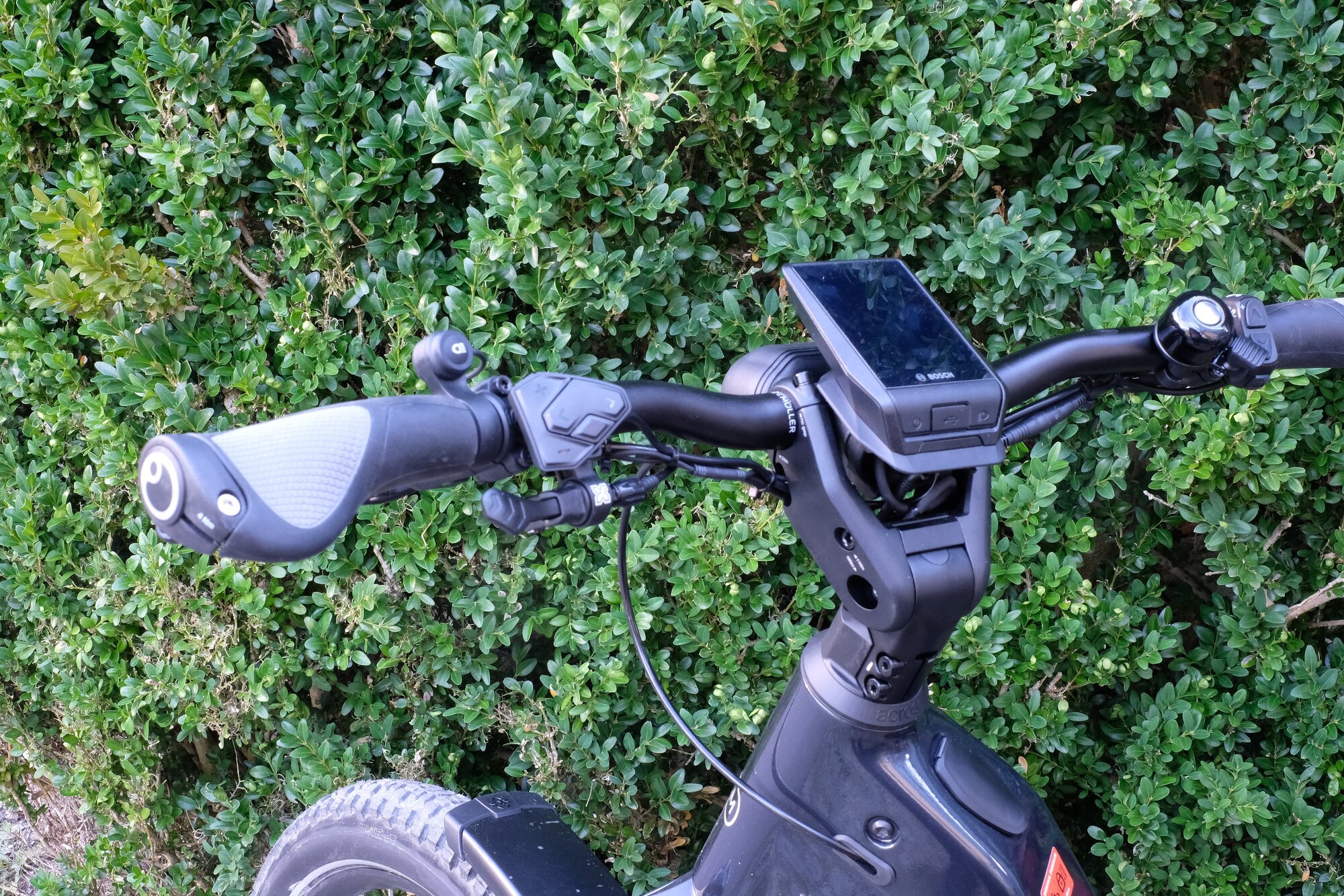

I see, I'm not the only one who appreciates the SQLab grips and inner bar ends. This evening I optimised my configuration. But I had to step back from my original plans regarding several issues. The lever for the seat post can't be moved to the left side due to its construction. And there doesn't exist a right side variant. (The same with other seat post manufacturers.) As a consequence mounting the bell on the left side is also not possible due to lack of space. Putting the motor control panel on the left side of the brake lever to get it closer to the grip isn't an option too. That way the panel would get in conflict with the inner bar ends (the mounting ring ist very thick) or if not the distance between the brake lever and the grip would become too far. Replacing the brake lever is also nonsense. This original lever is the only one from magura which has got a cable for the brake light.
In spite of all these setbacks I think I could improve the cockpit situation once again:
  • More comfort for the hands/arms/shoulders. Crucial are the inner bar ends. Like Alaskan I also prefer the SQLab grips to the Ergons due to their excellent ergonomic shape. But as you can see at the picture of Alaskan, he mounted the barends beside of the clamps of the grips. In contrast I bought these bar ends which replace the original clamps of the grip. As a result my grip/bar end combination needs less space than Alaskans and hence overall accessability of the buttons and levers is better.
  • Position for the seat post lever has been optimised. The lever can be reached by the thumb perfectly.
  • The high beam button now uses the clamp of the right break lever, which serves also as a holder (double function). As a result the reachability and stability of this button has been improved. Removing from the old holder was a little bit difficult since R+M didn't trust the magnetic fixing mechanism and sticked the button by double-side-tape into the holder. Some force was necessary to separate holder and button.
  • I exchanged the original bell by the "trigger bell" (mentioned in my previous post), since the orientation of the lever of the new bell is better.
Only the position of the control-pad of the engine could be a little bit closer to the grip. Regarding this issue I opted for a compromise between brake-lever position and control-pad position.
Summarised I think this configuration is now very close to the optimum. Overall accessability of the levers and buttons (and there are a lot of them at an e-bike) and ergonomics could be significantly improved. Especially the grips combined with the inner bar ends are the best you can currently get on the market due to my opinion.
Alas I replaced the pedals by "half-clickies" since I got already appropriate biking shoes with cleats. (If you are using a recumbent they are obligatory. Hence I'm accustomed to the usage of click pedals.)
Next Monday I will go to office by bike again. Then I can report, how all these modifications will prove themselves in reality.

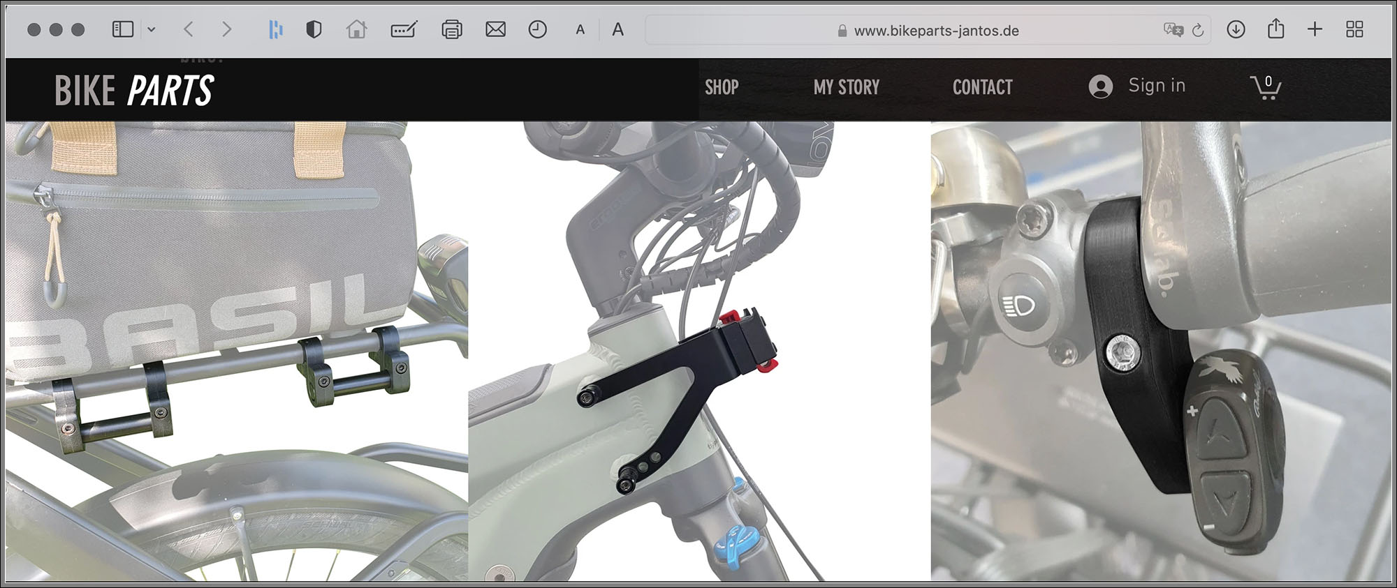

Bikeparts-jantos.de …
Bikeparts-jantos.de could be the place for frustrated, but otherwise enthusiastic R&M ebike owners, to source problem-solving bits and pieces!
Most of us will need to turn on our web browsers' German—English auto-translators.
