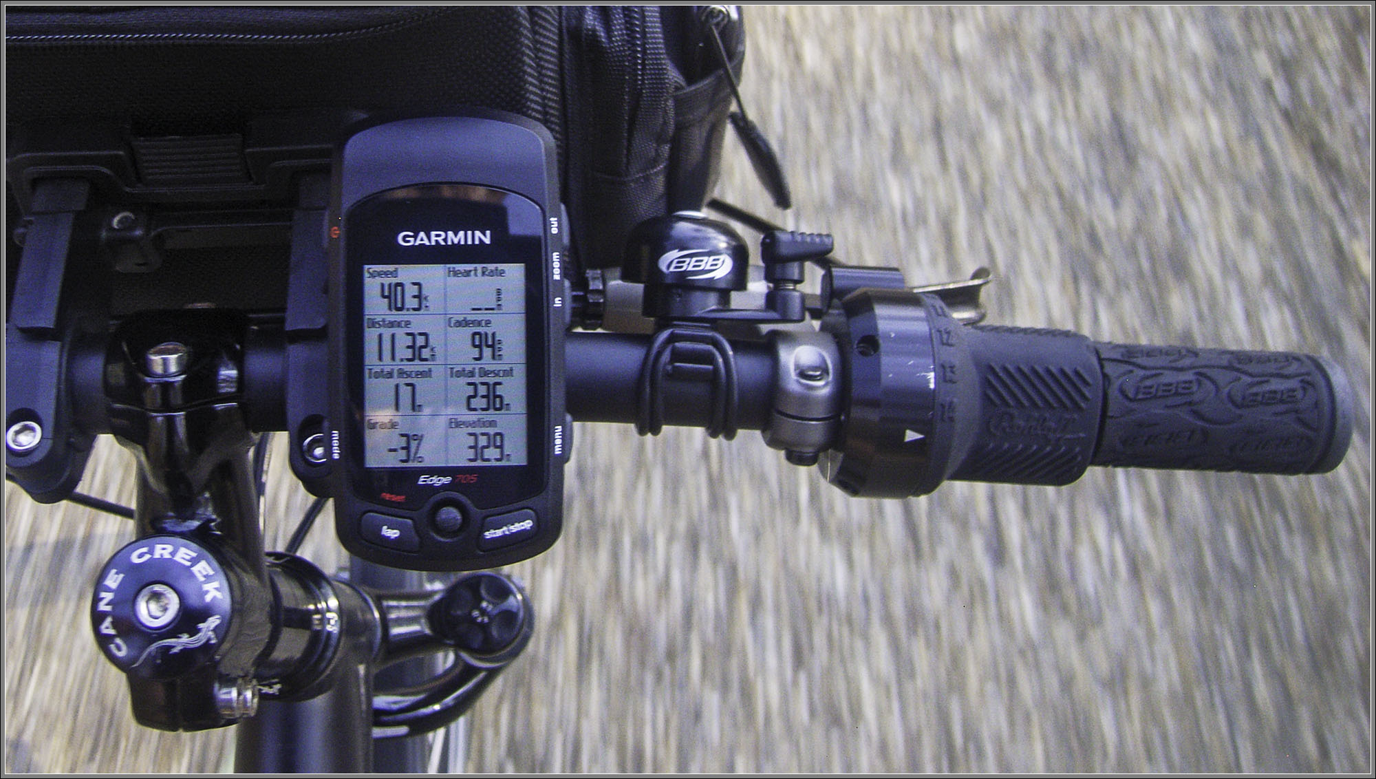

For me, any shifting disadvantage that the E-14 might have is offset by not having an uncomfortable 'cotton reel' as part of my right-hand grip. On my old non-electric folding bike (Airnimal Black Rhino Rohloff) my right hand, between thumb and first finger, was uncomfortable for 100% of the time (excluding the time spent taking this photo!). I later changed the grip to a Rohloff-specific Ergon grip, but the basic problem remained.

Of passing interest (so he says as he takes a swipe at the hornets' nest), note the speed (40 km/h), cadence (94 – too high to be sustainable) and gear (#14 – highest).
Unfortunately, this is typical of Rohloff-equipped bikes/ebikes: an emphasis on extraordinarily low gearing rather than 'a bit higher and a bit lower' than everyone else. I've never genuinely needed #1 or #2 gear on my Homage Rohloff (of course, I've used them!).

Of passing interest, note the speed (40 km/h), cadence (94 – too high to be sustainable) and gear (#14 – highest). Unfortunately, this is typical of Rohloff-equipped bikes/ebikes: an emphasis on extraordinarily low gearing rather than 'a bit higher and a bit lower' than everyone else. I've never genuinely needed #1 or #2 gear on my Homage Rohloff (of course, I've used them!).
