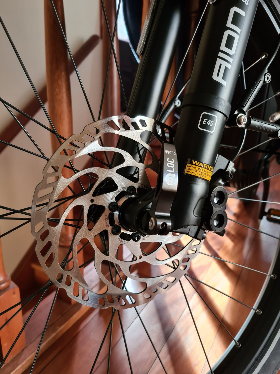

After ordering my dual battery Rohloff Homage (Kiox, comfort pack, dropper post, front rack) in early September, I eventually received it on 18 May and it has completed 320km. It replaces the 2019 Nevo Vario and will be used as my everyday bike around the city and for day rides and bike touring. (Having discovered that the weight and Super Moto-X tyres of the Nevo were not compatible with loose gravel on steep terrain, I have a Focus Thron2 6.8 EMTB for more serious off-road riding.)
With the front rack fitted, the dual battery Homage is no lightweight at 35.7kg (my estimate). I normally ride in Sport mode with occasional Turbo for the steeper hills. This allows a steady cadence and power output without stressing my arthritic knee and hip. The comfort pack was a great choice and the saddle has worked best angled slightly backwards. At 175cm tall on the 49cm frame, I have the seat pushed back.
A problem solved
The Kiox computer was not charging properly on the bike resulting in a low battery warning for the device. Other computers were tried but the problem remained, thus indicating an issue with the cradle. The bike shop adjusted the cradle and the computer now snaps into place with an audible click, ensuring good electrical connections. (Does your Kiox snap and click?)
A problem still to be fixed
The rear shock has failed. The bike shop disassembled the shock and concluded that the small hole between the air chambers was becoming blocked. To test the bike after the shop had put it back together, I went for a ride yesterday but, at an 18km coffee stop, I noticed that the shock had again failed and the rear wheel was riding far too high.
Using the train for part of the return trip, I checked the rear wheel height when I arrived home and it had returned to its original height. Go figure.
Riese and Müller have agreed to send a replacement rear shock. Let's hope that they do so promptly by taking one from existing stock!
PS That is not dodgy paintwork in the second photo but the effect of sunlight on protective plastic film.
