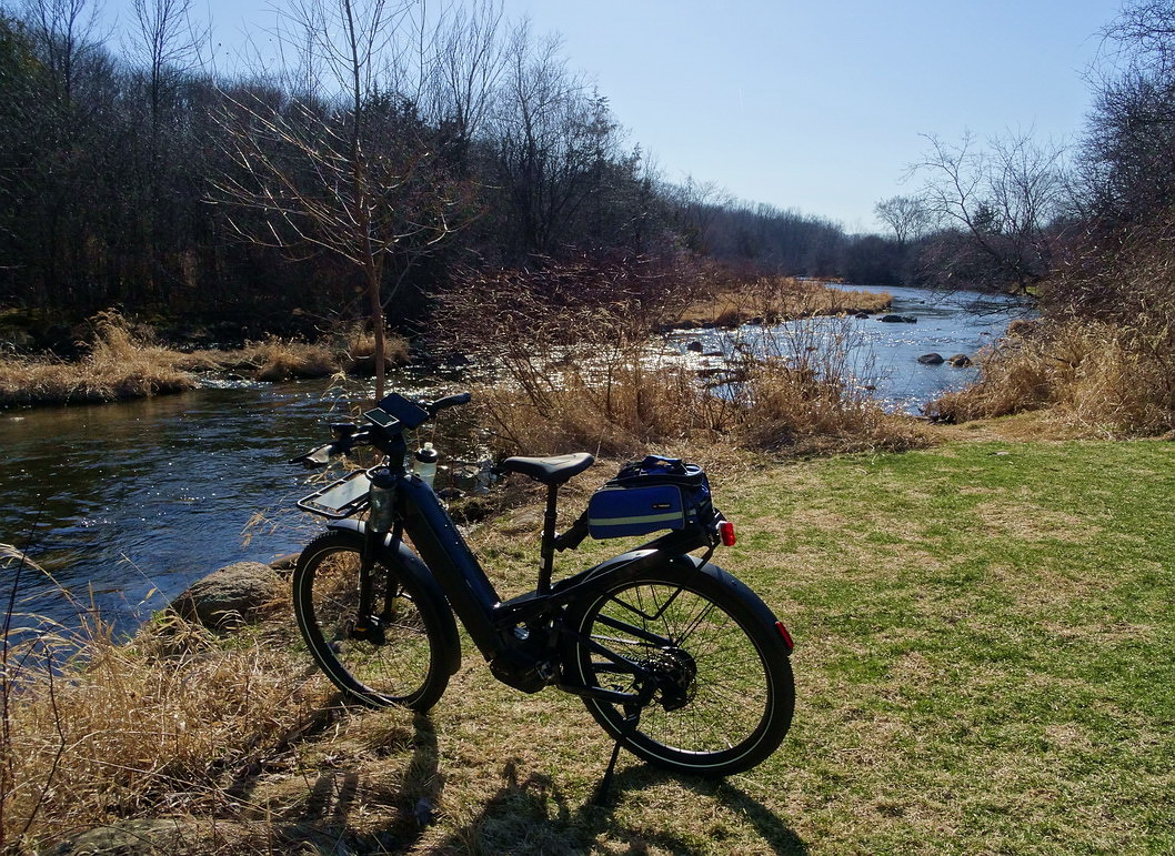

Took the new bike out for the first decently long ride in SE Wisconsin back roads on Monday.
Left the house with the dual-batteries showing 84%, returned home with 47% showing after using the eMTB mode for most of the ride, and Turbo on several of the bigger/steeper climbs.
Tire pressures before I left were 40psi rear & 36psi front.
Temperature for the ride ranged from around 60F down to 55F by the time I got back home.
Winds were "brisk" at 15-20mph sustained with gusts to 30mph.
When riding in crosswinds, I could definitely feel the bike being pushed sideways and had to lean the bike into them.
With the Bosch Gen4 CX Class-1 motor in eMTB mode the headwinds virtually disappeared. (other than my ears getting cold)
Made a few stops along the way to relax and take some photos of the bike and scenery.
The blue is a VERY deep blue, which shows as virtually black most of the time except in very bright sunlight.

The two shots above were at an old rock quarry which flooded when they dug too deeply.
The big iron thing in the second shot is an old rock crusher.

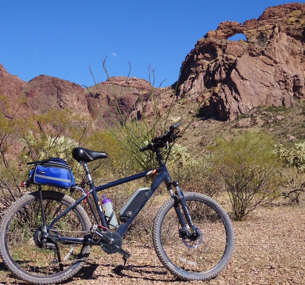

My previous (and first) e-bike is a Raleigh Talus with a 250 watt & 60N-m rear hub motor and torque sensing, with a maximum assist level of 100% in Turbo mode.
The new Homage offers 85N-m of torque and up to 340% boost in Turbo, or variable 140-340% assistance while in eMTB mode which is where I leave it most of the time.
Even in just the second assist level (Tour) the Bosch motor is giving 140% boost, which is more than the Raleigh offers when cranked all the way up.
Not to mention the fact that the power is being produced by the Homage is at the crank, which benefits from gearing reduction for additional torque at the rear wheel when climbing the numerous hills here in southeast Wisconsin.
