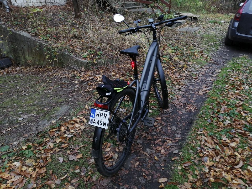

I found the two outer layers are enough for 34 F. I had a 2x2 mile ride to the local LBS (to extend the stem in Vado and to install the registration plate); and to an insurance agent to finish the rest of matters following the registration of the S-Pedelec. I did not suffer at all. A longer ride might require three layers, as it was yesterday.
The top jacket is Softshell, the outer pants and overshoes are of Gore-tex. Inner layers are most probably made of Neoprene or I don't know of what...
So do you get insurance coverage for theft when you register the bike?
Nay, that's the Third Party Liability Insurance. You need to buy it if you want to ride the L1e-B (Class 3) e-bike in Europe.
There were quite funny things during both registration and insurance processes. The law clearly states that "A moped is an internal combustion engine vehicle that is limited to 50 cc and the maximum speed is 45 km/h or an electric vehicle with maximum assistance power of 4 kW in which assistance is gradually reduced to zero when the speed approaches 45 km/h", etc. Yet the Road Transportation Department officer had a hard time to skip the "cylinder capacity", find the "type of fuel" that was "Electric Energy EE", and so on. Finally, I got the registration plate and the registration itself.
Then, I went in local insurance agent office. The agent asked me what "fuel type" and "cylinder capacity" it was. The software was not capable to accept any electric moped. She had to write to the head office for an acceptance. Luckily enough, the acceptance came after a phone talk and 20 minutes of waiting... They are not prepared here in Poland yet.

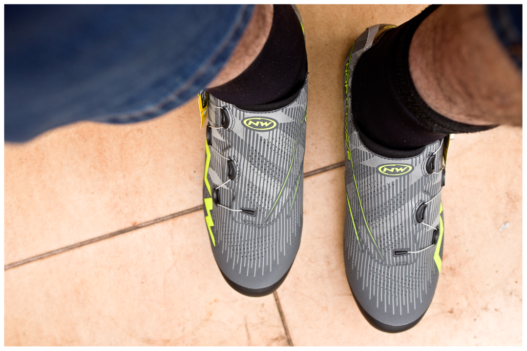

Friends,
I strongly warn you against the Northwave Flash/Raptor Arctic GTX winter cycling shoes. The design is wrong and sizes are wrong. Note: Flash are for road bikes and Raptor are for SPD/MTB.
The shoe has an internal Gore-tex membrane, which serves as a sock. First of all, the sock cuff is far too tight and you'll be fighting to both pull on and pull off the shoe. Secondly and it is even worse, the sizing is completely wrong. As I do not know the US or British shoe sizes, I will only talk the EU sizes:
I normally wear EU size 46. When I bought Raptors size 47, those were totally too small. I returned them and ordered Flashes EU size 49 (the maximum size produced). Before I tried the shoes, I compared them with my leather winter boots size 46. The size 49 NW Arctic GTX were shorter than my size 46 boots! Then I pulled NWs on with a lot of effort and my foot exactly fitted the shoe, no allowance. Even worse, the heel of the Arctic GTX strongly projects behind the shoe top, making pulling the shoe on and off even more awkward.
The Raptors have their soles well made for the winter. The Flashes have a carbon sole which is extremely slippery even at home. BEWARE.
So if you are tempted to get a pair of NW Arctic GTX, start with ordering shoes of 4 sizes larger than you normally wear... Otherwise the Northwave winter shoes are very warm, breathable, waterproof, windproof and frost-proof (down to -10 C/14 F). I'm gonna keep them but I am not quite satisfied with them.

Friends,

The Swiss designer at Northwave should be hanged by his own feet. A slippery sole for arctic winter shoes! When the rider steps off his bike, he'd slip even on a summer warm concrete! I'm going to a cobbler with these shoes; good there still are some cobblers around here.

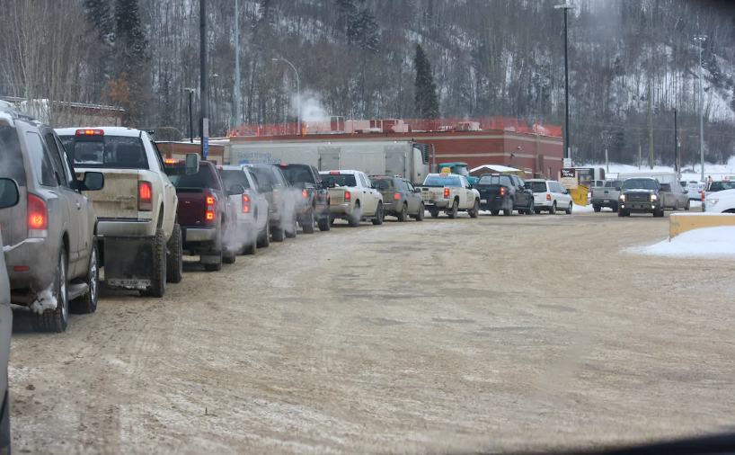

I see more of this (that's a Tim Horton's drive thru they are queued up at).
My winter ebike tip is: Don't over-complicate it. Dress like you are walking to your destination, but with a strong headwind. Add helmet and warmer gloves. If riding a non-electric bike, dress like you are cross country skiing (plus helmet, glasses and gloves).
Ha, I wish! Most of those pics are from Europe.
Yeah, I thought those pics looked not of a Canadian city...I thought possibly Montreal.
Timmy's...they need signed exit lanes on the roadway.
