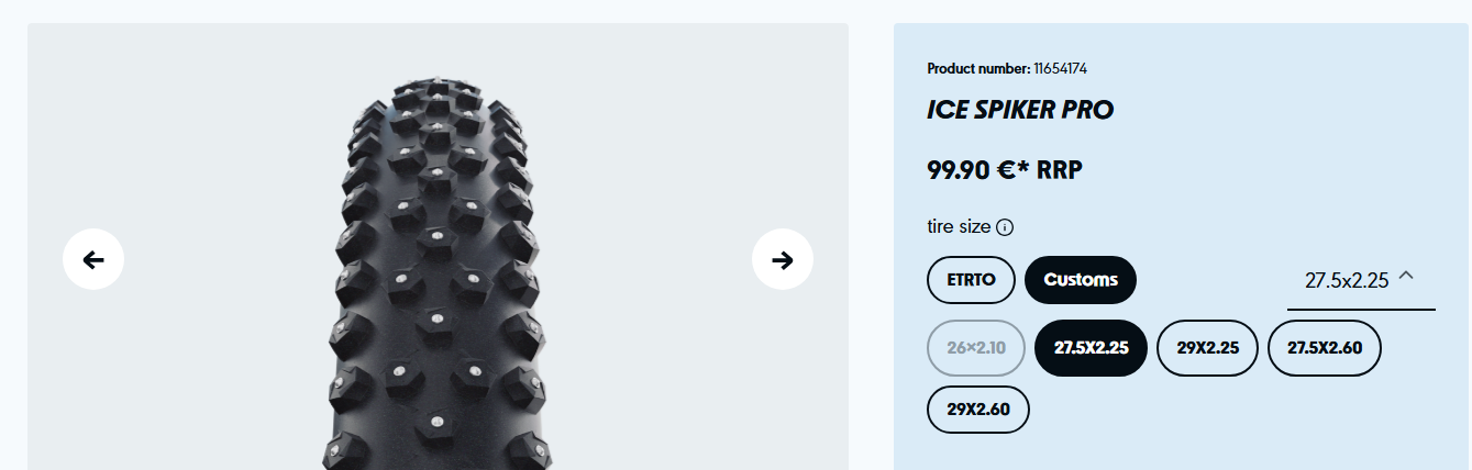

@DrewInSK: Are your wheels 27.5"?
Why not Ice Spiker Pro 27.5x2.25"?
You might say you wouldn't like riding narrower tyres. What I say is 'You won't regret it". Bear in mind these tyres are very special and different to anything regular. The actual contact with the surface is done via the studs only! As you might notice anything else in the tyre is totally slick!
Of course, these tyres will not ride through deep snow but they can be safely ridden on ice (even on a frozen lake), proven!
I regret your wheel size does not allow installing Schwalbe Marathon Winter Plus, which are a way more normal tyres but the traction on ice is excellent, too!
I went wider because as far as ebiking in winter in Saskatoon, fat studded has worked well for me in our most common conditions(though those were 3-4.8" fat tire ebikes at lower pressures). SO I figured I'd roll the dice on 2.6".. I still think this was the right move, though right now at -30C-ish I'm not so motivated to get started just yet. I wear ski pants usually anyway so the dirt isn't a big deal from the rear(plus i'll have partial coverage thanks to my trunk).
I have the 27.5x2.25, they worked great. It's best on ice, thin snow, and packed snow. As long as the studs can make contact with a hard surface, the tires will grip. I feel super confident on my winter commute.

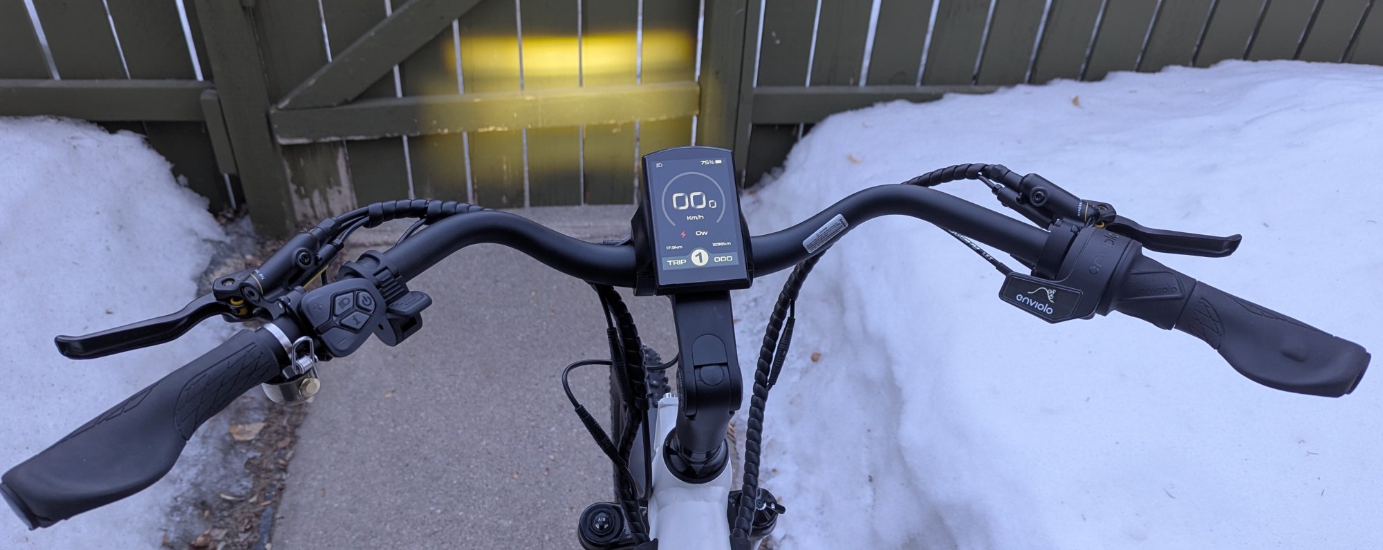

Finally got the upgraded display and had a chance to re-arrange the cockpit to my liking and get it installed. I don't use throttle...ever really(and can still reach in a pinch if I need to), but it's handy for maintenance I suppose. I found the lack of good placement for a bell was really bugging me also. it's ready for a good ride in the snow we're going to get tomorrow. Probably not the last we'll get, either. And then soon the spring riding season will begin. I'm pumped for it, especially now that it's all adjusted just so. No whistles, nothing to interfere with the good times.
@DrewInSK, did you order your new display from Zen? I'm asking because my wife has the older stock display on her Photon and doesn't like it. She finds it hard to read in bright sunlight.
Sure did yeah, it came up in another thread...I think the one for the latest version of the Photon. Reach out to them about it. I haven't put it to the test in full sunlight yet, and I doubt we'll have much today.

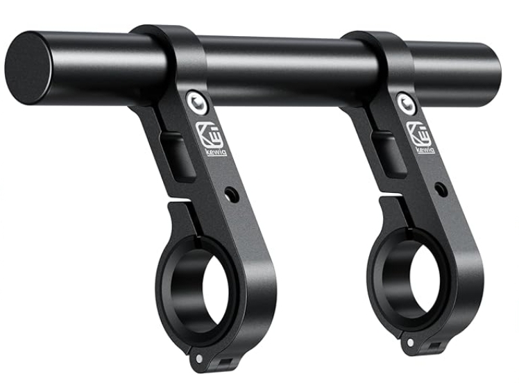

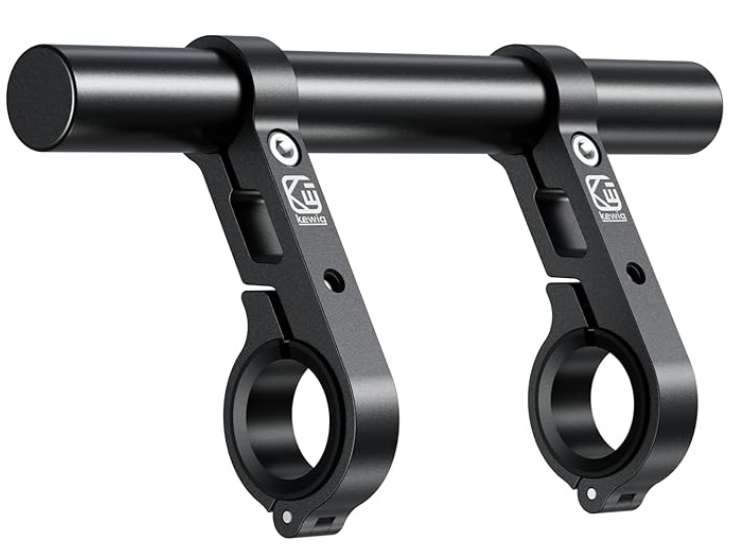

Part of the problem with any display in sun light is having it lay flat as it does over that ridiculous Zen stem. You'll find if you have it mounted more vertically they handle the sun much better.
Mounting the display on something like this makes a world of difference.
Good advice! Thanks for the link action too. I tend only to glance at it anyway for speed and PAS level. My use case was the better cockpit config(and pogies, though the extreme cold has since passed).
