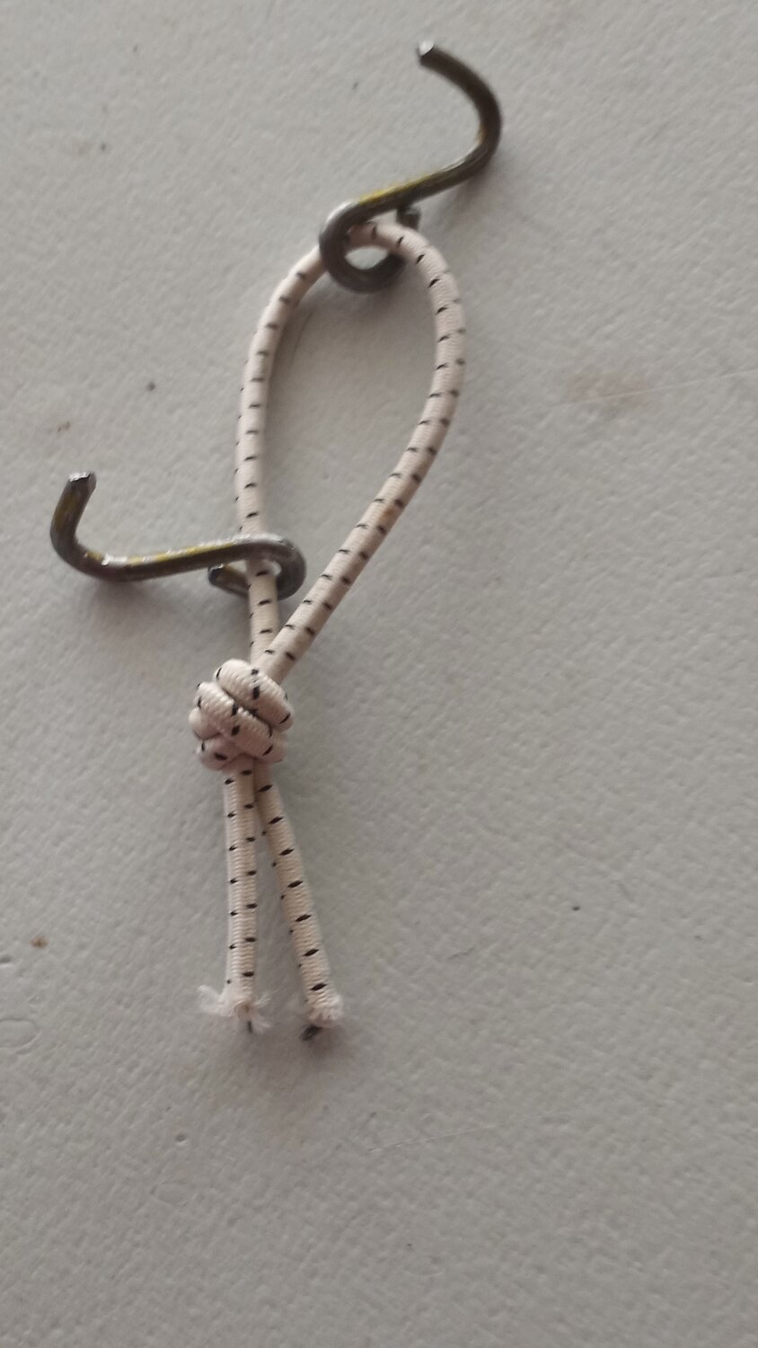

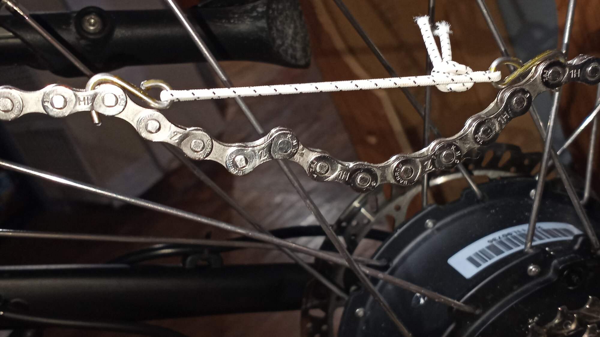

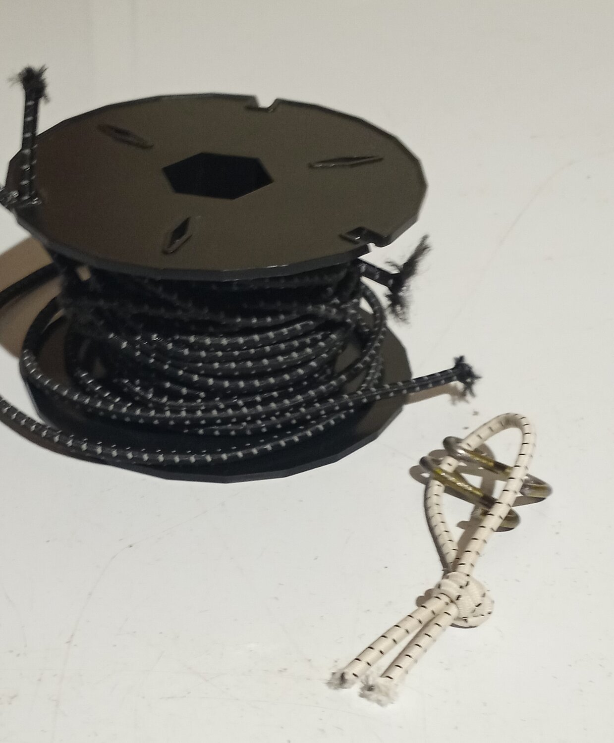

I thought up a hack for you to help install your emergency chain,..
A spring loaded chain tensioner.
I bought a spool of shock cord.
It comes in handy for making stuff.
Ordinary rubber bands are made with crappy rubber that disintegrates and turns to mush.
Shock cord uses chemical proof long lasting rubber.

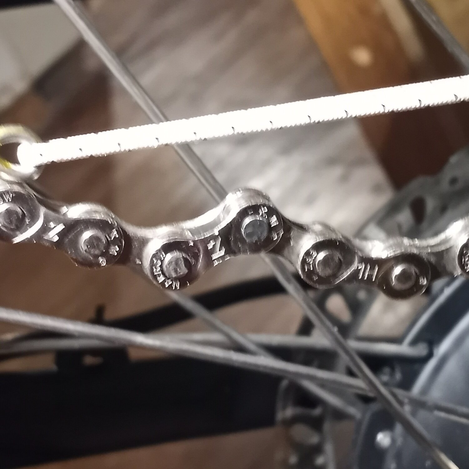

Here it is in action,..

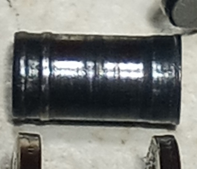

I put that black "master pin" in the middle of the picture.
As you can see, it's binding a little and not draping like the other links.
I realized that I just need to push that black pin out, and the mushroomed pin to the left and simply replace that link with my Missing Link and my chain will be the same length.
I'm keeping the "master pin" though.
It's very special. lol
I can try my new Crank Brothers tool on it for practice.

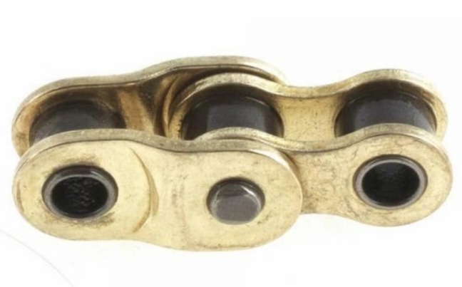

I don't think a half link will work for you?
I think that you'll end up with two skinny slots in a row and you need to alternate them?
EDIT: I found this picture of a half link. It has two consecutive skinny slots.
@PCeBiker The binding of the master pin is exactly why you want those two channels on a chainbreaker. Thats what its used to fix.
I suggest anyone thinking about it avoid trying a half-link for any solution with a standard chain. Been there and done that. Half-link chains are great for things like the drivetrain on a Cyclone motor. Where the whole chain is half links and very, very strong.
As for Tannus, there are plusses and minuses. I suggest searching around as there are entire threads dedicated to its discussion. I have stopped adding it to my wheels and instead used thick tubes (Schwalbe Air+ for example) and Flatout Sportsman formula sealant. Not their new bicycle formula. Consider it Slime 2.0 if Slime had continued developing their product beyond what it has been for the last couple-three decades.
That's what I figured but that link is pretty messed up now, and I'm going to replace it with the Missing Link.
When I first tried to remove the link, I was reefing the HELL out of my chain breaker and knew something was going to break. That's when I stopped and figured that maybe it's a directional pin?
So I flipped the chain breaker around and then the pin came out quite easily.
I didn't think of trying to see if one end was bigger than the other at first and it would have been hard to measure that ½ mm difference even with my caliper, especially with the chain on the bike.
I did manage to push the pin the wrong way a smidgen though. Just enough to damage the link. Lol

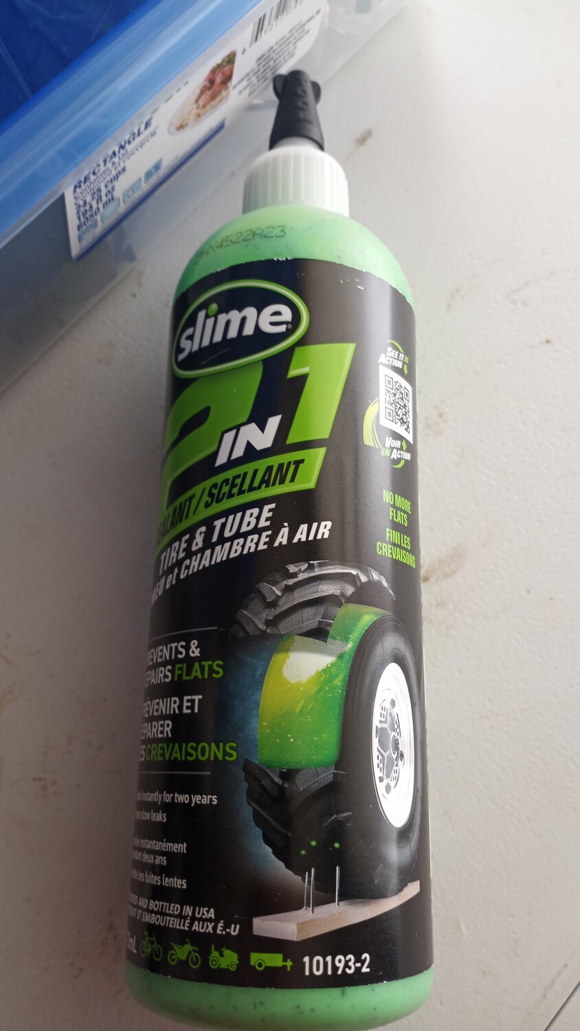

Luckily I haven't installed the Slime yet and it is still in the bottle.

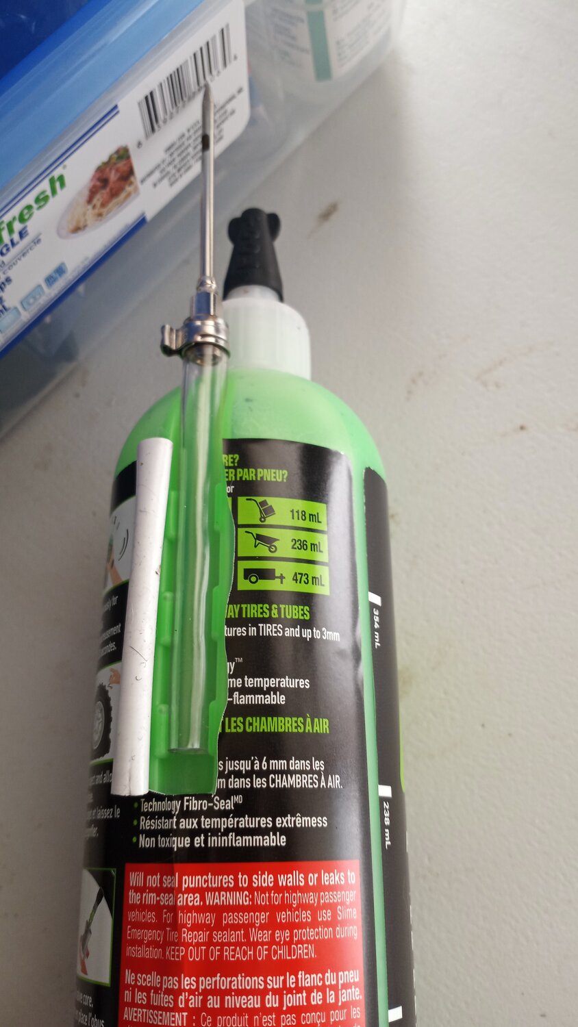

I did modify the installation tube by crimping on the needle of a turkey baster from the dollar store to hopefully avoid gunking up my valve stem with goo.
I don't know if it's going to work though? The slime might be too thick to squeeze through the needle?

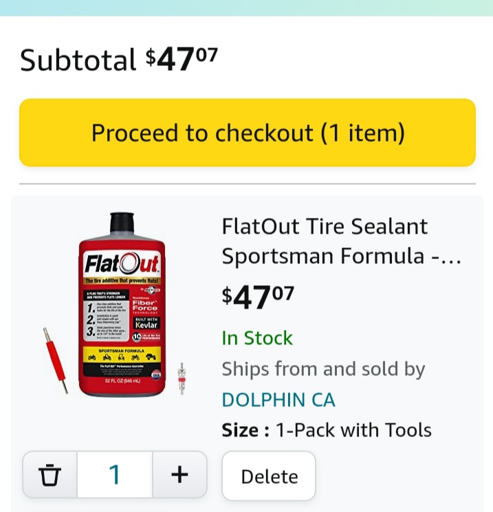

After watching the video I purchased some Sportsman Flatout to use instead of the Slime.
It's kinda expensive here in Canada but well worth it I figure.
I've already got the Tannus inserts installed so adding the Flatout to my tubes should give me the best protection possible.
I should at least be able to get myself home, and not have to deal with a flat in the field.
@PCeBiker I have done *exactly* that same thing with a baster needle, but not for the same reason. Some tubes (Continental in particular) have a flap at the bottom of the valve as it enters the tube proper and you have to push past that flap to get the sealant in. Sometimes it works, but also sometimes the sealant's fibers decide its trying to plug a hole in a tire and then they clump up and you have to pull the whole thing out and try again. Its best to just pull the core of your tire valve and use the open hole vs. the unobstructed tube.
There's no concern about gunking up your valve. Just take a hand towel to it when done. Shove it in a little and wipe. Make sure no one is looking and then blow into it like its a straw. Job done.
There's something else: Slime comes in two versions. The one you have is generally for automotive or utility tires that may or may not have tubes. The version with the red on the label is specific to bicycle tubes. Using the wrong one results in green slime splooged out everywhere and a flat tire. Do not ask me how I know this. This is the right version for bicycle tires.
I am intending to remove the valve core and using Q-tips to clean out the valve stem figuring that should help to keep any stuff from getting into valve core.

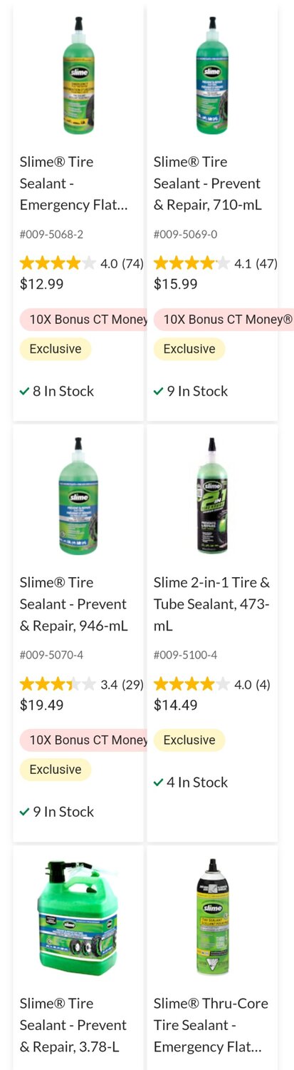

They don't have it at my local Canadian Tire, and maybe not in Canada?
All they have is the 2 in 1.
I would have had to have it shipped from the US and then it would cost all most as much as the Flatout.
I just assumed that the Slime and Flatout were the same thing with different levels of hype, so I bought the Slime.
Thanks again for that link.
You caught me just in time. I was getting ready to add the slime.

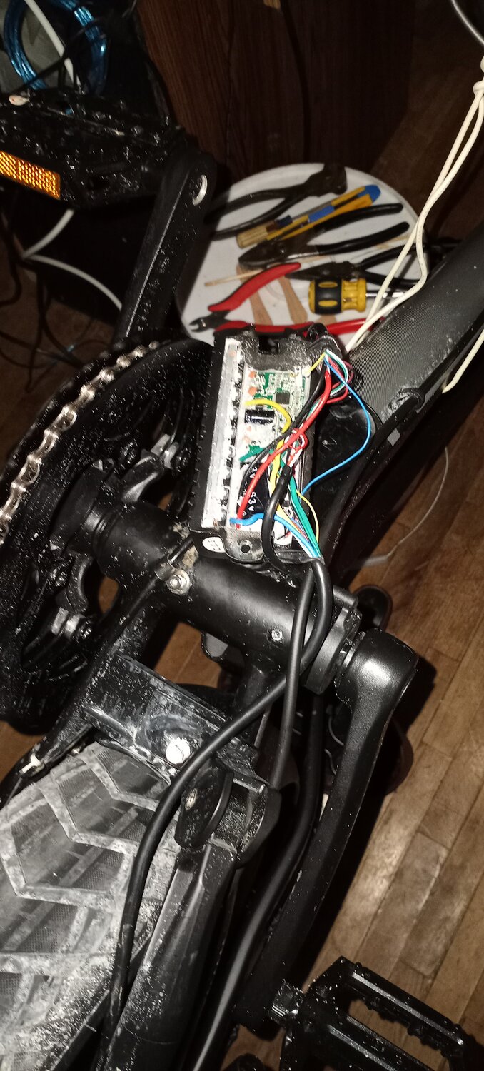

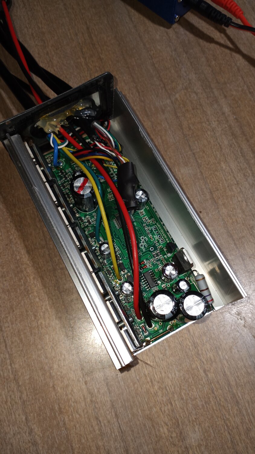

Luckily I have been distracted by giving my ebike a brain transplant.
I'm installing a KT controller,..
