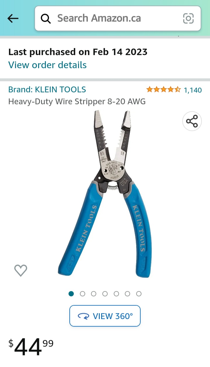

You can get 8" Klein diagonal cutters made in Mansfield TX in the electrical aisle of Home Depot.

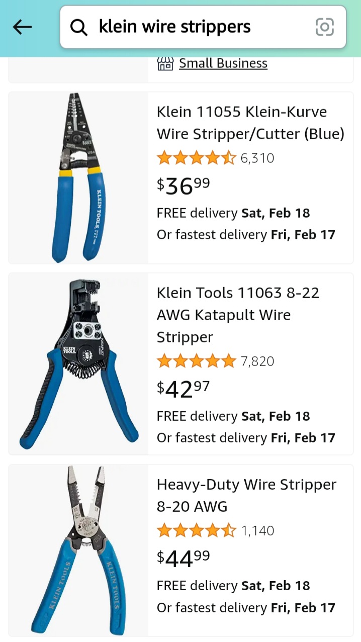

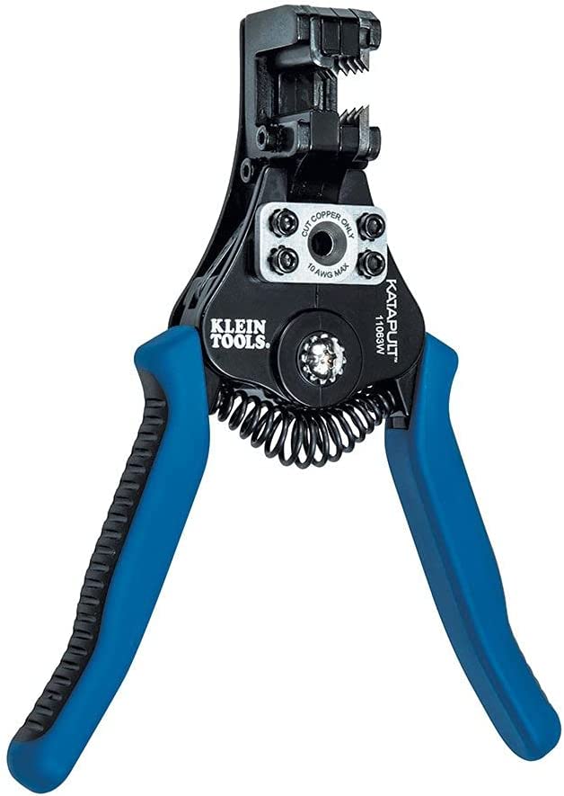

I took your name brand advice and bought myself a Klein wire strippers.
The Knipex version was $92
I went with the manual version with the bigger nose for twisting wire.
It's also got a wire cutter and 2 sizes of screw cutters (for electrical boxes)
The biggest complaint about it is that it doesn't have a lock, and a couple guys damaged their cutters (Knipex too), but they were cutting steel wire and Armoured cable.

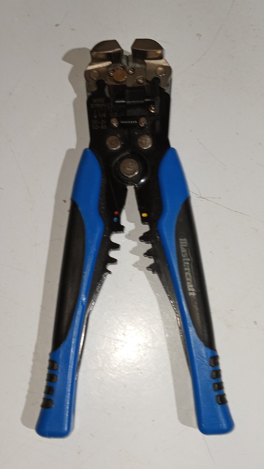

but its cool. I dont use it for bike stuff.
I've got a crappy version of that.
It works OK for solid wire but it rips stranded wire.
It is really quick and easy though.

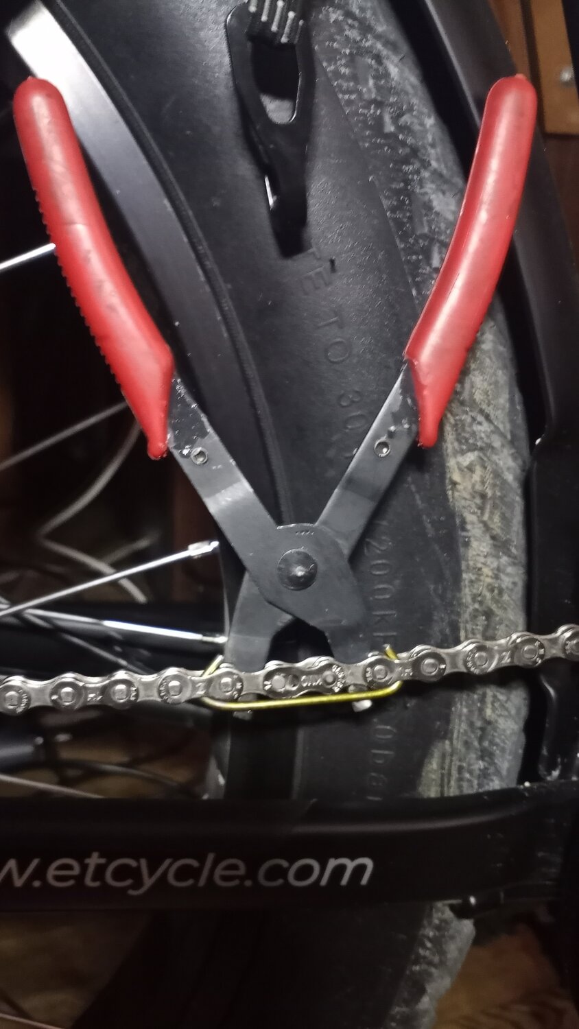

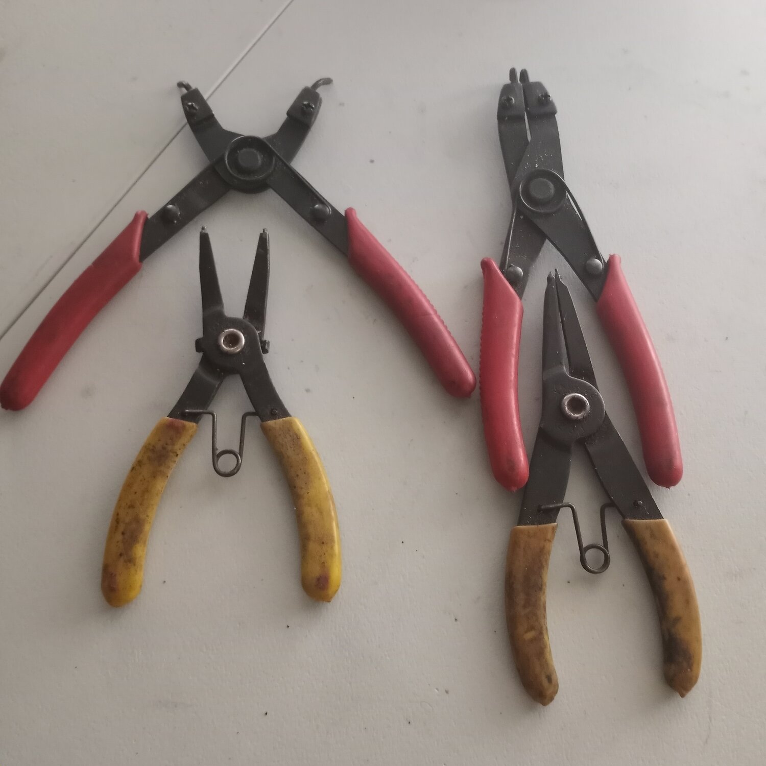

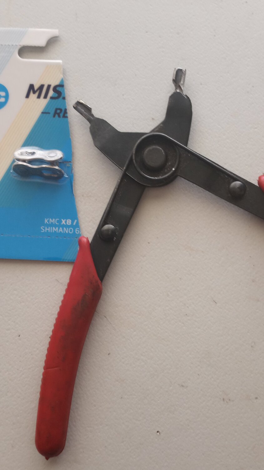

After reading this I decided to make a quick link removal pliers.
View attachment 146657View attachment 146658View attachment 146659
I don't know if such a tool is available?

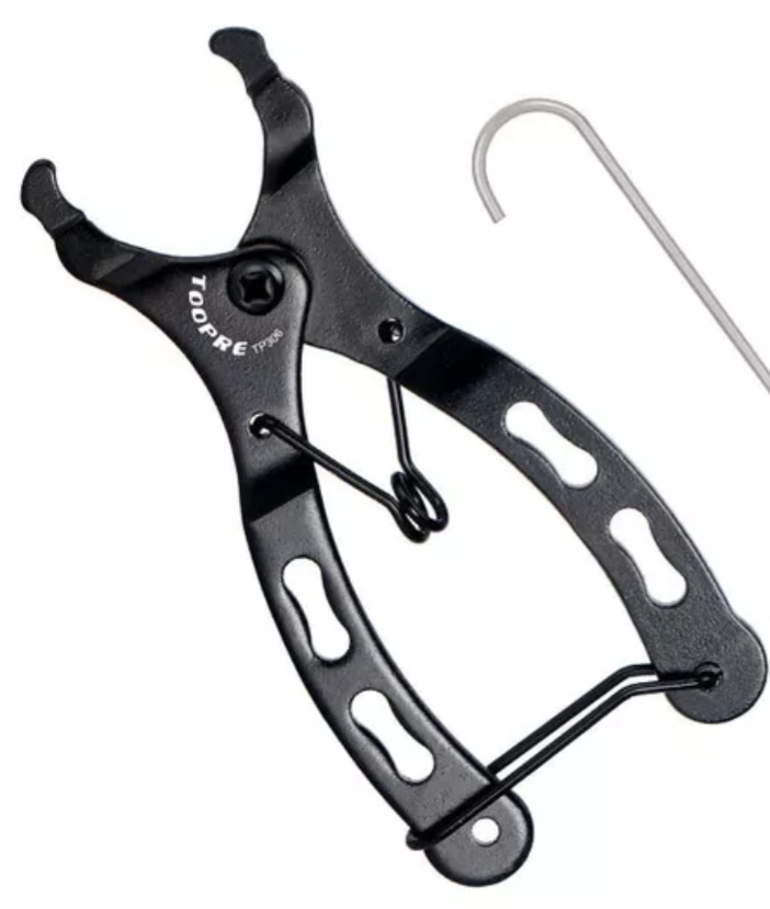

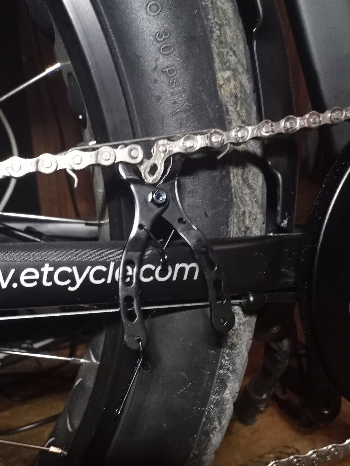

I've got one of these coming, but it's for spreading a quick link open to lock it.

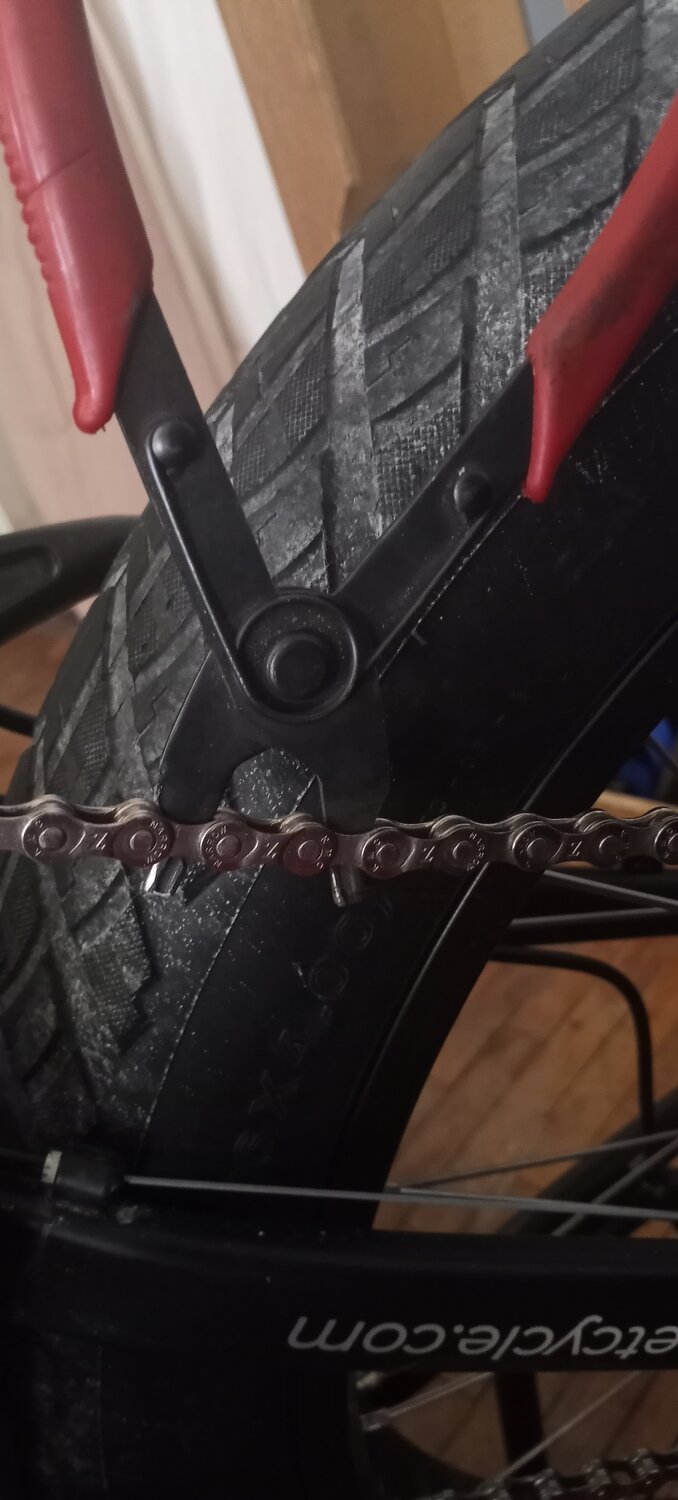

My chain breaker arrived a couple of days ago. (It was lost in the mail for a month. lol)
I didn't realize how small it was in comparison.
I managed to easily remove/compress the link by using my thumbs to pull on the handles.
I think maybe the link loosened up after putting a few miles on the chain?
I'm going to put the new one in my tool kit. It's smaller, lighter, and works fine to remove a master link.
And I can clip my spare master links to the handle.
PC
Those type of chain pliers work very well, as I found out, testing mine..........LoL
Mine is in the tool bag on the bike.
Tia,
Don
PC
Tia,
Don
Yeah, I thought it would be difficult to pull the handles apart to compress the link, but the tool kinda "clips" into the chain and it's easy to pull the handles apart with my thumbs.

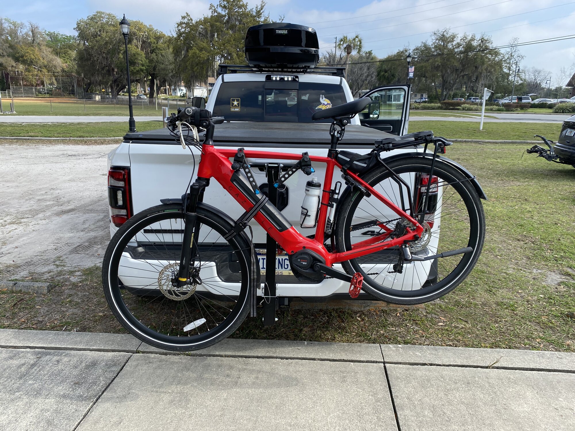

Not sure if this has been posted or not, but here it is. AAA will now tow your ebike. I have AAA with up to 150 miles of tow, so that is good news in case Im up in the mountains or at the beach.
I have AAA as well. They will transport e-bikes but there are limits. Although their plan is great for roadies, most AAA sponsored towing agencies won't go out into the boondocks to fetch a stranded biker. Don't expect to be rescued if you're out on a remote trail somewhere or even on a rural dirt road.
Obviously, you also need cell service to call AAA in the first place.
If you're a trail rider, it's always a good idea to know the location of the nearest paved road. I always carry a GPS for this purpose. As an added layer of protection, my GPS is equipped with Garmin Inreach, a satellite based texting service with near global coverage:
I wouldn't use it for something minor like a flat but it's good protection for a serious injury.
