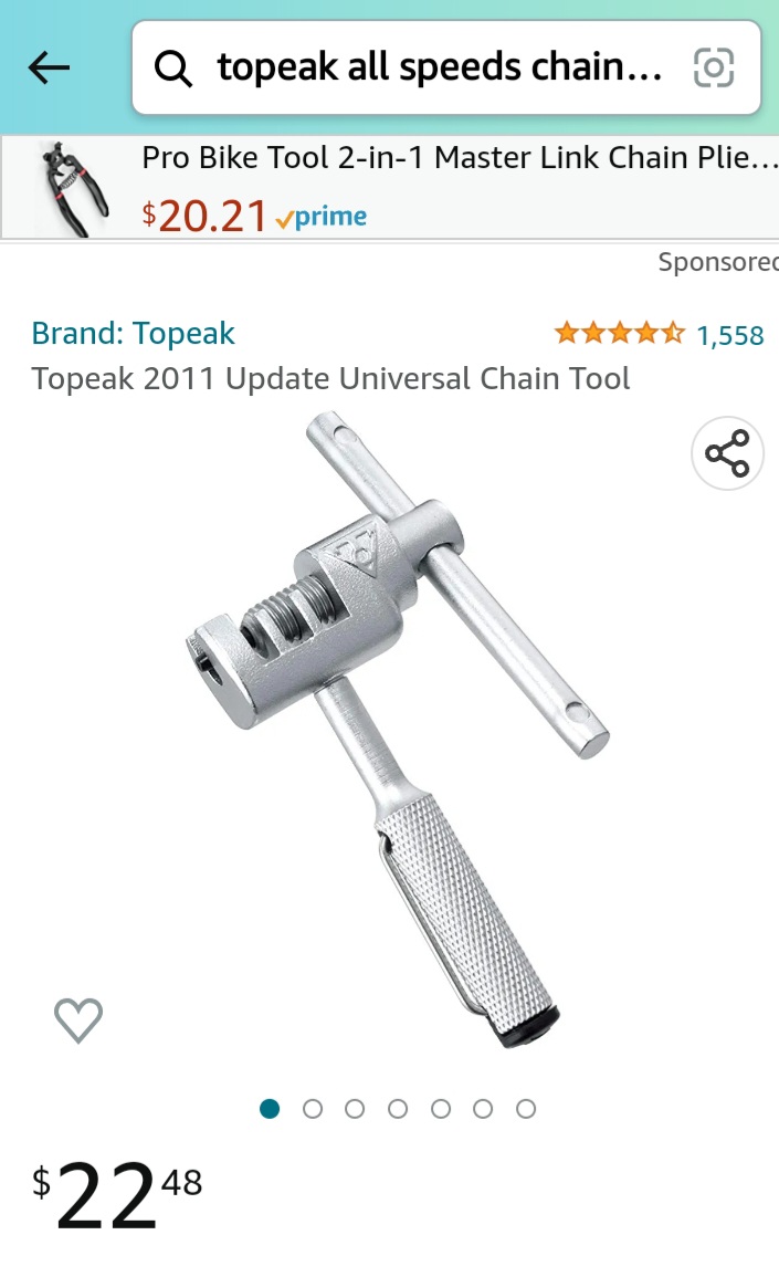

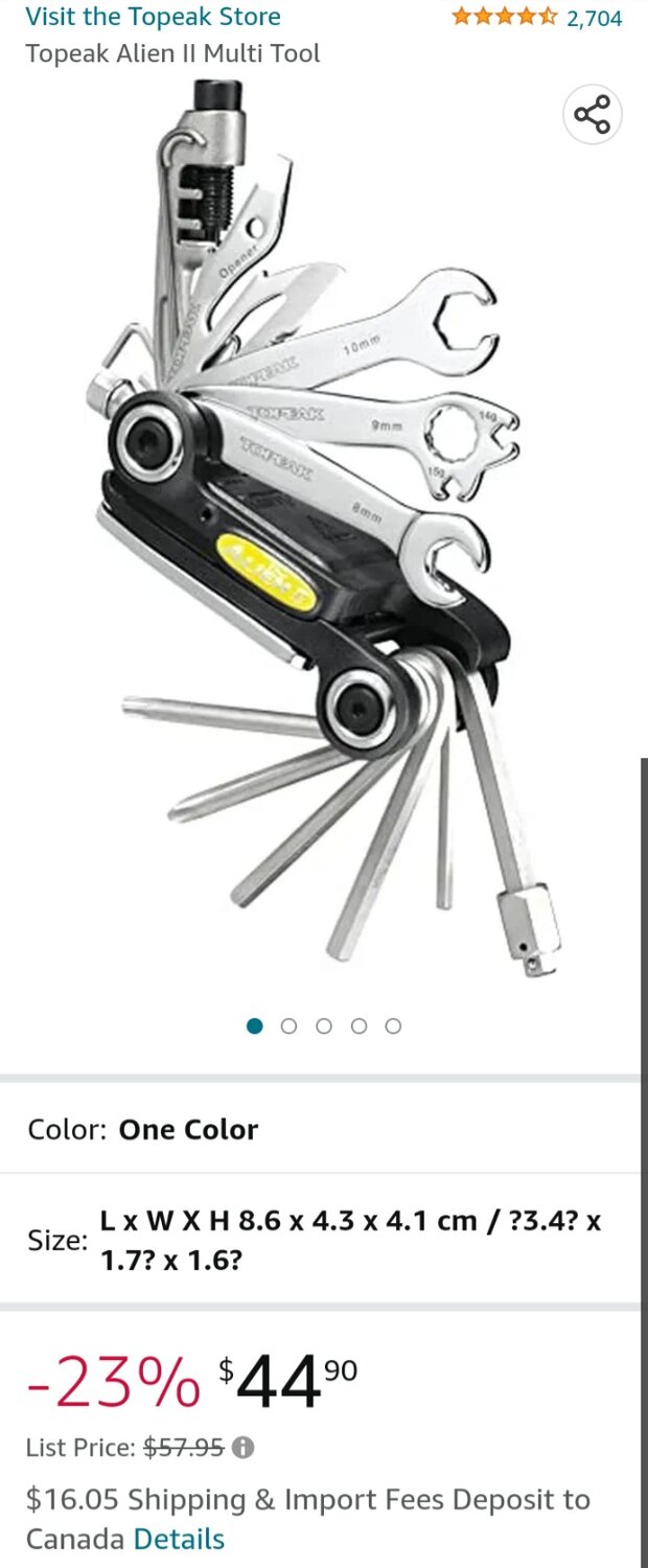

I think I found a half decent chain breaker ??,..
You can also spend a little more and get a high quality breaker like this one from Park Tool:
That's about $65 in Canada.
Park Tool has a mini for cheaper, but the handles are small and would hurt your hands.
I found this list,..
Topeak sounds like a good compromise.
Everything on AliExpress is like 4 bucks. lol

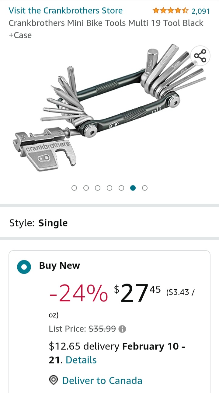

Crankbrothers M19 is another great choice for a good chain breaker with a lot of the other tools you might find yourself needing.
Probike multi tool with chain breaker. Stainless steel, compact 2"x3" short reach but works perfectly well on my 2 Emtbs.
That's a good idea.
And these,..
$65 plus tax but I get a whole tool kit.
And this for less money with only the tools that I need,..

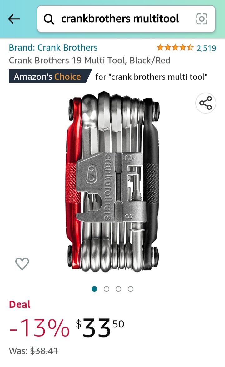

I'm liking the Crankbrothers.
Small, light, practical and all the pieces are connected so you can't lose them.

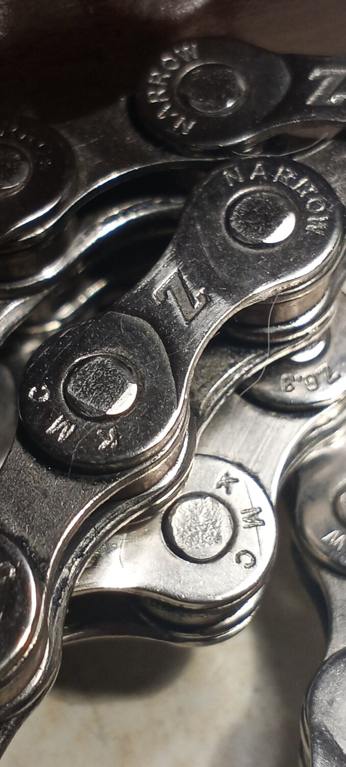

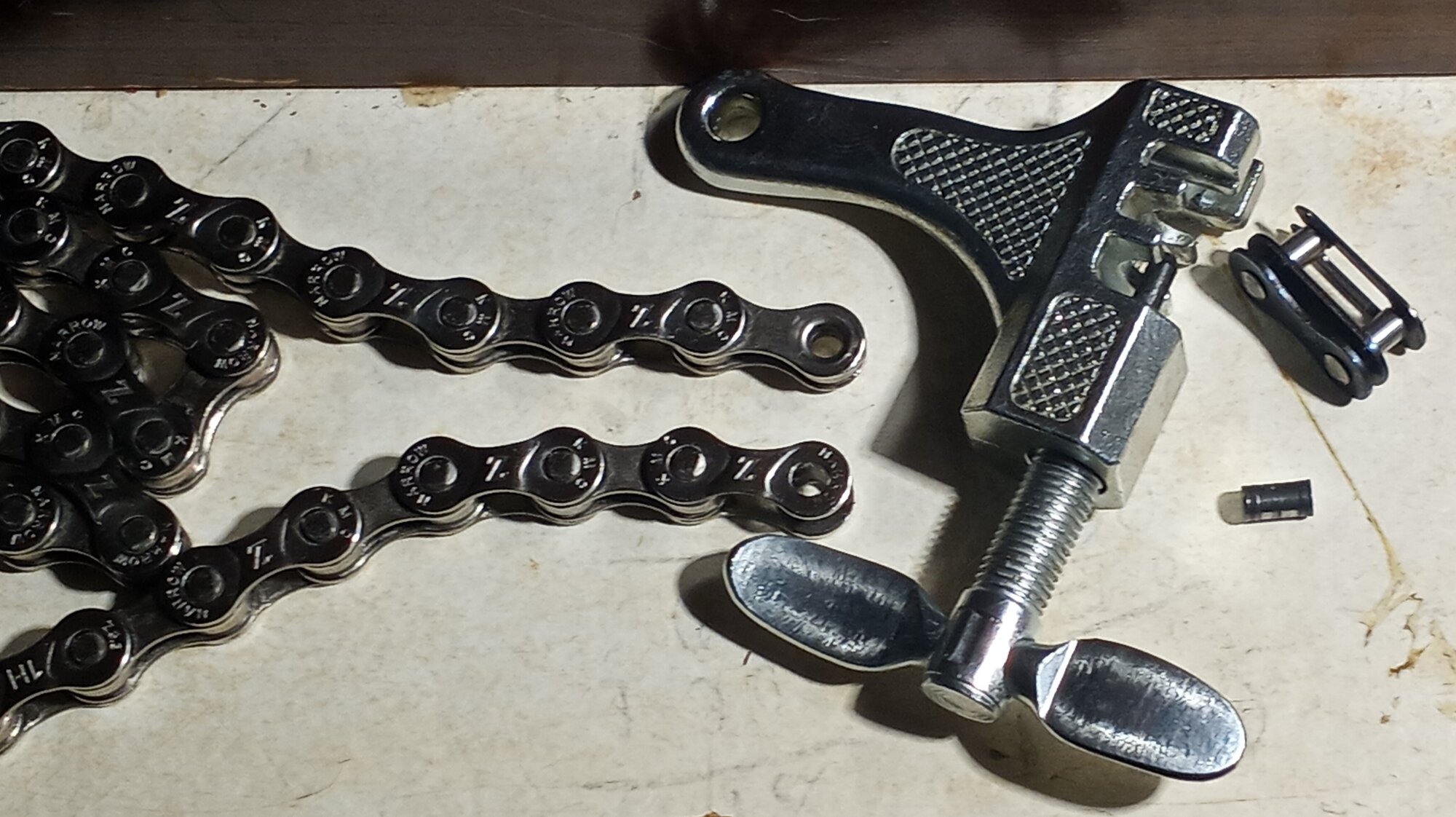

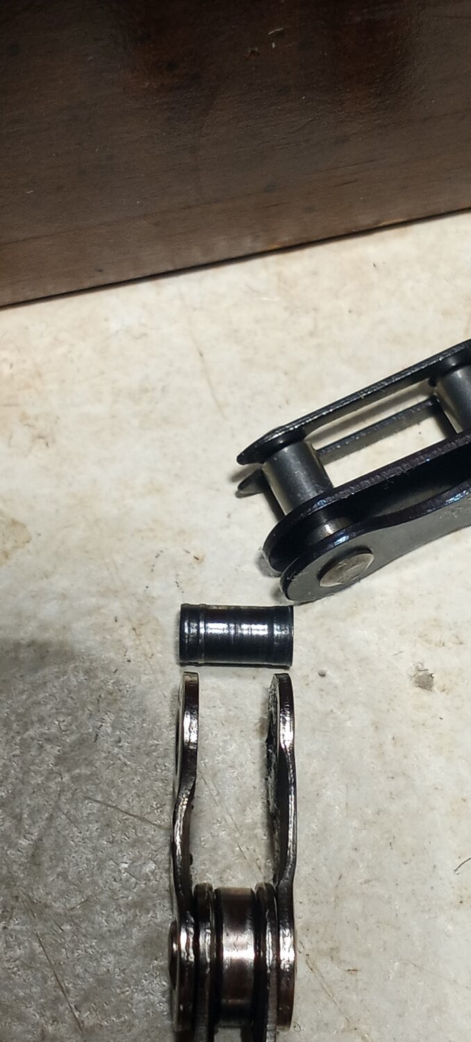

This is my KMC chain that I separated using what I think is a chain breaker.
There was a black master pin in the chain that I managed to remove.
View attachment 146032View attachment 146033
I struggled getting the master pin out (mostly because I was pushing it the wrong way at first. lol) but the other links look peened and really difficult to remove.
I was thinking that I would need to grind off the top of the pin to remove it if I had to.
Is there a different chain breaker that I can get that will remove those peened pins?
Was I only struggling because I was using a cheap Walmart chain breaker?
OK don't take this as a negative on you, because we all have to start learning somewhere, but you are doing it wrong. Here's the deal:
First of all, that single-speed chain appears to be an old-school type that does not have mushroomed pins, which means you can do the old-school method of pushing the pins out, and then back in again to re-section the chain. The more modern way is to use a master link, but I'll save that for later. For your chain, you went off the rails when you pushed that pin all the way out. Once you do that, getting it back in again is possible but not guaranteed, and a nightmare to make happen. I know a way to reliably do it but its not something I want to teach or you want to spend time learning. Instead what you do is NEVER let that pin go all the way out.
What you can do is practice on a sacrificial length of chain and do only a half-turn at a time. Count your half turns. As the pin gets further and further out, you start testing to see whether it is retracted enough to tease the chain apart. Once you find you can do it (there will still be a small nub of pin still sticking out on the inside) you remember how many turns it took to do that and file that knowledge away.
If you do have mushroomed ends on the chain, then what you do is twist hard and that lip will snap off as a natural part of the separation process. This is the reason you do not re-use chain links after pulling the pins. The pins will go back together but you have created a weak link in your chain by breaking off that little lip. You always re-section with master links. So if you are cutting a chain down to fewer links, thats fine. But if you are adding more back on you need to use a second master link, which is generally considered to be stronger than the actual original chain. BUT I'm not sure that is true with the style of master link you have on that chain. A more typical style of master link is seen on this Z8.3:
What I see in your pic is sort of an old-school kind of master link and I wouldn't trust it the way I do the snap-lock kind.
And yes you probably will have an easier time in life with a better chain breaker. I use the Park Mini Brute which is very small and fits into a tool bag on your bike. Bigger ones are easier to use but the mini brute is all thats necessary to get the job done reliably.

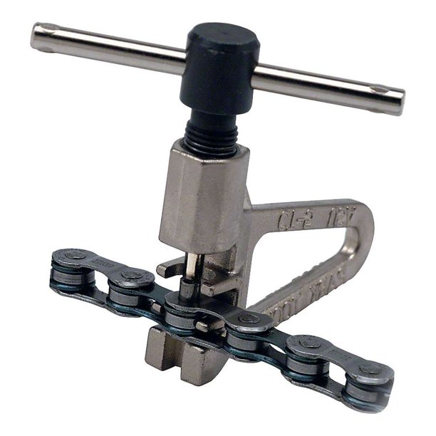

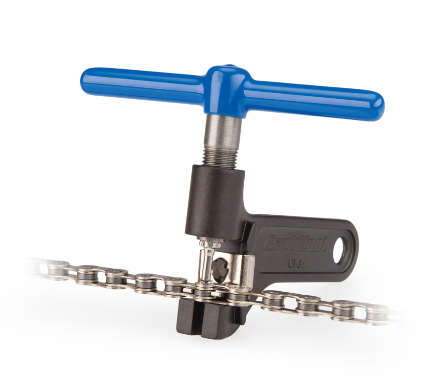

Thats a bad choice for a noob. Its great but is missing something: lacks the middle 'shelf' that lets you spread a link a tiny bit, and fix a stuck link which happens a lot.
The Park Mini Brute. Notice the two pins sticking up above the chain. Thats a second channel to put the chain so you can spread it a touch.
The big expensive Park shop version doesn't have that. The sliding chrome plate is used for a different purpose.
Also
The Topeak chainbreaker is a good, high-quality tool. But its more expensive than the Park, which is top of the line in the same league (compact tools you can carry with you on the bike). It does have the slightly desirable bit of wire to hold the chain links together for you so there's that. I keep a complete tool kit in each ebike I have so thats 9 chainbreakers, so I try and minimize my spend and standardize on just one. I forget which bike has the Topeak in it but I remember it works.
If you are looking for a bigger chainbreaker than the Park mini, the Topeak ain't it. If you need size, go to Amazon and look for the Oumers breaker. They are cheap and will not last forever, but have big paddly arms that will be comfortable.
My chain does have mushroomed pins, except for that single black "master pin" that I figured was the one that I should be pressing out.
Yup, I pushed it right off the rails. lol
I did press it in just enough to clear the outer link and went to rotate that link out of the way and it wouldn't budge. I put pliers on it to try and rotate it and nothing. I thought it must be connected to the outer link on the other side, so I just kept pushing on the pin. I figured that I could push it to the other side until it clicked into the outer link, but there was still a lip in the way and I couldn't get the inner link out, so I just pushed the link onto the train tracks. lol
Ohh, it was a challenge. lol
I must have dropped it 5 times when it came flying out of the chain breaker.
I ended up gluing a magnet to the table and stuck the pin on it while I figured out how I was going to get it back in.
In the meantime, I ordered some KMC single speed quick links, then thoroughly cleaned my chain with soap and water, brake cleaner and alcohol and gave it a hot wax treatment on the stove.
(I used my own plastic container because the kit was more money and came with half as much wax.)
I ended up using an adjustable pliers to press the pin back in, taking note of the direction, to install it the way it same way it came out.
I'll keep that in mind, but I'm going to use quick links from now on.
Meanwhile, my chain is still holding with that master pin. I've put around 100 miles on the chain.
That makes sense. I didn't think of counting.
That didn't look possible.
At least not with my piece of crap from Walmart. lol
This is the reason you do not re-use chain links after pulling the pins. You always re-section with master links. So if you are cutting a chain down to fewer links, thats fine. But if you are adding more back on you need to use a second master link, which is generally considered to be stronger than the actual original chain.
That's good to know.
I assumed the quick link would be the weakest link.
That was a master link that I had in the garage for 25 years.
I thought I could possibly use it if I couldn't get the pin back in while I waited for my Missing Link to arrive.
I just ended up purchasing this,..
It will be here on Monday.

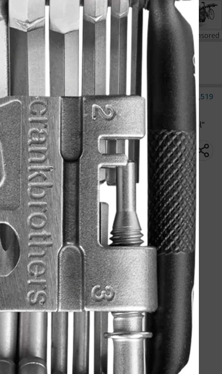

s*it !!
I think I'm missing a shelf. lol
EDIT: It looks like the Crank Brothers has a self,..
The crappy one has two shelves.
Maybe for a thicker motorcycle chain?

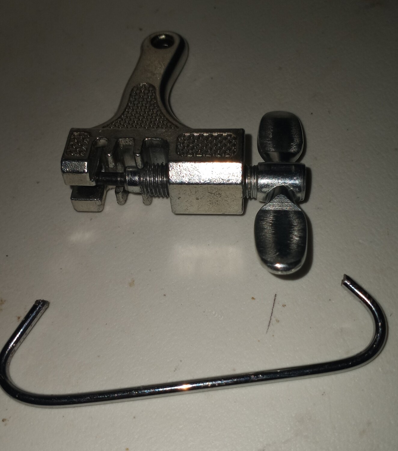

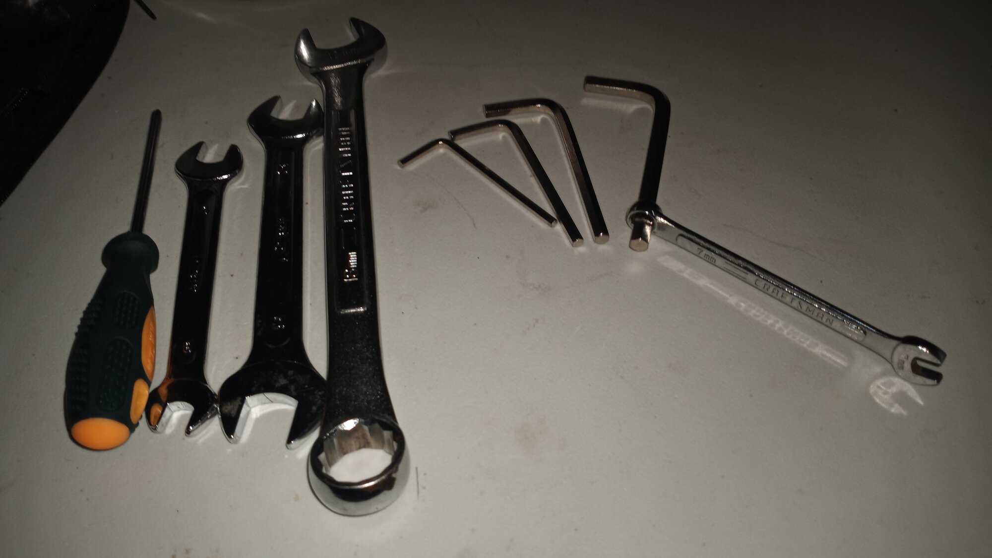

I made a hook out of a metal skewer from the dollar store.
Metal coat hangers are hard to find nowadays.
Yes. that looks like the **** schwinn chain breaker from the grocery store.
Get a citizen's choice, pedros, or full price park breaker from modernbike.com universalcycle.com or equivalent. I've used the first two successfully. Buy them with your tires to save freight.

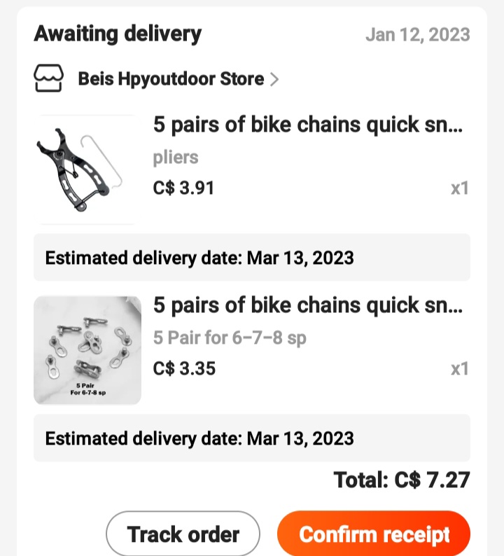

I also ordered this from AliExpress.
It should be here in a few months. lol
I figure that the pliers don't have to be quality, and I've got 5 crappy quick links to get me through until I find a deal on KMC missing links.

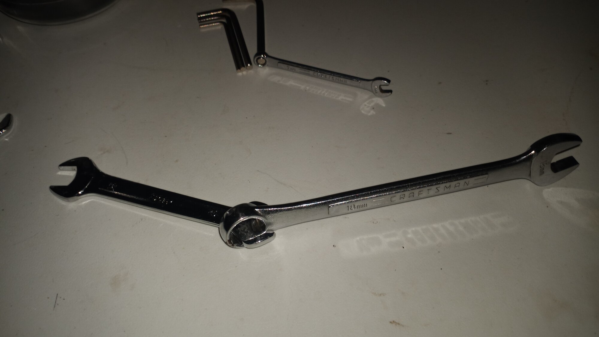

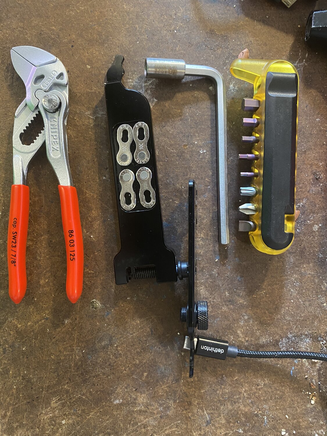

Those multitools are too short to get proper torque on the axle nuts, seat mounts, steering column, handlebar clamp, brake mounts. At least with my hands. I carry mechaniics length allen wrenches from mcmaster.com or bondrus, 6" or longer 15mm & 17 mm combo wrenches, 18 mm for the motor axle. I have an extra long (7") 5 mm ball end allen wrench to adjust the front brake pad without taking the motor off. I use a kids pencil box to keep the rain off them.
I've got the original kit that came with the bike that is reasonable quality, and I added an 18 mm wrench for the rear axle and a little box ended wrench to get more torque on the allen wrenchs.
You have to be careful using the little box ended wrench as an extender.
The box end can spin around, and you end up stabbing the end of the allen wrench into your palm.
I keep crazy glue in my tool kit to seal up the wounds. lol
This works too, but it comes with the same warning,..
