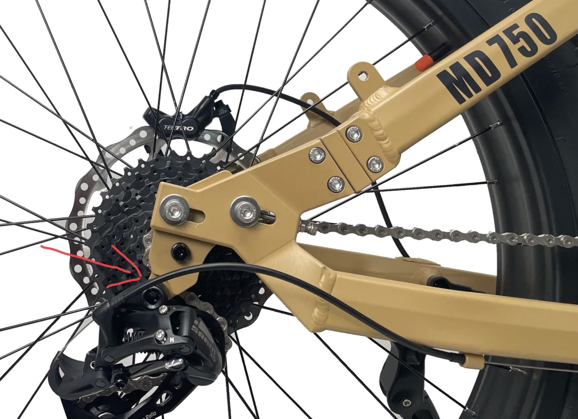

In your case, I'm not sure they built that hanger to protect anything
Am I correct your whole back wheel is held in place on an adjustable plate? I guess you can use that to take up slack when running as a single speed....but WTF were they thinking?

Looking at what you have indicated, via the arrow, it appears that the whole plate is bolted to the frame, the 2 big silver bolt heads in line with the chain, same thing on the other side, the QR axle goes thru both side plates and thru the cassette (black hole just below the arrow point), there is an adjustable screw/bolt for adjustment on the front edge of the frame, right in front of the view of the chain.
Right now on my bike there is no adjustment possible as both of the locking bolts are out of space and at the end of the slot, just like the picture shows.
So this means I have no adjustment possible for the chain?

So at this time I am SOL, if the derailleur is destroyed etc,
I only have the shorten chain method to get home via pedaling,
