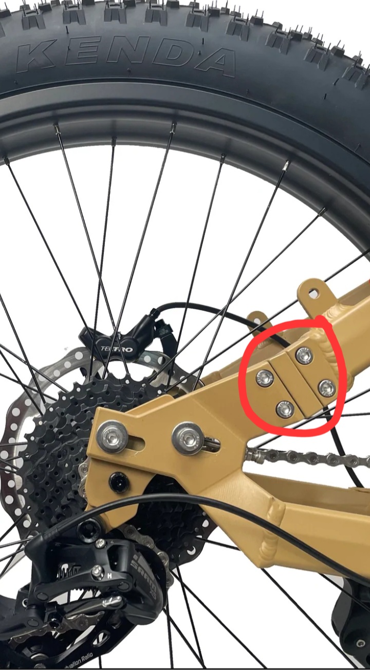

Right now on my bike there is no adjustment possible as both of the locking bolts are out of space and at the end of the slot, just like the picture shows.
So this means I have no adjustment possible for the chain?
You can't tighten your chain, but you can loosen it.

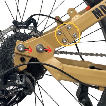

Your frame is designed for a single speed chain, with adjustment for slack so there is no slop in the chain.
AND, your frame is also designed to get your original chain off the bike and the single speed chain installed WITHOUT breaking either chain or using master links.
Pick a low speed gear (1,2 or 3) because you may need to go slow with lots of torque to get up a hill or through something slow.
You can always pedal along going slow, but if you pick a high speed gear, your pedaling cadence will be really slow at slow speed.
Loosen the two bolts marked with red arrows on both sides of your frame and slide the bolts to just past the middle of the slider slots.
Figure out how many links you need for 1st, 2nd or 3rd gear.
You can slide the adjustment all the way to get the chain on the sprocket, then slide it back to snug up the chain and eliminate slop.
Then have that emergency chain connected properly as one piece by pressing in a proper pin, or have a chain made that is complete and joined, to avoid any master link/quick link issues, and keep that emergency chain on your ebike.
When your derailleur eventually gets smashed (it appears that your entire derailleur is sacrificial on your ebike? lol), you remove the derailleur and remove the four bolts (circled in yellow), then remove your original chain IN ONE PIECE , through the slot that is created in your frame by removing those four bolts.
Then you install your pre-built one piece/fully connected emergency chain through the slot in the frame and on to your front chain ring and rear sprocket using the adjuster slots to snug up the chain.
No chain breaking, or quick links, or Idler wheels necessary.
Having a proper fully connected chain built with the correct number of links is probably your best bet.
Maybe contact BIKONIT and see if they have a one speed emergency chain available.
Thier ebike is designed for the easy installation of an emergency chain.
They can also verify if my suspicions are correct.

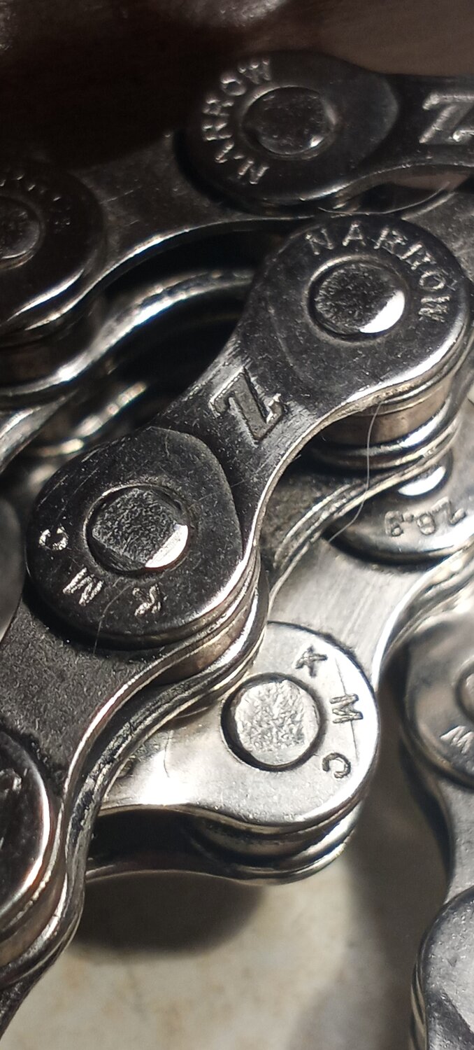

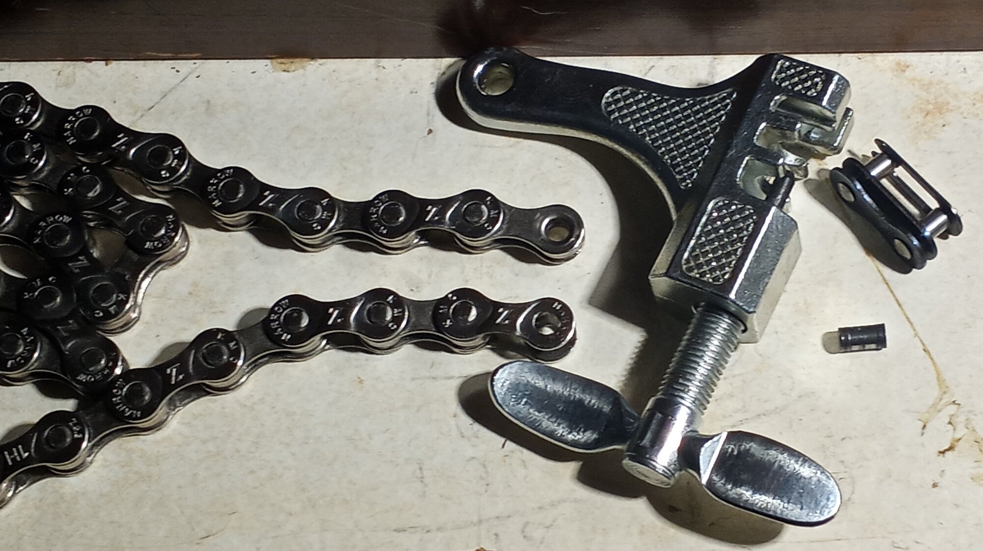

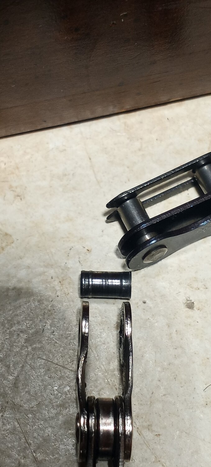

This is my KMC chain that I separated using what I think is a chain breaker.
There was a black master pin in the chain that I managed to remove.
I struggled getting the master pin out (mostly because I was pushing it the wrong way at first. lol) but the other links look peened and really difficult to remove.
I was thinking that I would need to grind off the top of the pin to remove it if I had to.
Is there a different chain breaker that I can get that will remove those peened pins?
Was I only struggling because I was using a cheap Walmart chain breaker?
Lemme tell you something about that chain breaker. Had one just like it. It's an aluminum body and a steel bolt. Eventually, the threads in the aluminum body are going to completely strip out, because it's just too soft with the force of the bolt pushing against those threads. I think I used mine 3 times before it was useless.
OK, thanks.
Any recommendations for something that isn't crap? lol
