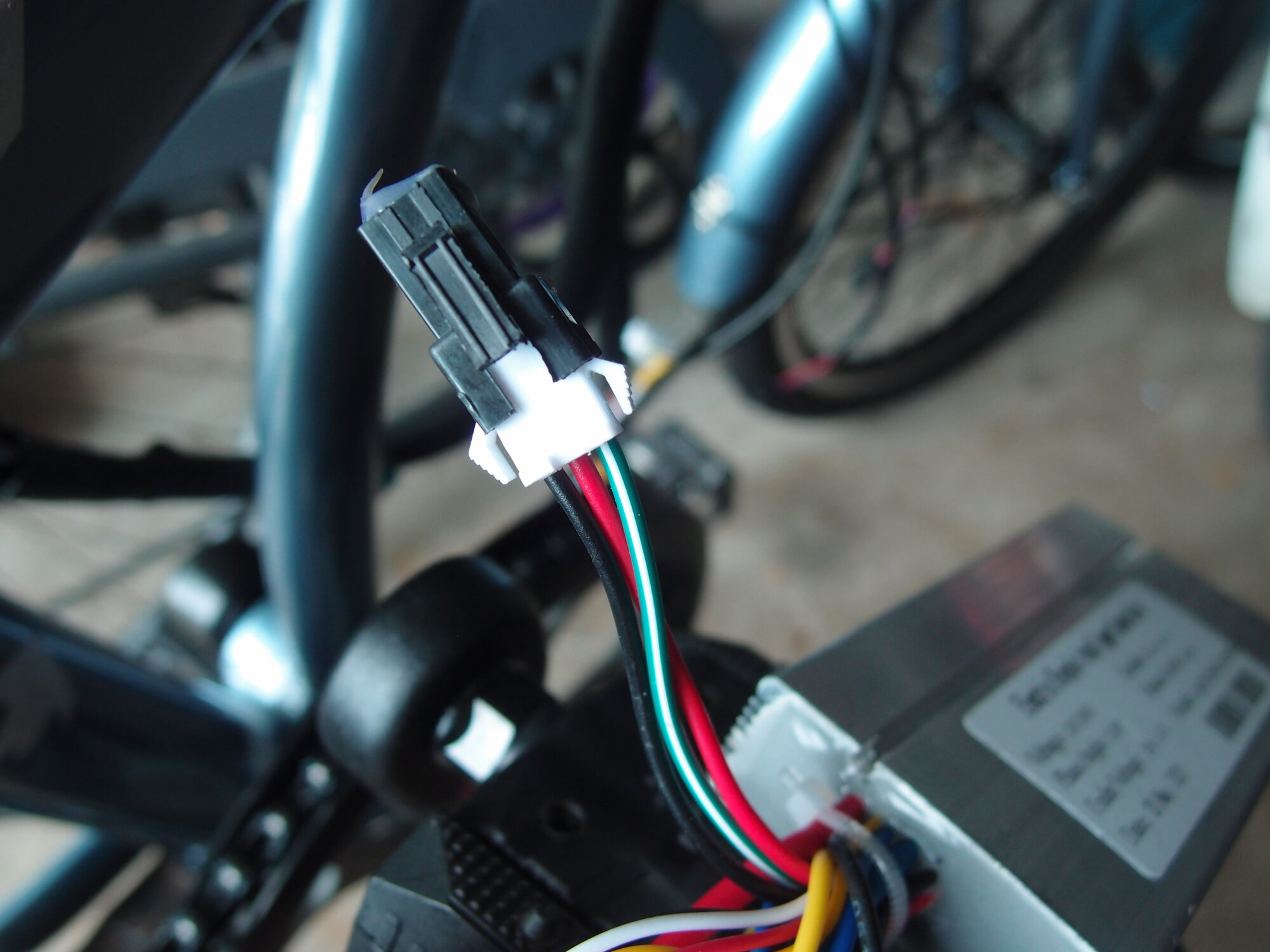

This was the connector on my Huffy. It was in one of the posts on the first page. The black cover is an empty male JST plug. It comes off.
Then you can buy a throttle like this one. It comes with an empty JST plug and the pins wired into the throttle wires, which allows you to order the pins to match the controller. Don't change anything else, and the throttle should work, ON/Off should work, PAS should work, etc,

The throttle I ordered was plug-n-play: https://smile.amazon.com/dp/B08HYPVC7F
The voltage display and power button was easy to install as well since the Oslo comes with the power button on the handlebar. I reused the connector on the new throttle's voltage and signal wire and both the voltage display and power switch works as intended.
It is definitely a lot better than straight pedal assist. With the throttle, you can control the amount of assistance it gives, whereas default PAS just always max assistance. I usually throttle to get the motor started and then pedal to reduce the PAS lag.

I got the throttle/switch/voltage-display some other have mentioned and I'm not sure how to wire it.
The three wire throttle lead (red black green) is straightforward of course (snaps perfectly into the controllers throttle lead, which came with a black plastic cap that needed removing). But then there are 2 other thicker wires, yellow and blue, for operation of the voltage-display and on/off switch.
But the OEM handlebar on/off switch has three wires! That is confusing to me (considering a simple light switch for example with 2 wires, which are connected when the switch is on, and disconnected when the switch is off).
So I believe some splicing is necessary but not sure how, or if it is possible to have the switch function. (The switch isn't really necessary as there is a switch on the battery for on/off purposes). I will hopefully get a photo up soon, I forgot to take one while tinkering. Thanks in advance for any advice.
When I put that same throttle/switch/voltage display I only hooked up the throttle. I was too lazy to trace the switch wires back to the controller.
The throttle worked good, but then I relaced the bike's controller with Kt 15 amp controller kit that included a thumb throttle. Significantly more power and speed with the new controller. So, for about 50 bucks you can fix what made this bike such a marketing failure.
The Huffy controller cannot use the on/off switch on that throttle/voltage display that MaKlounkee bought. It's a different design, with different voltages on the wires. So send it back if you can, and just buy a throttle.

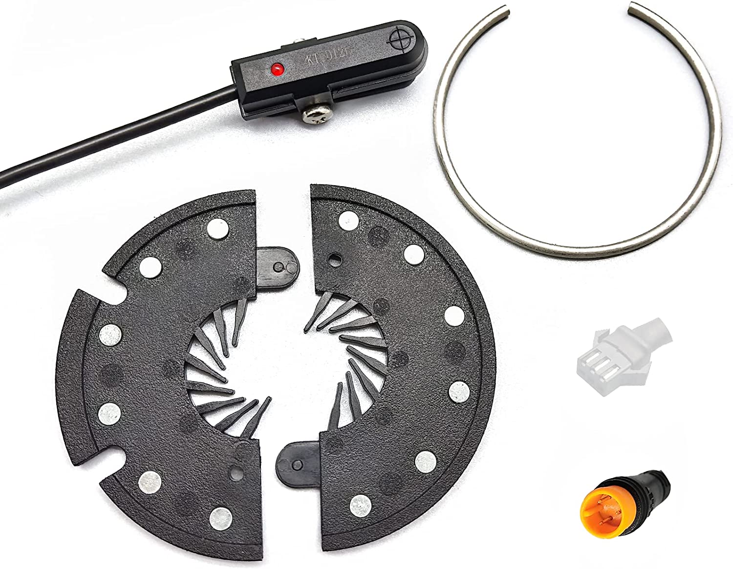

It is worth mentioning that Huffy Oslo cadence sensor is integrated one. Fix-position sensor and rotate magnetic points are inside plastic casing similar to one found in Amazon
And product usage guide line saying that "Parameters: If the magnetic dot does not work, you need to adjust the parameters of the display (adjust according to the correct parameters in the display manual). If you are using a KT display of the same series, please adjust the parameters from C1 to 7", after change KT-LCD display setting, KT-controller is able to pick up Huffy Oslo cadence sensor. If you using KT controller but paired/connected KT display cannot change that parameter, then you have to replace Huffy Oslo's cadence sensor with one bundled with the controller.

Nice price on the walmart controller, but for the effort involved, get a better display. The 880 is only three PAS levels, and you lose a lot of flexibility including perhaps, the ability to read the Huffy PAS sensor, as well as a speedometer, the wattage being used (some models) and your actual battery voltage (some models).
As for cadence sensors, the integrated ones just slip over the pedal axle, but you need a $10 crank puller to do that. The two part units are a pain to install. You have to extract the axle with another special bike tool iof you're going to fit them under the bearing cones as intended.
Agreed on the 880. I’ve had problems with that chintzy display on several buddies bikes.
All Split ring 12 magnet here.
KT D12​

To use the Huffy PAS sensor with a KT controller, after you get the wires correct, you have to try different settings in the LCD settings, That was discussed earlier in these posts. Without an LCD that does this, you'll have to buy a different 5 or 8 magnet sensor.
I.
I had the same problem with the Huffy sensor on my 20A KT controller, and I didn't remember to try the settings. I had an extra sensor, so I put that one in.
Thanks for the information harry. Though I'll probably just put on the kit's cadence sensor, after I get a BB tool.
