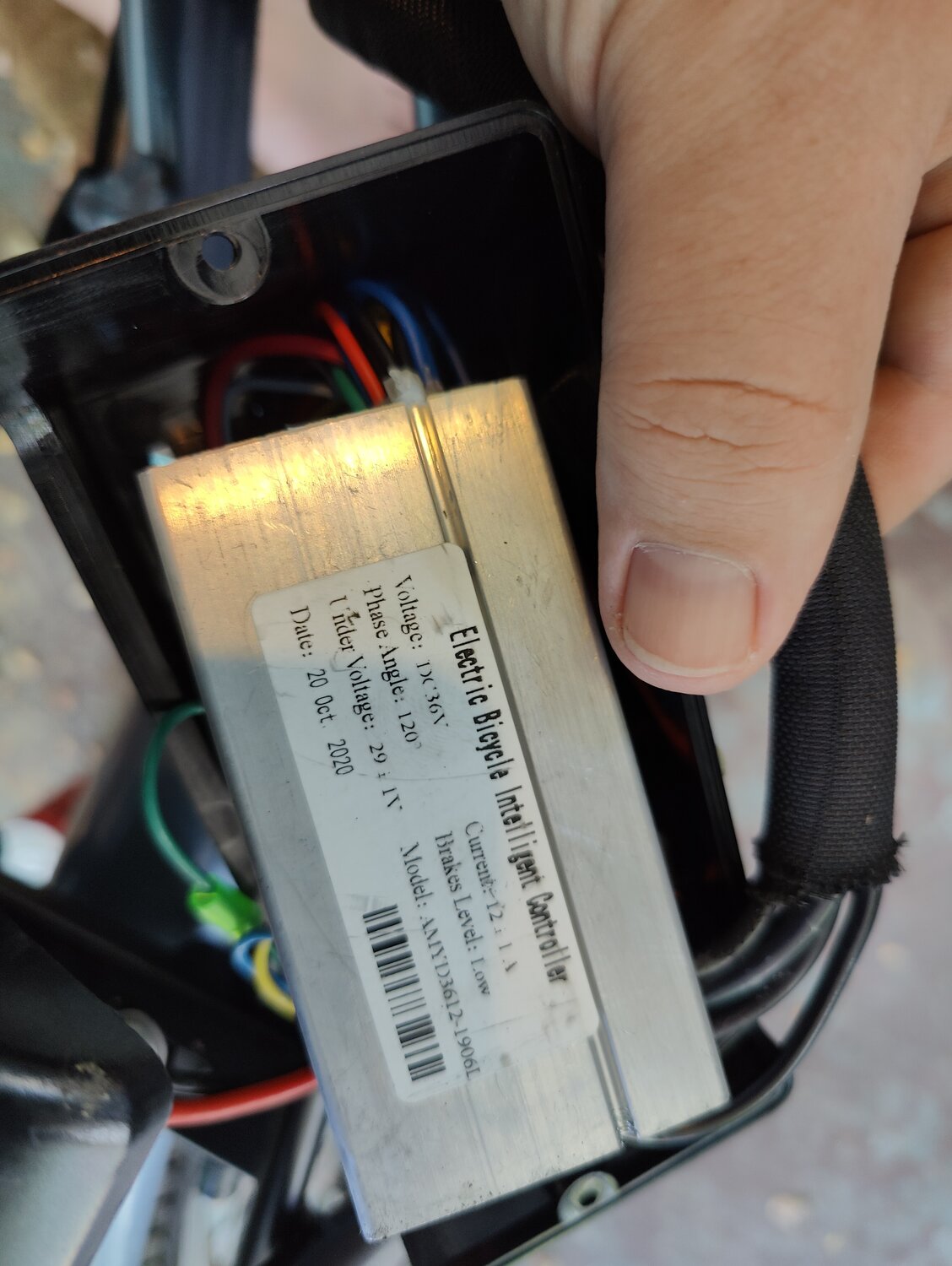

I ordered some cheap $10 thumb throttles which will be here in a few days. I found the Green/Red/Black cable and appears that connector is common with most bike/scooter throttles. Do I just hook up the throttle and im good to go? I love the throttle/display, but im just trying to keep these cheap and simple. Hoping this works as the pedal assist is not consistant and tends to kick on oddly and then carry on too long. just be nicer to control with thumb as well as not pedal at all so i can be extra lazy ;)
Also, i found a fuse holder inside the battery compartment. looks to have come out of the battery from the side. i didn't see a fuse inside nor on the other bike, so im guessing no fuse on this battery pack.

The throttle I ordered was plug-n-play: https://smile.amazon.com/dp/B08HYPVC7F
The voltage display and power button was easy to install as well since the Oslo comes with the power button on the handlebar. I reused the connector on the new throttle's voltage and signal wire and both the voltage display and power switch works as intended.

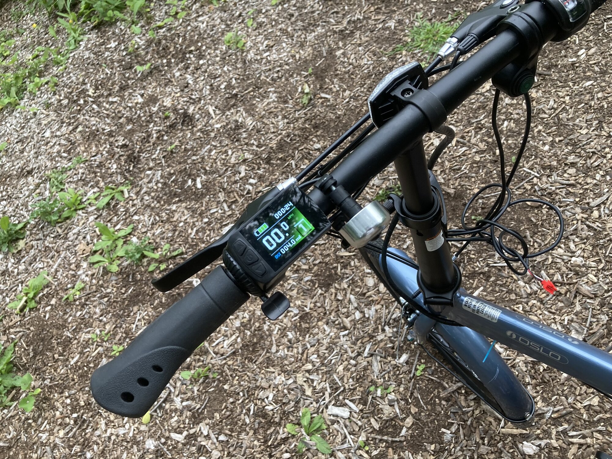

Done. I had to put in a different PAS sensor. Must have pinched the cable on the Huffy unit. This is the KT LCD9 display. It's my color model and is easy to see. Shows watts, voltage, mileage, speed, distance, but on different screens.
The pedal response is far better, but I can't pedal much over 16 mph. The gearing is too high, as is typical of 20" folders with a 14-28 freewheel. I'm not willing to throw another $30 for a DNP 11-28 freewheel yet. Throttle will take me up to 18 mph. The ride seems more forgiving than my other folder, but the tires don't roll like the Schwalbe tires on that bike.
The seat has weak springs, and my butt has them fully compressed. All told, it's the usual scenario, Bike needs better tires, better seat and gearing changes. However, the rim brakes seem fine.
The battery is a bit small. I will install a y-cable for an aux battery in parallel if I keep the bike.

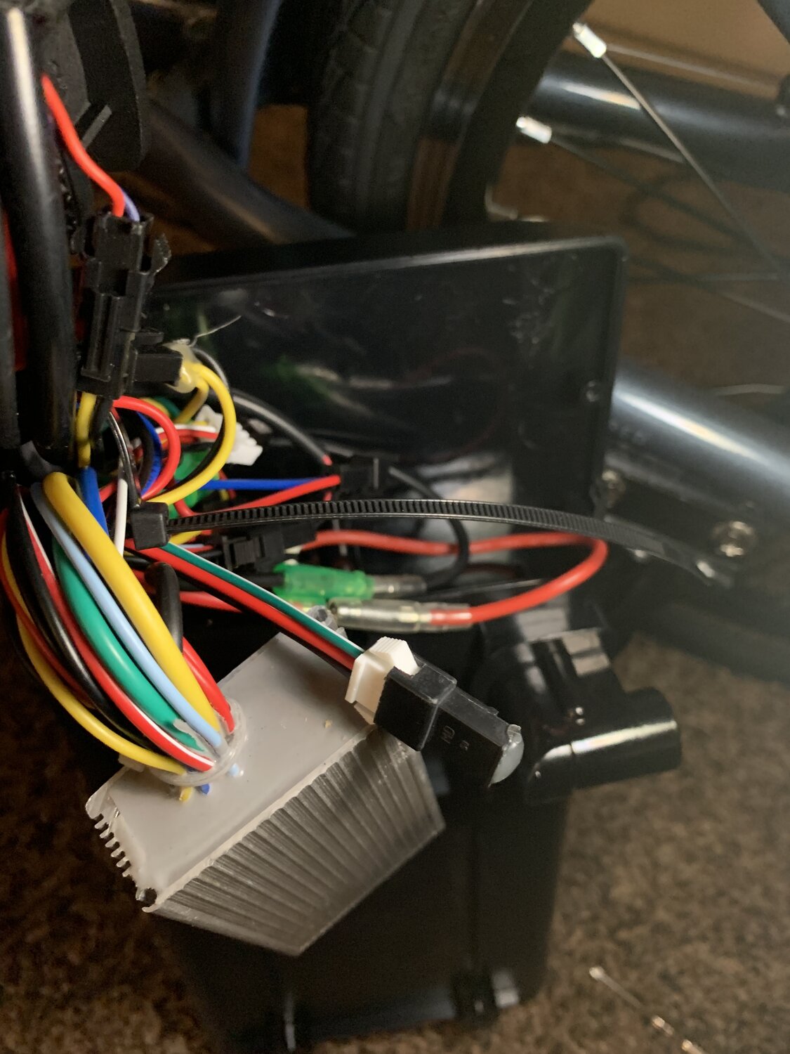

Silly question but how do you get access to the controller? Am I unscrewing the plastic housing to get to it next to where the battery sits or does it pop out easier than that? TIA
The plastic case has two compartments, the big battery part, and a small part (towards the front of the bike) for the controller. There are two screws underneath that hold the cover over the little compartment. I couldn't get to those two screws without unmounting the whole plastic housing though.
Thanks I found the two screws but def having a difficult time unscrewing them with my plus driver; is it a #3 screw in size or smaller if you know by any chance? TIA
Ah I was able to get to it. So guessing it's this three wired plugged cable with black, red, and green/white that I'd plug the throttle into then? I tried to look for the power and voltage display as you'd mention but not sure where those other two wires would replace so that the throttle you used would work with the cut off kill switch design?
DI you solve the battery charge problem? The bike ships with enough charge to run the bike.
Use the existing on/off switch on the bike. Buy a three wire throttle to keep the upgrade simple. There's probably no display that works.
I did! Had to keep it plugged in for a while and the led on the wall charger finally lit up and it started charging the battery!
Sounds good I will stick with a three wire throttle then. Thanks everyone!
