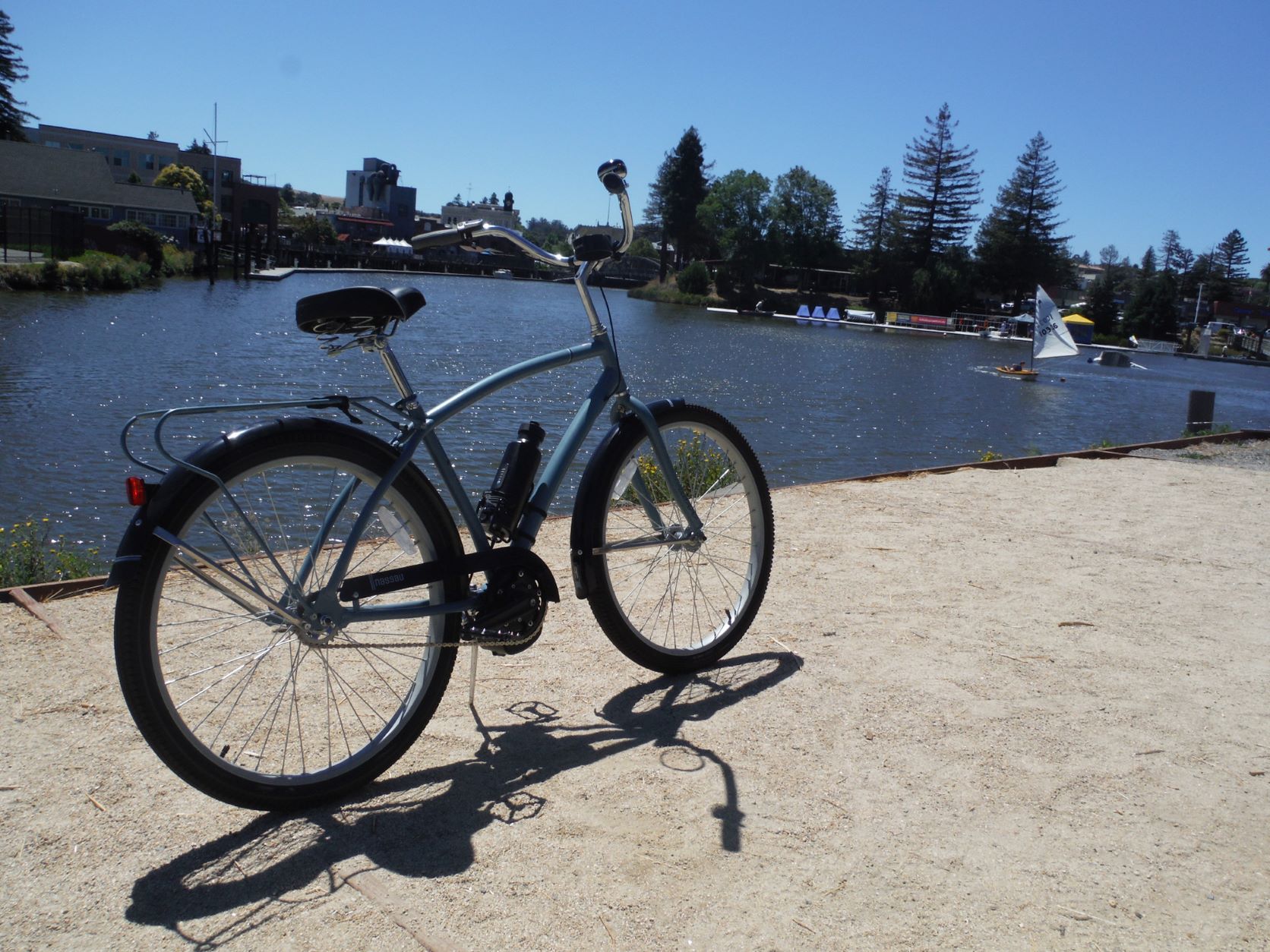

If you command a rowboat do you want a lightweight Viking rowing it? Or a strong one? Do you want that big strong Viking far out at one end, or centered low in the middle of the boat? Get a mid-drive, low and centered, one that pulls the chain through the shiftable gears. When some added weight adds multiplied power exponentially and is low and centered, you do not feel the weight, you feel the enhanced torque sensor power. I love the DM02 with the 4mm wire T154 display going through frame with no zip ties and no visible connectors and a battery that looks just like a water bottle. I sell carbon SL Creos at my day job, and can kick their butts with this set-up out in Western Marin on my days off. I have a Vado 4 and can smoke it with a ToSeven DM02.
