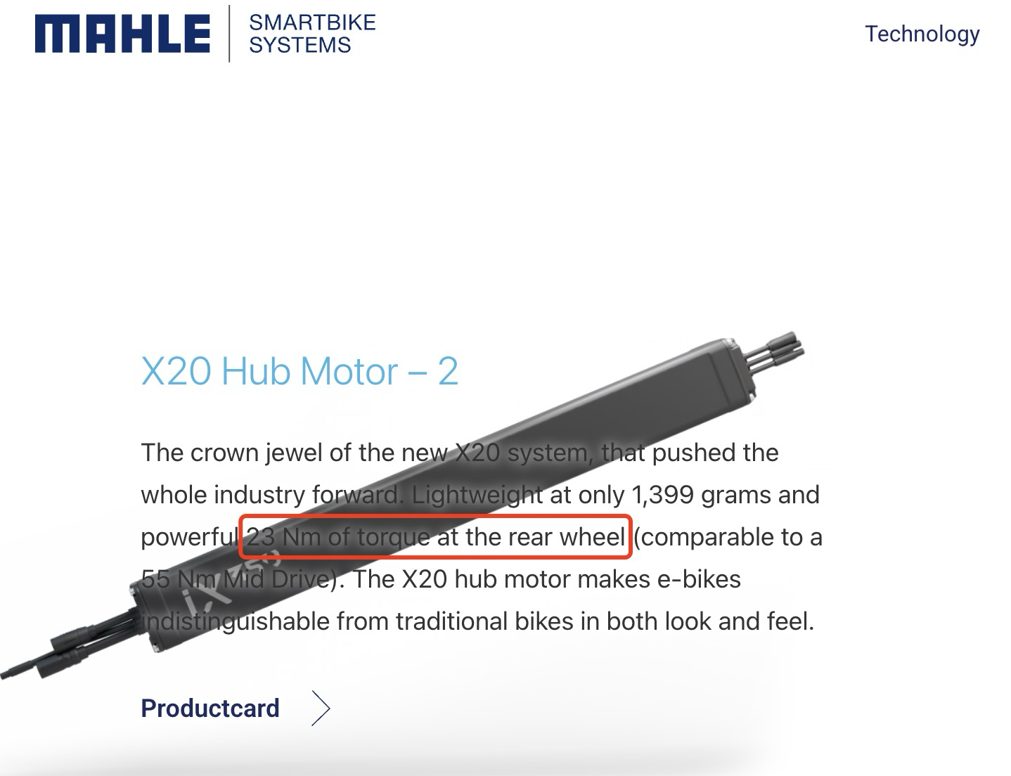

Strange, their own web page description states 55nm rather than 23nm.
maybe you'd need to test ride one to see how it works for you.
If this were a mid-drive motor, the formula for torque is Peak Motor Power divided by 6.28 (60 rpm in radian per second). Take a 240 W Specialized SL 1.1 motor with 240 W peak power. The torque at the motor spindle it 240 / 6.28 = 38 Nm. Specialized marketing department has rounded it to 35 Nm. The SL 1.2 motor has its mechanical peak power of 320 W. Divide it by 6.28 and you get at the advertised 50 Nm.
The matter with hub-drives is different. The hub motor has a different rpm figure. It acts directly on the rear wheel. Mahle x20 is a 250 W peak power motor and the 23 Nm at the rear wheel sounds reasonable at 100 rpm. Mahle or Scott marketing department must have multiplied this figure by 2.4 with the following reasoning: 'If the actual torque at the rear wheel were 23 Nm and the bike gearing is 2.4, what equivalent mid-drive motor torque would be necessary?' Just the marketing crap, nothing real.
Torque without the reference rotational speed means nothing.
Juggling the torque figures makes no slightest sense. It is the motor power that matters. Only. Which is 250 W for Mahle x20, 240 W for SL 1.1 and 320 W for SL 1.2. Torque does not drive the bike. It is the power.
Strange, their own web page description states 55nm with no mention of 23nm. Maybe a matter of max vs continuous or to meet regulatory requirements.
the actual torque from the motor is 23nm max. they scale it up for marketing purposes because most of the time a mid-drive is actually geared way up by the bike’s chainrings and cogs - imagine you’re riding a mid-drive with a 50 tooth chainring up front and you’re in a 20 tooth chainring in the back. every turn of the motor turns the wheel 2.5 times, so the torque at the wheel is 2.5 times LESS. its a bit of a lie, IMO, but there is some basis to it for typical riding since typically One cycles around on flat ground with a 2-3x gear ratio. go up a steep hill, however, and on a bike with gears and a mid drive you’re probably going to end up closer to a 1:1 gear ratio, the 23nm of the x20 is still 23nm, but the 55nm mid-drive is now.…. 55nm at the rear wheel. which is a lot more ;)
