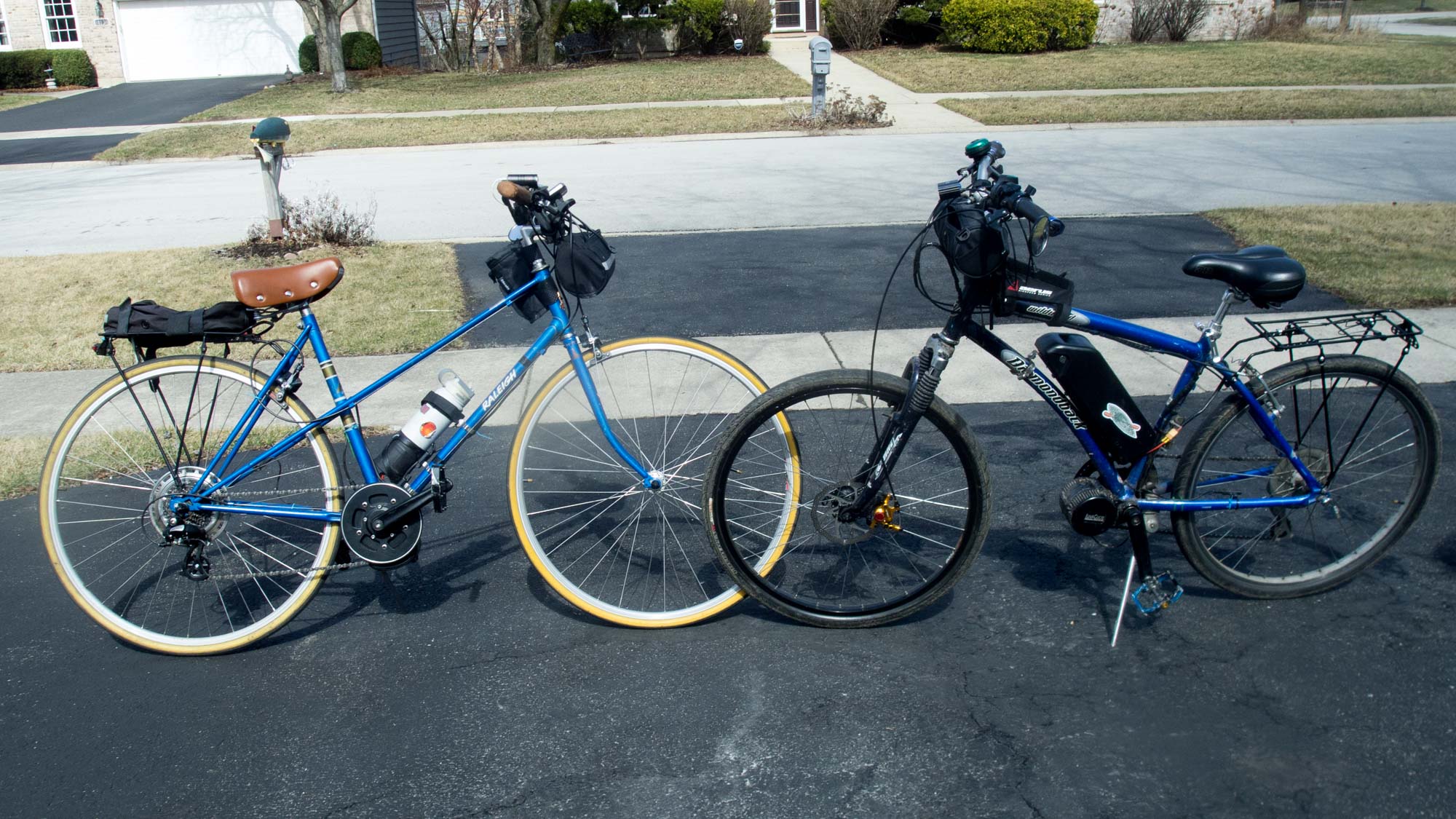

I have those UPP water bottle packs too, 36V10AH and 48V7AH, both with a nominal 350WH rating, Real life is about 300 WH, and I typically get 33-34 miles if I run them flat. AT home, we rarely go farther than 22-24 miles, Come home and recharge for the next ride,
I have a really old Luna 52V6AH mini, Have only used it about six times in 9 years, It's just too unwieldy. A 13 cell 48V pack with 21700 cells makes for a easy to carry spare though,
