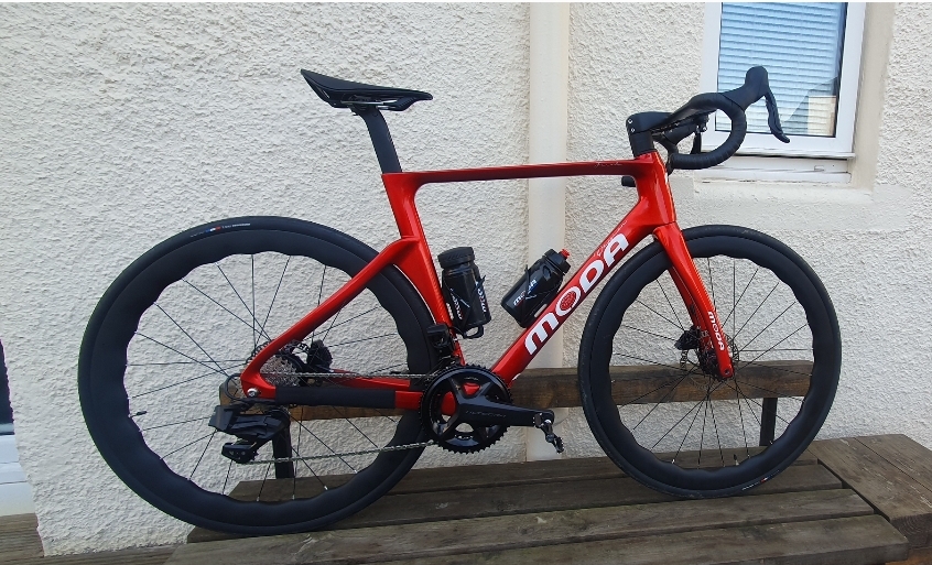

The through axle keyde does in fact work very well. I combine it with diy bottle batteries on non X35/x20 eride frames, using the di2 holes for internal cabling. I have attached a pic of this conversion on my moda. The S110 or Through axle is the best suited for this type of conversion as it is silent. The P110 although more powerful is noisy and has more drag.

The S110 is not through axle. You need to order the through axle motor instead. The 10ah battery is quite big. I'd go for 2x7ah batteries, which are closer to bottle sized. The Keyde ones are quite nice, but you can use any 36v or 24v battery to power these motors. If you have somewhere that builds batteries, I'd get someone to make you proper 5ah bottle batteries. They are very neat. However the 10ah battery will fit in the bottle cage fine, and give you decent range. If you are in the UK and want bottle size batteries, let me know and I will price them up for you.
