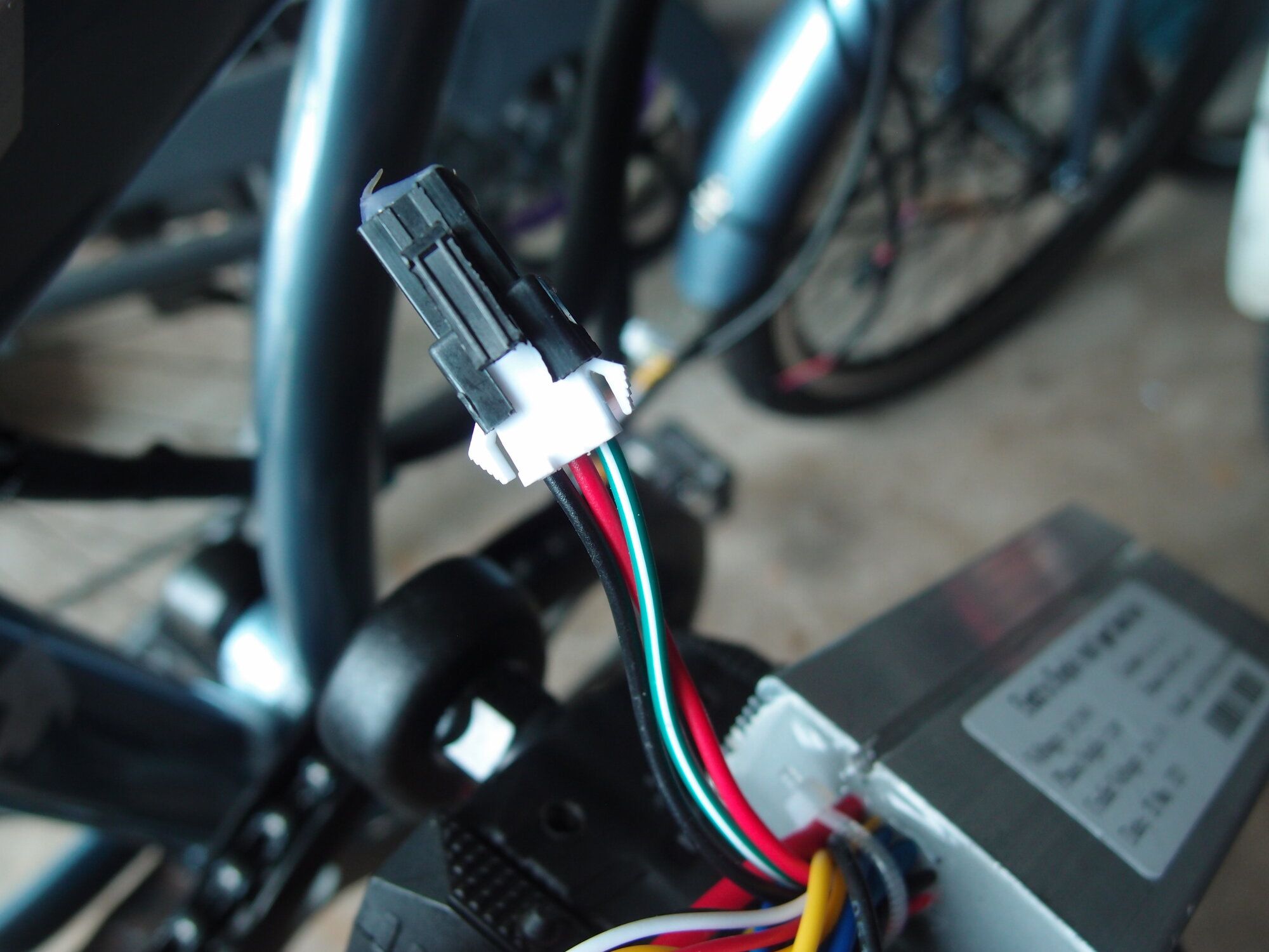

Throttle does work with the stock controller. It's the three pin white connector that has a cap on it.
Black is ground. Red is +5V. Green/white is signal. Couldn't find a bike computer in my junk box, so I don't know the speed,
I didn't find 36V on the unused 4 pin connector, so I ruled it out as compatible with my 4 pin 810LED's. I'm not that familiar with other controllers that have no displays. They often have a handlebar control to select one of three power levels. so this 4 pin connector and the other un-used 3 pin connector must deal with that, Oh well, I'm upgrading to my KT unit. You might find the bike flexible enough with just adding the throttle.

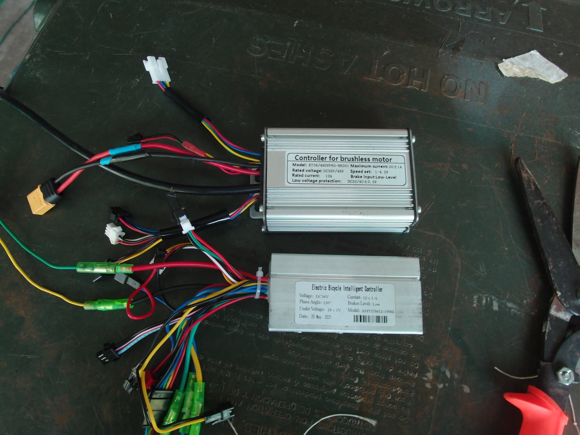

Here's the difference between a 20A KT controller and the 13A Huffy model.
There should be room for it inside the plastic compartment in front of the battery My KT unit is already wired with the 9 pin motor cable. Usually, I need a speed sensor in the motor or on the back wheel for a KT controller to read speed when coasting, but the LCD9 seems to do it w/o a speed sensor. The Huffy wheel doesn't have one.
So it's just a matter of splicing into the battery. and adapting the Huffy brake and PAS sensor connectors to match the KT. The throttle and display are from KT and match the controller already.

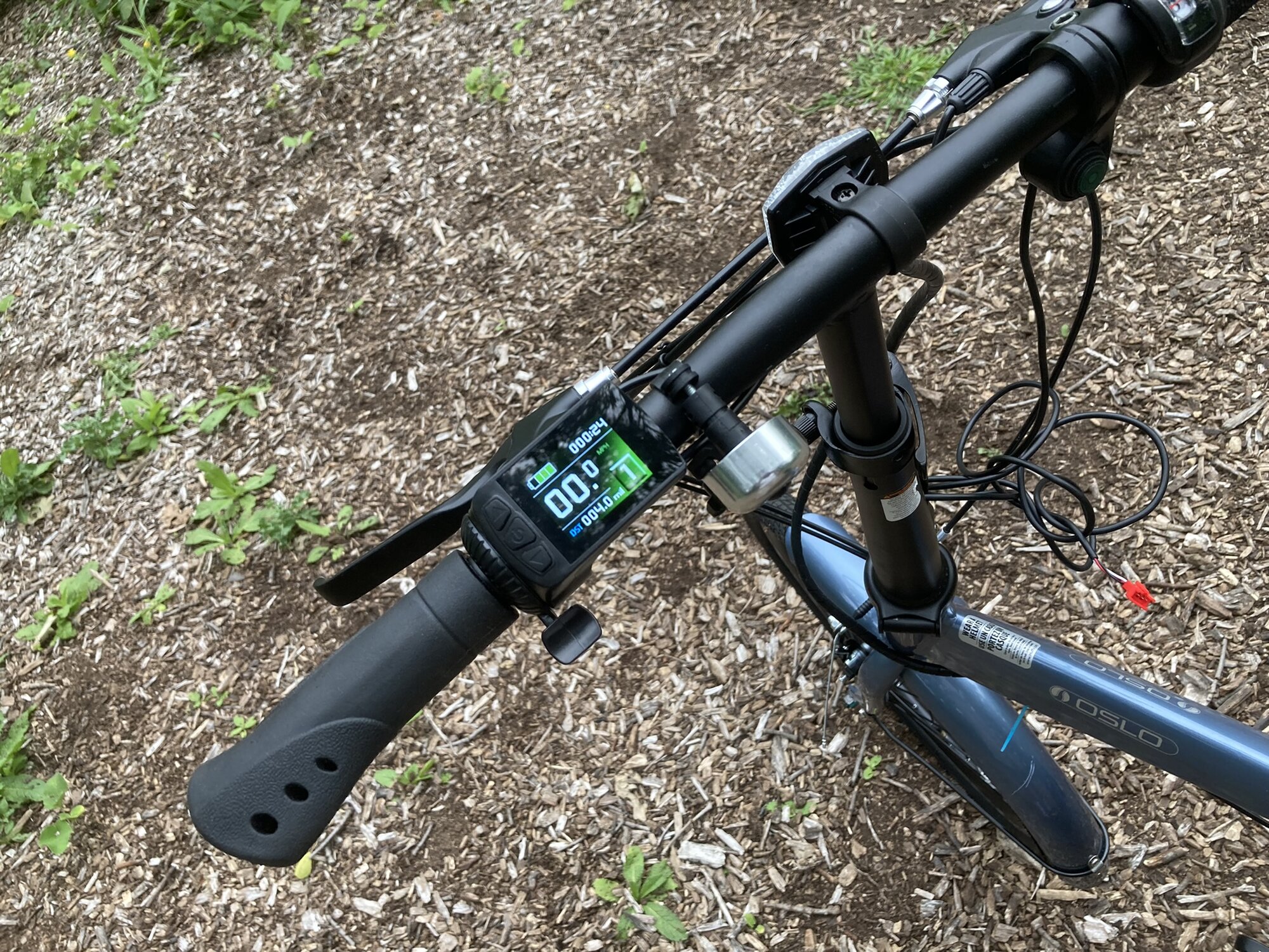

Done. I had to put in a different PAS sensor. Must have pinched the cable on the Huffy unit. This is the KT LCD9 display. It's my color model and is easy to see. Shows watts, voltage, mileage, speed, distance, but on different screens.
The pedal response is far better, but I can't pedal much over 16 mph. The gearing is too high, as is typical of 20" folders with a 14-28 freewheel. I'm not willing to throw another $30 for a DNP 11-28 freewheel yet. Throttle will take me up to 18 mph. The ride seems more forgiving than my other folder, but the tires don't roll like the Schwalbe tires on that bike.
The seat has weak springs, and my butt has them fully compressed. All told, it's the usual scenario, Bike needs better tires, better seat and gearing changes. However, the rim brakes seem fine.
The battery is a bit small. I will install a y-cable for an aux battery in parallel if I keep the bike.

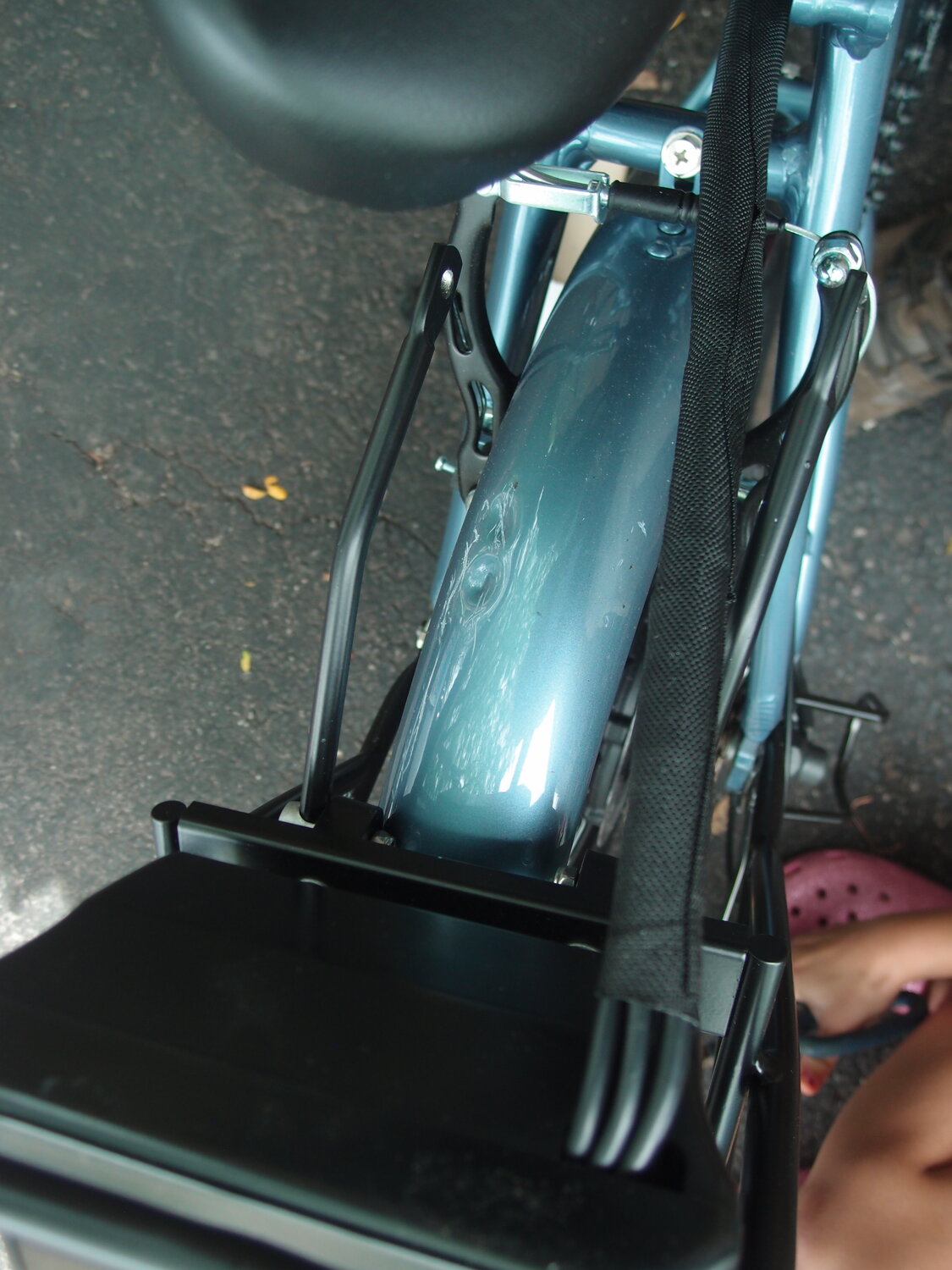

Got mine! ... but a piece of the rear rack snapped off and rear fender is horribly bent, lol. Seems like I lost the gamble, lol. Will test the bike later to see how it rides in general and decide what to do next.
sorry to hear that! my rear fender was a bit bent too (in toward the tire). sounds like yours got it worse. hope they take care of you!

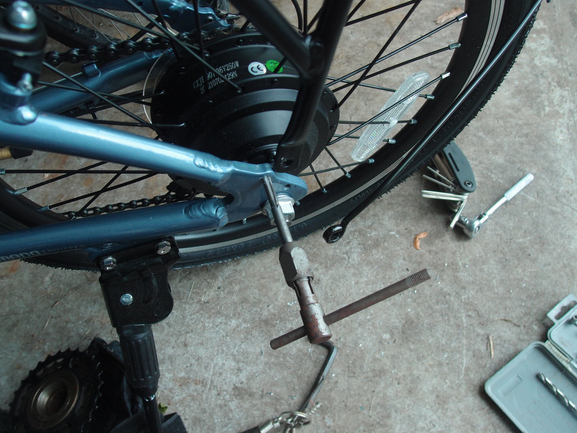

The mounting screw on the left side of my battery rack had worked loose in the box. and stripped the threads in the frame. Top of the fender had some dents from the rack bouncing on it.
Those screws were too small anyway. I rethreaded them for the next size up, 6mm, I believe.
For $364, I wasn't going to send it back. as buyer pays for shipping.
