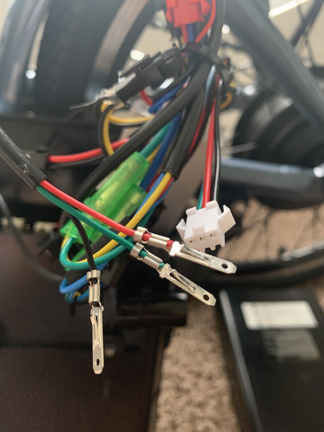

Ugh this is not plug and play...purchased a three wire thumb throttle off Amazon and the wire metallic plates are too thick to fit into the existing three wire input on the bike controller; what do I do? Thanks in advance

Most of us would just splice that, You could return it and get the one zannymanny used, but then you'd have to splice in the power for the LCD you paid for.
If you cannot solder, there's plenty of room for alternate splices. Twist/tape is crude, but will work. Little wire nuts too.

Hi, I recently purchased the throttle and WS hoping you could provide some guidance. Not sure what to connect? Thanks for your help.
Recently purchased the throttle and WS hoping you could provide some guidance. Not sure what to connect? Thanks for your help.
Three of the wires are easy just plug into an existing three wire red/black/green-white on the bike controller with a plug on it; the other two will require you to splice into the wires that control the power and were too complicated for me so I didn't get that throttle
You might consider this one. It has three free pins that you insert into a plug to match your wires. This should work, as it's a male JST plug and the Huffy uses a female JST, the white one as shown in Fubag's picture. If I had seen it when he posted his problem. I would have suggested he get this one and retirn the other,

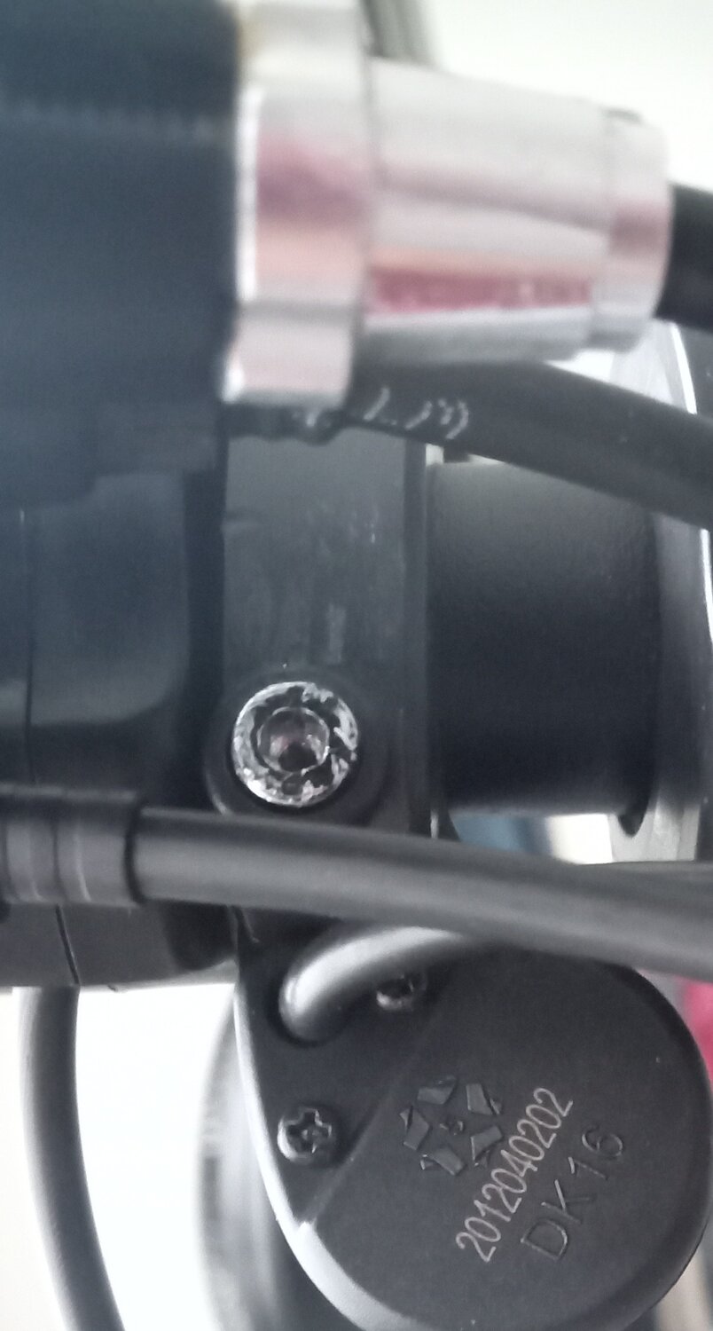

Embarrassing to ask but I mightve stripped the screw that holds the pedal assist power button on the handlebar...was using a T15 screwdriver head that worked the first time I removed it and reinstalled it but now I can't unscrew it to take it off...any thoughts or am I *screwed* lol
It's not a Torx. It's like a 3mm hex. Maybe a 2.5mm, whatever comes in those swiss army type wrench kits. The only time I've seen Torx on a bike are the fasteners they use on disk brake rotors.
