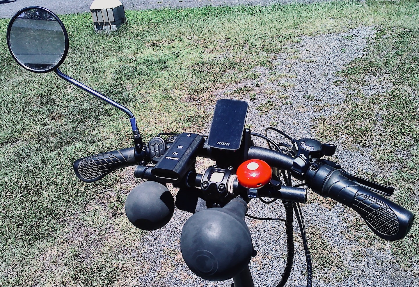

My Abound was great unless I had to take a hand off the bar. It seemed as if one day I would go into oscillations from which I could not recover. For two weeks I rode the Radmission while I awaited a replacement part for the Abound. I noticed that the one-handed instability was less severe on the Radmission. The Abound's bars were 72 cm wide. The Radmission's were 67.
I swapped bars and the Abound felt more stable. I realized why. Legs can't absorb all lurching on bumps. Most of the pressure from a lurch probably happens at the base of the thumb, about 9cm from the end of the bar. The one-handed torque I would have to apply against a lurch would vary with the distance of the base of my thumb from the center of the steering tube. With a 72 cm bar, that would be 27 cm. With a 67 cm bar, it would be 24.5 cm. 24.5/27 =0.907. One-handed, it took 9% less torsion to maintain control with the 67 cm bars.

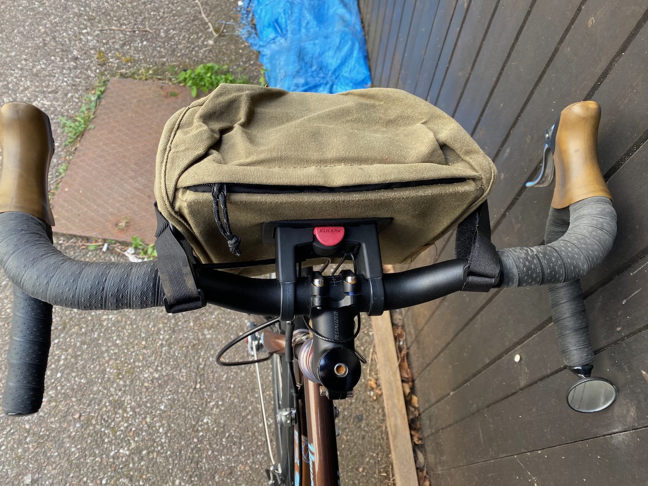

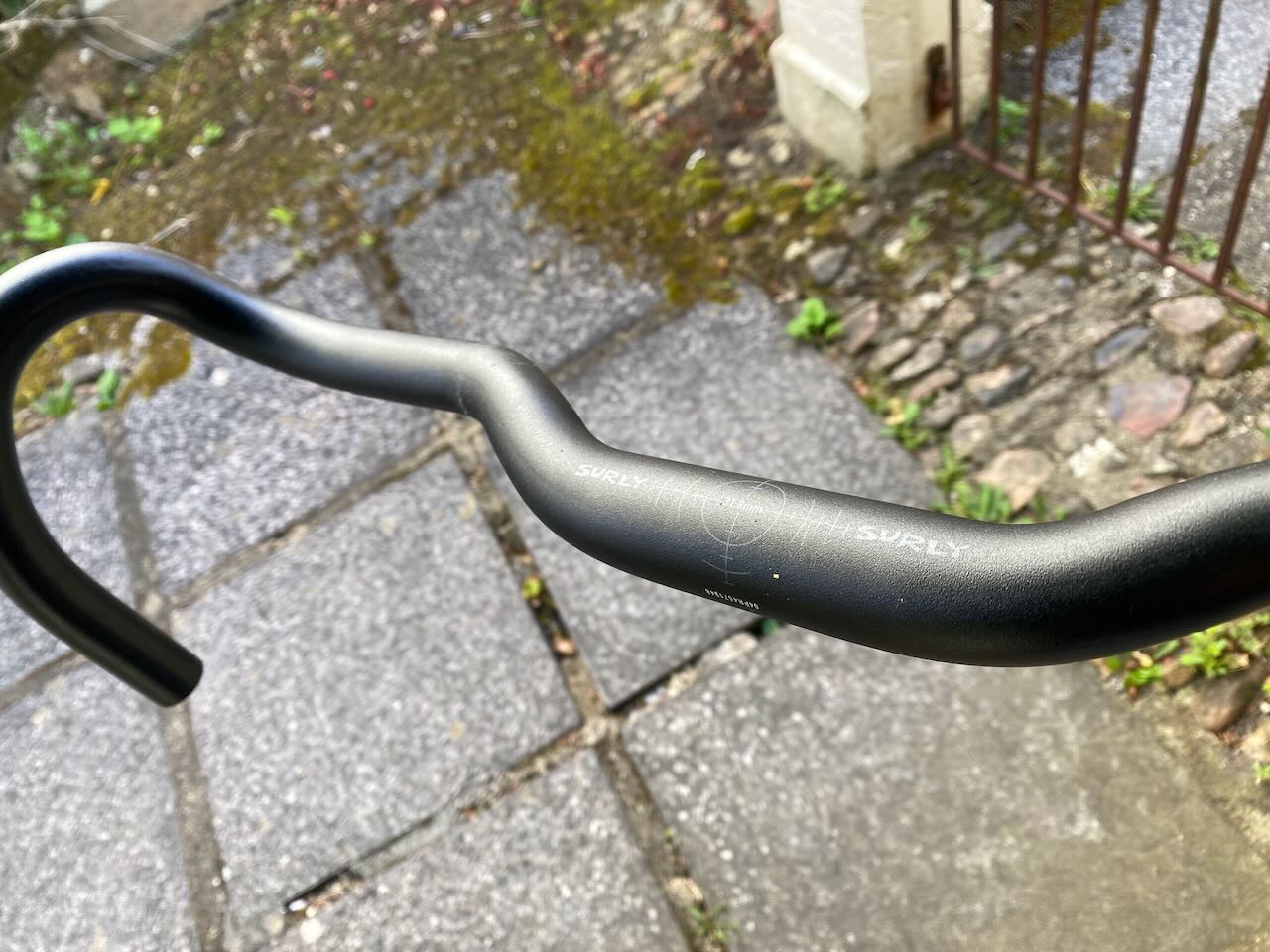

For road or gravel, drop handlebars it could be anything from 36 to 48 cm, depending on the rider's arm spread. Gravel handlebars are flared to increase the hand spread in the drops for more precise ride control in rough terrain.

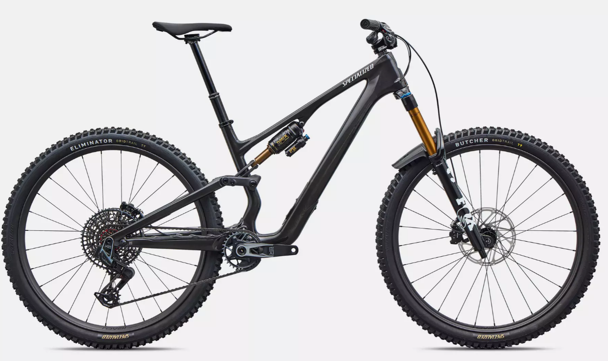

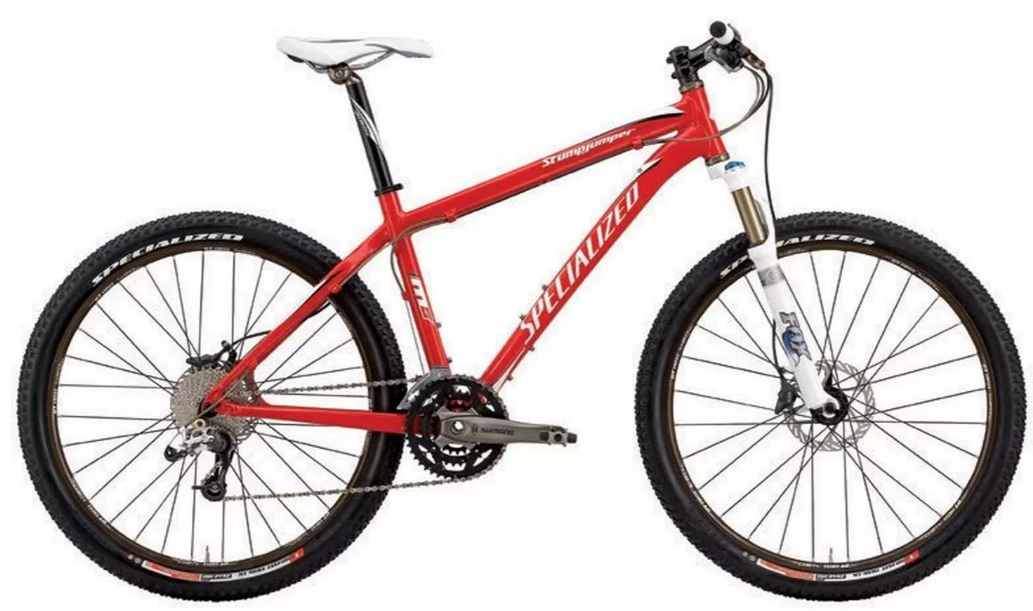

MTBs -- depending on the subtype -- can have anything from 75 to 85 cm.
