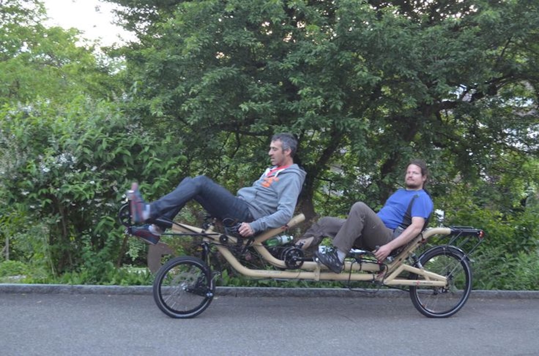

I loved the Earles forks on BMW motorcycles prior to 1969. Each swingarm had more than one axle hole, allowing the rider to change trail. Now I've found a photo of a bicycle with an Earles fork. Think I could put one on my
Abound?
