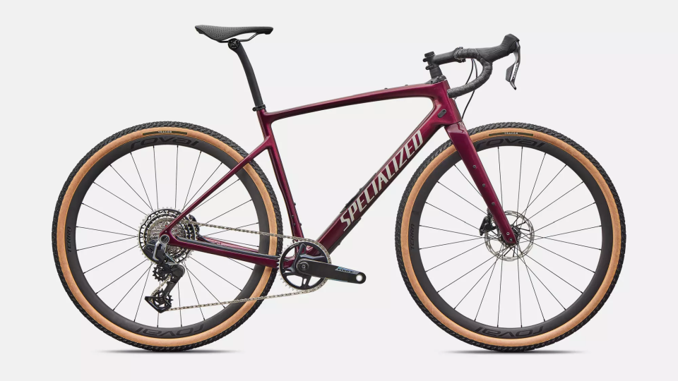

But honestly. There are two flavours of gravel bikes:
  • Racing geometry, extremely lighweight, totally unequipped (just for racing)
  • Relaxed geometry, heavier (could be even steel), with multiple equipment bosses: for several water bottles, tools, fenders; frame, handlebar and saddle bags and even fork bags could be installed as well as detachable lighting. These are for bike-packing.
The very specific feature of a gravel bike is it is very fast on paved surfaces and pretty fast off-road. However, a gravel bike is not the thing for a technical singletrack.

Perhaps I should have explained that first. A gravel bike is:
  • A specially designed version of a road racing bike for fast riding asphalt, gravel and off-road

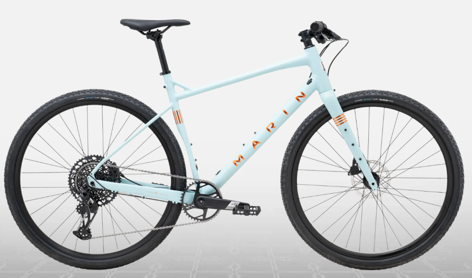

  • Usually, a gravel bike is designed for drop handlebars although flat handlebar gravel bikes exist, too (see Marin DSX 3)
  • A gravel bike has no other suspension than its own tyres. Some gravel bikes have a sort of suspension for the stem and/or seat-post
  • The tyre width is usually 38 to 55 mm on 700c wheels. The most typical size nowadays is 700x45c
  • A gravel bike often comes with a dropper seat-post
  • The frame is designed for pretty wide tyres
  • The bike geometry is relaxed, allowing the rider spending many hours in the saddle without getting much tired
  • The drivetrain is a hybrid between a road and MTB type. It supports drop-bars but the gearing is more of the MTB type: more rugged, and it is geared a way lower than for a road racing bike
  • Although the 2x drivetrain is still popular, you will meet a 1x drivetrain on a gravel bike more often than on a road bike
  • Gravel bikes need to be really lightweight. The rider has to be able to carry the bike over an obstacle as bunny-hopping is rather not done by gravel cyclists
  • Often, the gravel bike frame is made with multiple bosses for the equipment needed on very long rides.
A typical modern gravel bike.
A typical modern flat handlebar gravel bike. The fork for such a type is usually made of carbon fibre.

So..... It seems from all the info provided, a gravel bike is more like a road bike, except with fatter tires.
It is the most simple definition, yes. The devil is in the details, though. For instance, gravel bikes are usually equipped with "flared" drop-bars. That is, the drop is wider than the hood area. It is for greater stability in rough terrain. Gravel bikes are more rugged than respective road bikes.

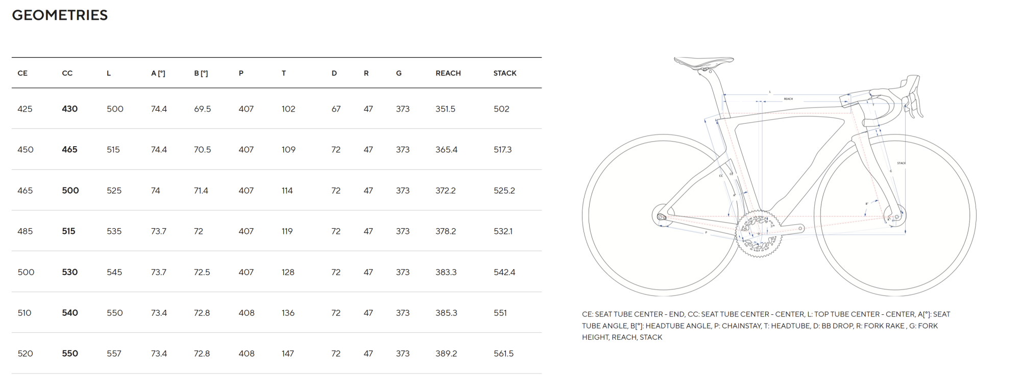

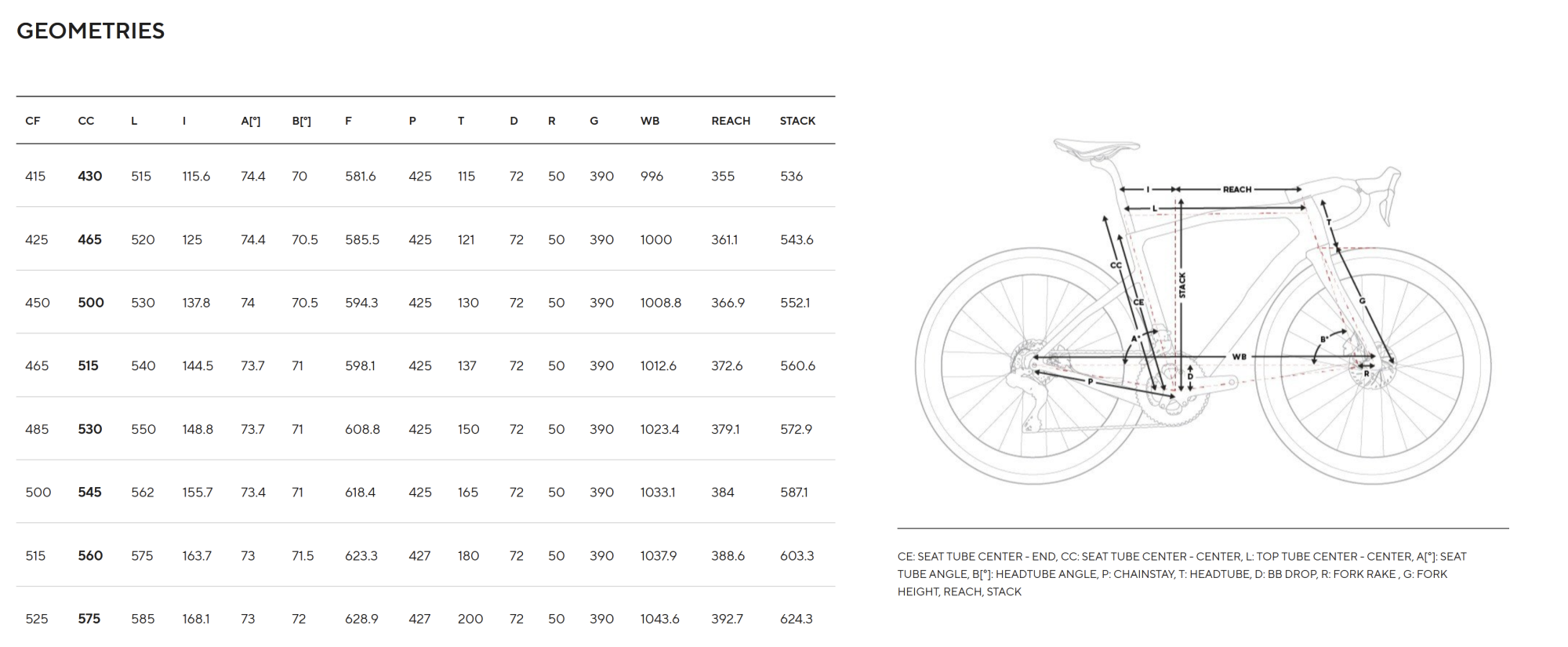

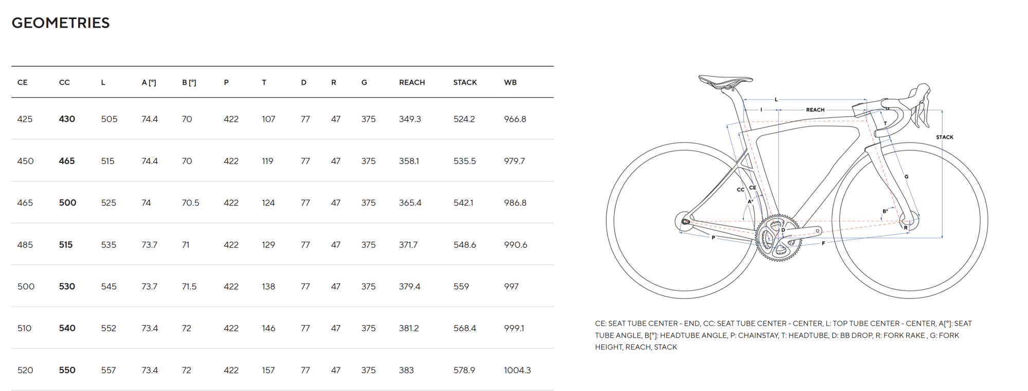

If we are not talking about e-bikes, here is a comparison of the geometries of a road bike, comfort road bike, and a gravel bike.
Pinarello Dogma F1. This is a WorldTour class racing bike.
Pinarello Dogma X1. This is a high end comfort road bike.
Pinarello Dogma GR. This is a high end gravel bike.
For any given frame size, pay attention to the overall length, the head tube and seat tube angles, the head tube and chainstay lengths, and the reach and stack. Think about how a rider would be positioned on each one, using the bottom bracket as a reference.
Road bikes have the tightest geometry. Shorter length, more forward and aggressive position, shorter head tube.
Comfort road bikes are similar, but are longer and less aggressive, with a taller head tube.
Gravel bikes are even more relaxed than a comfort bike.
For wheels and tires, road bikes generally use 28mm-32mm tires, comfort 32mm-35mm tires, and gravel bikes 40mm-50mm tires.
For gearing, road and comfort bikes are almost exclusively 2x, but gravel bikes can be 1x or 2x.
Some gravel bikes have a front suspension fork (i.e. Lauf) but most do not. They may have a suspension or dropper seatpost.
Have at it.

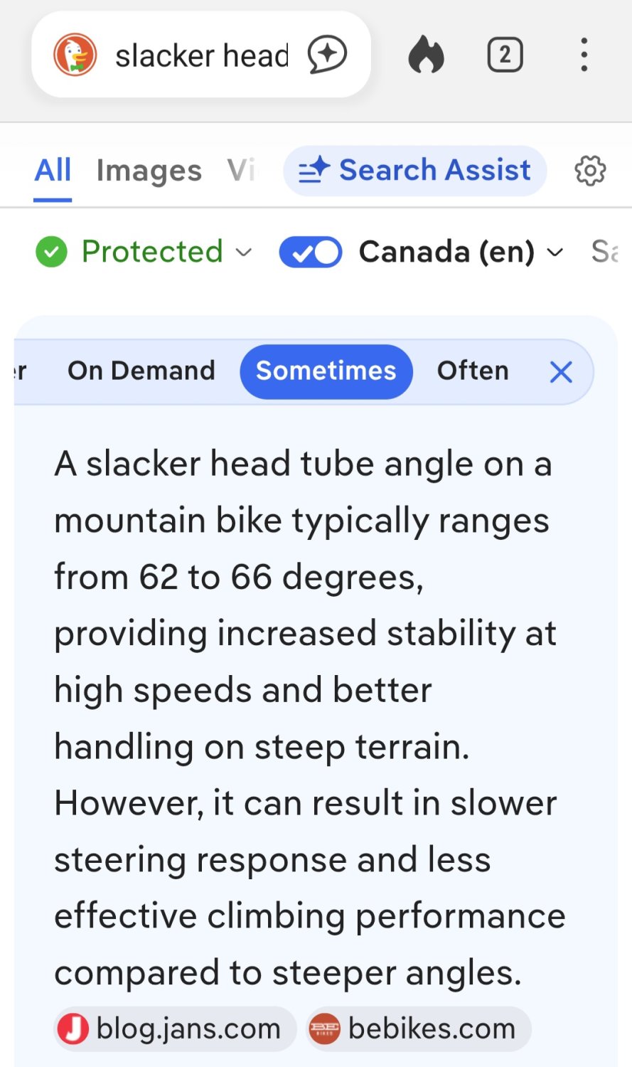

I'm just a slacker that doesn't like to pay attention in class. Lol

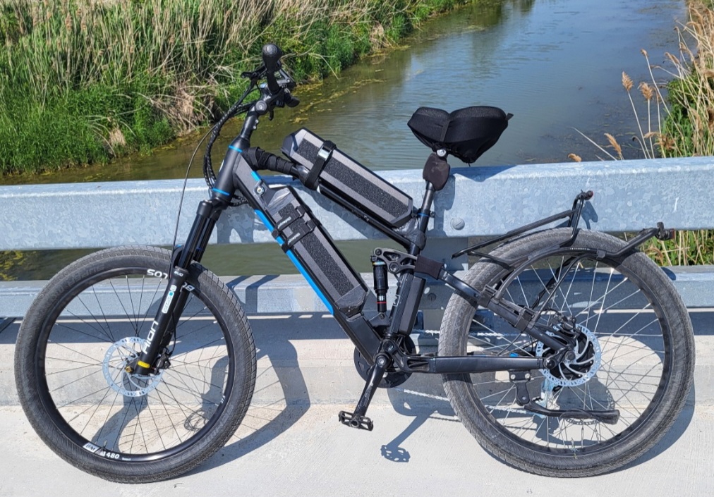

@6zfshdb if it were me, and I were to start over, I'd skip all that Fat Bike nonsense, and buy the downhill frame that I always wanted,..
I just found this on AliExpress:
C$1,898.68 | Suspension Bicycle Soft Tail Frame,Trunnion MTB Enduro DH XC AM Cycling 29/27.5ER Boost 148mm DDP Full Suspension Bike Frames
Now I want one !!??@#
I can just swap all my parts??
It should be able to handle two motors and two batteries. 😂
My frame is Too Fat.
It's got a skinnier front end now but it's got that Shitty Quick Steer rake angle crap that I Hate !!
