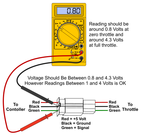

Sorry, I haven't taken apart a Lectric One. However, many/most displays have a pin going to them with battery voltage and should also have ground. You may be able to tap into that. You could test that with a multimeter.
I'm not sure if Lectric uses a proprietary throttle or not, but most 3 wire Hall sensor throttles operate like this:

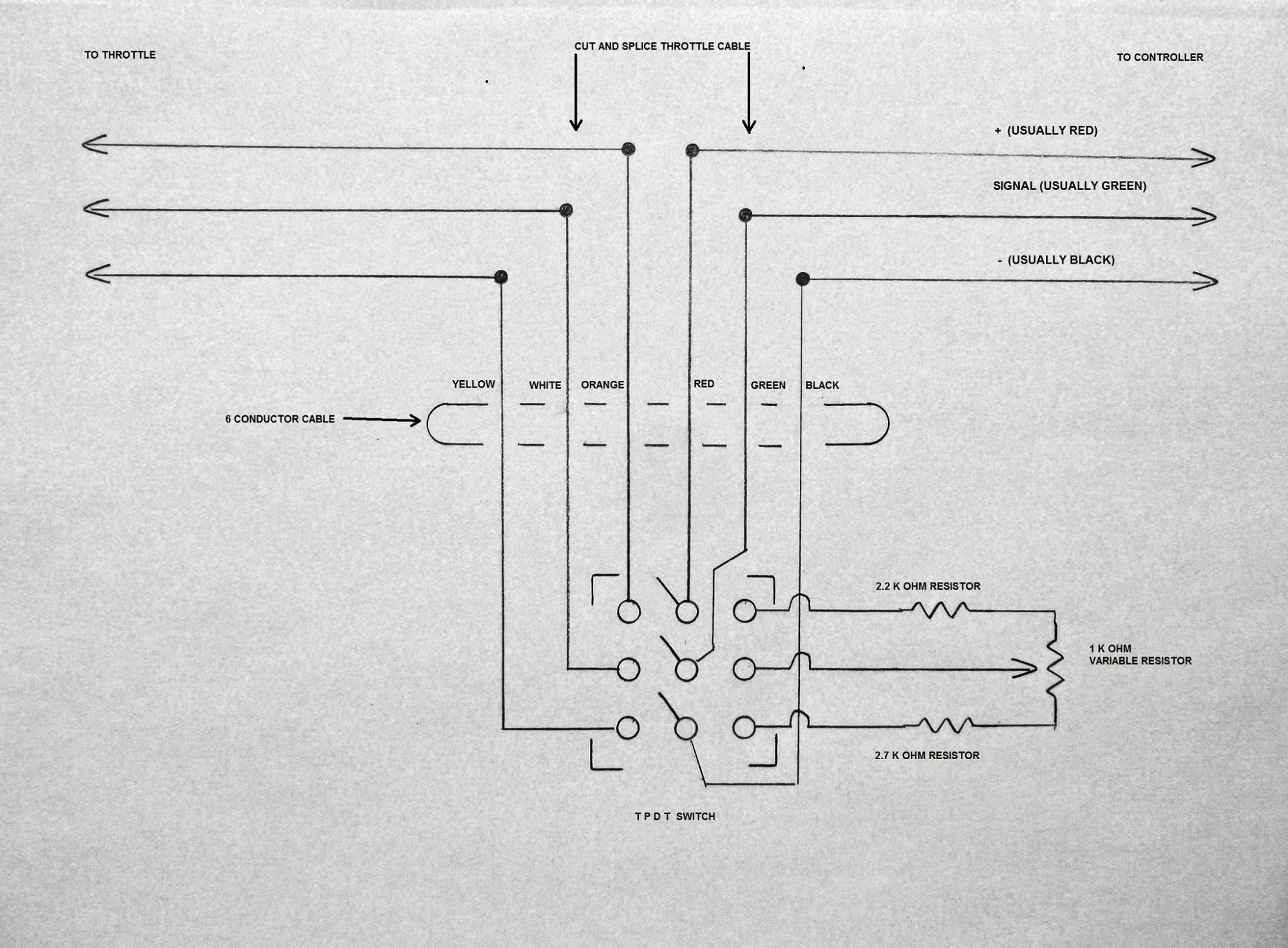

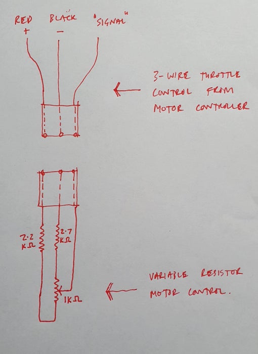

FWIW, I find a twist or thumb throttle is great for starting, especially on a hill if you forget to downshift. However, maintaining a constant speed with one of these throttles, even a properly proportioned one, can get uncomfortable after awhile. After just a few minutes, I get cramps in my thumb or wrist while trying to hold the throttle steady.
As a result, I did some experimenting and found a Hall throttle sensor can be emulated using a series of resistors. If a variable resistor (pot) is used, as in this circuit, speed can be varied, and held in position, by turning a knob. In effect, It's a form of cruise control.

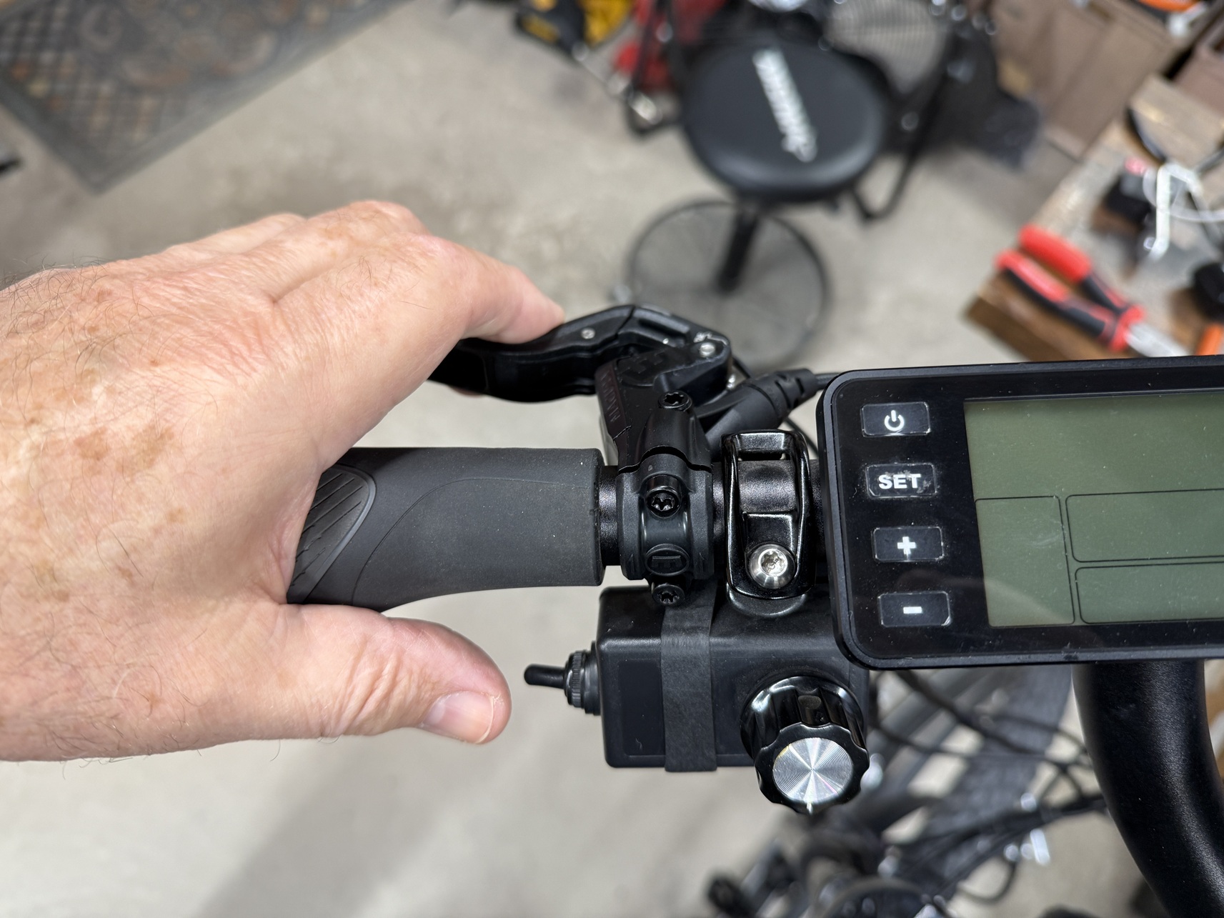

Using this principle, I built a handlebar mounted "black box" speed control that can be switched on or off:
Here's a link to a thread on how it was done:
