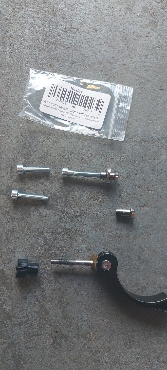

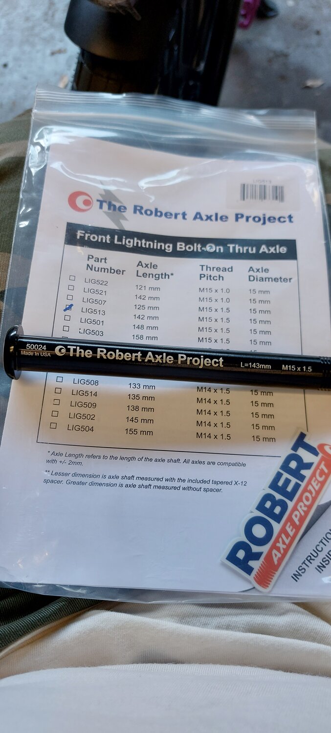

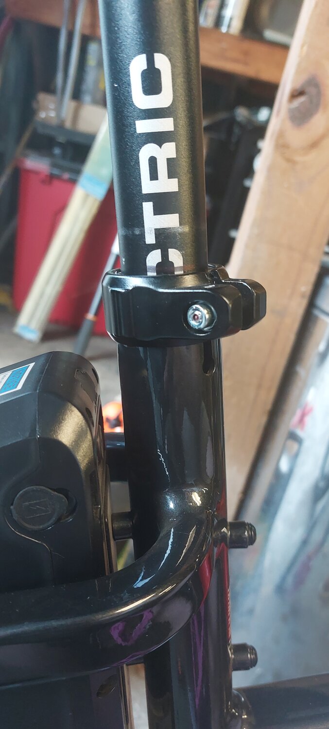

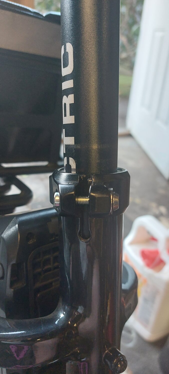

I ordered 2 quick release anti-theft seat clamp conversions (one for the ONE and the other for the Xpedition) from HexLox. I also ordered a HexLox thru-axle for the front wheel of the ONE. I'm pretty sure I got the measurements correct on the thru-axle. Will post pictures and the axle size once I confirm everything fits/works. I don't want no bum types nabbing my seats!

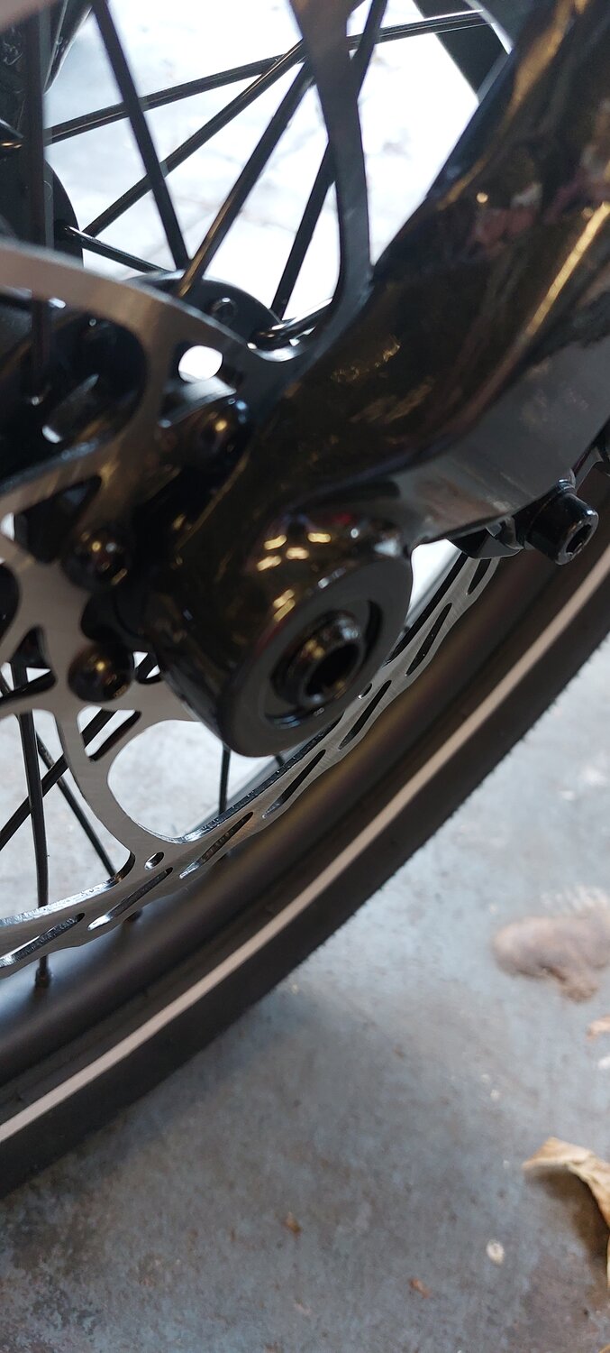

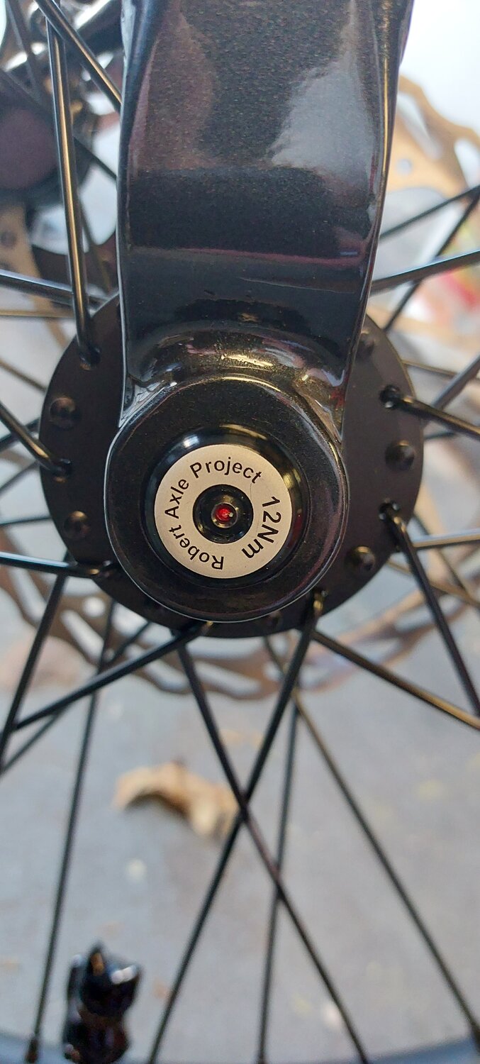

Front wheel security courtesy of HexLox. This size fits/replaces the original quick release front thru axel.

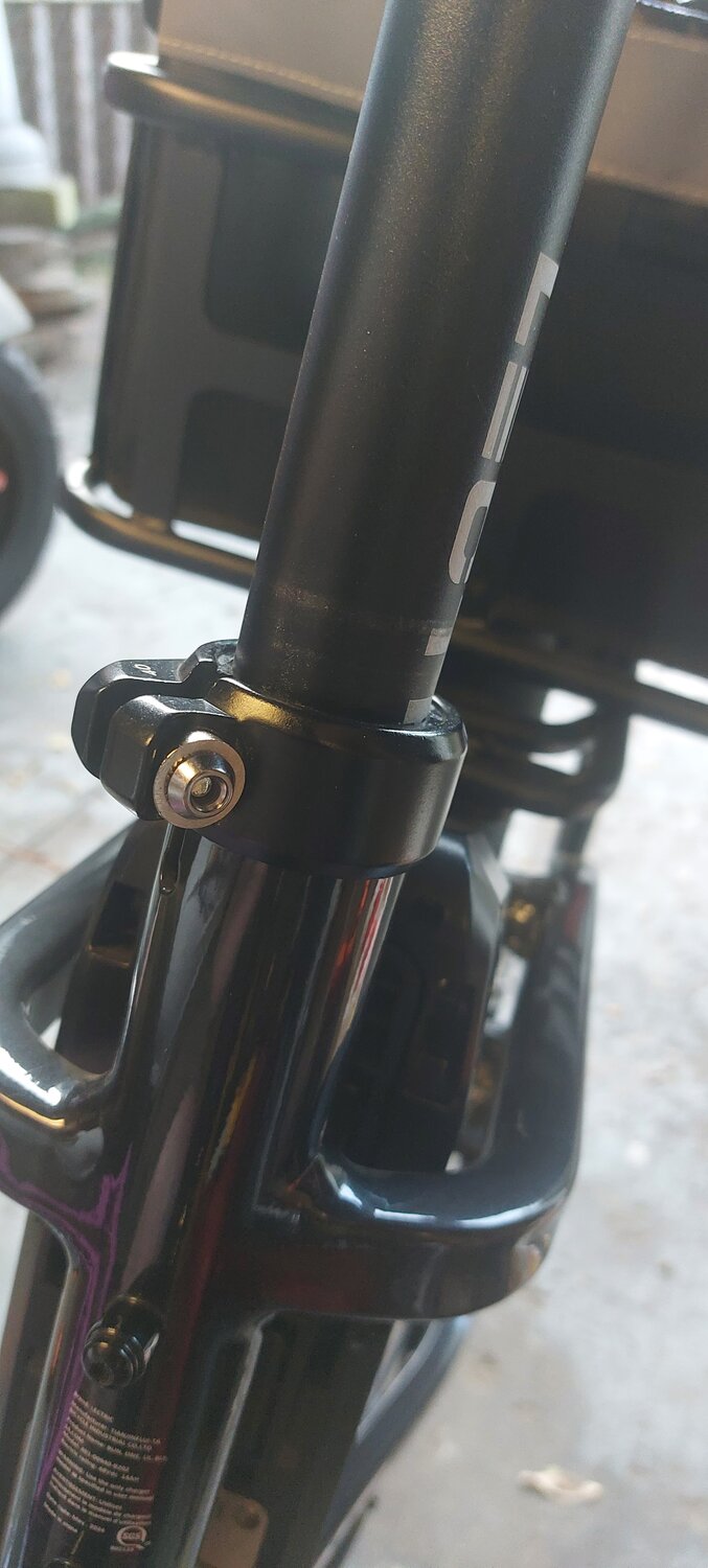

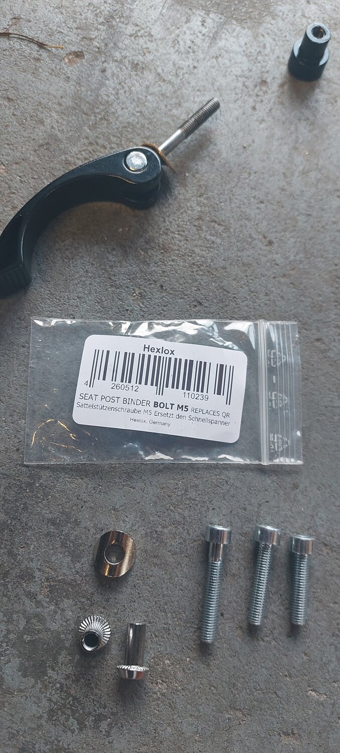

Seat security courtesy of HexLox. Kinda complicated but you'll figure it out from the pictures posted on the HexLox website. Ask any questions about eithe, or both, HexLox add-ons!

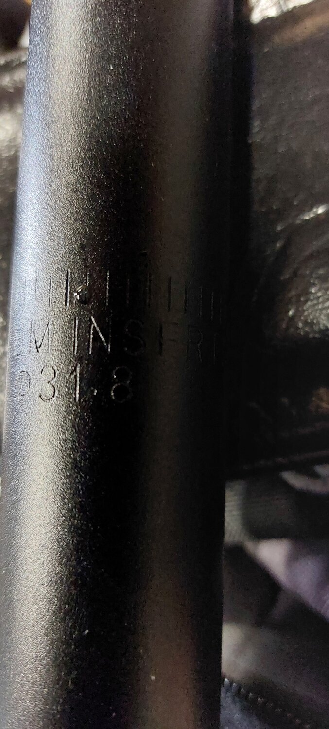

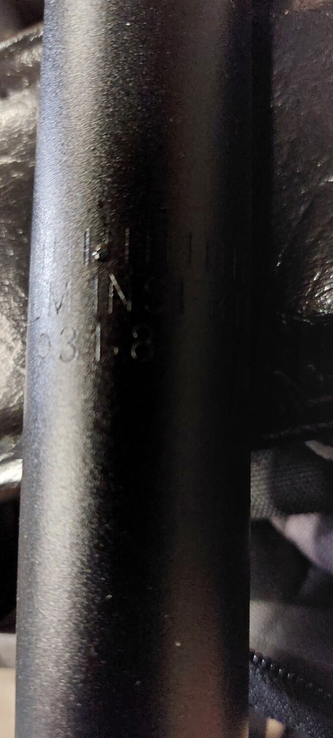

What is the seatpost diameter? Couldn't find it in the review write-up. I miss Court's attention to detail. Thanks.
31.8 is the size of the seat post. It's a weird size and when you order a, say, suspension post that says 31.8mm you'll get a smaller size with shims. The cheap Lectric pogo post is 31.8, so no shims needed. I have no hatred for shims but try to avoid them when necessary. Picture of stock post. It says. 31.8.

Thank you. I have a 31.6 Kinekt seatpost I could dedicate to this bike, if I take the plunge. Sounds as though I will need a shim. Looking forward to your comments as you use the bike.
