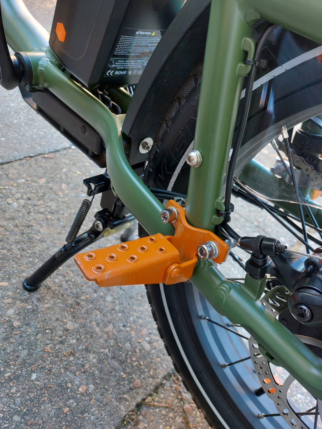

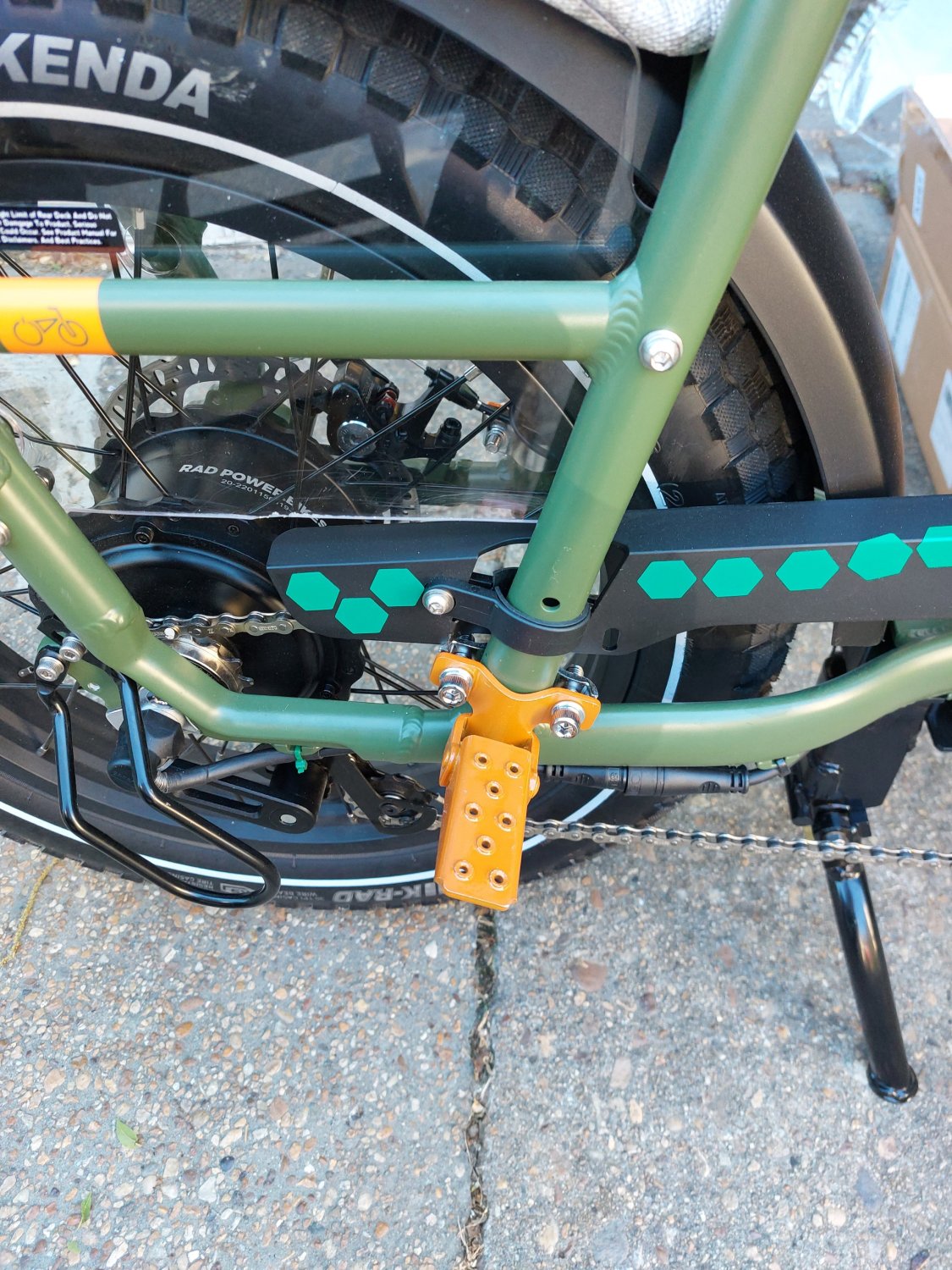

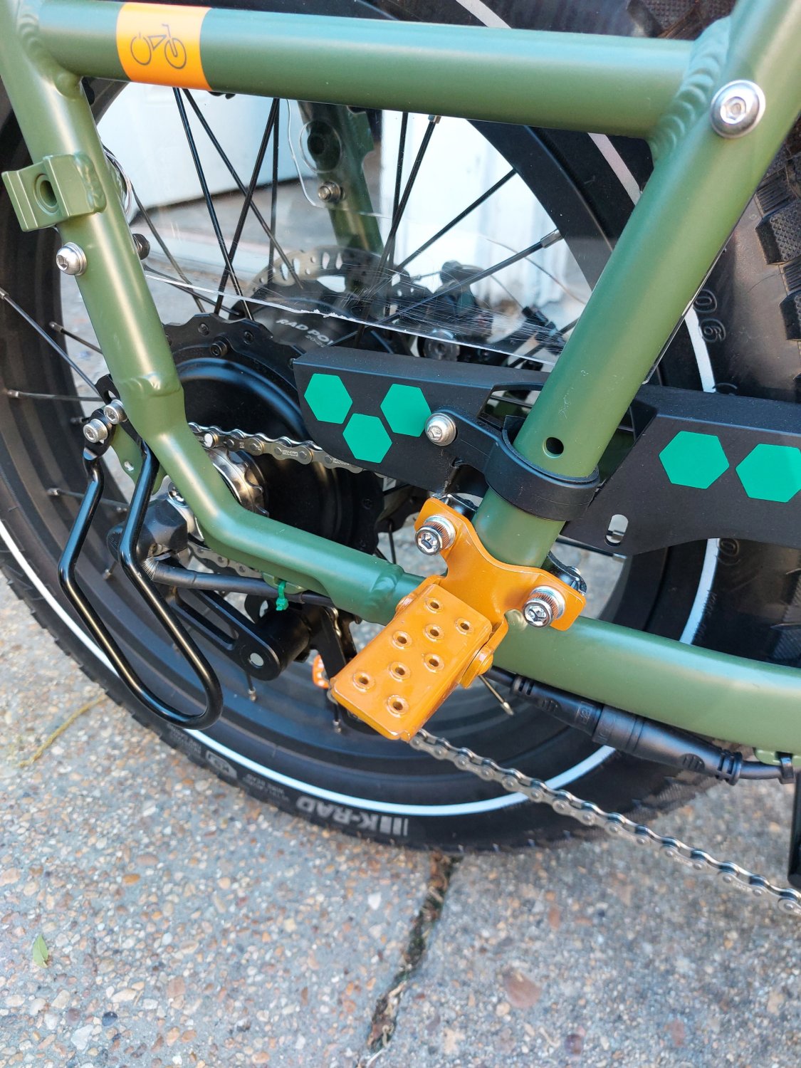

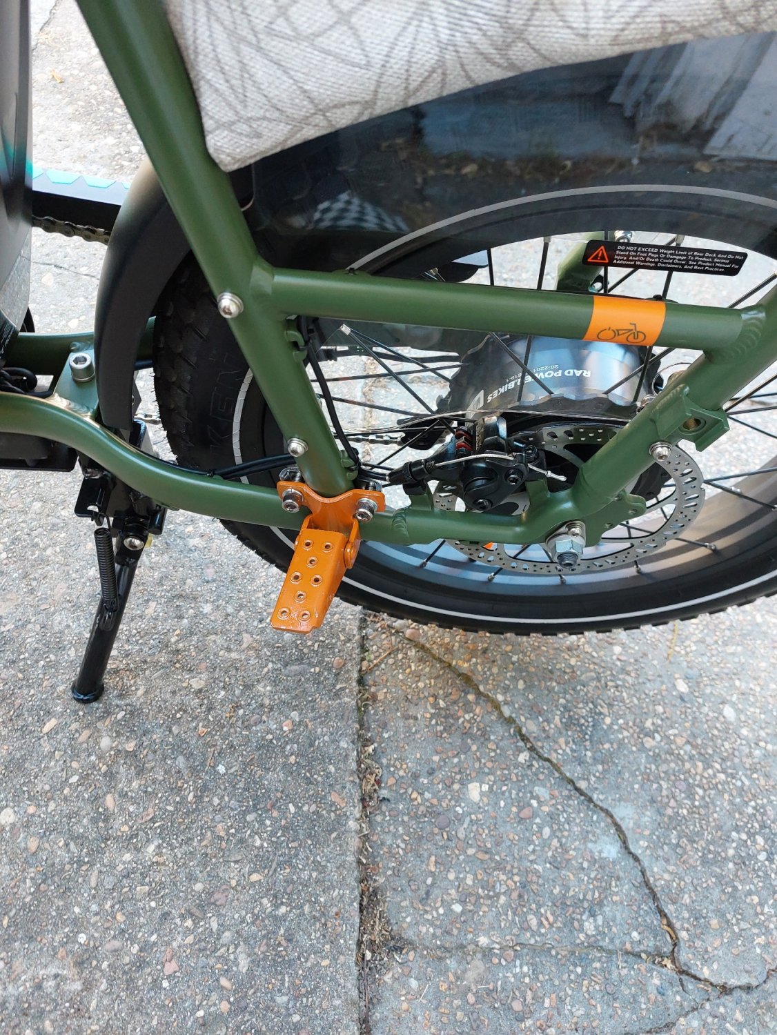

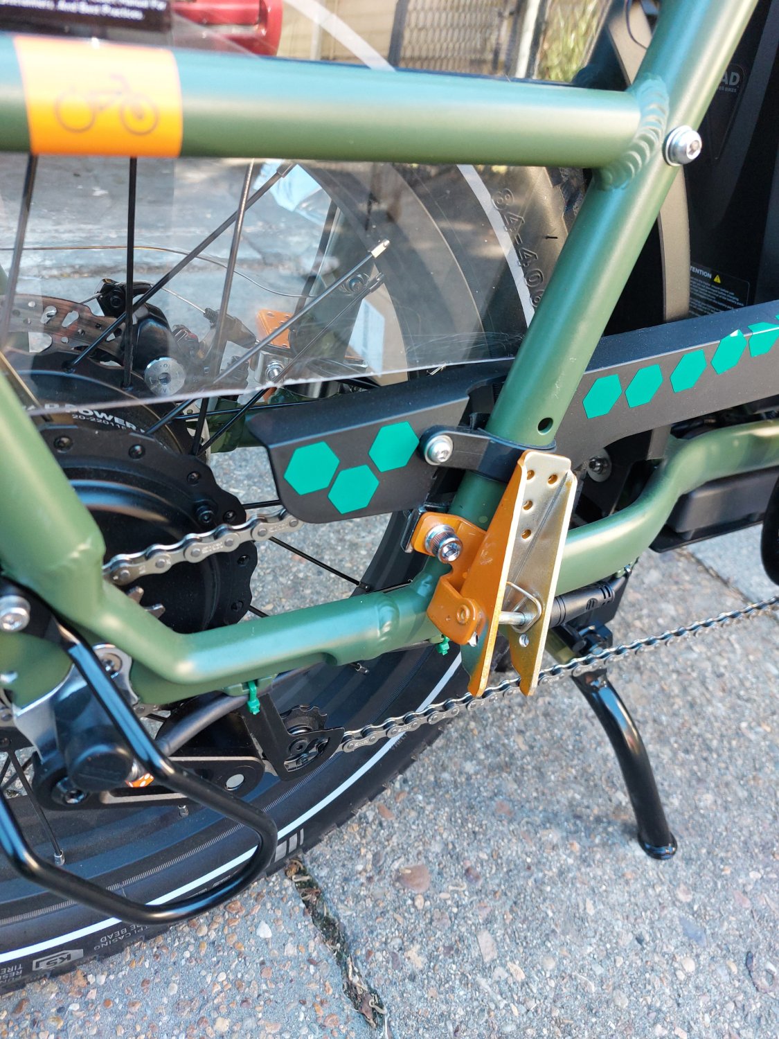

I need to post up some pictures but I ended up with a passenger seat kit. I used some GT fork standers for the pegs and they are much more comfortable for the passenger, and I can still pedal without interference! Yeah, I'm creative when needed! A few more notes:

Passenger pegs:
