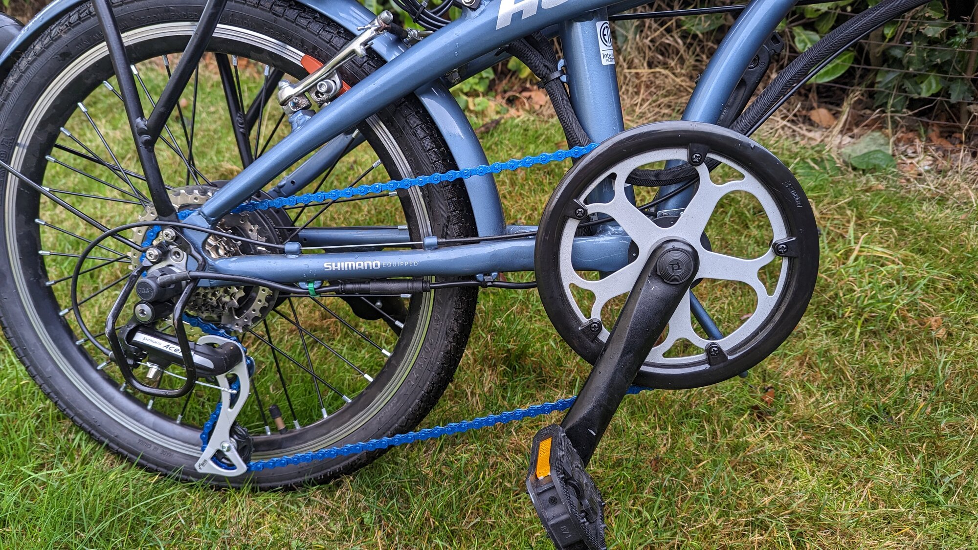

An update on my quest to make a more perfect Huffy Oslo. I had previously replaced the bike's controller with a KT 15a kit, and finally got around to breaking open the bottom bracket to install the cadence sensor as it is supposed to be. About the only thing that I found good and tight on that bike was that bottom bracket, had to slug that puppy apart. Then I installed a twist throttle on the right side and moved the twist shifter to the left.
When I find a suitable rear derailer I will replace the cassette with an 11-32 and put on a blue chain I found on ebay. After that I want to replace the flimsy brake calipers with some shiny aluminum calipers. Oh, and then a new seat.

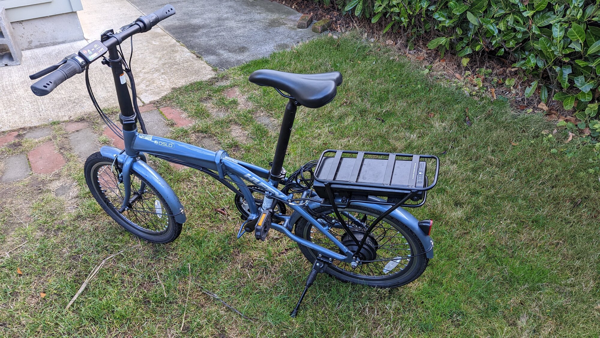

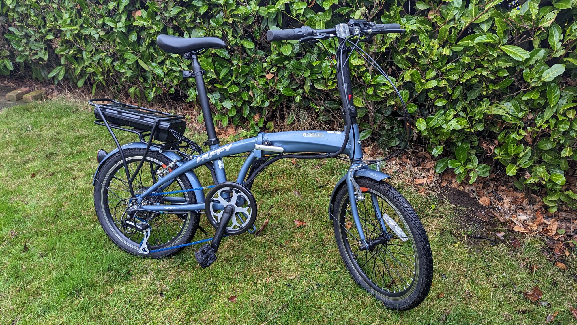

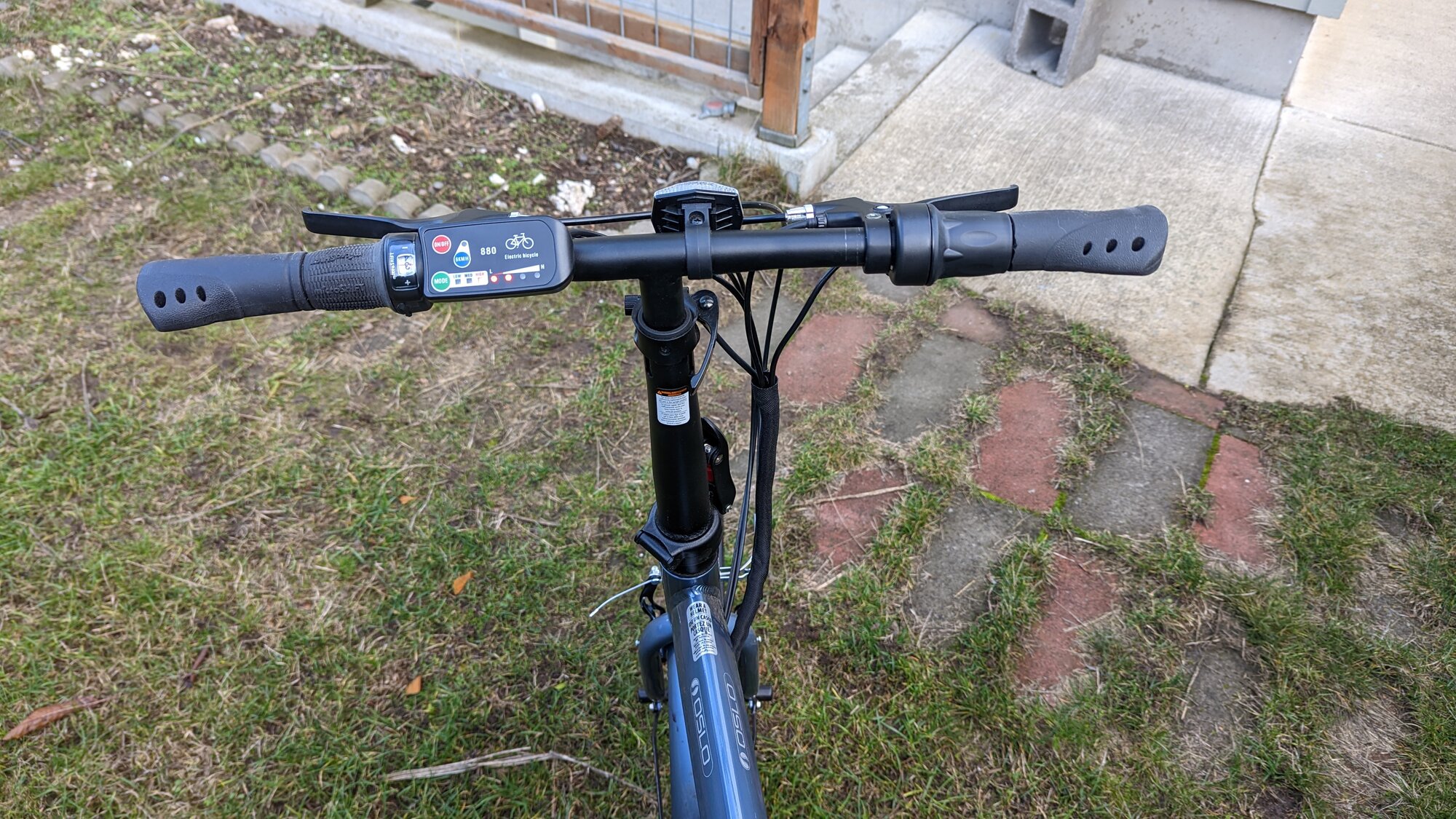

The overnight rain melted the snow so I was able to test ride my newly improved Huffy Oslo. Previously I had replaced the controller, installed a twist grip throttle on the right, and moved the twist shifter to the left. What I did on this Huffy go around was install a 11-34 freewheel, replaced the derailleur and chain, and put shiny used Tektro V-brake calipers on, with Kool-Stop brake pads.
I like the speed on that 11 tooth cog. I guess it was a 14 before. Living in hilly country I always want a climbing gear, hence the 32 cog. The new brakes stop much, much better than the junk that was on it.
The bike was about $340 tax and shipping included. With the new parts I have about $500 into it. Now it seems like a decent ebike folder.
Four days ago it was 24 and snow and ice on the road. Today, low 50's, clear roads (except for the leftover traction grit) with no wind or rain! So I did my errands on the Oslo.
The 11 tooth cog moved the bike very well, and at a good clip, even at PAS 1. I tried climbing a hill with the motor off on the 34 cog. That sucked. A decent derailleur makes for positive shifts, and no chain noise while pedaling. The derailleur that came with the bike was junk, which seems to be a thing with the Oslo--use of lowest priced components available. I guess that's to be expected on a sub- $400 ebike, though it was originally marketed at over $600. My reworked brakes are great. So overall I am very happy with the improved Oslo for its intended use as a townie bike. Folded, it fits great in the boot of my VW Golf.

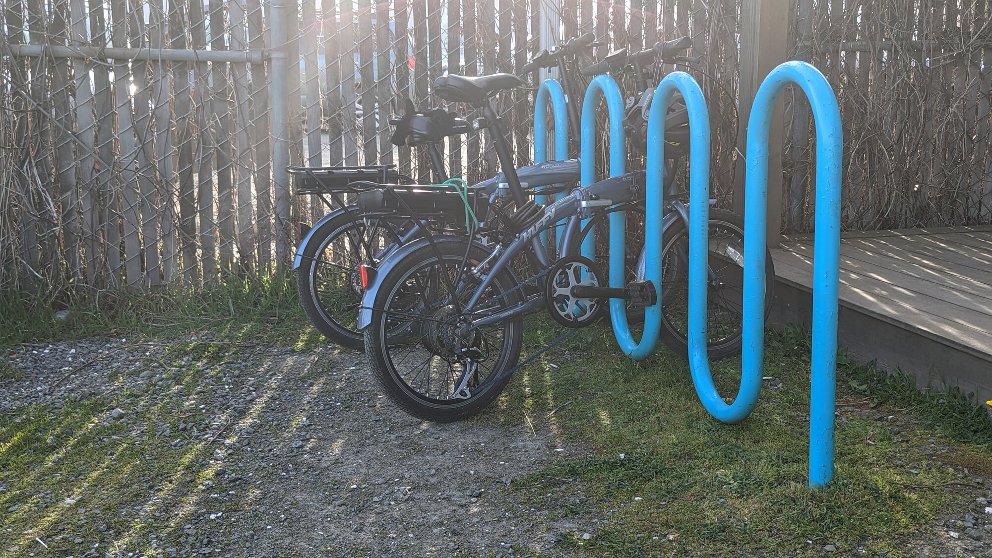

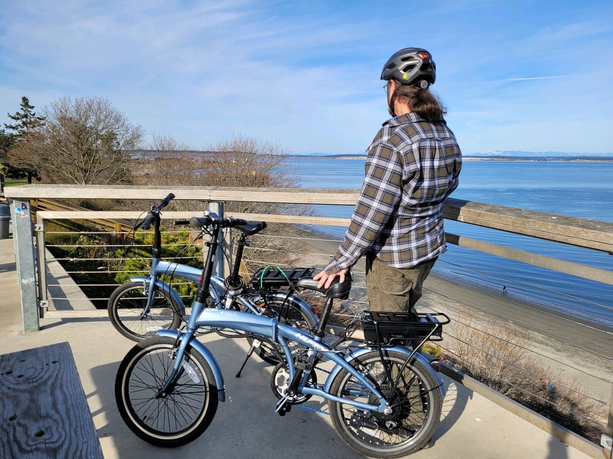

Finally got my two "improved" Oslo's out on the road together.
My friend loved riding hers, though she's a newbie to ebikes. On our final hill home she rode up on full throttle. I was on full PAS and pedaling with effort just to keep up with her. I guess my fifty more pound makes a big difference in uphill speed while on a 250 watt hubmotor.
The Oslo's rest while at the local watering hole.

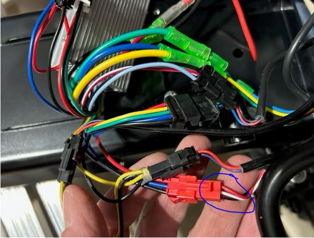

The three pin male red socket is from huffy's PL Power-switch/LED-display, red+white wire are from power switch and black is ground for powering led on the switch. If you want to hook up the TPV Throttle/Power-switch/Voltage-display, TPV's yellow and blue wire should be connected as TPV-yellow=>PL-red, TPV-blue=>PL-white. The TPV voltage display ground is going through the throttle ground wire. The voltage display works in door well but difficult to read outdoor some times.
It is worth mentioning that Huffy Oslo cadence sensor is integrated one. Fix-position sensor and rotate magnetic points are inside plastic casing similar to one found in Amazon
And product usage guide line saying that "Parameters: If the magnetic dot does not work, you need to adjust the parameters of the display (adjust according to the correct parameters in the display manual). If you are using a KT display of the same series, please adjust the parameters from C1 to 7", after change KT-LCD display setting, KT-controller is able to pick up Huffy Oslo cadence sensor. If you using KT controller but paired/connected KT display cannot change that parameter, then you have to replace Huffy Oslo's cadence sensor with one bundled with the controller.

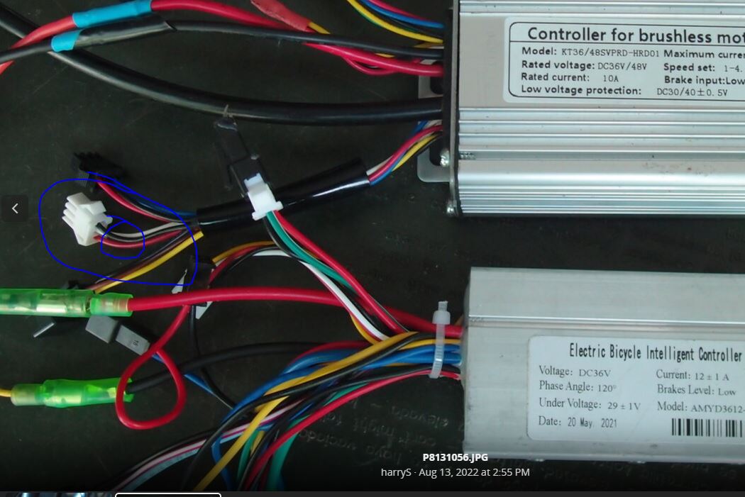

Hi. If possible might I ask for a bit more info on this? When say 'PL - red" do you mean the three wires circled in the attached (red, white, black)? And if yes, do you mean cutting those wires and splicing in (prior to the white connector)? Also, if I do this, and leave the original on/off button on- will the throttle work seperate to the PAS? In other words, If I power on the new throttle (https://www.amazon.com/dp/B08HYPVC7F?psc=1&ref=ppx_yo2ov_dt_b_product_details ) with its power button, but dont power on the original huffy power button (with led backlight), will the throttle work but not the PAS? Thanks, and sorry in advance if those were dumb questions!
Sorry, wrong pic attached above- I mean this one (where the white, red, black wires are on the panel/bike side, and the corresponding wires on the controller side are black, red, blue).

From the harryS post on page 1:
Throttle does work with the stock controller. It's the three pin white connector that has a cap on it.
Black is ground. Red is +5V. Green/white is signal.
And harryS from page 4: The Huffy controller cannot use the on/off switch on that throttle/voltage display that MaKlounkee bought. It's a different design, with different voltages on the wires. So send it back if you can, and just buy a throttle.
