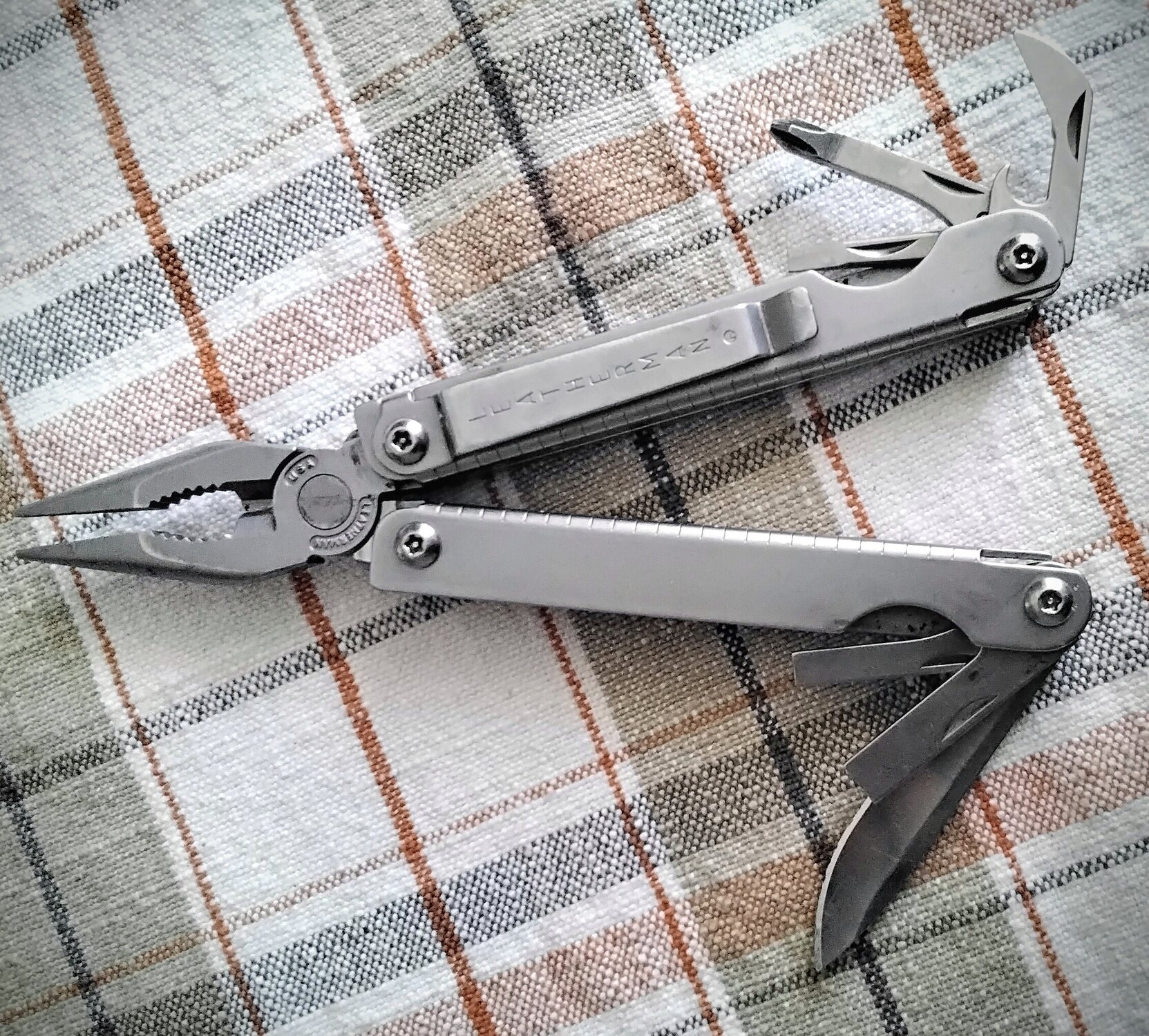

A multi tool for the most part are half_ass'd gimmicks. You should carry a full set of hex wrenches and a real screwdriver as they don't take up much space, don't weigh much and WORK when needed.
That said I do carry a base Leatherman for the knife.
Many are, but there are good cyclist multi-tools out there that seem to work well for most people. Crank Brothers, Topeak, Pedro's, and Blackburn all seem to make great multi-tools that get the job done. If you just grab any multi-tool at random they are unlikely to be an optimum fit for you and your bike, but if you do a little bit of research and experimentation you can find one that works great for you.
I'm really intrigued by the Mineral Bikes Mini Bar, which seems like an awesome tool and if I could get one it would probably be in my every ride carry. Unfortunately they seem to have been out of stock for a long time.
The Silca T-Ratchet is awesome but very expensive and I'm nervous about losing the tiny bits during an emergency field repair. So I usually use it when I'm working on a bike at home.
On extended adventures I usually carry a Leatherman Micra and a small locking-blade pocketknife.
Always watch out for multi tools that look really cool but have a very short reach. A lot of bolts are in locations where you need a centimeter or more of reach to actually get at the bolt to tighten it or adjust it.
It is good to take the time with a new multi tool to find out what locations on your bike it cannot get to and bring some other alternative (maybe just a hex key). I also bring hex keys (or some alternative tool with more reach and leverage) for bolts I am likely to mess with a lot.
Sure dedicated tools are better, and on longer rides I'm possibly over-packed, but it's proven itself handy on a couple of rides now (only other peoples bikes so far, knock on wood).

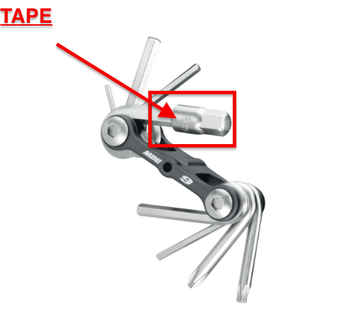

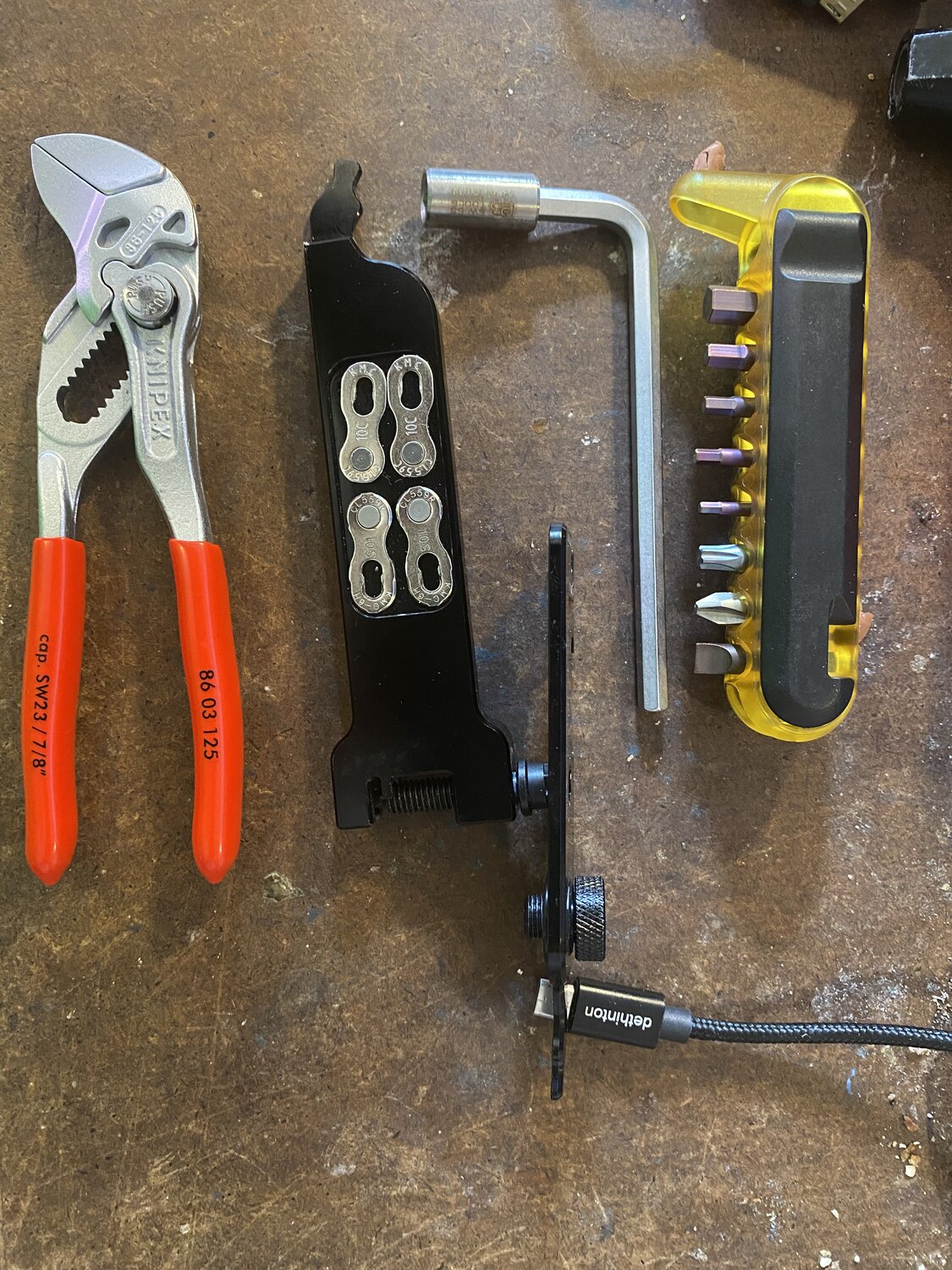

I really like this swiss tool wrench setup. but the only complaint is the cost. plush sure levers are way small for y hands. but it works really well full size wrenches in a compact size.
or me those tools with loose changeable points are guaranteed losers. I WILL lose one or more. So for over a decade, I've stuck with topeak mini tools. But I needed to use some electrical tape to keep from losing the one removable head.

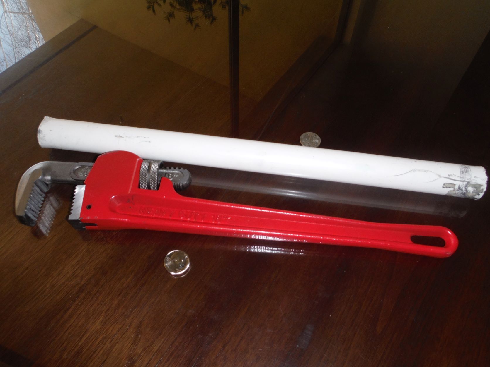

I normally use a ratcheted breaker bar when extracting old bottom brackets. Sometimes freewheels are stuck. That is when I pull out the 18" monkey wrench. It can be extended with a pipe.

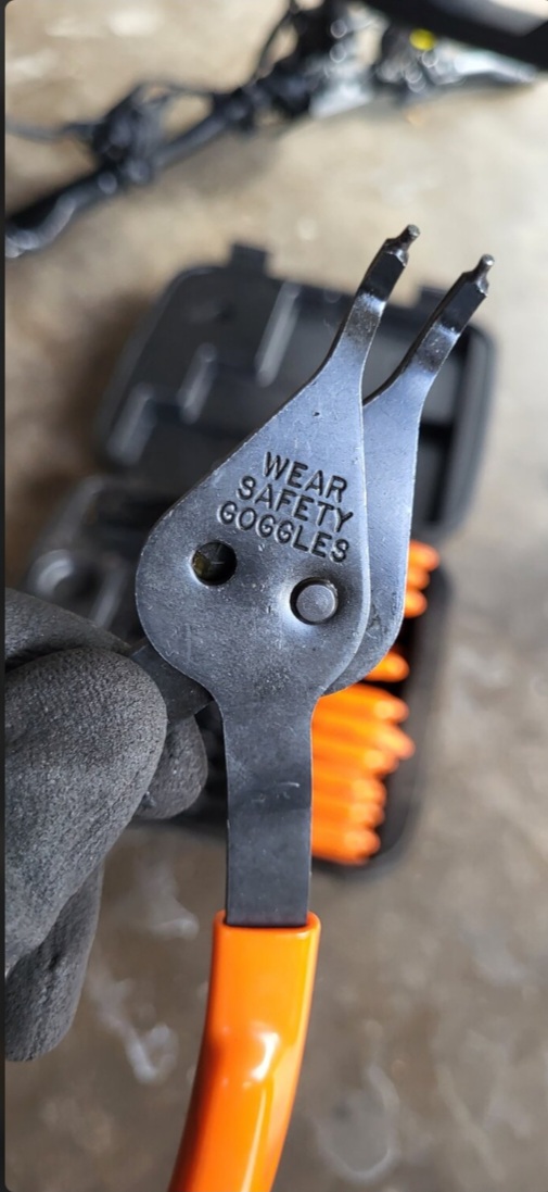

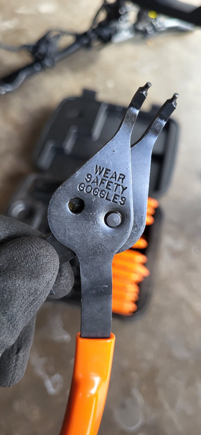

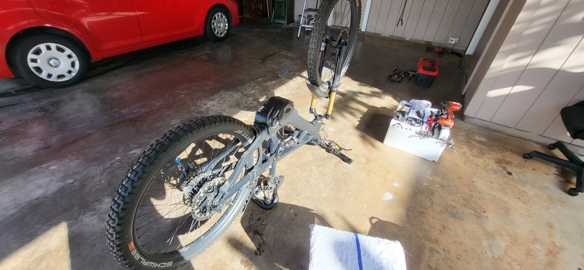

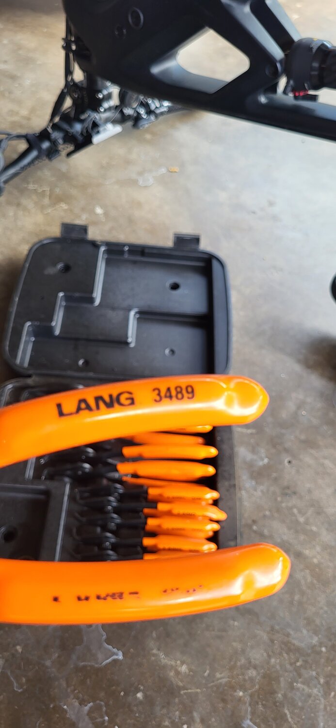

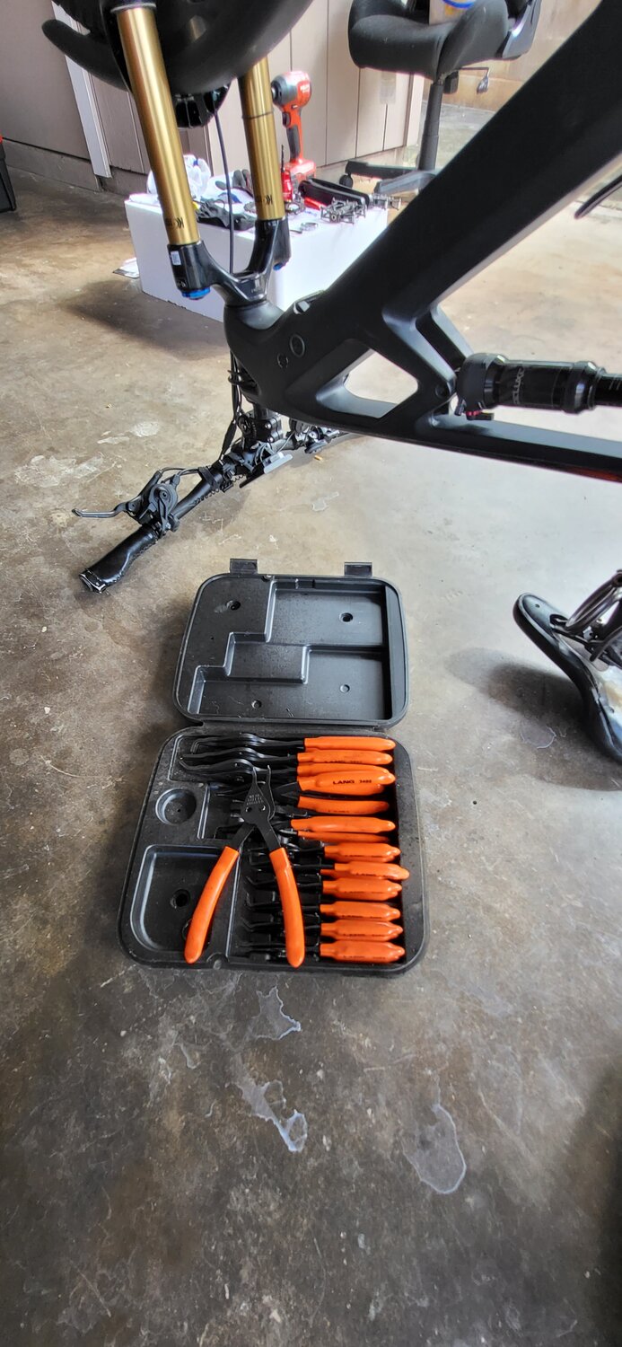

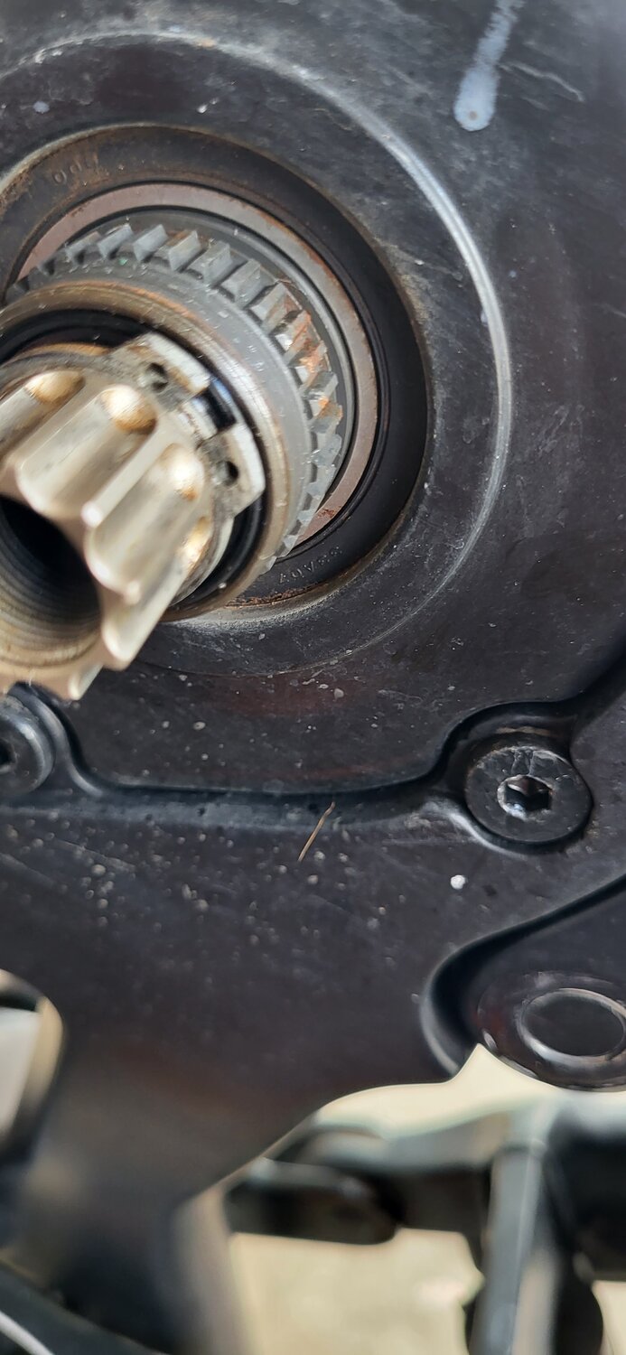

Disassembly time on the Bafang.
All I needed was the #3489 Lang to remove and replace the snap ring.

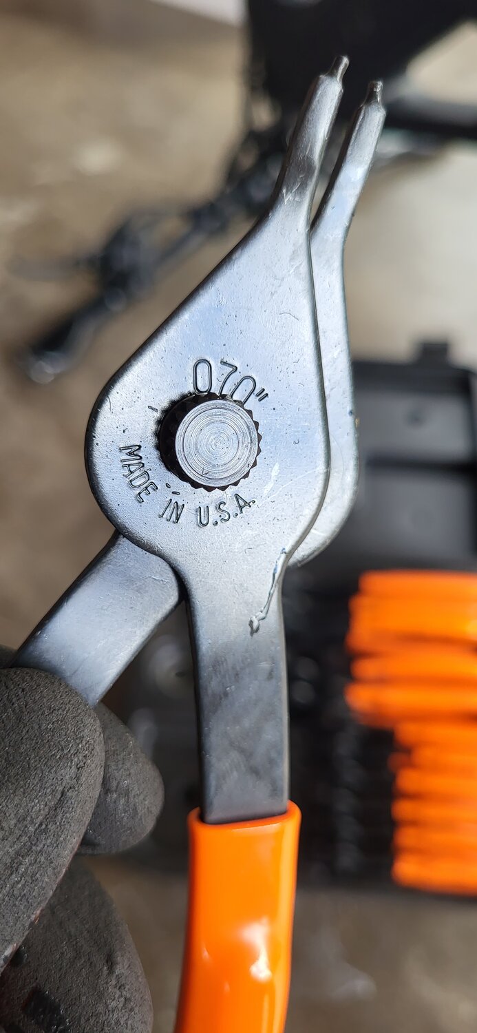

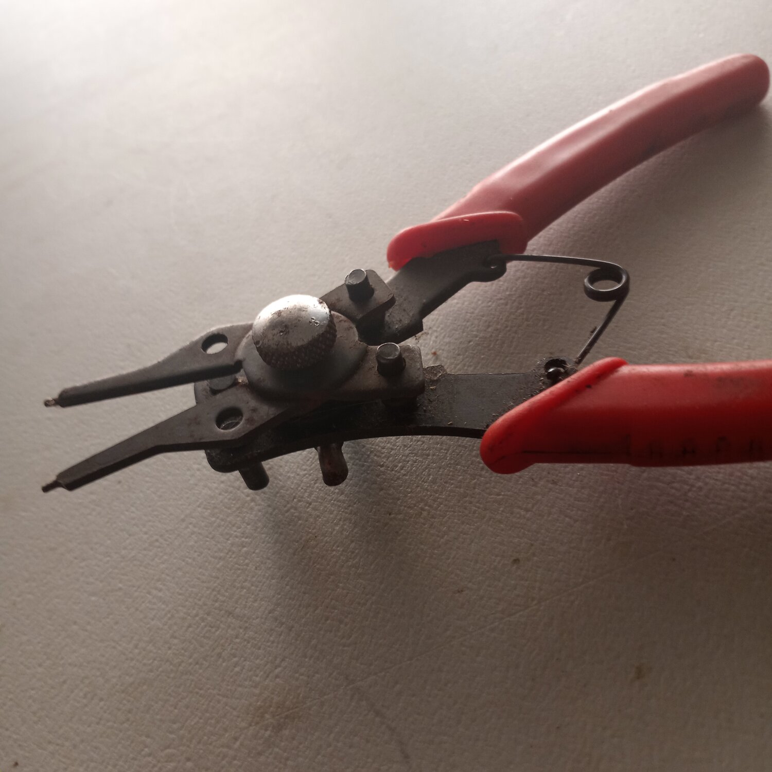

Is there a chain tool like this that can both close and open a chain link?
I've got a similar c-clip tool that will open or close a c-clip.
The jaws won't open up far enough to get into a chain link though.
No no no...
It's a snap ring plier.

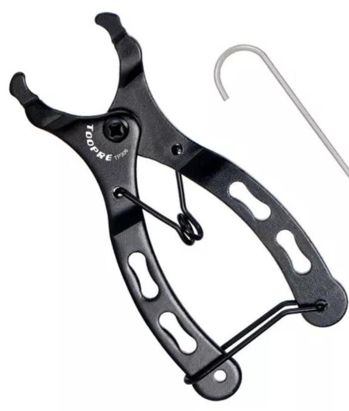

You must have a tool for removing missing link on your chain people call it master link tool for remove and replace chain link.
Yes, I've got one coming, but it's geared the wrong way to remove a chain link.
It's geared to close the new quick link.
I'd have to use both hands and pull the handles apart to remove the old link.
That might be clumsy and difficult to do?
The quick link tool can open with compression. Just move it half way to the next link. The compression is then pulling apart. Then move it to the other side and do the same thing.
Ohhh OK.. Thanks
I wonder if I would have figured that out?
