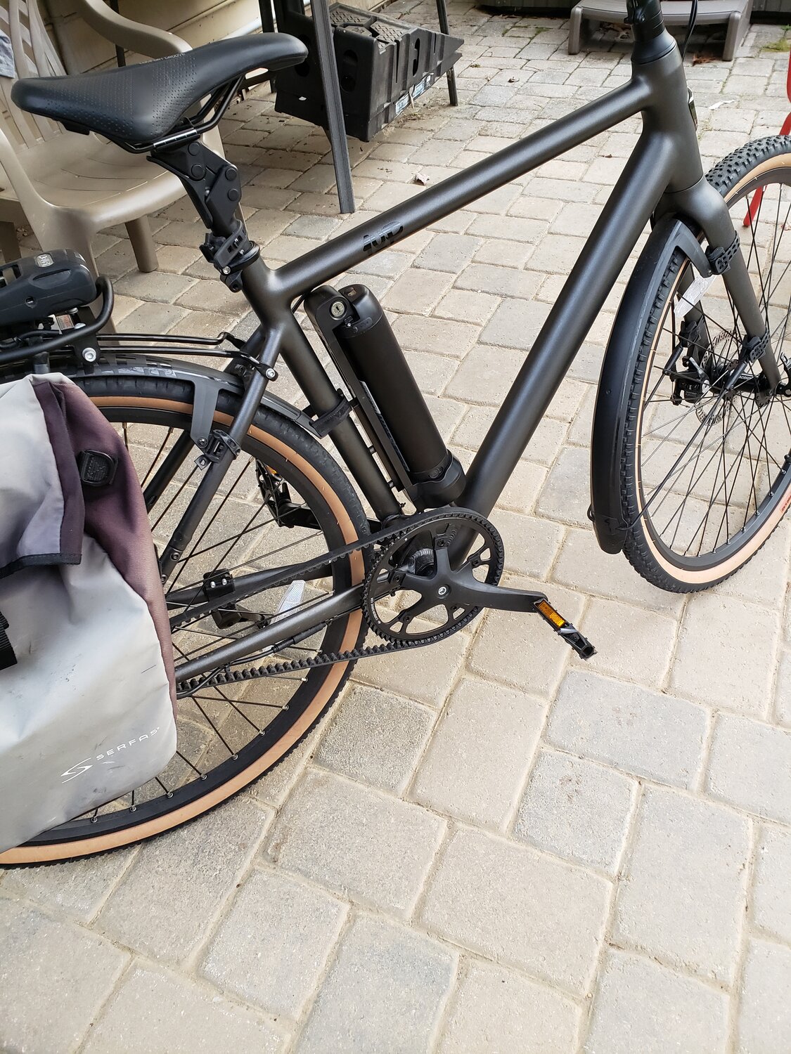

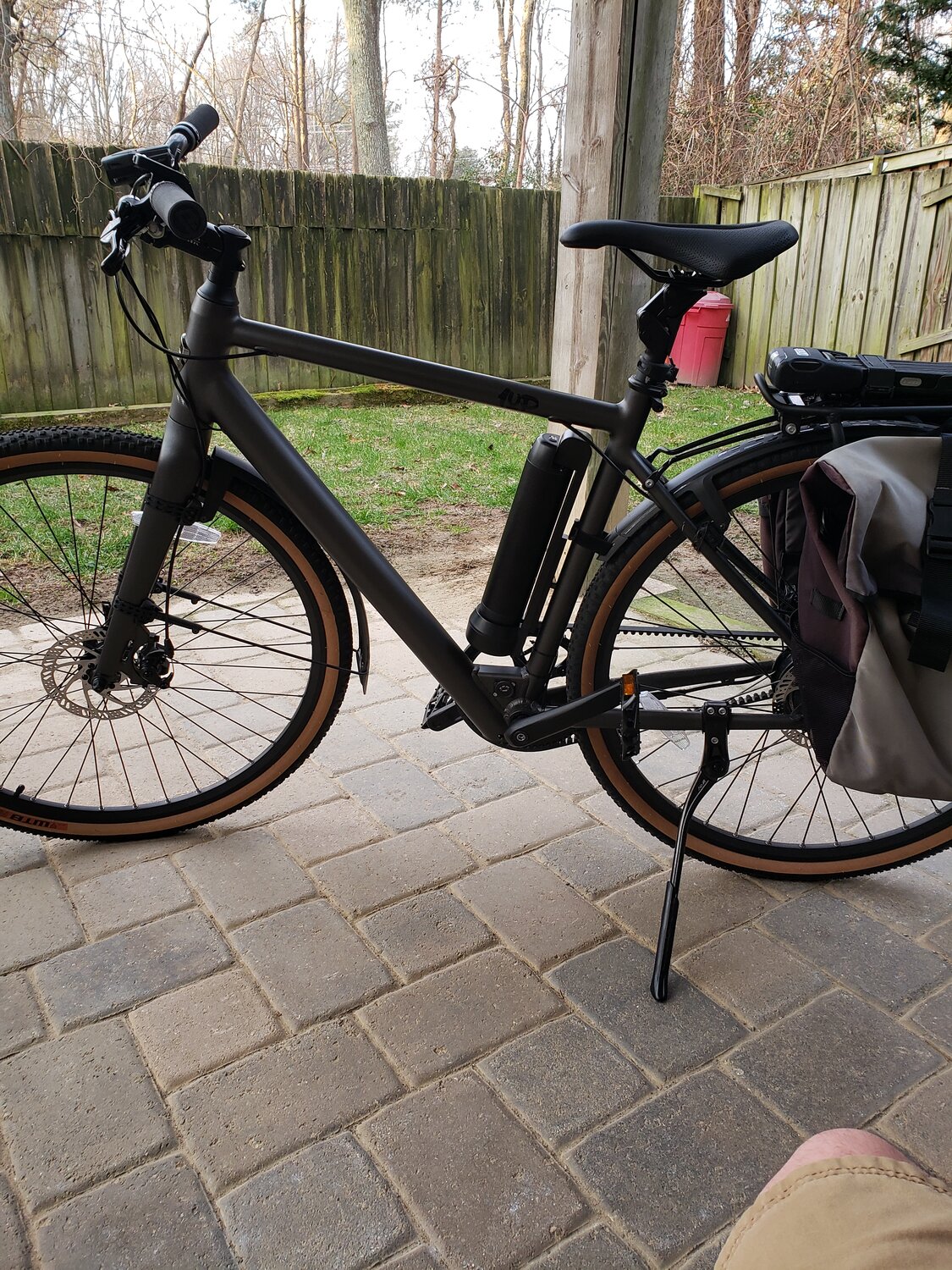

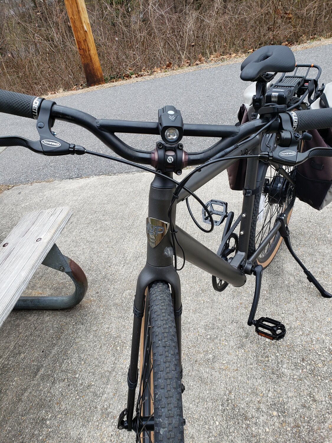

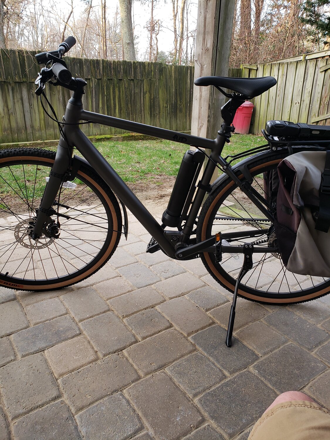

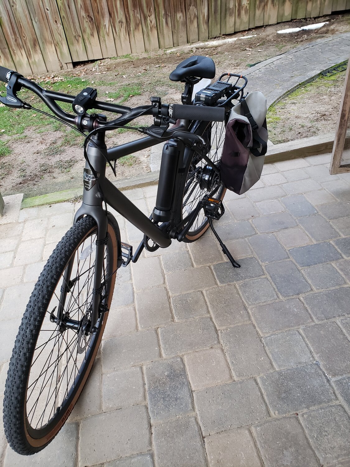

Add on battery came today. Installation was easy if you follow the video but the middle bolt for the bracket was too short so I had to make a trip to the hardware store.
Here she is.

Jimmy I think you have the mounting plate on backwards. The plates recessed holes should go over the bottle cage mounts so that the plate sets flush with the frame. See this in the video at about 6:20 in. https://support.ride1up.com/support...79581-roadster-v2-add-on-battery-installation

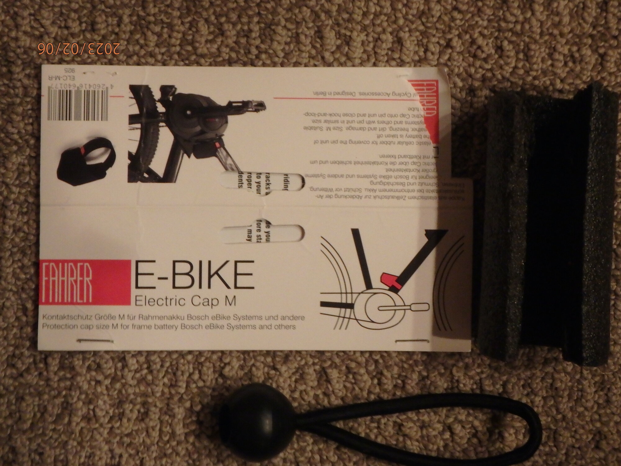

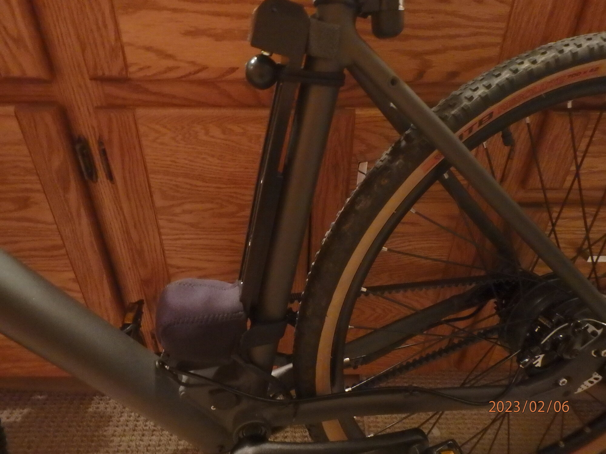

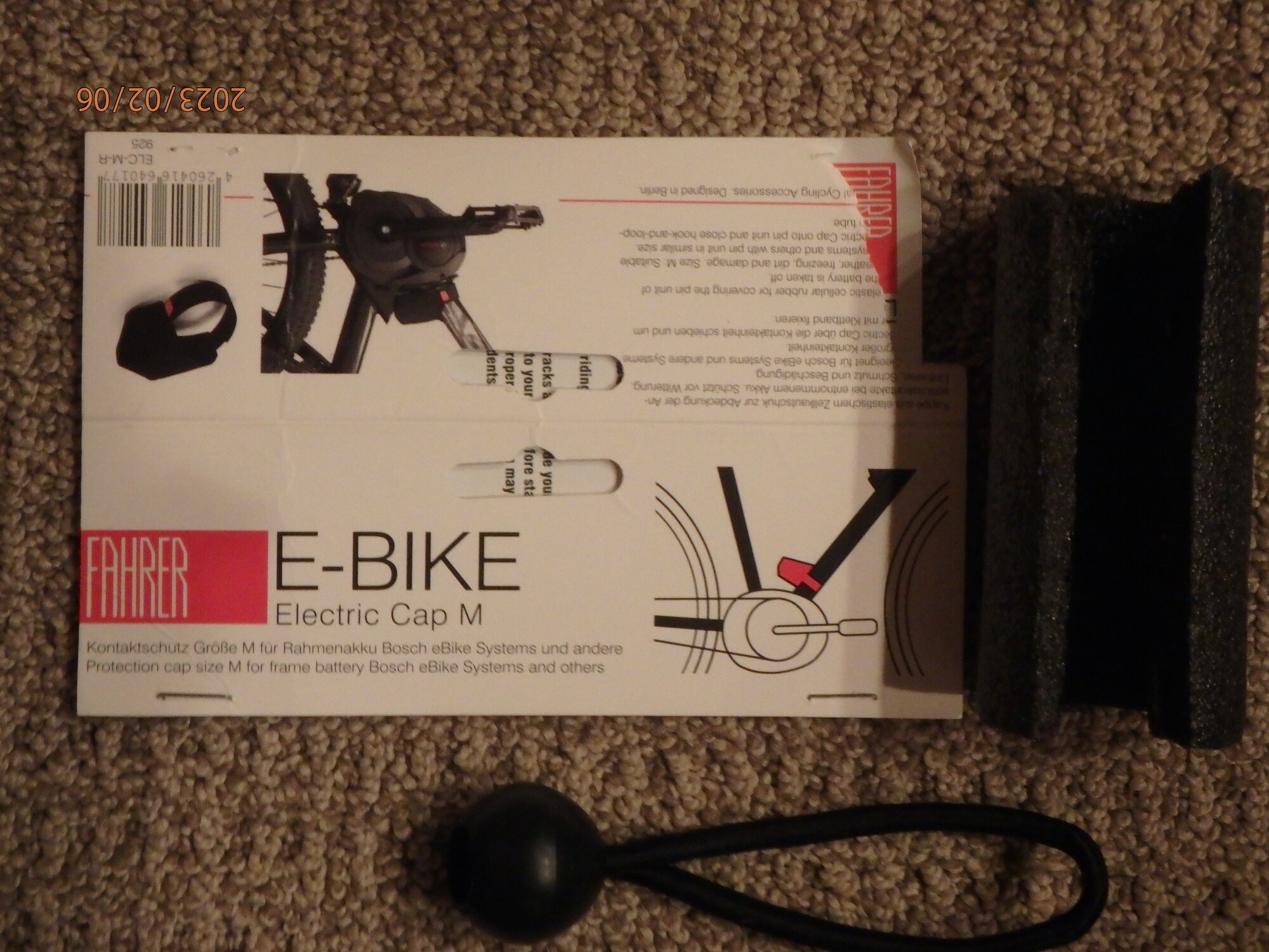

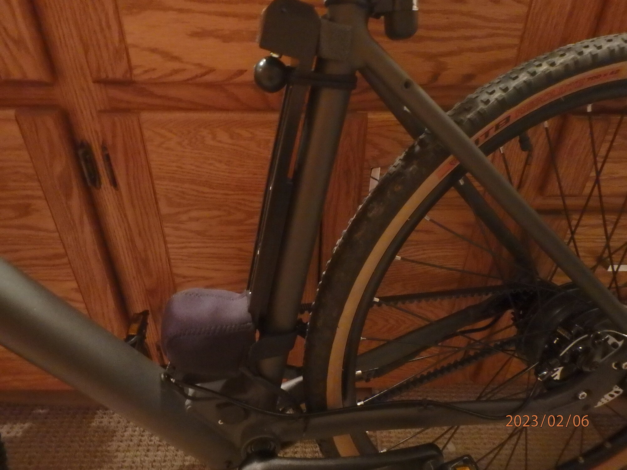

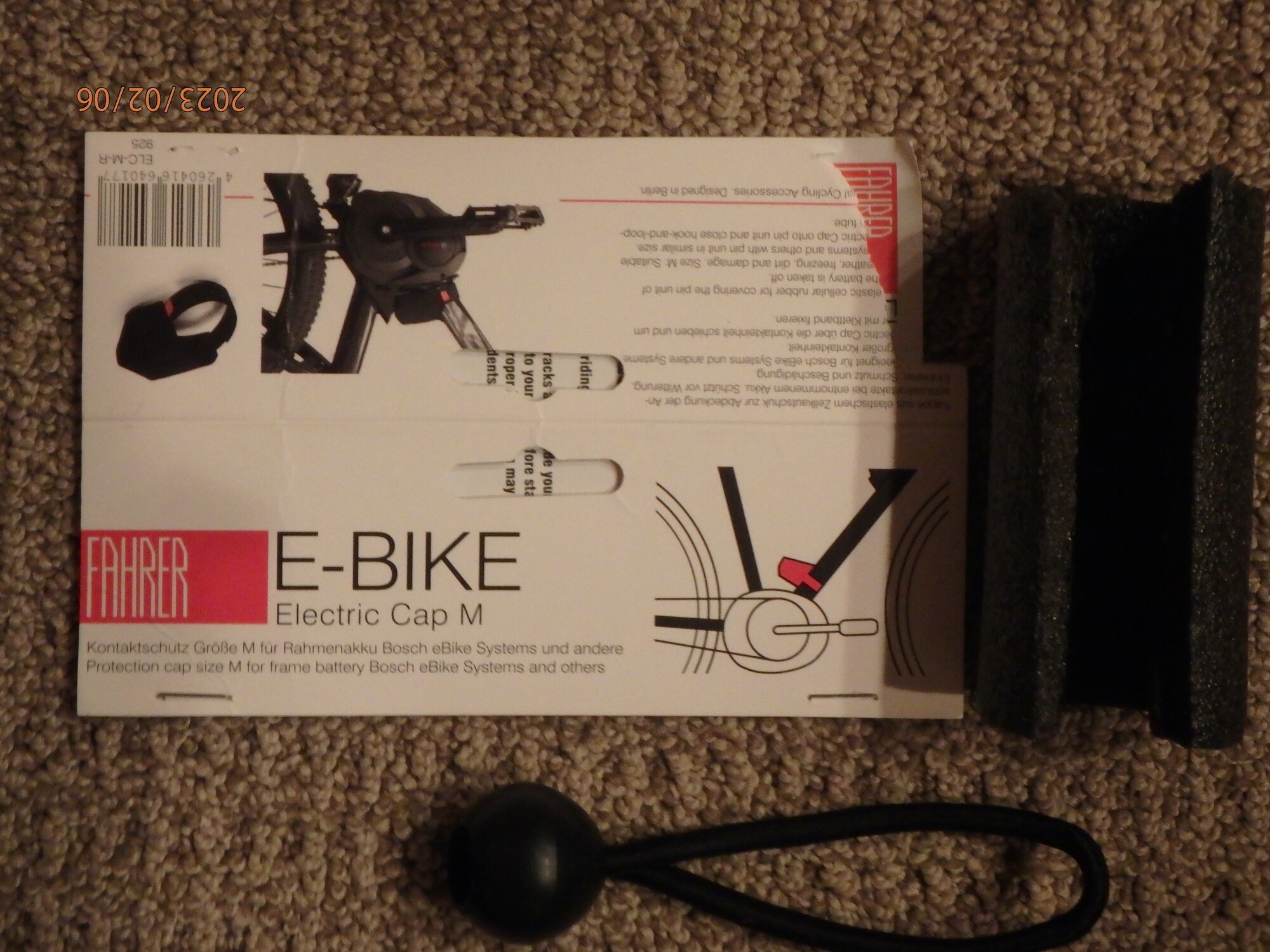

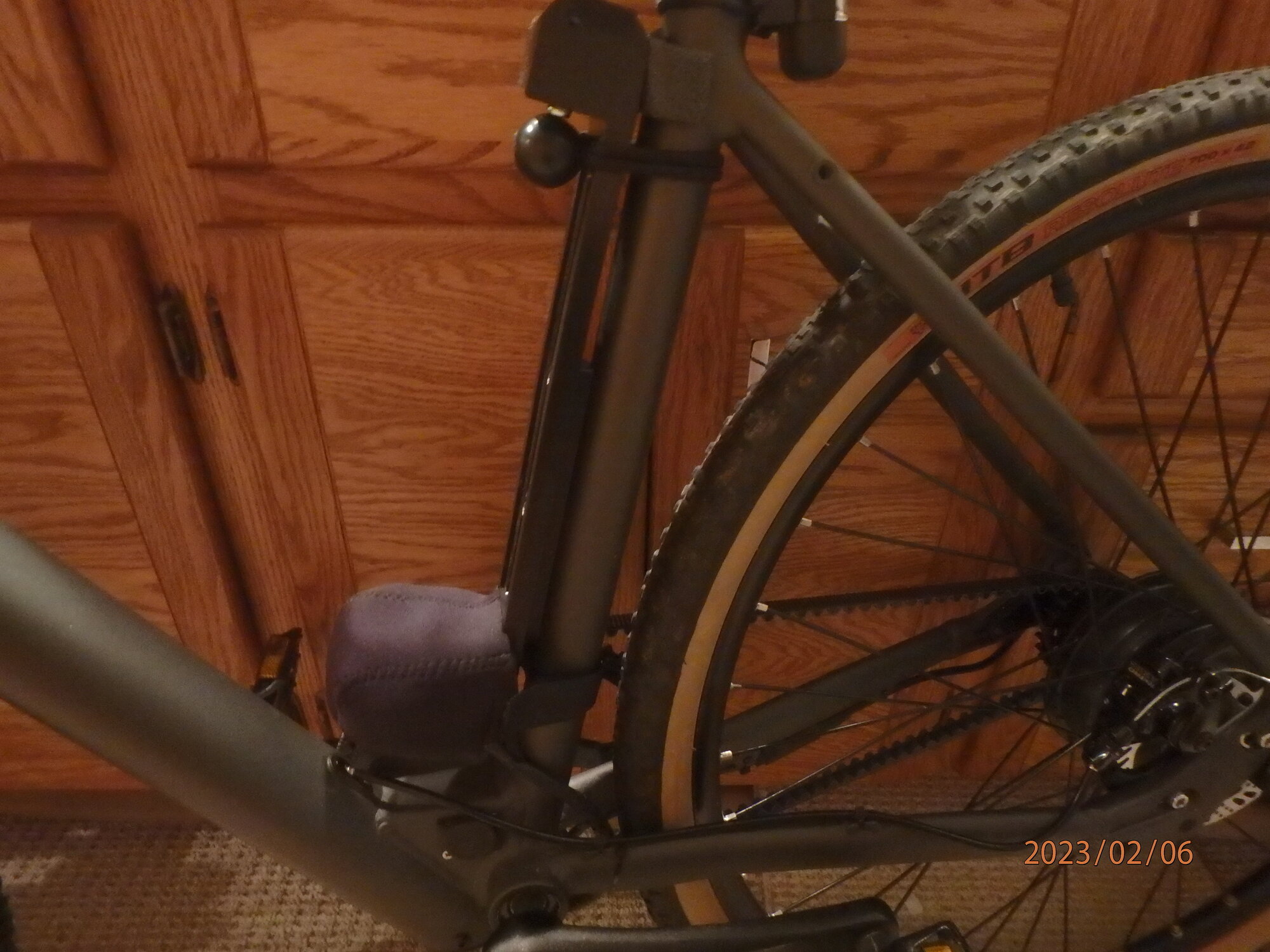

Here is a shot of mine w/o the battery itself. If I'm riding above 25 miles then I'll add the battery, if not I ride without the battery. To help in keeping dust/debris off the connectors I use a Fahrer cap. And to stop the vibration noise I stick some pipe insulation behind battery plate, use a short "Spiderweb.com" ball bunge I had from my Jeep days and stick some good old electrical tape at the joints at the top where the key slot is.

Oops lol. It is working out fine though. Usually my 7 mile ride in this cold weather would knock out 1 sometimes 2 bars on the battery depending on how much pas I use but today I haven't even knocked off 1 bar yet.

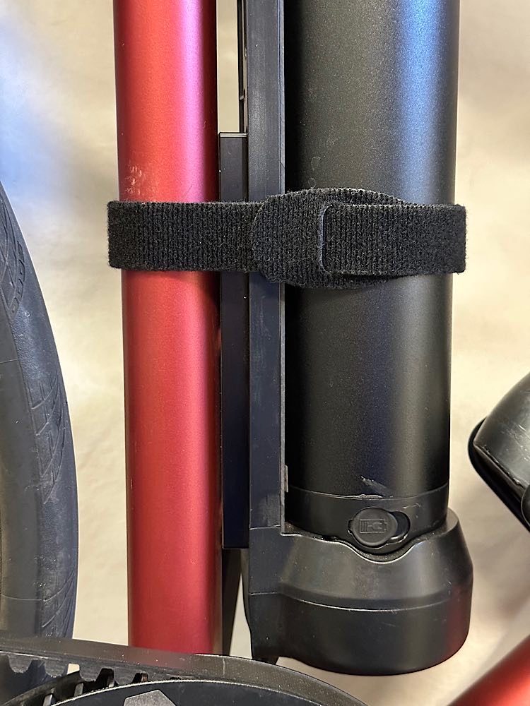

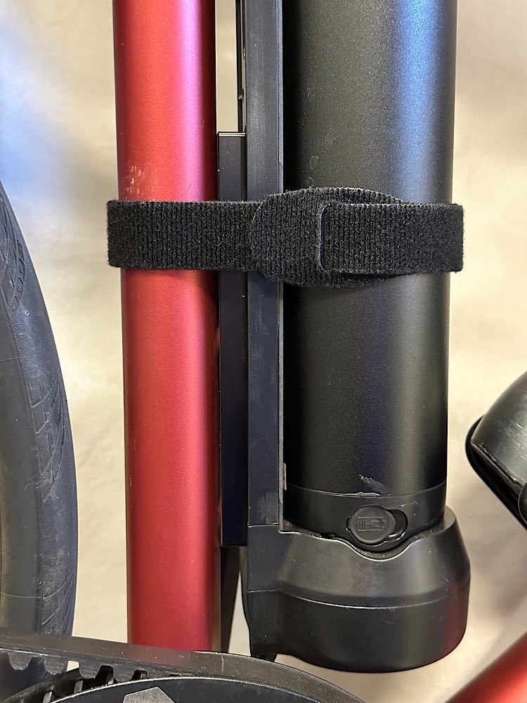

I use a Velcro strap, to stop an annoying rattle over bumps. Light and easy to take on and off. And having the bracket in the right orientation, helps keep things flush and maybe more secure?

I use a Velcro strap, to stop an annoying rattle over bumps. Light and easy to take on and off. And having the bracket in the right orientation, helps keep things flush and maybe more secure?View attachment 146552
funny enough, I put that bracket on backwards and I didn't hear any rattling at all today and part of the road to work is rough enough that I would have heard some.
