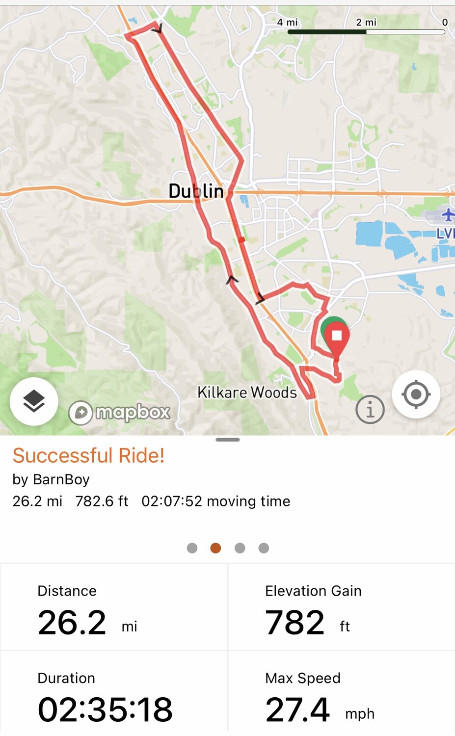

But I have exciting news to report. My 1999 EVG did more consecutive miles than she ever has done before. I just did 26miles (42km) and returned with 59% battery (62% post rest). I am really excited as I still have a battery pack coming; so I may just hit my first Century Ride ever!!!

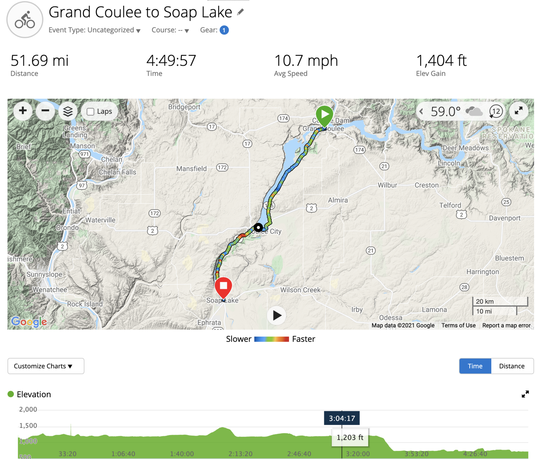

Tough ride today .... used almost twice as much battery (210wh) as I’ve ever used before. High starting elevation, too much climbing, not enough food! Time to reconsider my no bottle no food “strategy!”
The bike performed magnificently though, I did most of the ride on eco, used sport for the last few minutes of the biggest climb, but then for the final 1,200 climb I was utterly bonked, put it in turbo for the first time for any length of a real ride, and watched mission control with “motor power” pegged to 300w for almost the entire climb. For some reason (cadence/gearing?) it was MUCH easier for me to put out 150w when the bike was adding 300w than it was when the bike was putting out 50.
My output was generally very low - I usually average 200-230w, but perhaps due to altitude, perhaps due to the nature of climbing, perhaps the ride was just a bit too much, average 166w with the weighted average only 178w. Support percentage was very high at 33%!
I think what Mission Control actually shows is the power drawn from the battery (there is no way to actually determine the motor power while it is very easy to measure the current and voltage to multiply them and get the power figure). Since we know the 1.1 motor produces 240 W max and the reported value was 300, it indicates the motor efficiency of 80% and it sounds about right.
I agree with the phenomenon (that you describe) of inputting more leg power at high motor assistance than it happens with low support. I cannot explain that at all but I get very similar relationship when I ride my Vado 5.0 and measure the leg power against motor assistance with the BLEvo app. Let us say I need to ride together with slow traditional cyclists. I set the assistance down to say 25%, and after the daily trip I realize my leg power was just puny. Now, the more assistance I use the higher my average leg power turns to be. Finally, if I set the assistance to 100% and do a (say) 8 km/5 mi sprint, my power input becomes quite high as for my ill legs.
I don't know why that happens. It might be we just try harder ourselves with high assistance on?
Interesting - the field is sort of mislabeled then, since “rider power” is clearly a torque x speed measurement and not an internal body measurement but usefully so as it allows you to calculate range and so on. 80% would be a reasonable value for a brushless permanent magnet electric motor, i think.
I believe the issue with rider power for me has more to do with gearing. I simply can’t pedal hard enough to climb a very steep hill at a good cadence in the lowest gear; my heart rate would be too high. But at higher speed, whether enabled by the motor boost or flatter ground, I feel very comfortable putting out 200-300w for extended periods of time. I’m very curious if a super light road bike with a 2x drivetrain would allow greater power output from my legs and heart uphill! Probably Not. 😂
Interesting - the field is clearly mislabeled then, but usefully so as it allows you to calculate range and so on. 80% would be a reasonable value for a brushless permanent magnet electric motor, i think.
Not necessarily. There have been many charts for many mid-motors published, and the top efficiency was reported at about 80% max. For instance, the Specialized 1.2s motor I'm using appears to work at 78% top efficiency: the rated Max Motor Power is 520 W, the power drawn from the battery with the motor at the top power is 666 W, hence 78% efficiency.
A 2x drivetrain? Just think: If you could get into really low gear, you would need to spin the cranks: Your heart-rate would go up tremendously. I'm so glad to own full-power e-bikes...
