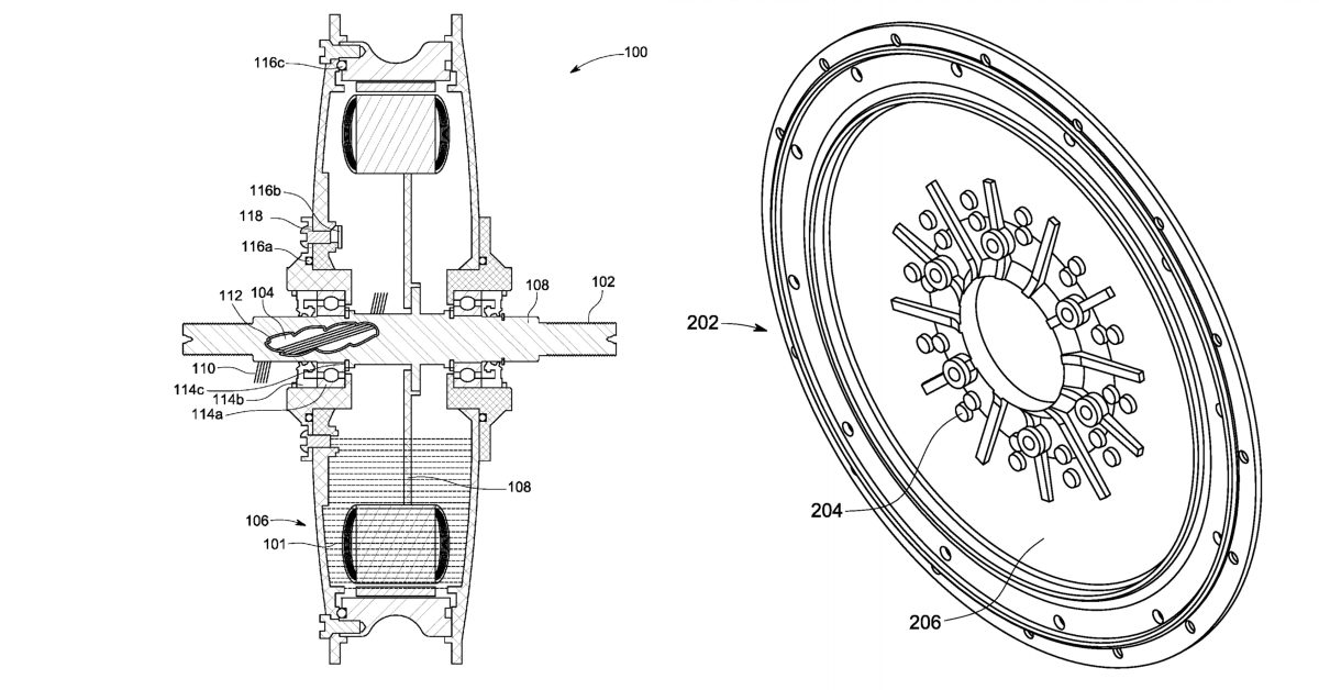

So back on point, just for the sake of conversation, the seals you see on that G062 (and others), that you believe are for containing oil (you are calling them oil seals, right?), may actually be there for the purpose of keeping dust and crud out, and possibly to increase the motor's ability to resist water intrusion should it be dunked, correct? So the fact there are seals in place does NOT mean the motor is designed to be run with an oil bath. Not as designed originally in my mind anyway.....
So, the question is will those WATER seals hold oil? Do we know that because it's been done successfully (by Bafang or somebody using a Bafang), or are we saying it MIGHT/SHOULD work if done correctly with a little luck? I'm hanging out in these forums quite a bit, and I think it pretty safe to say it's NOT something you see done frequently.
