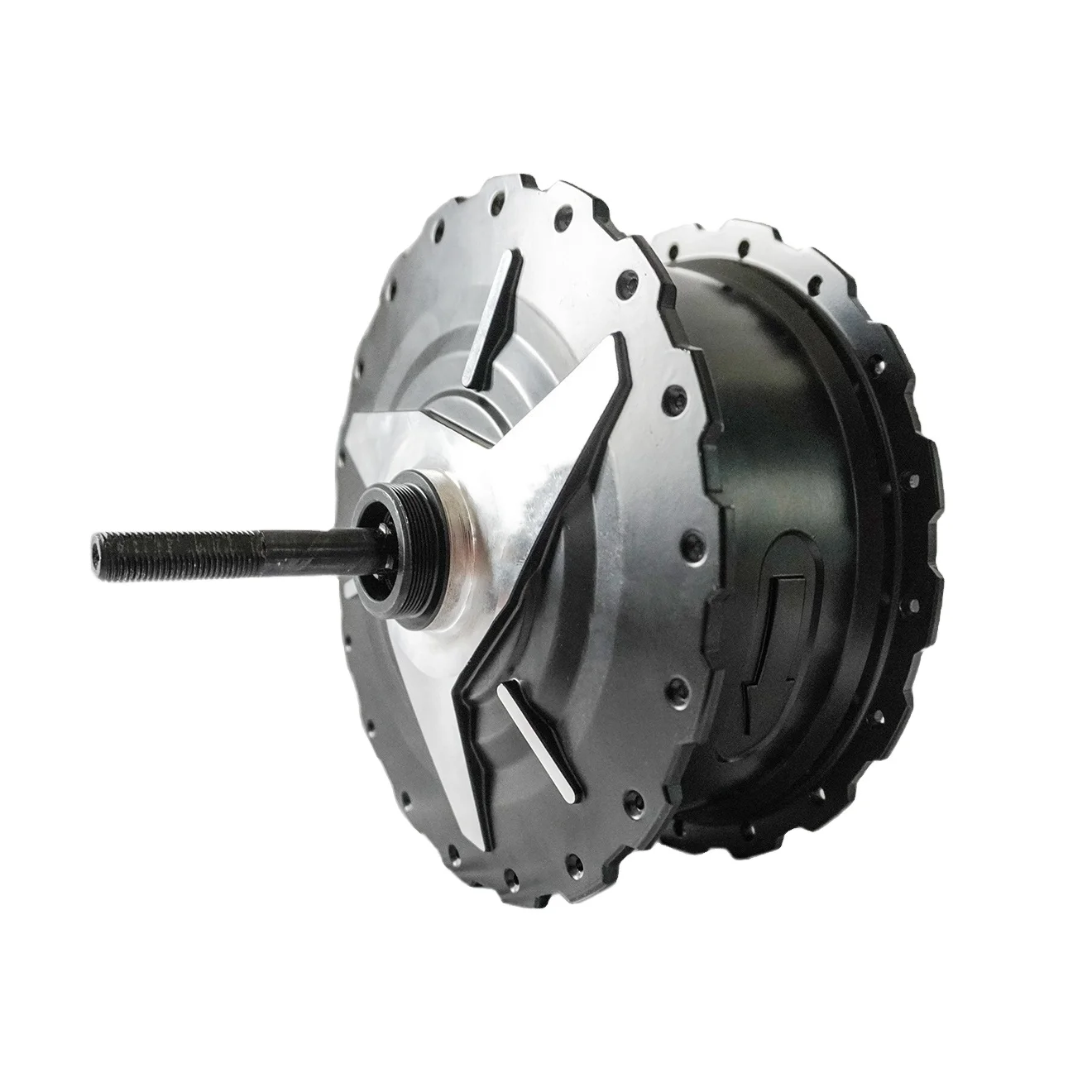

I was told by Mxus import/export on Alibaba, the difference between the 2 motors is the 750w has 20H magnets, and 1200w has 25H magnets. This is the only difference I have been able to identify so far between the two. Not sure if copper fill is any different but would imagine it might be. However see the picture below, the copper fill looks quite nice (a significant amount of copper is stuffed in these larger diameter motors). See the photo below, the motor has a larger stator/rotor than previous generation geared motors, allowing more copper and a greater amount of torque due to leverage ratio.
I was told it is available in 4T and 5T configurations, with the 5T having 400rpm unloaded at 48v, and 4T having 500rpm unloaded at 48v.
Take a look at the clutch picture- you will notice it has 2 notches, where 2 feather/parallel/magnet keys can fit. The feather key slot is much larger than previous generation geared motors. This is perhaps why the motor can handle more torque. When running high torque on prior models the feather key would shear off, this model has a much stronger (longer) feather key, as well as feather keys on both sides, and appears it can withstand significantly more torque than previous motors. The gears appear to still be nylon, but of course can be upgraded.

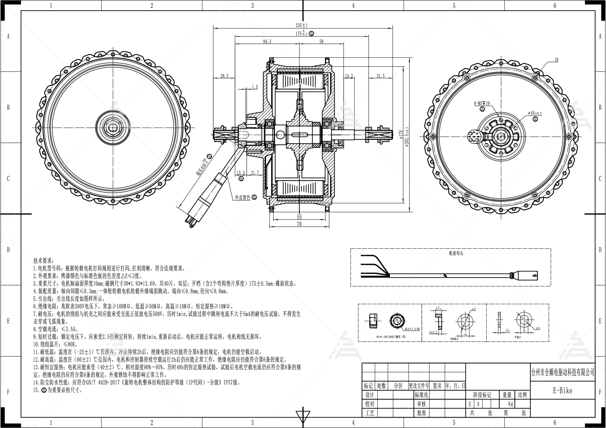

Also attached is a hard to find dimensions diagram of the motor

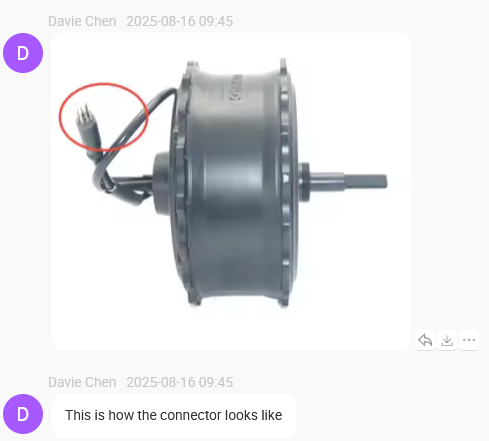

I think this is the link to the same one you bought? https://www.alibaba.com/product-detail/Electric-Gear-Rear-Drive-Snowmobile-48v_1601379396205.html
I also found another model on that reseller's alibaba webstore. Model GDR19-SR. Which is listed as a 1500w motor. Thoughts in comparison? Says it's a bit heavier.

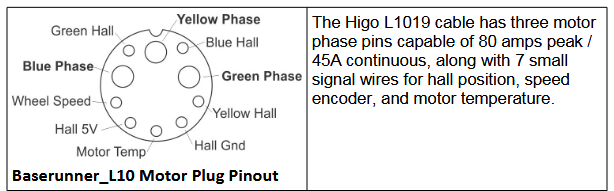

The wiring issues you saw concern me though. I'm not ready to rewire brand new hubs upon arrival. Even if better than a bafang. If they have things sorted out by now I'd be more likely to try one.

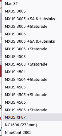

But if it's not easy to get working with a Grin Baserunner/Phaserunner L10 easily, then for me I'll probably go with a Bafang for now.
I don't see it in the Grin list even when choosing from all motors.
But I really like all the upgrades they've added to this motor. It has potential to outdo Bafang finally it seems. It would just need to catch on and get the wiring plug and play for the L1019 pinout if it still isn't already.
