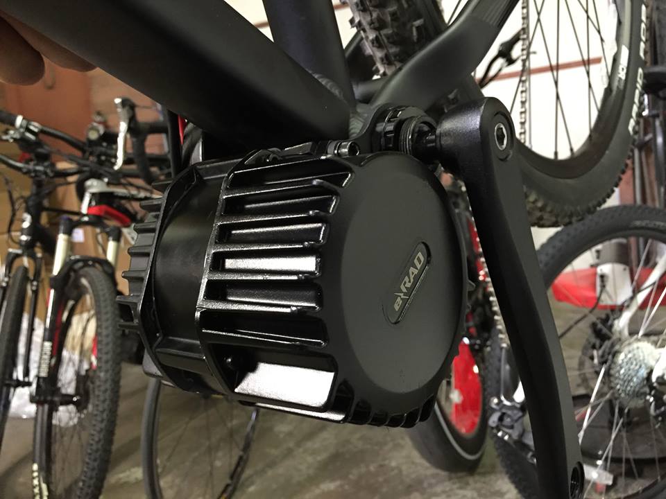

Look what we received yesterday. E-RAD HD 1000watt continuous mid drive conversion. Only 6 of these exist and only 2 with the e-RAD brand w/gear sensor. We will begin taking preorders in 2 weeks at www.lectriccycles.com
We will post more soon. I expect that Court will have a chance to test it at Interbike next week as well. Stay tuned. I will say that this motor has tons of improvements beyond just more power.
Cargo Bikes and Pedicabs are strong applications, but to be honest people have been clamoring for this motor since the first hint of its development back in the spring. These folks simply want more power and speed. Even if you are not looking to go fast, every aspect of this motor has been made "heavy duty" hence the HD. This is another reason folks are interested
Those are some huge fins around the motor....Of course, I assume, the bigger the fins and vents, the cooler and smoother motor will run. I bet, Chris, big fins is a much needed addition, keeping the motor cooler at potentially peak 1500 watt performance ( eventually after overclocked modification done)....Bafang motors seems to be continuing giving what we U.S. consumers want: More power! Court hopefully will test ride this motor at interbike next week; he might want to consider wearing a motorcycle helmet in test ride, j.k. Bosch company should pay attention to consumers wants (more powerful mid-drive motors) or lose out.
Those are some huge fins around the motor....Of course, I assume, the bigger the fins and vents, the cooler and smoother motor will run. I bet, Chris, big fins is a much needed addition, keeping the motor cooler at potentially peak 1500 watt performance ( eventually after overlooked modification done)....Bafang motors seems to be continuing giving what we U.S. consumers want: More power! Court hopefully will test ride this motor at interbike next week; he might want to consider wearing a motorcycle helmet in test ride, j.k. Bosch company should pay attention to consumers wants (more powerful mid-drive motors) or lose out.
Given that the legal limit in Europe is 250w and that the market there is currently far larger than the U.S. I don't think they are losing sleep over it.
