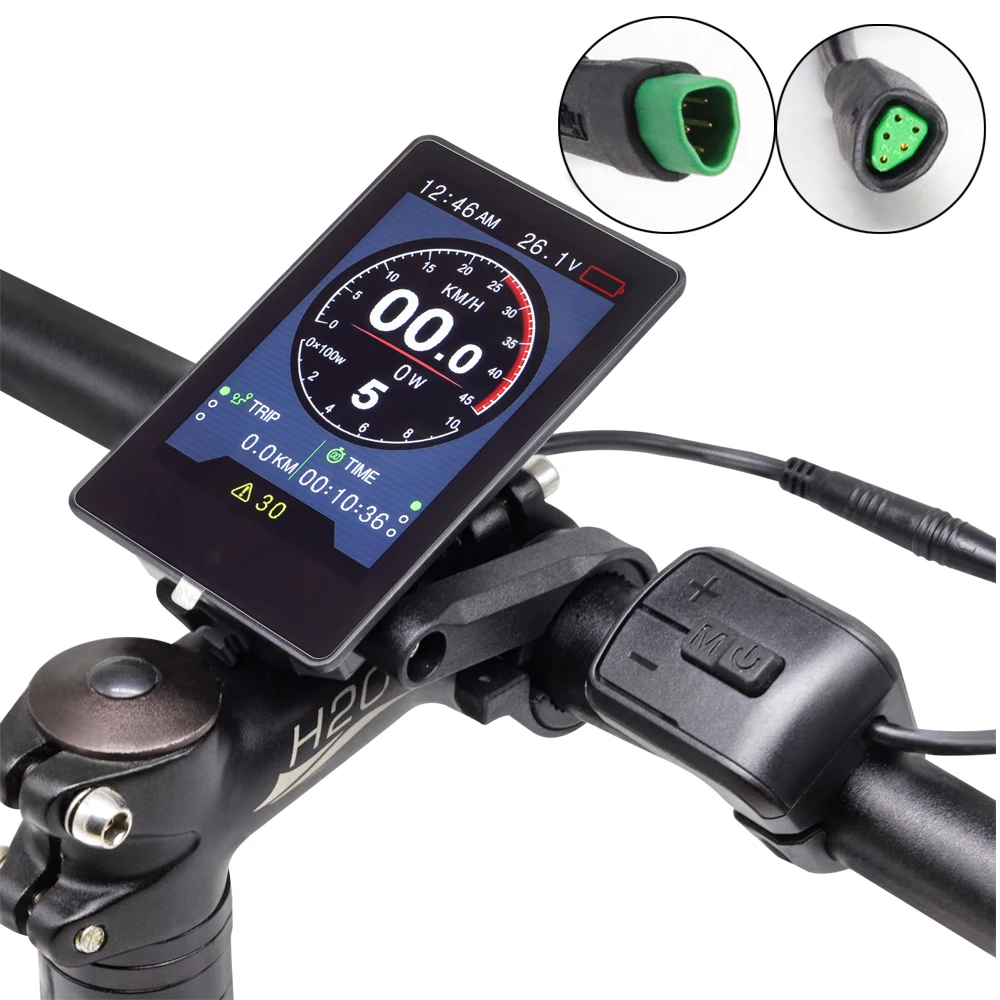

So I received my new Biktrix Juggernaut Ultra Beast yesterday, assembled and tested it and was excited about hooking up the laptop to upload the current controller settings to see what changes i would possibly make after riding it a little. When i disconnected the display port to hook up the programing adaptor i noticed the fitting was a different shape, it was V shaped instead of round.
I remember reading that Bafang was switching to a new proprietary design, i think it was called Canbus but I'm not sure about that or not. I am hoping I just need a different shape display cable.
Does anybody know if or where we are able to purchase the new adaptor cable needed to program the Ultra controller? I hope its not the case that Bafang made the new motor unprogrammable. Thankd
Attached are photos of the new V shaped display port and a photo of my programming cable.

Wish I had better news for you, but I beleive your plans for programing changes are on hold for a bit. That connector is the CANBUS flag identifying it's NOT the programmable UART bus. There are people working on the software change(s) to allow riders to change their CANBUS controller settings, but to my knowledge there is nothing available - yet.:(

Those are Higo connectors and they make a dozen different styles.
Bikonit is using one that is different than what you show as well making it harder to plug and play the controller USB adapter.
That particular one is a MINI F (MALE AND FEMALE) connector.
You will need to do some digging, Find the proper HIGO connector (ebay and amazon) and then figure out the pin out and modify the cable yourself, this is what I had to do. Of course that is IF they haven’t switched to a different programming language. CANBUS is universal, used on most cars since 2003 so there are plenty of software options for looking at the code if you are tech saavy.

Yup that's the new connector indicating that it uses the CANBUS communication protocol.
You won't be able to use the older UART programming adapter or software.

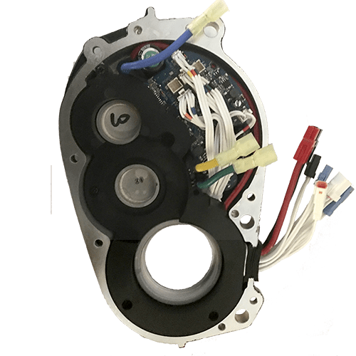

Possibly dumb question, but isn't it just the controller that controls whether the motor is canbus or UART? If so, could people getting the new Ultras swap in a "new/old" controller?

I would ASSume yes. But it is possible that the new controller has a different internal wiring scheme and connection points in the motor.
It's also possible that it is physically different and might not line up with different mounting points
