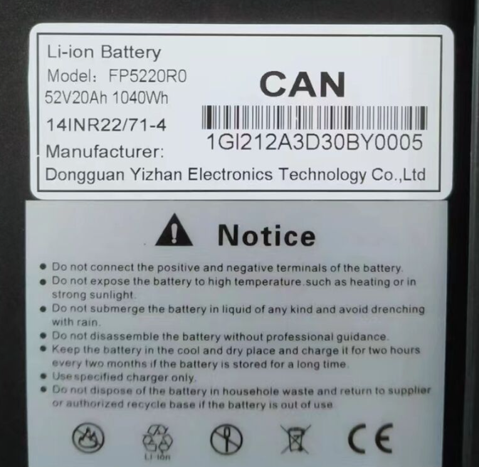

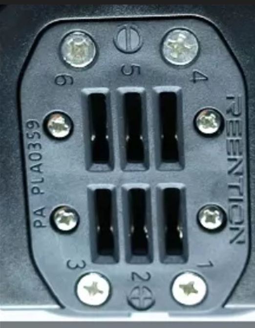

And I have another question. There are batteries with CAN protocol communication. Will such battery work with Uart Bafang m620 motor?
Here is the battery with CAN protocol. It has 6 pins interface. Can it be paired with UART Bafang m620 motor or CAN Bafang m620 motor in the only option for this battery?

The UART and CANBUS based motors are identical, so identical power on tap available from either. The difference is the controllers. This is where the issue is. The UART controller is very easily set up with the Frey Smooth tune, making it one of the most sophisticated available. This allows excellent management of a torque monster motor. The CANBUS, using the OEM controller programming, is like a bull in a China shop....
No, like Ahicks said the motors are identical in power. But because my custom uart program was so much smoother it felt like it had less power but that is only because the power delivery is more gradual. If i laid into the pedal with some force which i dont normally do the power was all there. The factory program in the canbus motor was rough and got annoying after a while. It was powerful but the delivery was not ideal.
